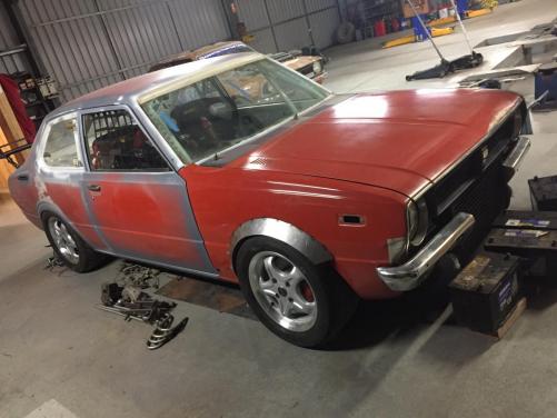

    Well, big day on the car today, extremely happy with the progress, got the welding finished, primer on, chassis blck on and the irs in with the car back on the ground, very exited
