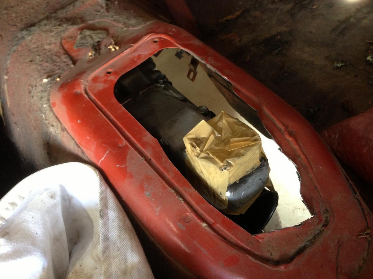

Would you be interesting in swapping shifter housings from that gearbox?
I have a further forward one available similar to this: top.jpg

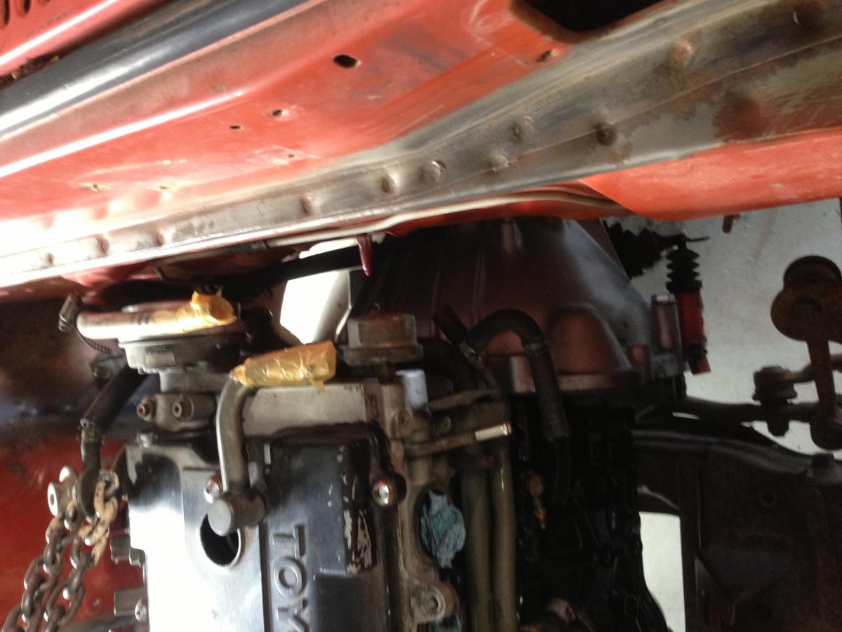

    Started on the front end, machined up some spacers so I could put rose joints in for the inner joint of the lover control arm, gonna make up some dummy control arms with some flat bar so I can work ou

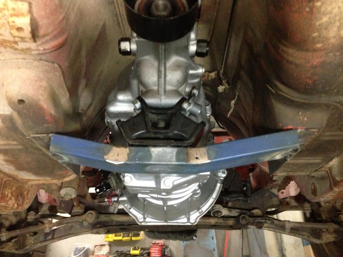

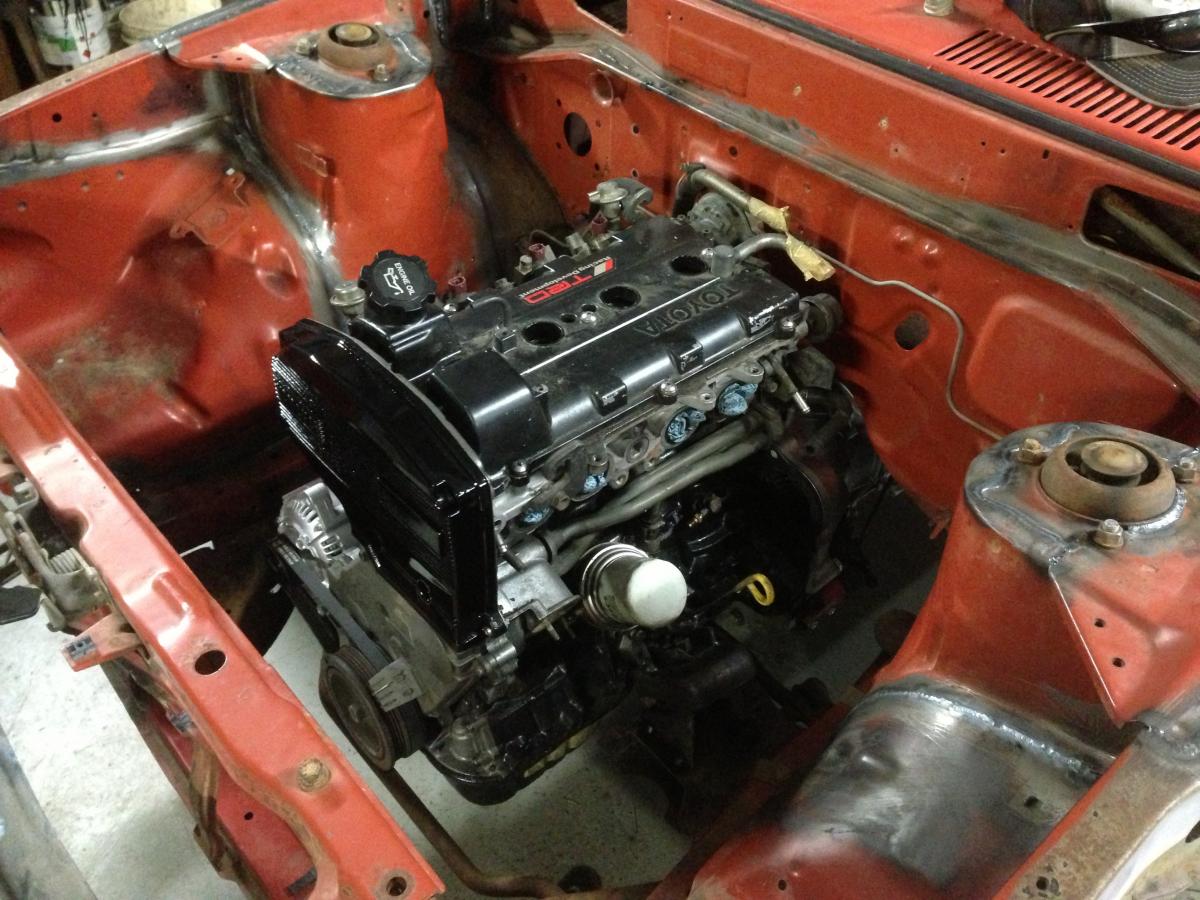

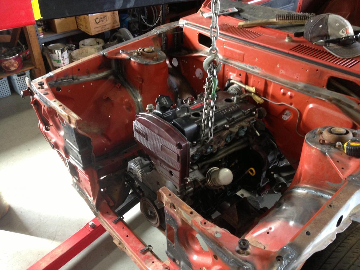

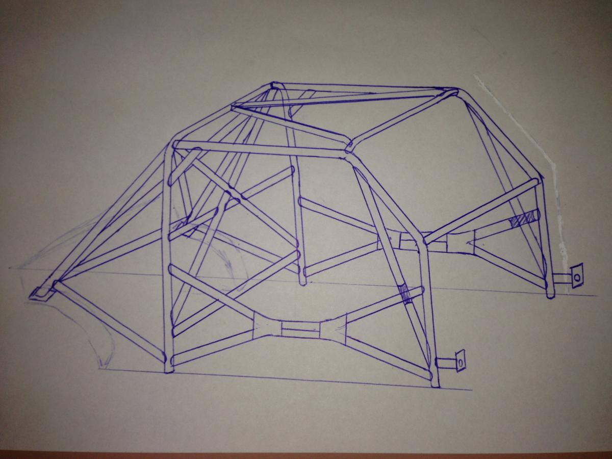

Mounted up the engine and box last Sunday so she sits up by herself now, and I sat down with the CAMS manual tonight and worked out my cage design
Make sure your head fits up in the little triangle above you, and you can easily get your legs and bum over the side intrusion bar and past the secondary front vertical one.
Personally I'm not a fan of that CAMS cage. The one in the rally car will cause the crash by forcing a poor visibility situaton from a bad seating position, and then may keep you alive long enough to burn to death because you can't get out in a hurry.
Roof bars will be no issue and I may even still use a full cross, I have a very basic cage in my ke20 but it needs a lot more stuff to get registered so I can do rally I like this cage design easy to get out of and strong as ʞ©$ɟ

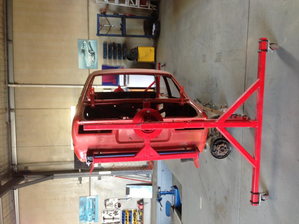

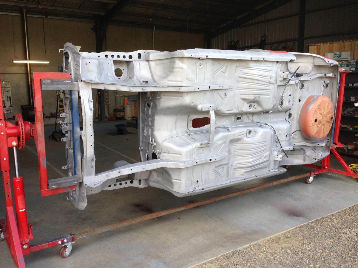

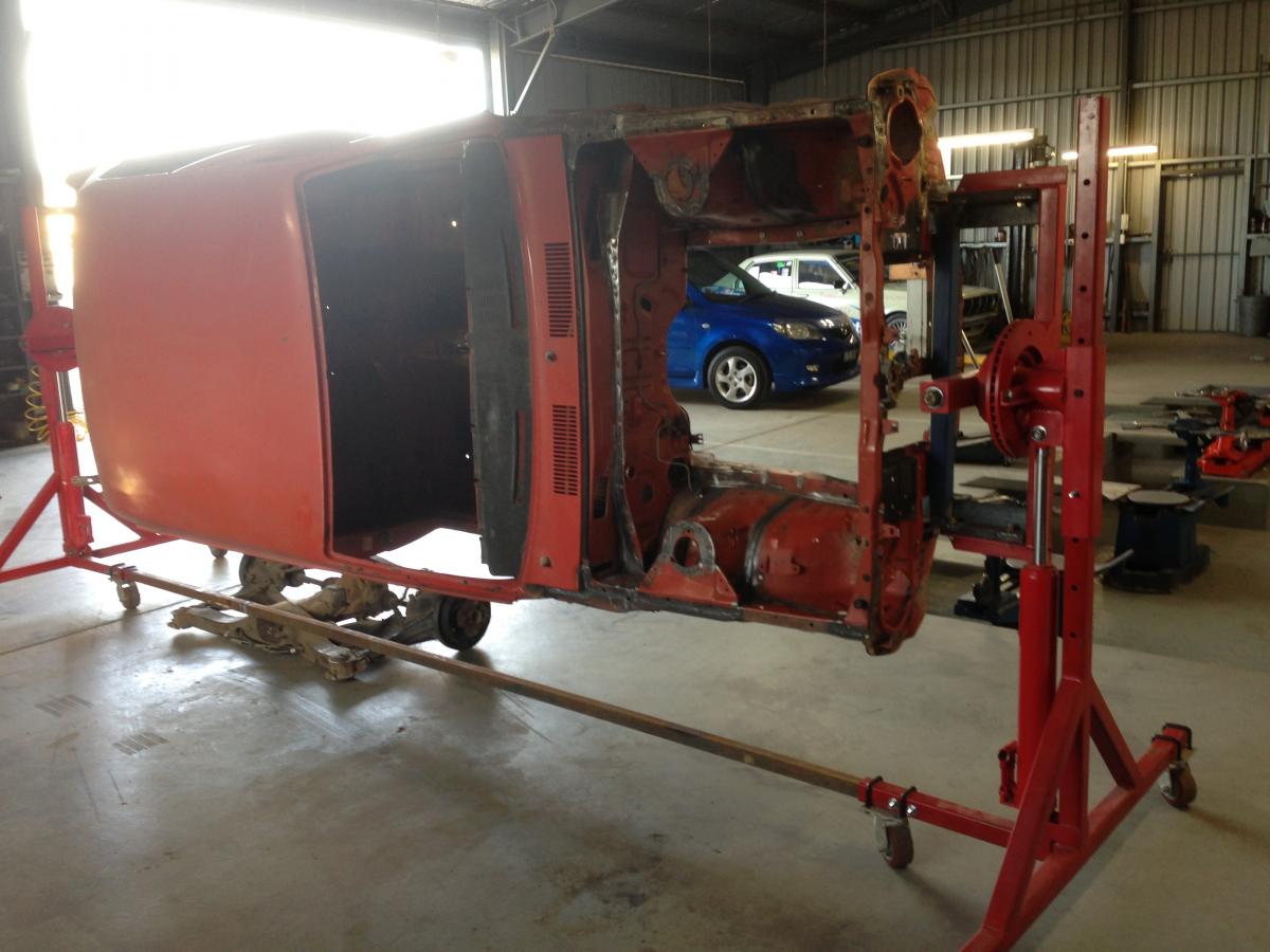

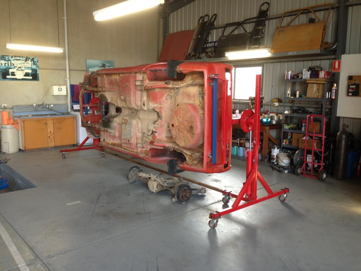

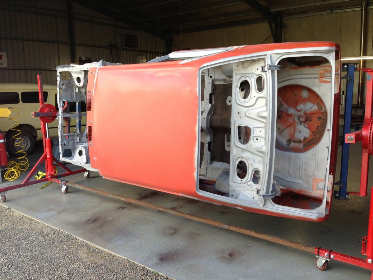

Ok so the car is now completely stripped and on the rotisserie, next up is to seam weld the floor and chassis and then mount the IRS, gettin exited now

I've been pretty busy lately with work, trade school and racing, gonna get a quote on sandblasting the undercarriage, interior, boot and engine bay so I can seam weld all the floor panels, chassis and fit up the IRS hopefully get it happening pretty soon

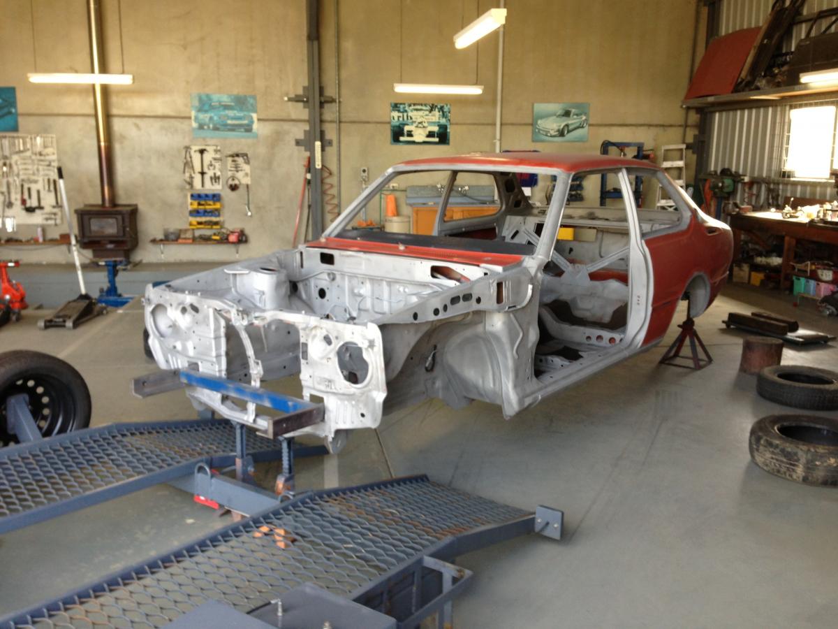

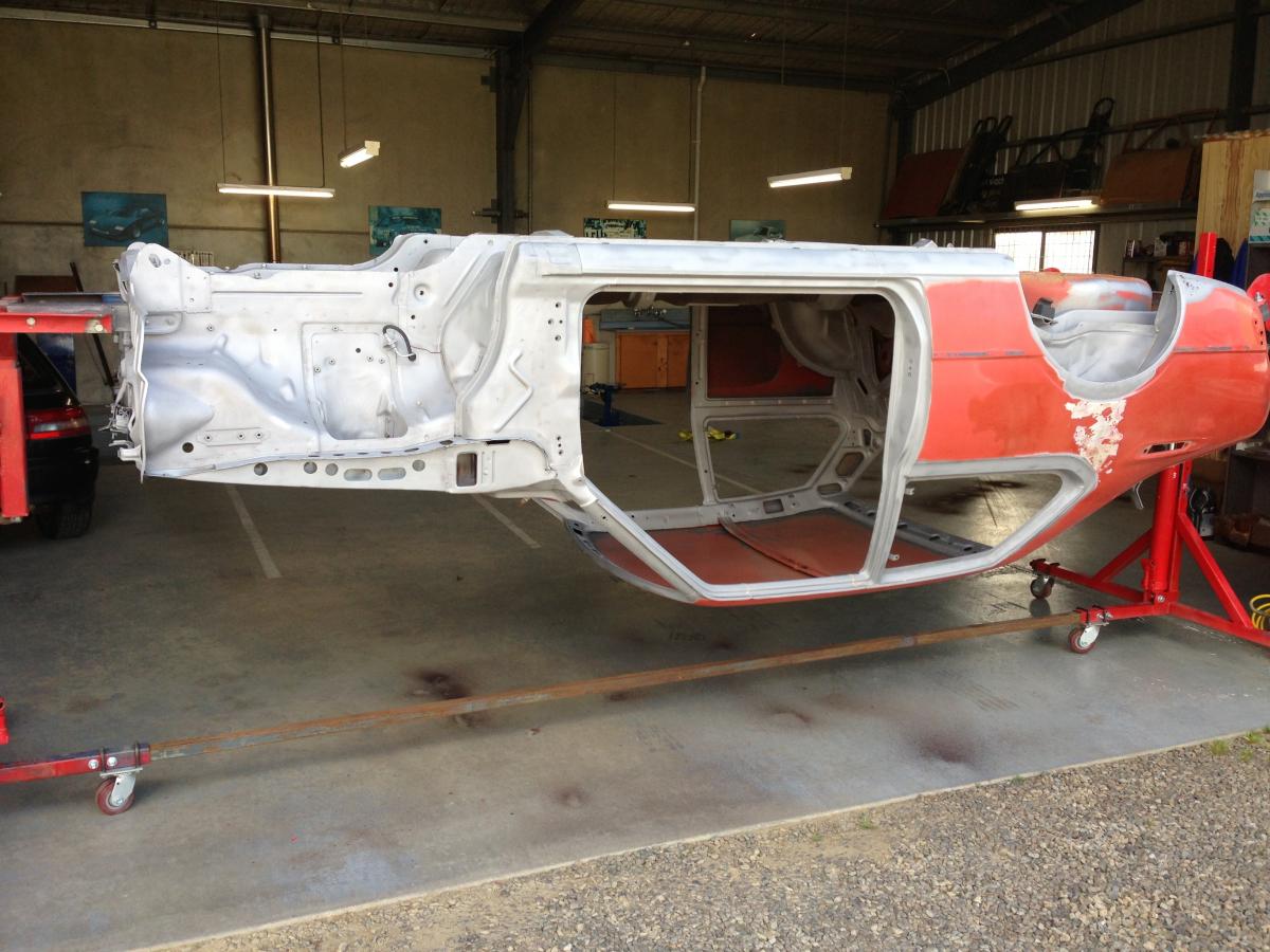

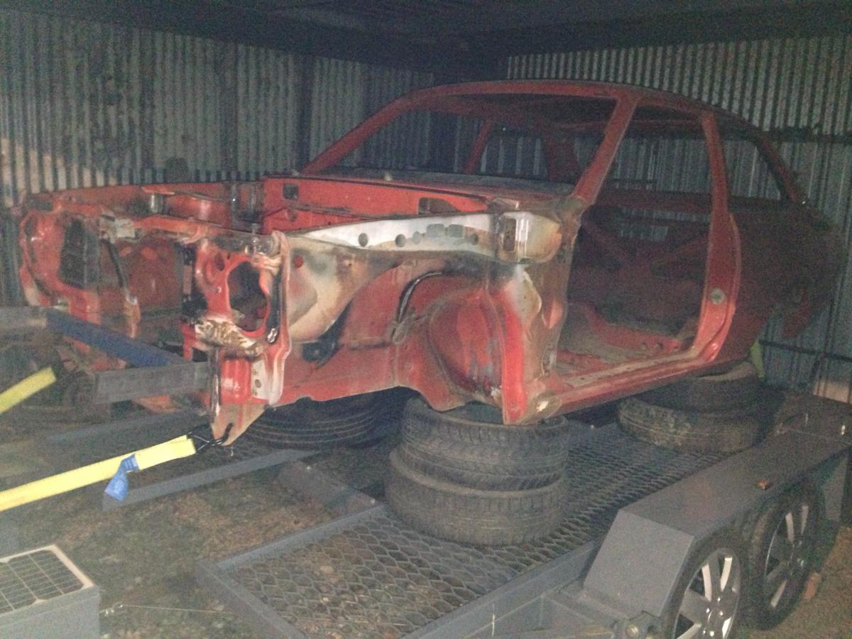

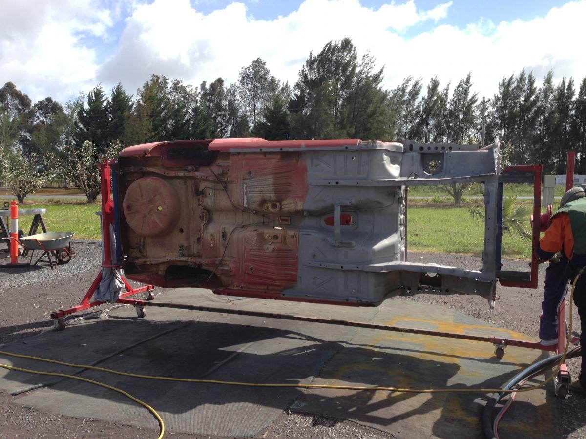

Ok so for anyone who is gettin eager for updates, I have a quote from the sandblaster and its gonna cost me $150-$200, no brainer, he can do it in a couple of weeks so I've gotta get it off the spit and onto the trailer then take it to him and set it up on the spit again and blast it, then move it back to the workshop and get to work. Will update once its blaster

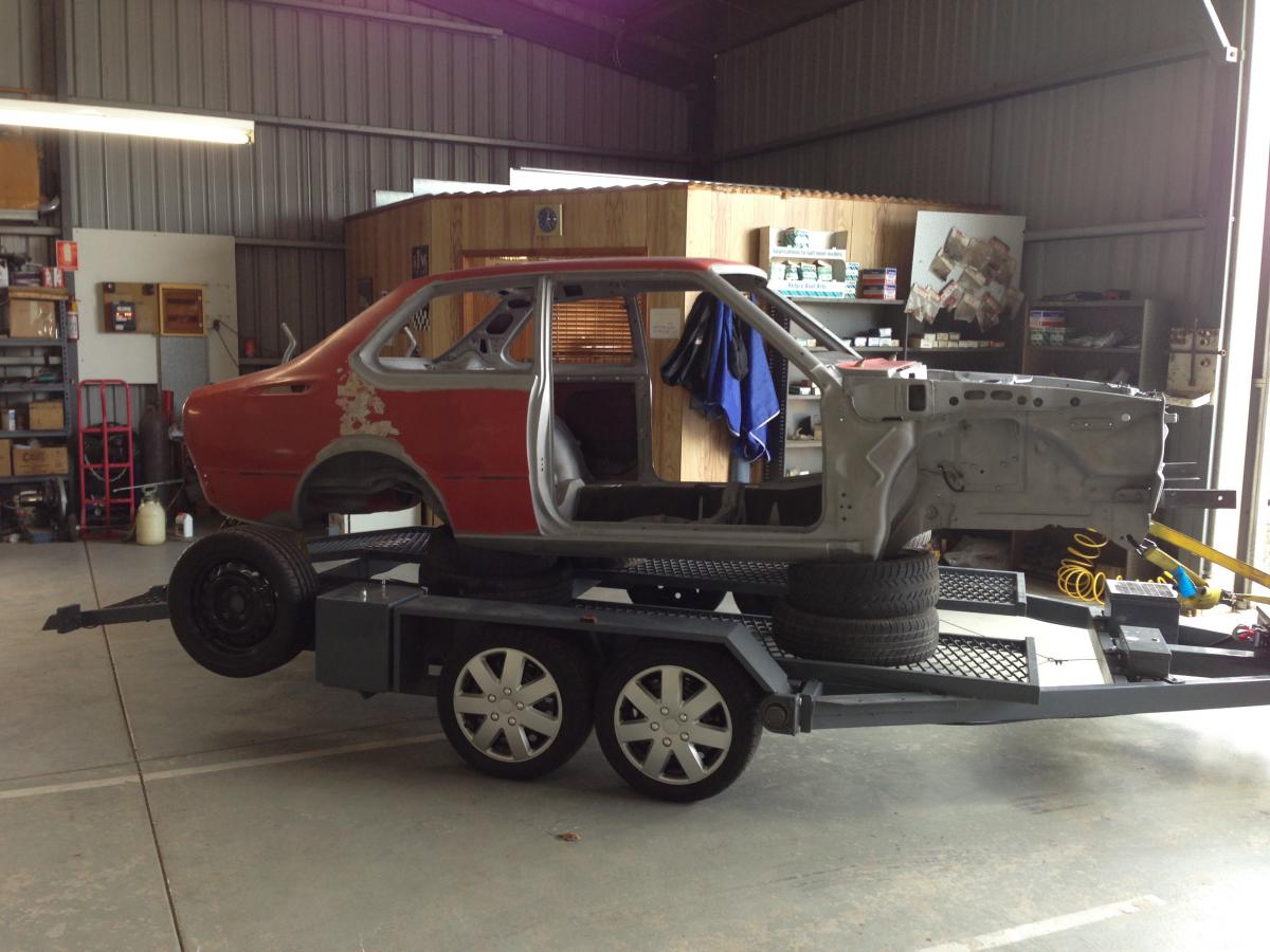

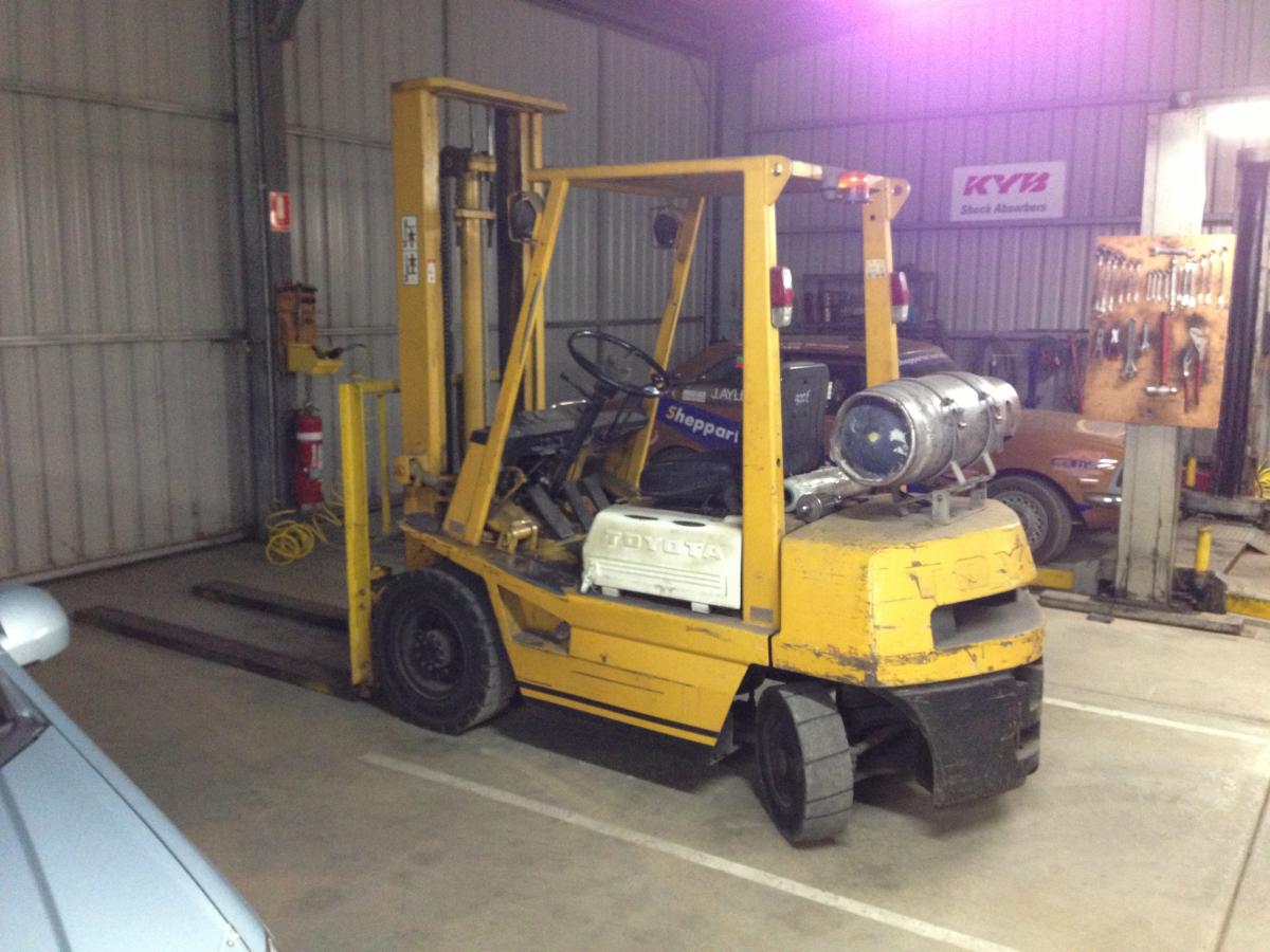

Called the sandblaster today and he's gonna do it this Saturday assuming its not raining, so the shell is now off the spit and on the trailer. It handy having a boss who lets you pinch the fork for the night, could have been pretty tricky otherwise

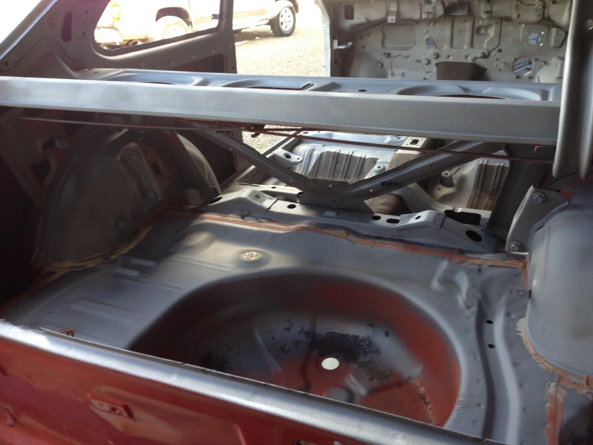

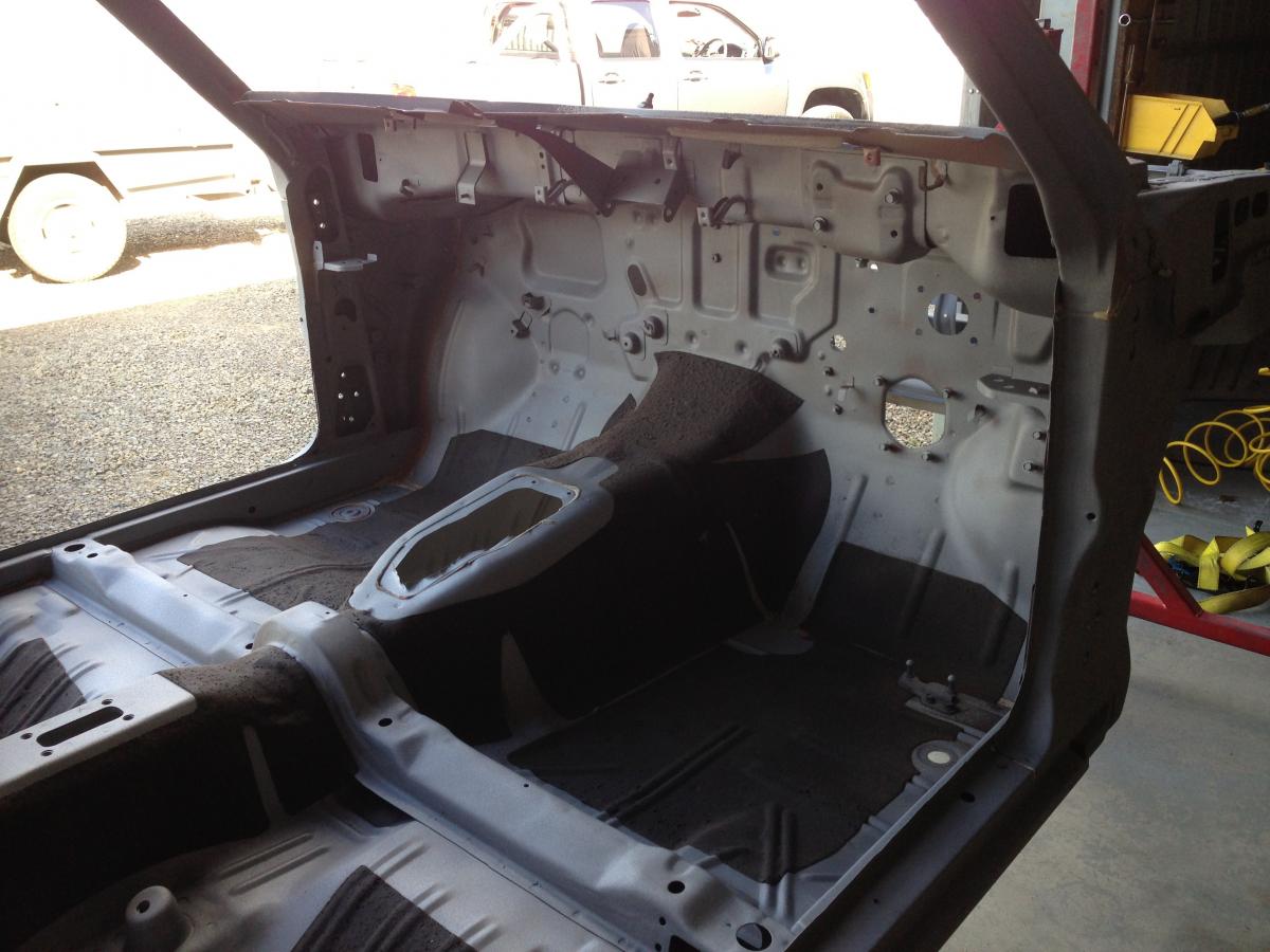

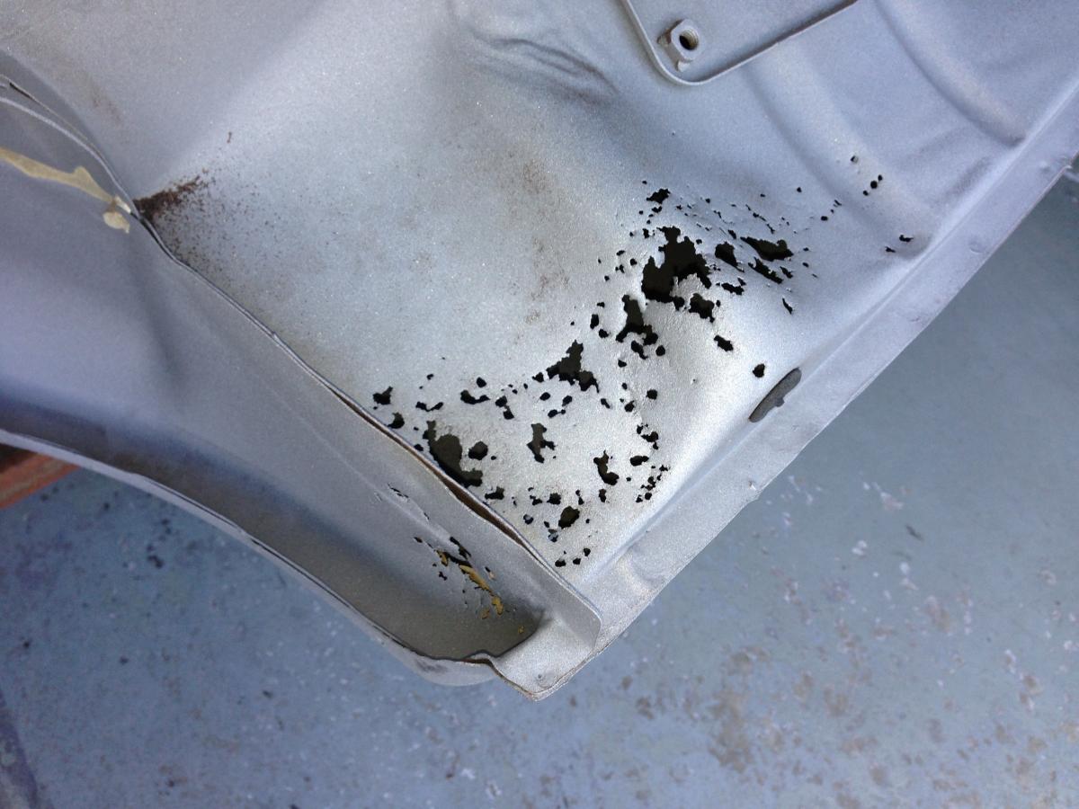

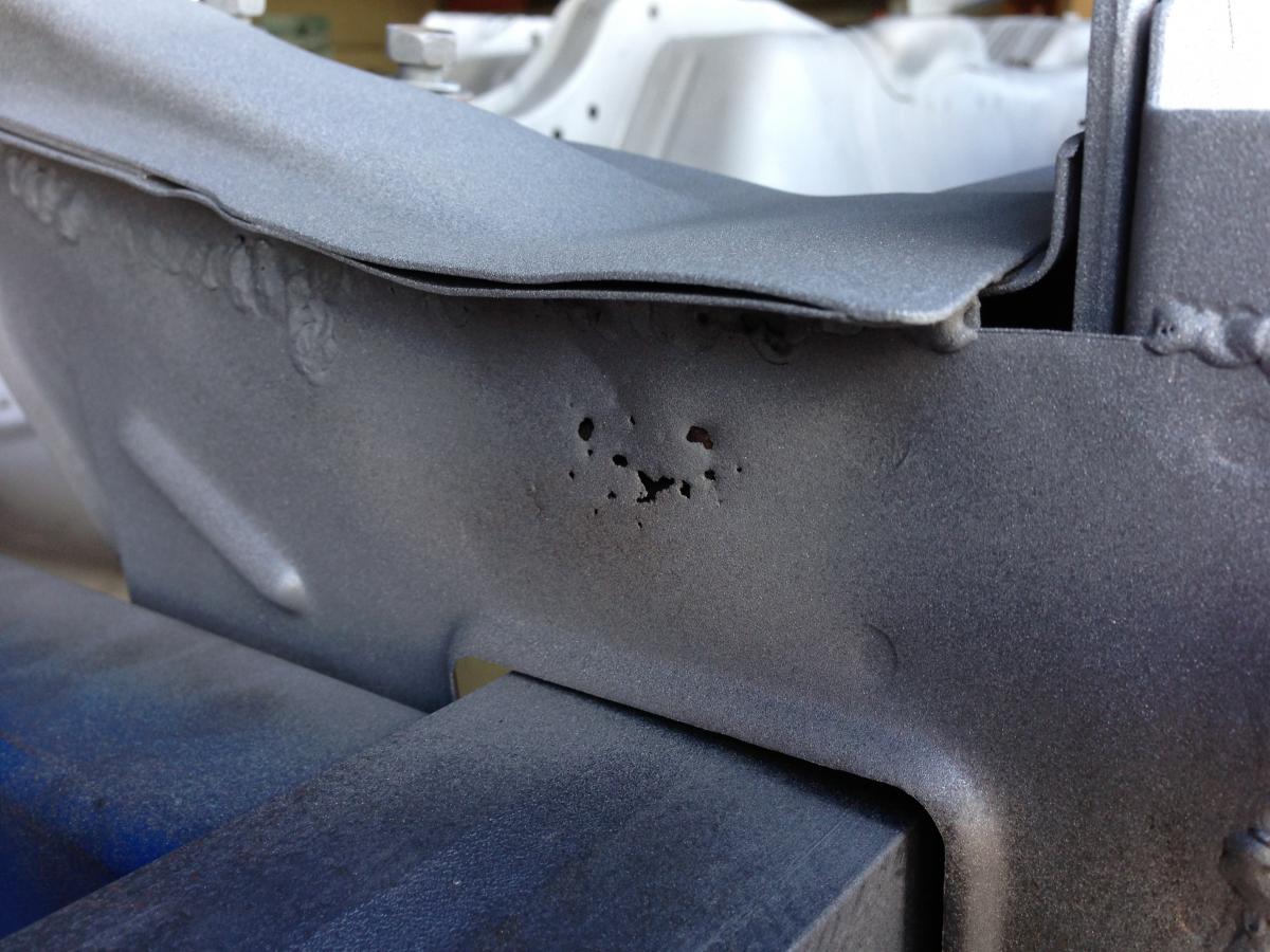

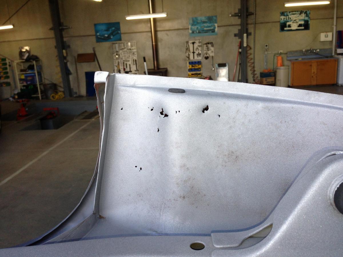

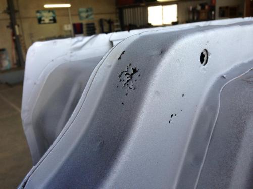

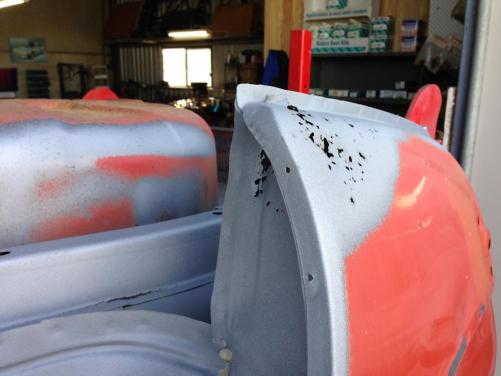

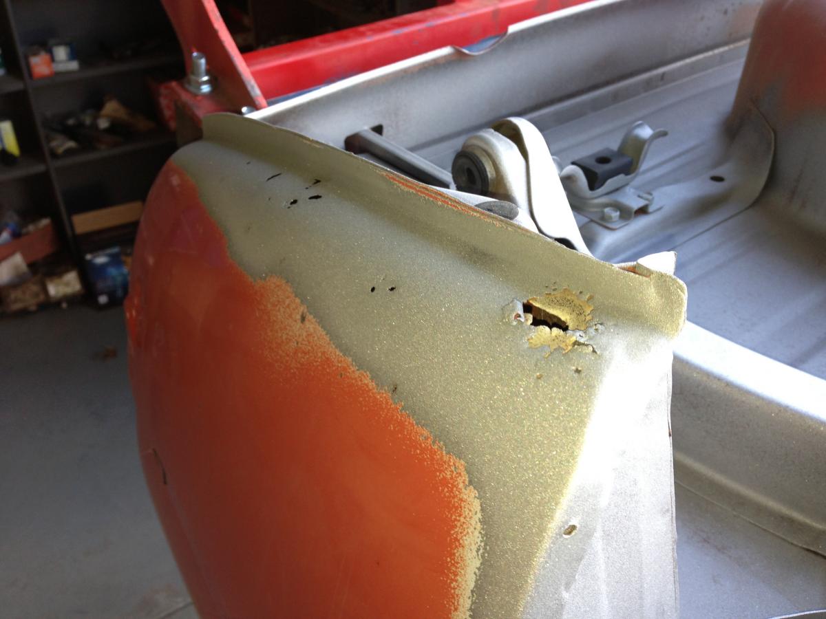

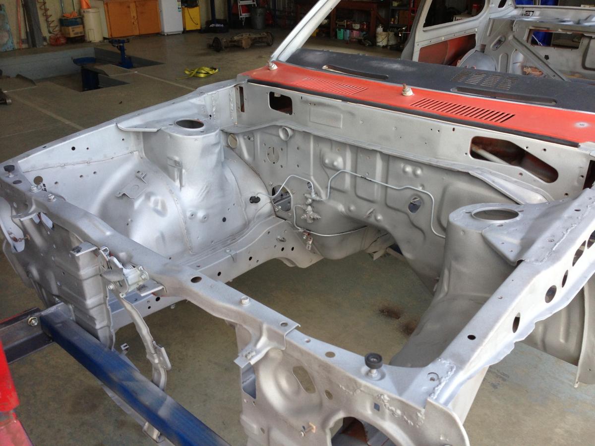

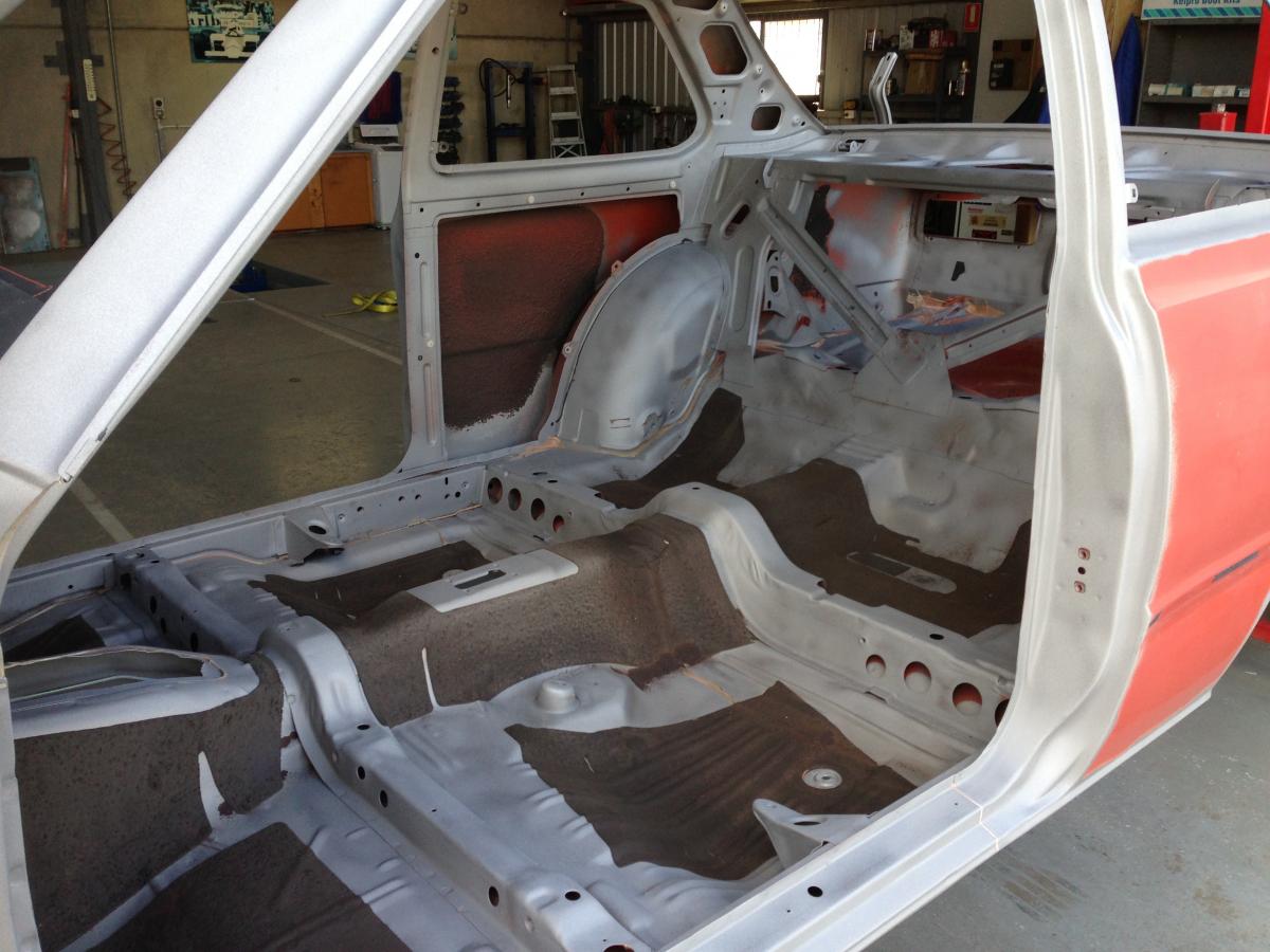

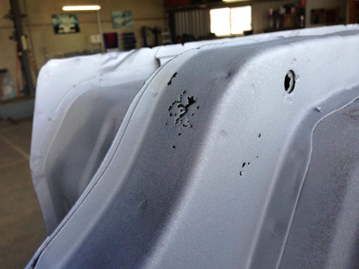

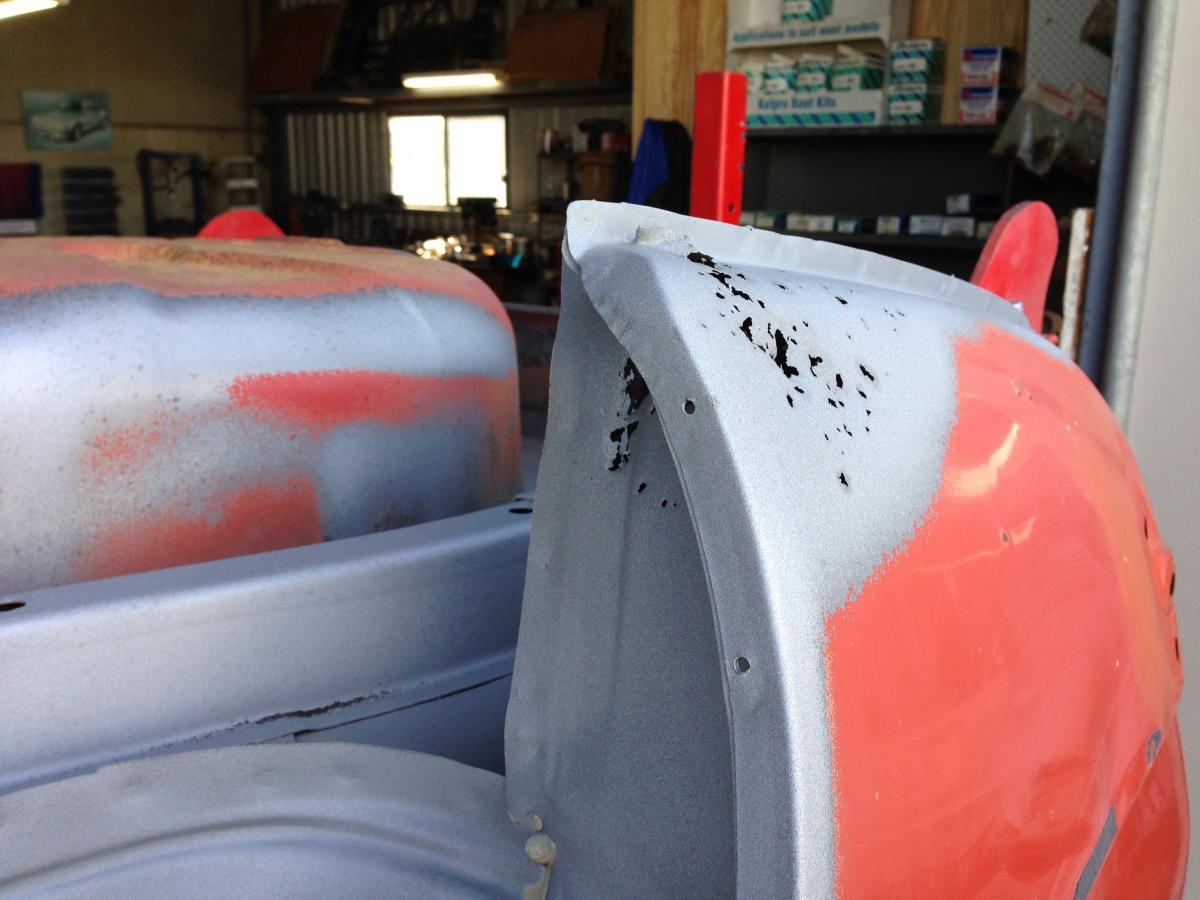

Ok some noticible work done now, the rolla has been blasted underneath in the bay, boot and interior. The rotisery made the blasting so easy. Luckily tge blasting didnt reveal anymore rust but it did reveal how bad the rust in the rear guards is. Because the weather is pretty good I'm not stressing about primer so I'm spending every night this week at work to get the seam welding done then Saturday ill get the sound deadener out and the primer on, then onto the IRS
