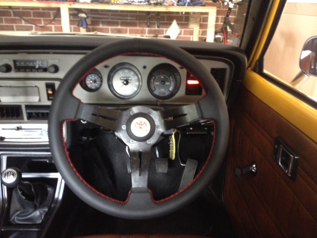

  14. Went with this one in the end, feels and looks much better.
