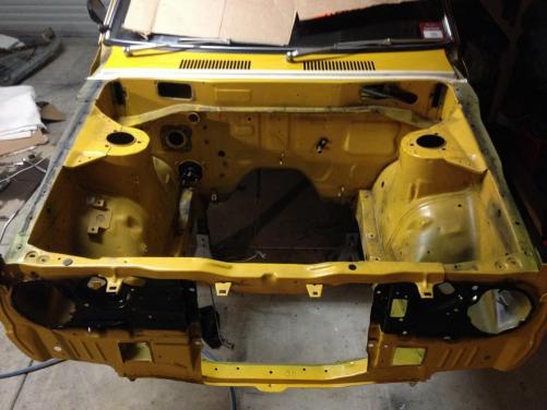

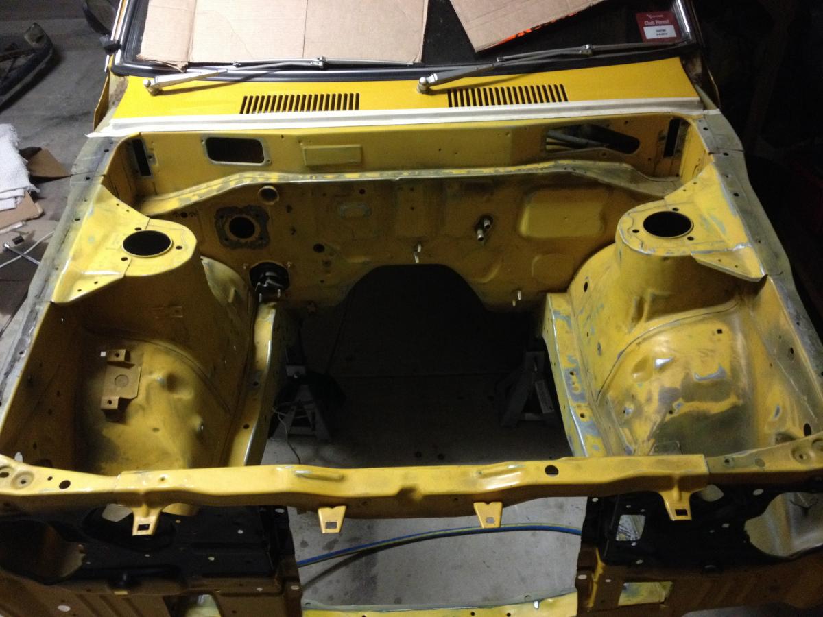

October 3, 201412 yr comment_689056 G'day all, I'm about to paint my engine bay with some Acrylic from Autobarn. I have repaired all the rust with patches, removed and treated the rust under the battery tray and sanded it down with 320G. At this point I have a few small patches of bare metal which I will cover with etch primer and then rub down the whole lot with 600G? then apply the Yellow Acylic, probably three coats? not sure yet. Questions... Does the whole engine bay need primer or just the patches of bare metal? Is 600G OK to base and top coat over? or would 800 be better? Will it need a clear coat after the yellow? I have read yes and no but I'm thinking no as Acrylic should be kinda glossy once dry. Any tips for painting? I have all the gear, compressor, gun, reg, water trap, and a spare guard to practice on first. Cheers Report

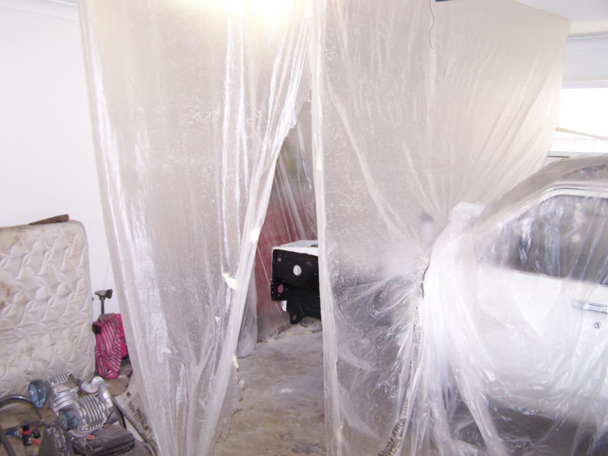

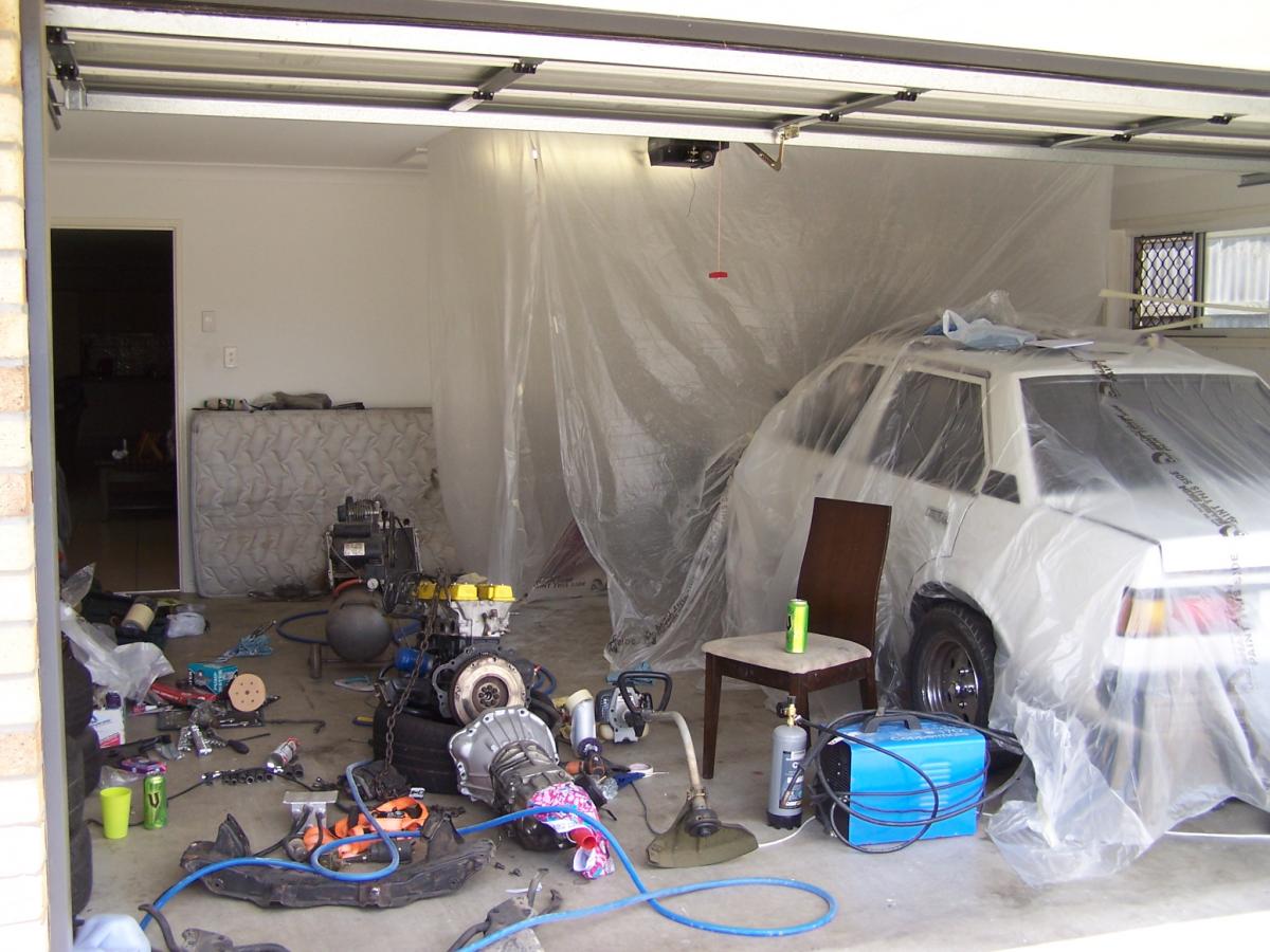

October 4, 201412 yr comment_689087 this is how its done hahaha only thing is add a window with a fan sucking out(put a blanket or something in front of it to stop overspray lol) Report

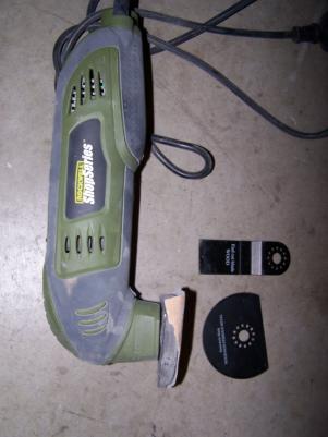

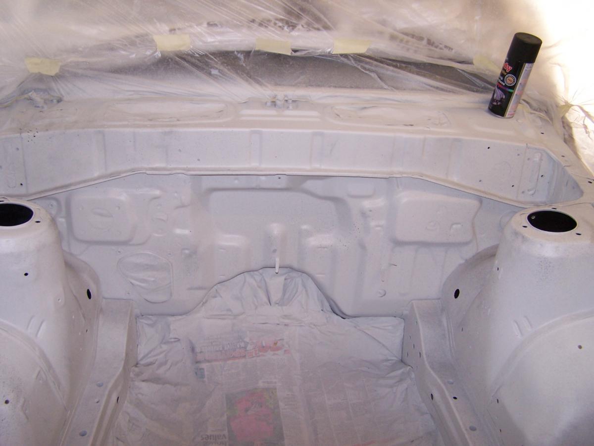

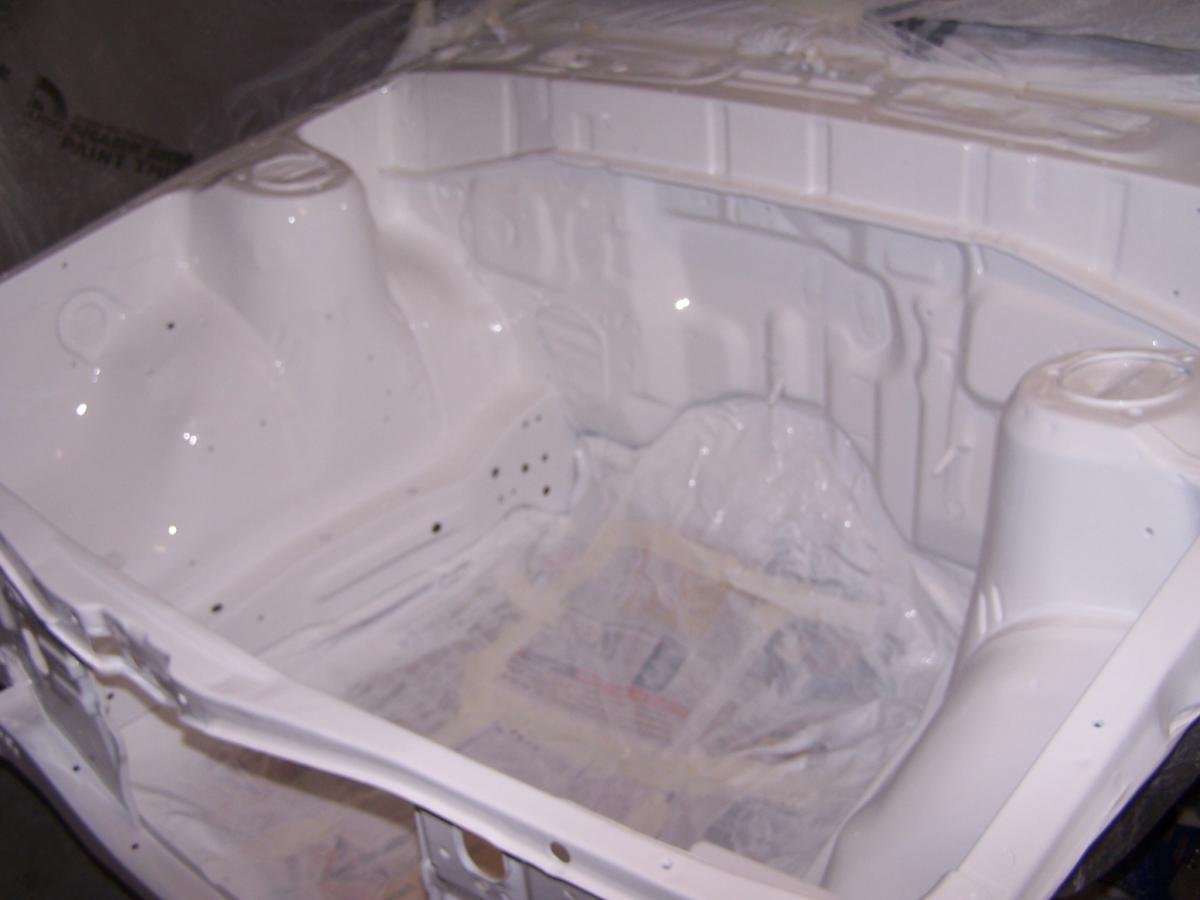

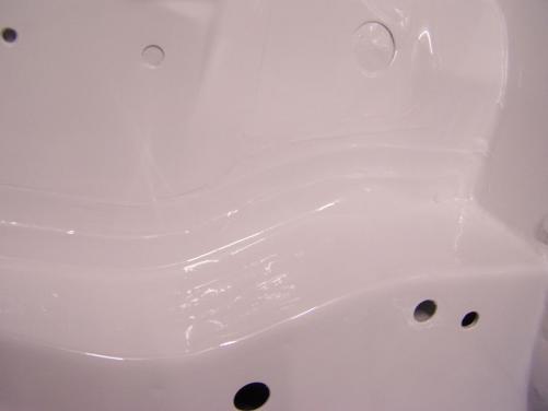

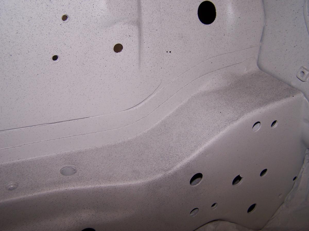

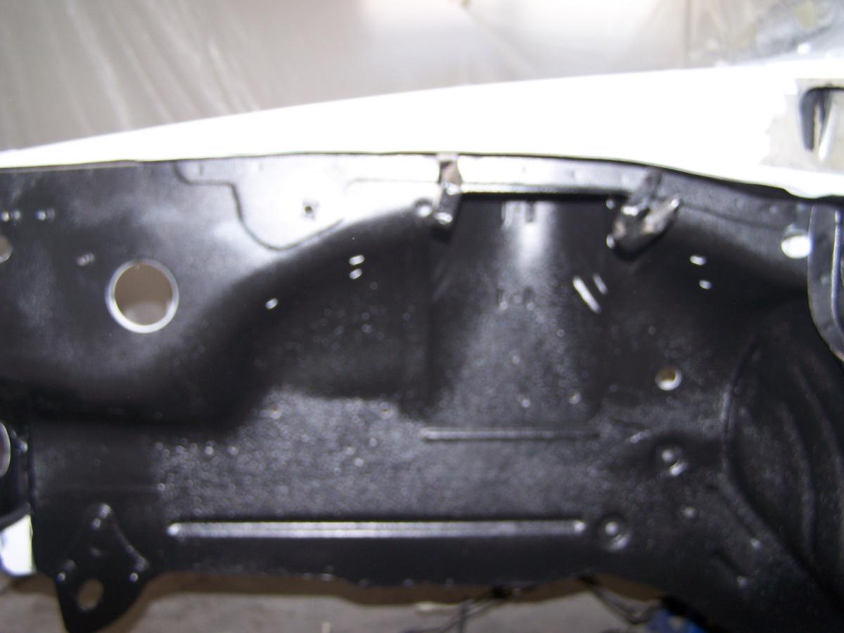

October 4, 201412 yr comment_689090 $80 well spent i think,used it to dig all the old sealer out and it kinda worked like a scaler on the rust along all the seams and it also allowed me to sand 95% of engine with it using the sander attachment(alot of sandpaper lol) i used 5inch velcro discs p150 which i got for nothing but not expensive for box.then i went over that with an orbital sander with p320 only the parts that arent covered up,,rust converter on all the seams then wiped whole engine bay down 3 times,twice with thinners and then final wipe with 70% metho 30% water mix,,then your 2pac primer over the top of that,,it was still factory paint on mine which is a baked enamel so 2pac can go straight over which meant i didnt have to take all the factory paint off only where i had too,see if you go acrylic then you wanna go 2pac in the future your gunna have to strip all of the acrylic off and i meant all of it,not very fun at all haha,as far as spraying 2pac go on youtube theres gotta be videos on how to spray 2pac,do a couple test panels,youll get it,,but a pretty sure 2pac is illegal to spray without a proper filtration system so i do not indorse this hahaha,, and thats how far ive got so far Report

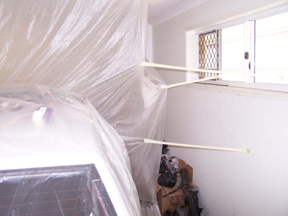

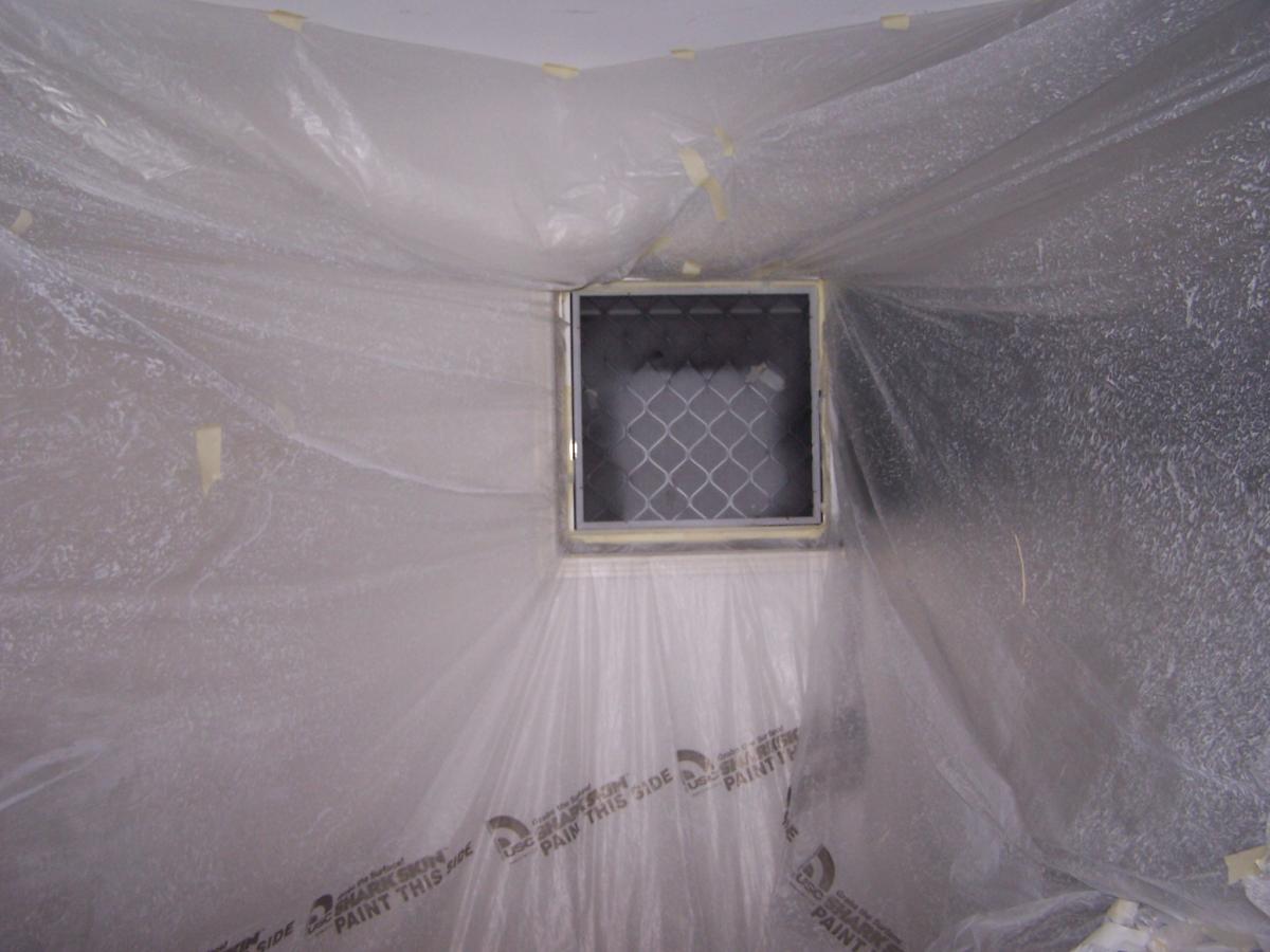

October 4, 201412 yr comment_689096 Good setup. The door you want is an upside down "T" cut in the wall, and on the inside you tape a plastic sheet about 2M high by 1M wide and it should overlap the "T" easily. That alows air to go inwards, (lifts the flap) and then out your fan window, but the flap stops air going back out through the door. Basic asbestos cocoon... Report

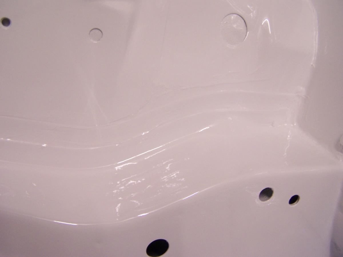

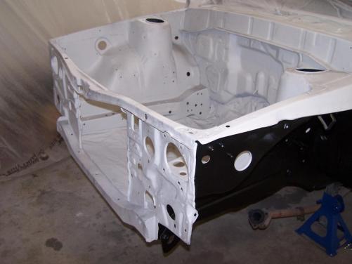

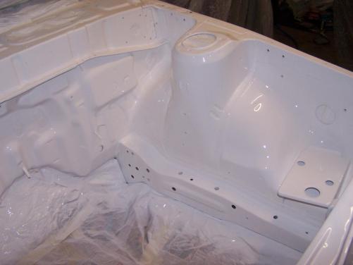

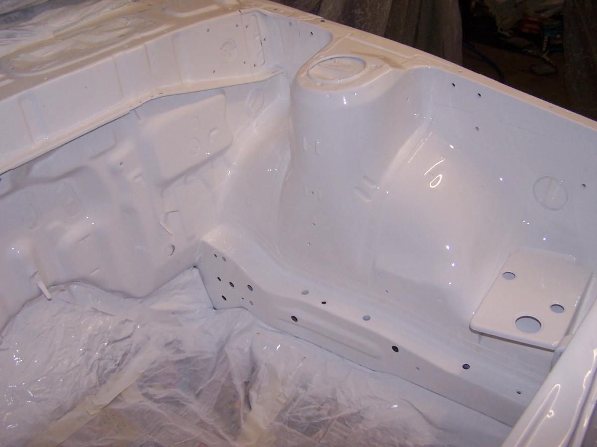

October 7, 201412 yr comment_689190 put in a window this time,with a thermo fan of the ae82 i pulled the motor out of haha,bit of crap in the paint but pretty happy on how it turned out also put new sealer on the seams,was wet rub with p400 and red scotchbrite on the bits i couldnt get with the 400,, 2pac in the engine bay is a must in my opinion Edited October 7, 201412 yr by bourtoni Report
October 7, 201412 yr comment_689198 Looking fantstic mate. I'm loving the enginuity of your ventilation system. Report
