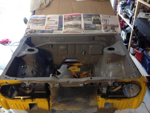

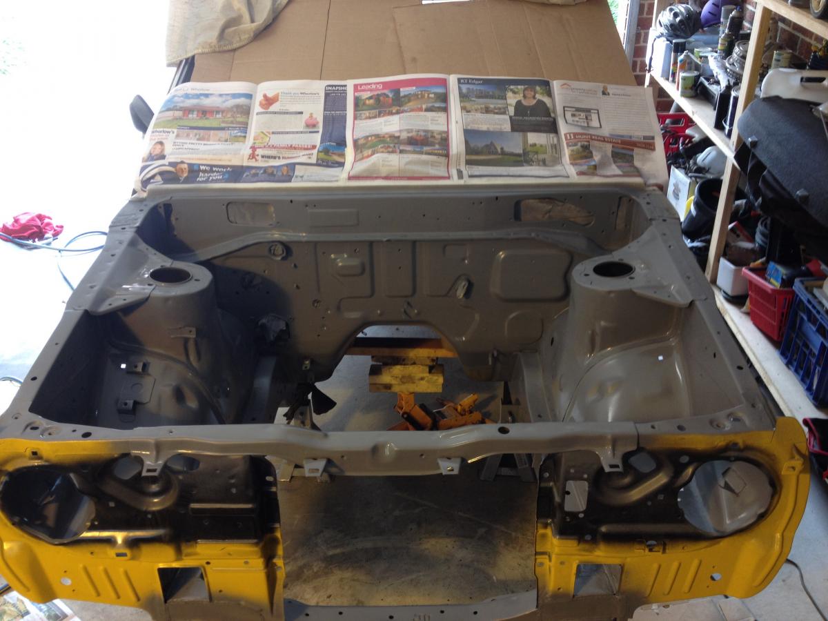

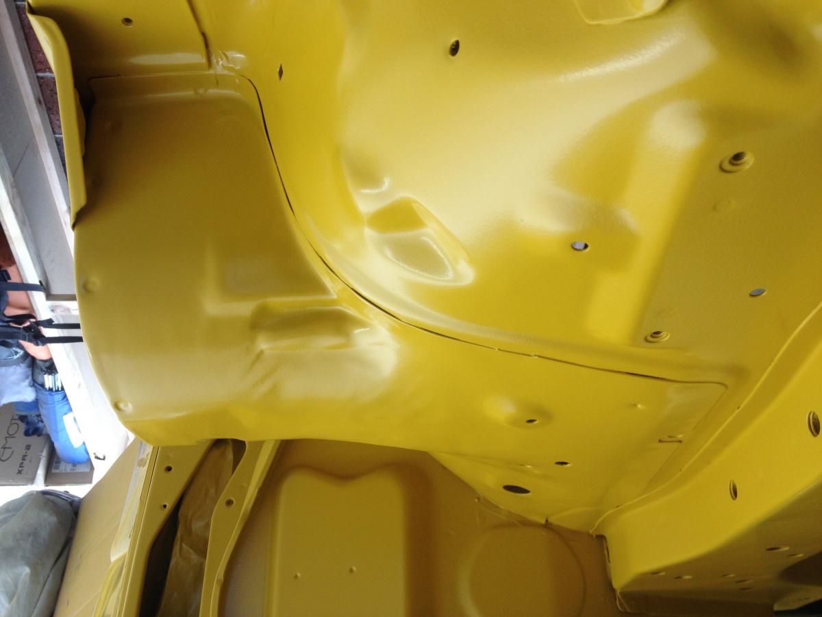

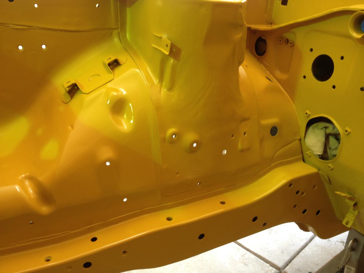

Got a couple of coats done today, should get it finished in the morning. It look pretty good I think the finish matches the rest of the car, not to glossy.

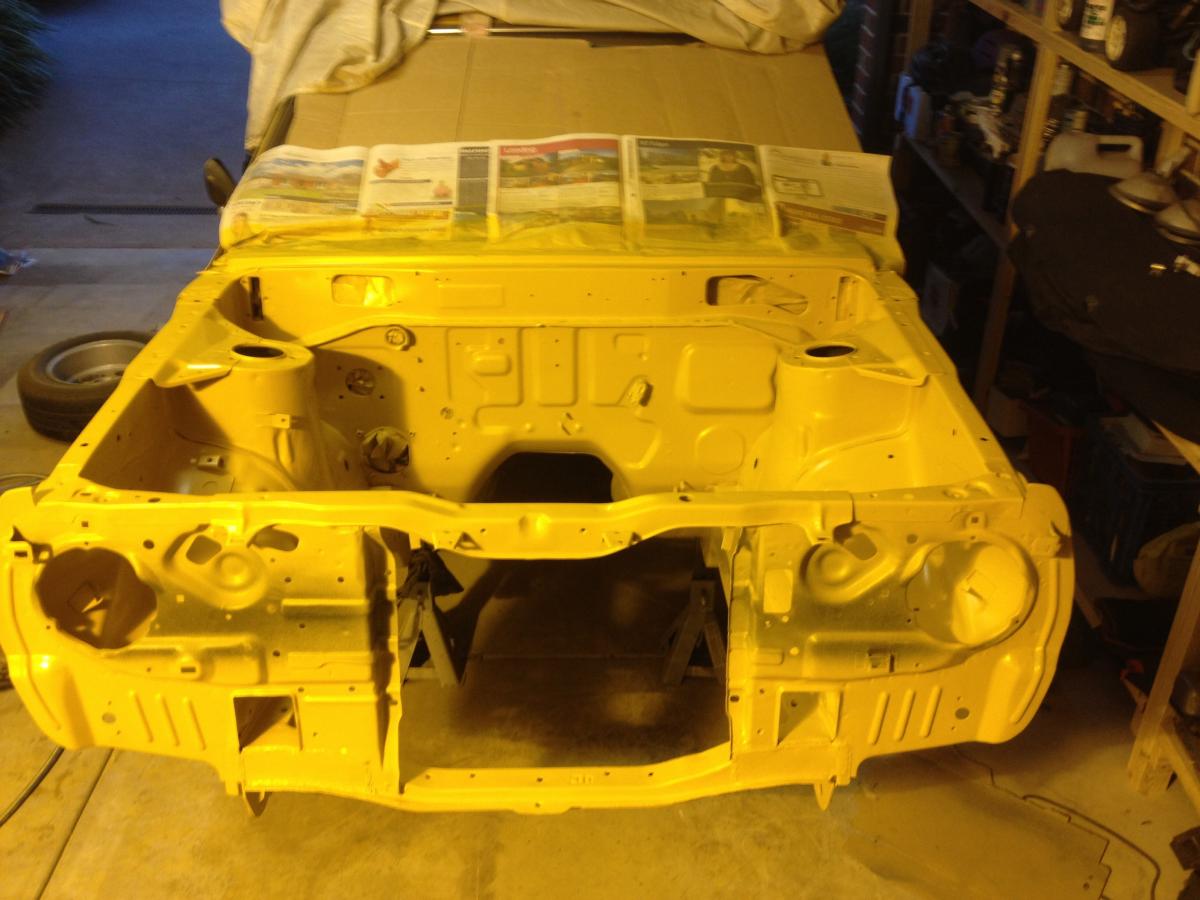

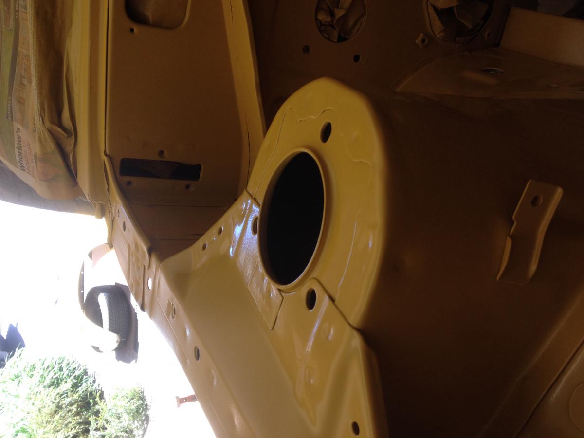

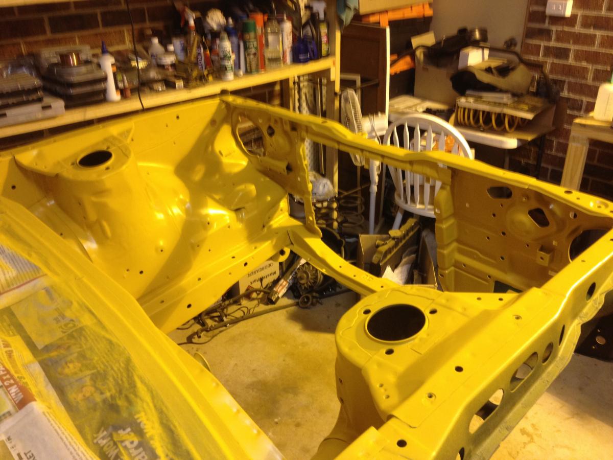

Finished it up today, got the gun set better and it is now way smoother. Might do a little wet sanding in places but it looks pretty close to factory finish now. Sweet!
I was at 45psi at the gun, bought a little Supercheap digital gauge $22. 100 paint to 150 Aclac 20

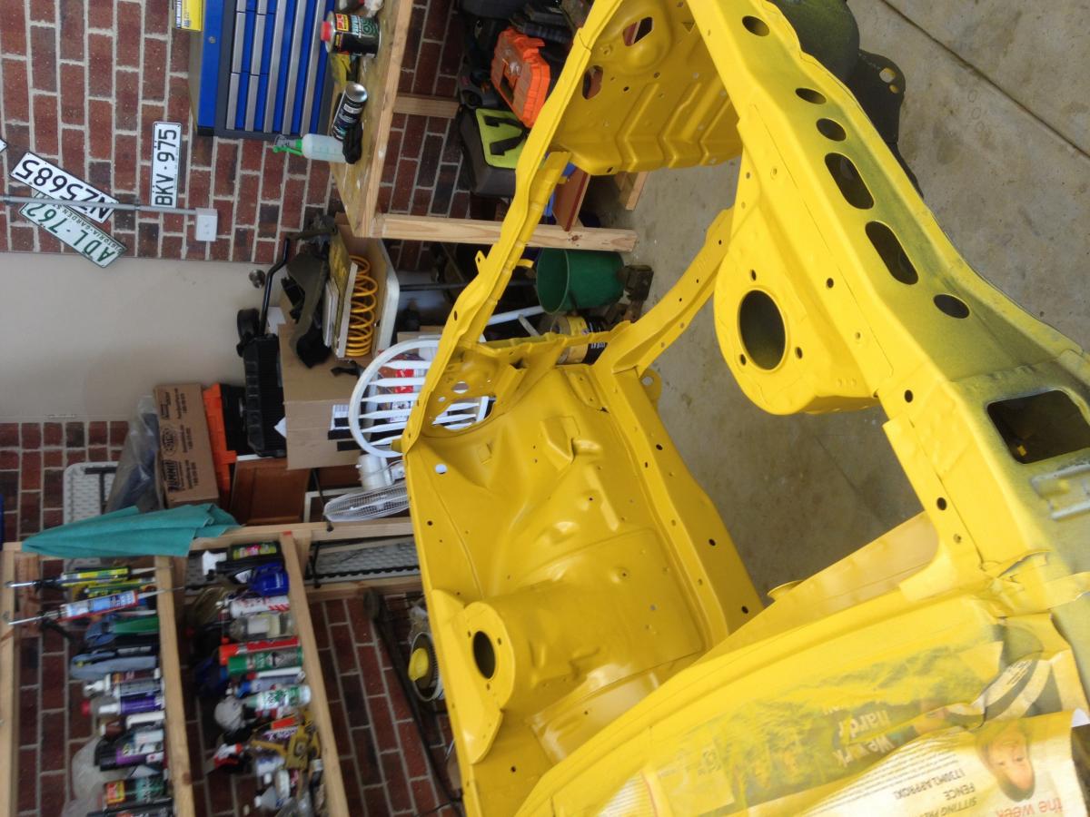

Came out good for a first paint job, it's definitely a feel thing, next step will be the whole car. Next year maybe 😜

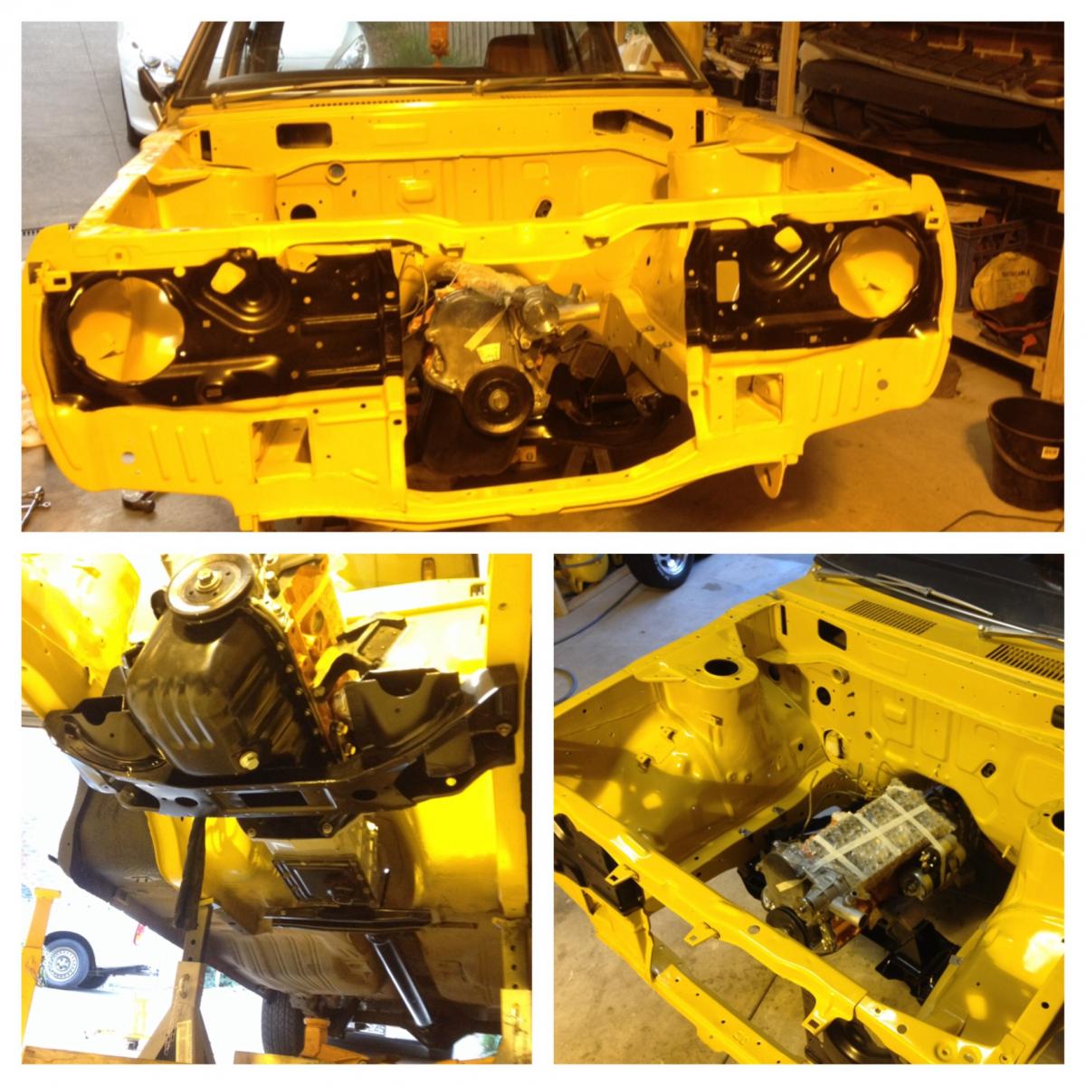

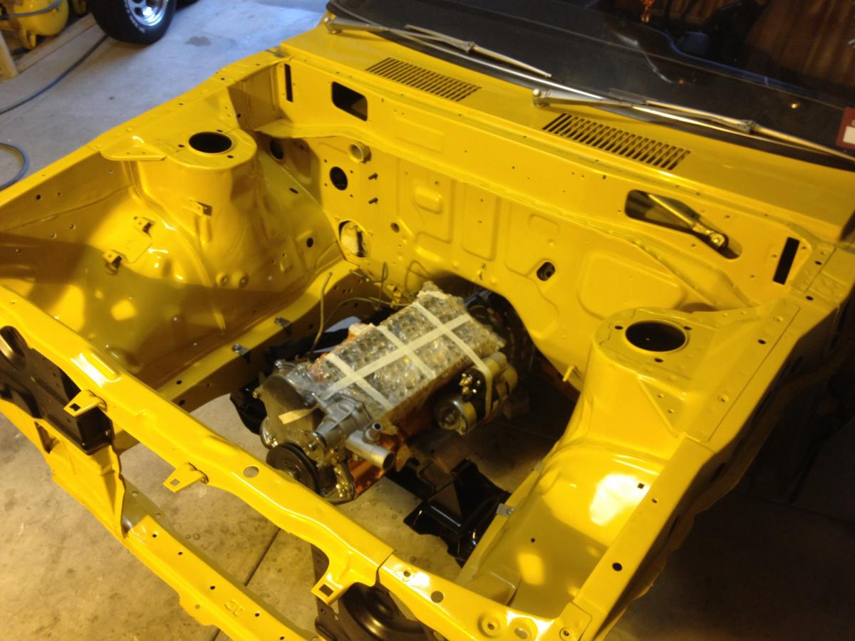

Finished it up with a quick buff and dropped the engine in.
Looks great! Well worth the trouble- in 10years you'll be still looking at it and thinking "gee that looks good..."

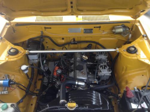

Looks good!! gotta be happy with that,mine is still ongoing,its hard finding funds,parts and time haha,
