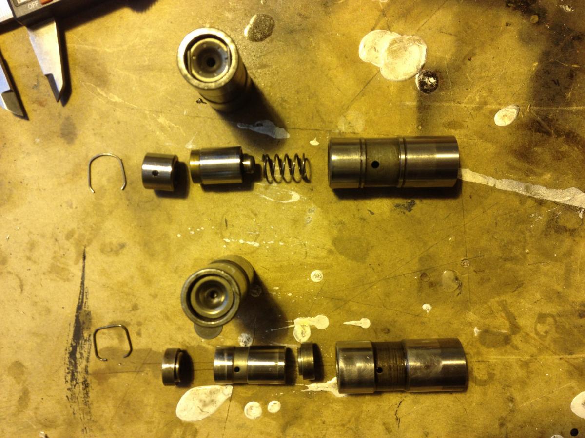

  3. Measured with calipers and they are exactly the same, both fill with oil via holes, so both hydraulic. It's just the internal you can see are different, one has a spring type design the other is an oil filled piston type. I wonder which is better or newer?
  4. Hi all, in the middle if the 5k build at the moment and I have three different types of lifters. Does anyone know the difference between these two? Which is better? New version? Any ideas which I should use? They are the same overall dimensions but obviously the internals are different.
