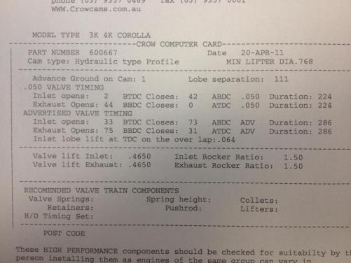

  11. Yup I have the exact same setup. Rebuilt 5k bottom, 5k head shaved to a 13cc combustion chamber, 22.5cc d dish piston, running a .8mm head shim. Comp at 9.7:1 So can I run the adjustable rockers from the 4k head with the hydro lifters and big cam. Couldn't I just set the tappet clearance to none? Won't that just be like having non adjustable tappets like the original 5k ones?
  12. Ok all you engine gurus, I just spoke to crow cams and they suggested the cam below for my needs. They mentioned that I would need to change to a 4k head/adjustable rockers to use this cam due to the high lift. I want to stay with the 5k head as it has been restored etc. so can I just get different length push rods to suit once the cam is in or should I fit the 4k adjustable rockers to my 5k head. Ideas?

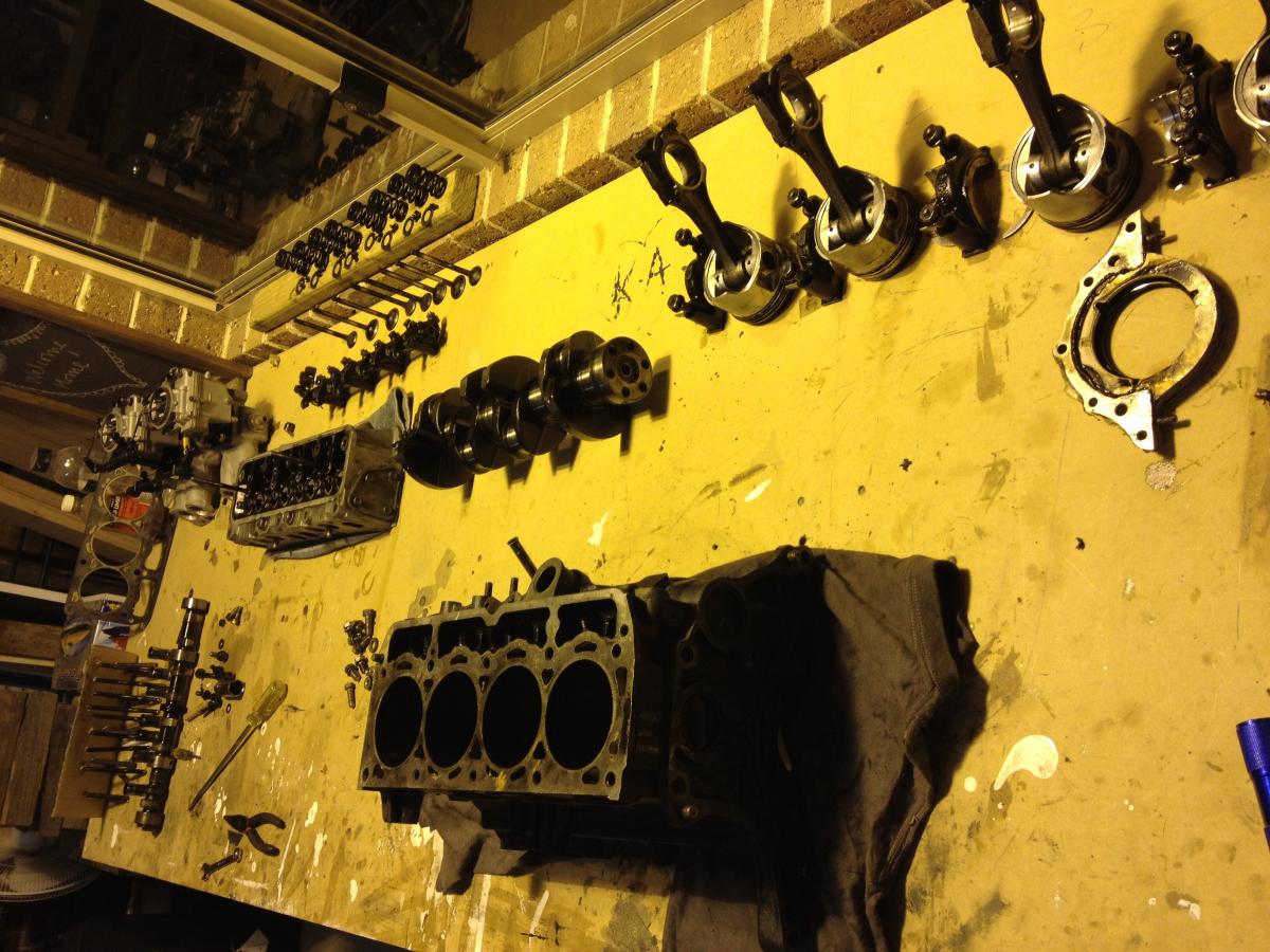

  20. Well after a bit of cleaning it turns out that the block has been bored 40thou over and fitted with appropriate pistons, it looks like it has been done recently too as there are still nice uniform cross hatch hone marks in the bores. Also luk3333 has kindly offered to sell me a 5K head with original rockers, pushrods and even a lumpy cam! So this might just work out OK. I have a set of factory Asian twin carbs that I have had rebuilt so with fit these with the a full 2inch exhaust and it should go alright! Can anyone recommend a good Carb guy in Victoria? from what I know these are jetted for a 3k so they will need some adjusting. Has anyone had a good experience with a local Carb expert?
  21. So I have just some calculations and come up with a 7.25:1 compression ratio! this thing must have been a slug! bore is 81mm, stroke 73mm, head gasket .5mm, dished piston 22.5cc, combustion chamber 35cc. I wonder how much I can take off the head without the valves hitting?
