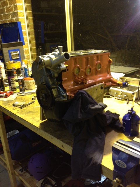

  1. Got it fitted today, engine is starting to take shape on my home made engine stand! ha. Cam specs... | Advance Ground on Cam: 2 Lobe separation: 110 | | .050 VALVE TIMING | | Inlet opens: -1 BTDC Closes: 35 ABDC .050 Duration: 214 | | Exhaust Opens: 39 BBDC Closes: -5 ATDC .050 Duration: 214 | | ADVERTISED VALVE TIMING | | Inlet opens: 32 BTDC Closes: 68 ABDC ADV Duration: 280 | | Exhaust Opens: 72 BBDC Closes: 28 ATDC ADV Duration: 280 | | Inlet lobe lift at TDC on the over lap:.045 | | ----------------------------------------------------------------------| | Valve lift Inlet: .4427 Inlet Rocker Ratio: 1.50 | | Valve lift Exhaust: .4427 Exhaust Rocker Ratio: 1.50 | |

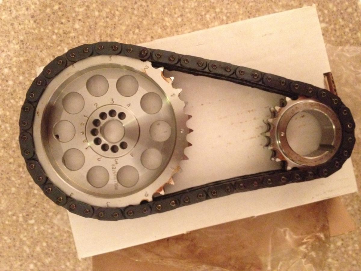

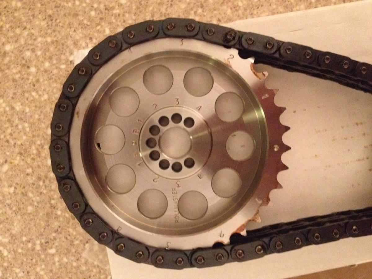

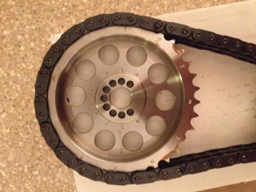

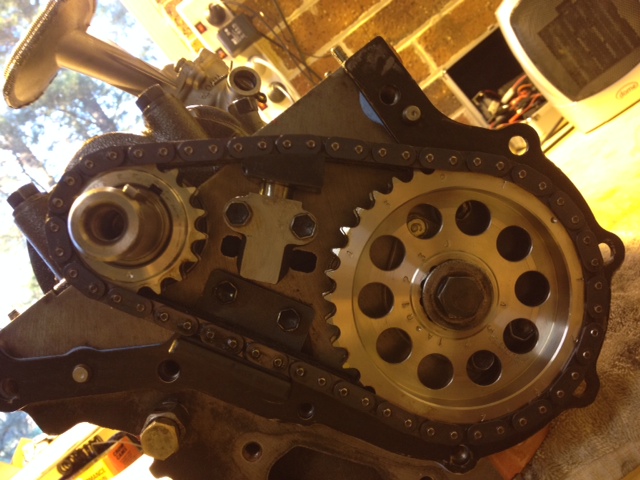

  4. Hi all, just received my Rollmaster cam timing kit, does anyone have fitting instructions for these, or experience setting them up. The Crank gear only fits one way, the cam gear has a middle hole, and then 6 holes either side for advance and retard. That would make 12 holes for 360deg meaning 30deg per hole? doesn't sound right?
