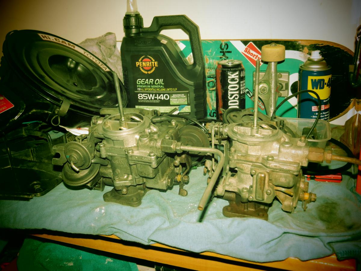

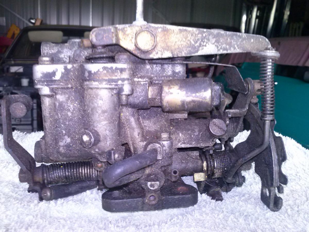

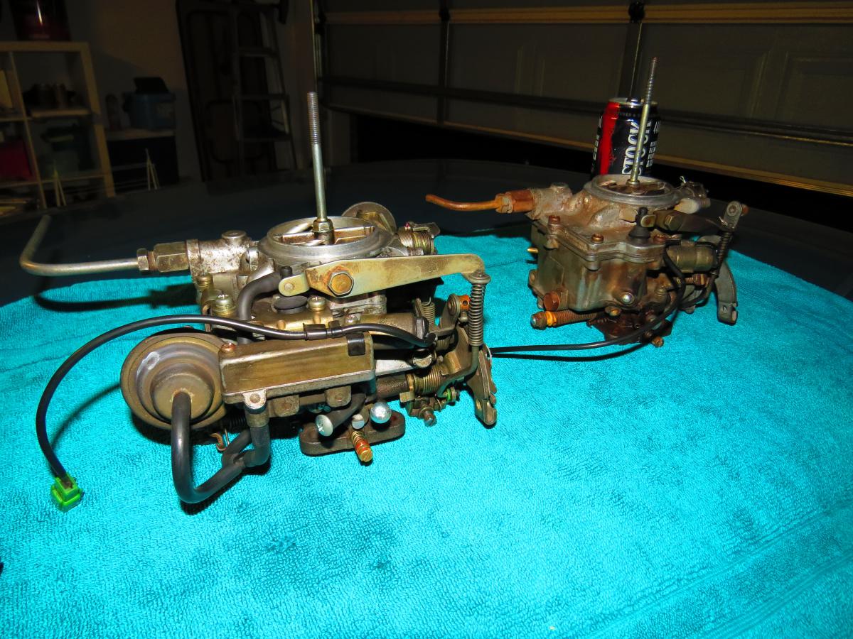

Below are my ke70 4k and ke30 3k carbs.

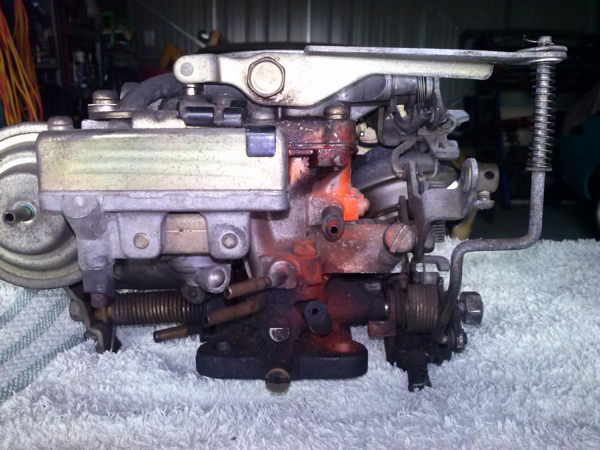

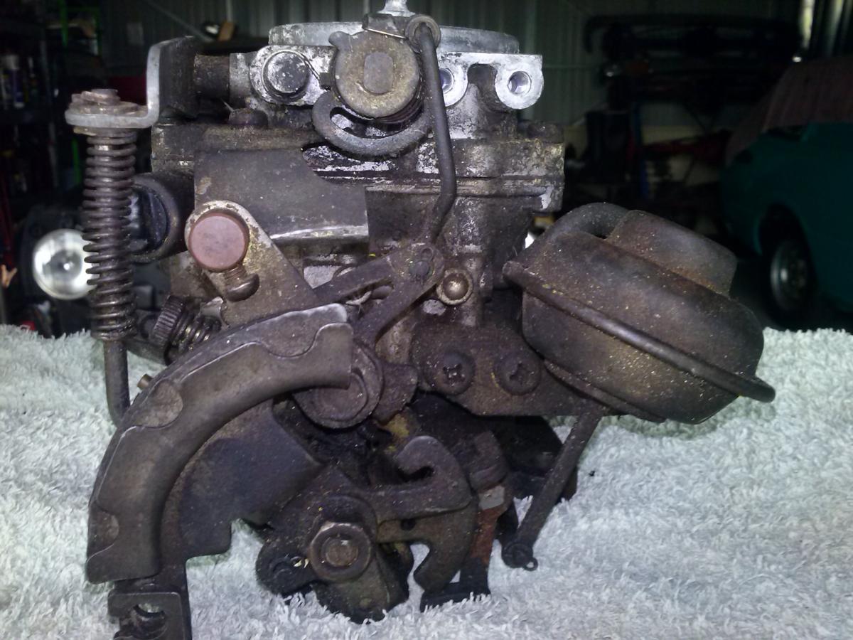

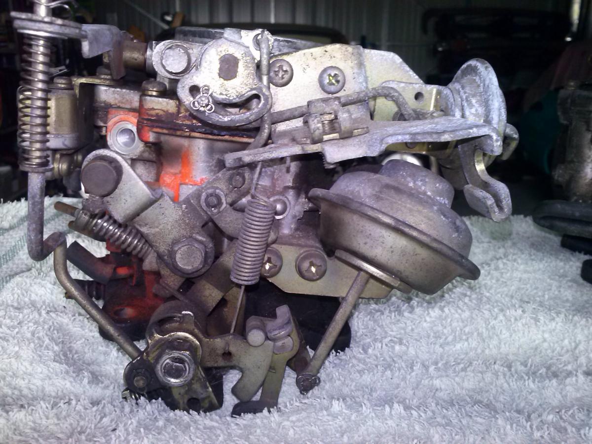

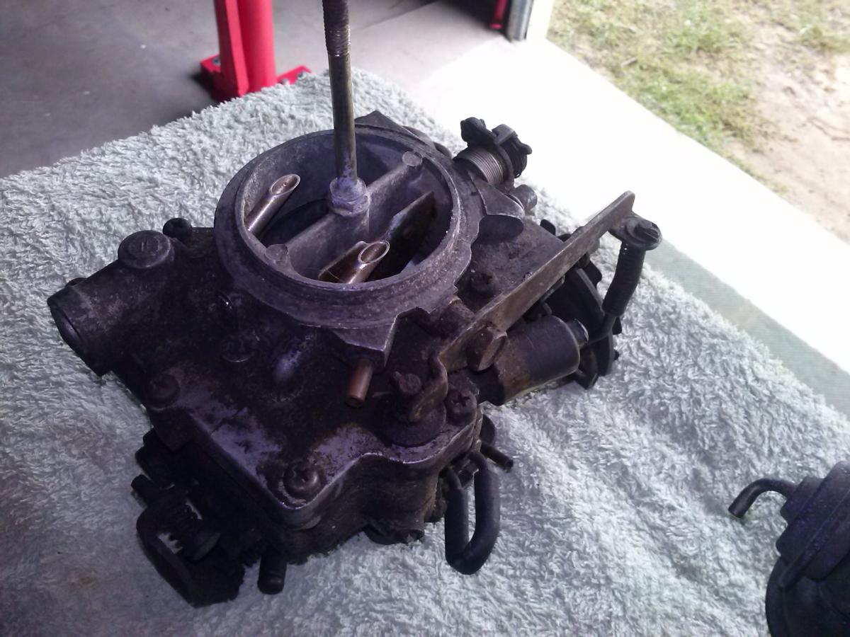

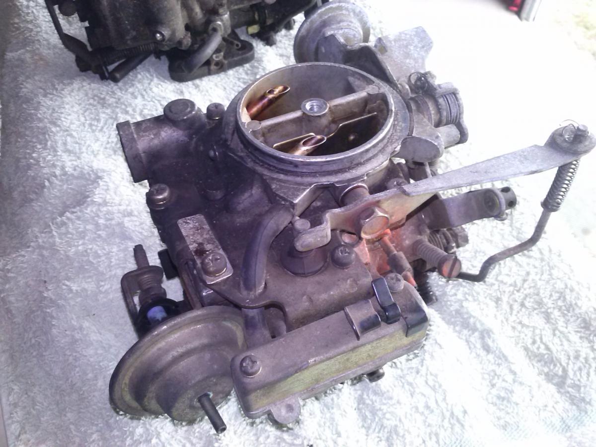

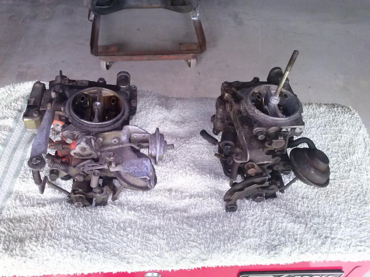

Okey doke,
Took some pictures, I have a vague idea when it comes to identifying stock carbs, (I usually unbolt stock and replace with weber's), in the first pic, the carb on the left (complete with orange paint) came off of a 5k purchased from an importers many moons ago, and the one on the right, I'm assuming its off of a ke70 4k, both appear to be 95% the same in appearance, Throat sizes from a glance look to be the same. I'm no expert when it comes to these.
