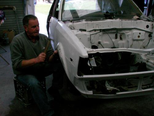

Thanks man, well it doesnt look that hard to do if you have the right tools but i wouldnt like to try it. The panel beater who did mine made it look easy, he only took about 2 hours to do all 4 guards. The rear ones you can't realy do much to because they are double panneled unless you cut a bit of the inner guard out, tap it to the shape you want then and reweld another bit back into it wich would take for ever, so i just got him to tap the square edge out, get rid of the line and put a nice curve on them instead of coming streight out. He tapped the back ones out to the same shape as the front ones but smaller because if you have a look the rear flair is smaller than the front ones to start with, but still looks sweet. The main thing is that you find someone who realy knows what they are doing with them other wise it could turn to shit real quick. :wink:

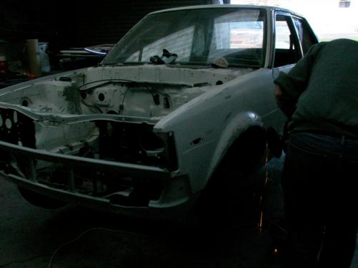

Dads mate who is a panel beater come around this weekend to flair the guards. All that has been done was the lip was folded up under the guard the the square edge has been folded out with the original guard shape and curved/shaped. They have now got a nice bubble on them :yes: the bits that have been welded in are where it was a bit shallow, so he filled it in with oxey welding and then ground around them ready for boging. engine bay is now also all sanded and ready for a coat of primer.

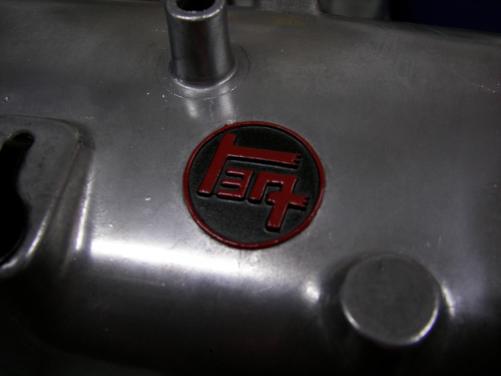

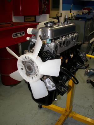

Just put a few more touches on the 4k that i rebuilt. Everything has been cleaned up inside and out, its had new rings, seals, bearings, timing kit, gaskets, oil filter, spark plugs and welsh plugs. As for cleaning it up and painting it, i got a small wire brush on a drill and went around and got any surface rust and corosion marks off the block, masked it up and hit it with a coat of gloss black VHT high heat engine enamel. The water pump, pulleys, sump and things like that where wire brushed to get any difficult marks off but other than that i used a bit of petrol and this high quality engine degreaser (that stings like a bitch if you get it on your hands) to clean them up, then wacked some primer on them, rubbed them with fine sand paper and sprayed them with that VHT paint and it came out awesome. All the bolts and bits and peices where soaked and cleaned in that kick ass degreaser to get them all nice and shiny again. The timing chain cover i painted with some alluminium paint and the rest of the alluminium stuff was cleaned and wire brushed lightly like the head and distributor but i polished the rocker cover with metal polish and a rag whitch took for ever :bash: but came out sweet :y:

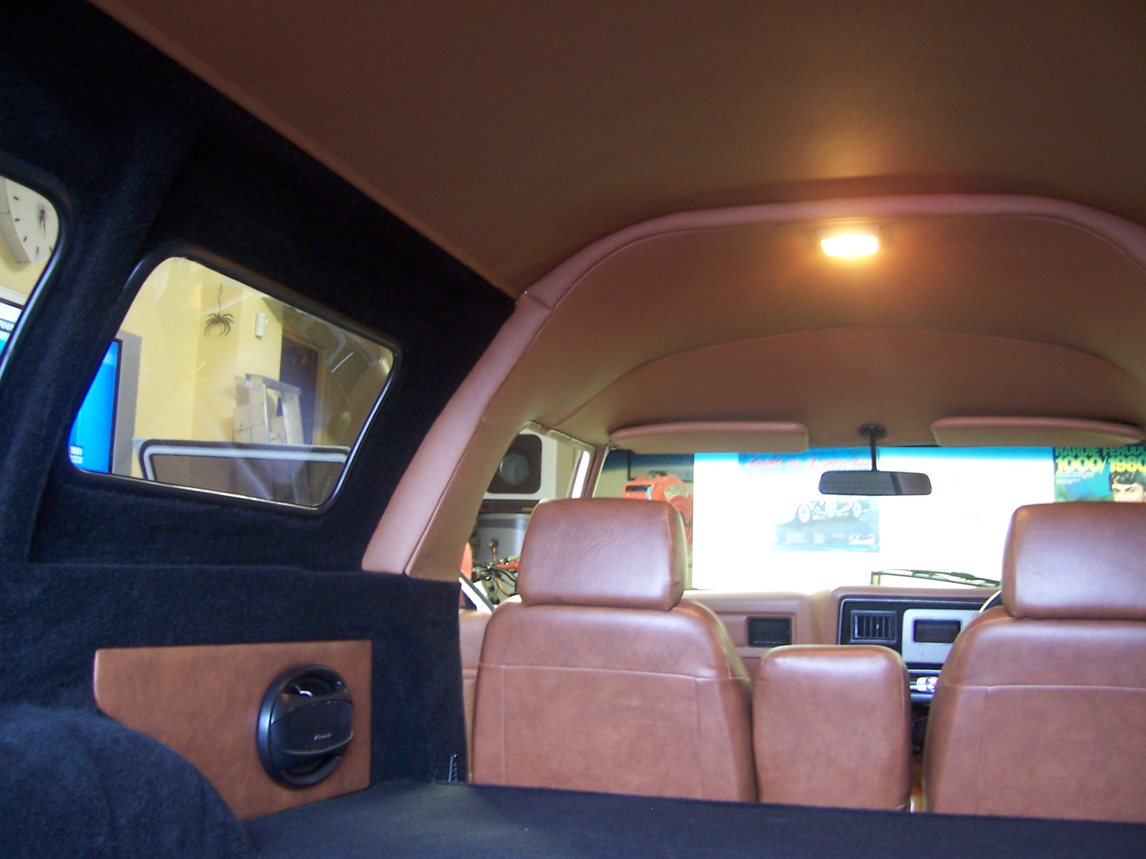

Actually it was pretty dirty, ecpacialy the interior. it had been sitting in a yard for a few years. i just spent hours and hours with a scrubbing brush and paint and i come up like this, i couildnt beleive it, the seats where like black with stains all over them and now there like new. Ile put some before and after photos of the interior up later on. Yeah i found him by chance on the web when i was looking for quad lights, he lives in the philippines and he had these reconditioned corolla parts, and some where new. the quadlights are used JDM parts that goes trough a refurb to restore it to its original state and the bumpers and indicators are OEM Toyota parts made in Japan. :wink:

Interior has come up so well after scrubing and katcher cleaning for what felt like a life time. Most of the plastics where pretty dirty and had a fair bit of grime on them so i got to work and scrubbed the plastics with degreaser and then armoralled them and they come up like new. The seats i gave a good hard scrub with detergant and then katcher cleaned them to get the stains out and wow :D
Cheers man, yeah its coming along nicley. Guards being flaired shortly, then it will be going in for paint :D
where i am with the build exept all the guards, doors have been repaired and rubbed along with the door frames ready for paint this week :dance:

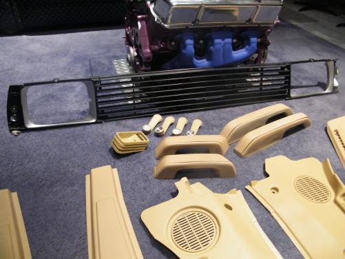

New quad light front and grill, chrome bumpers that i have orded from the Phillippines and my engine so far with my painted teq logo :wink:
No mods man, can't afford it at the moment. Just been rebuilt, new bearings and seals right through, full timing kit, rings and gaskets. chucking a 4AGE in it after a year or so
