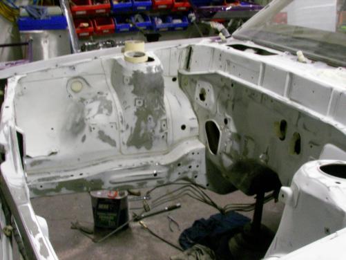

I pulled my front end out so we could paint the engine bay easier and get right underneth the rails. The whole front end had seen better days in the looks department so i decided to use my mates sand blaster to clean them up nicely. i then took them home put some primer on them a gave them a coat of gloss black which looks overrated :y: Also decided to do a custom coil :P and clean up my dash

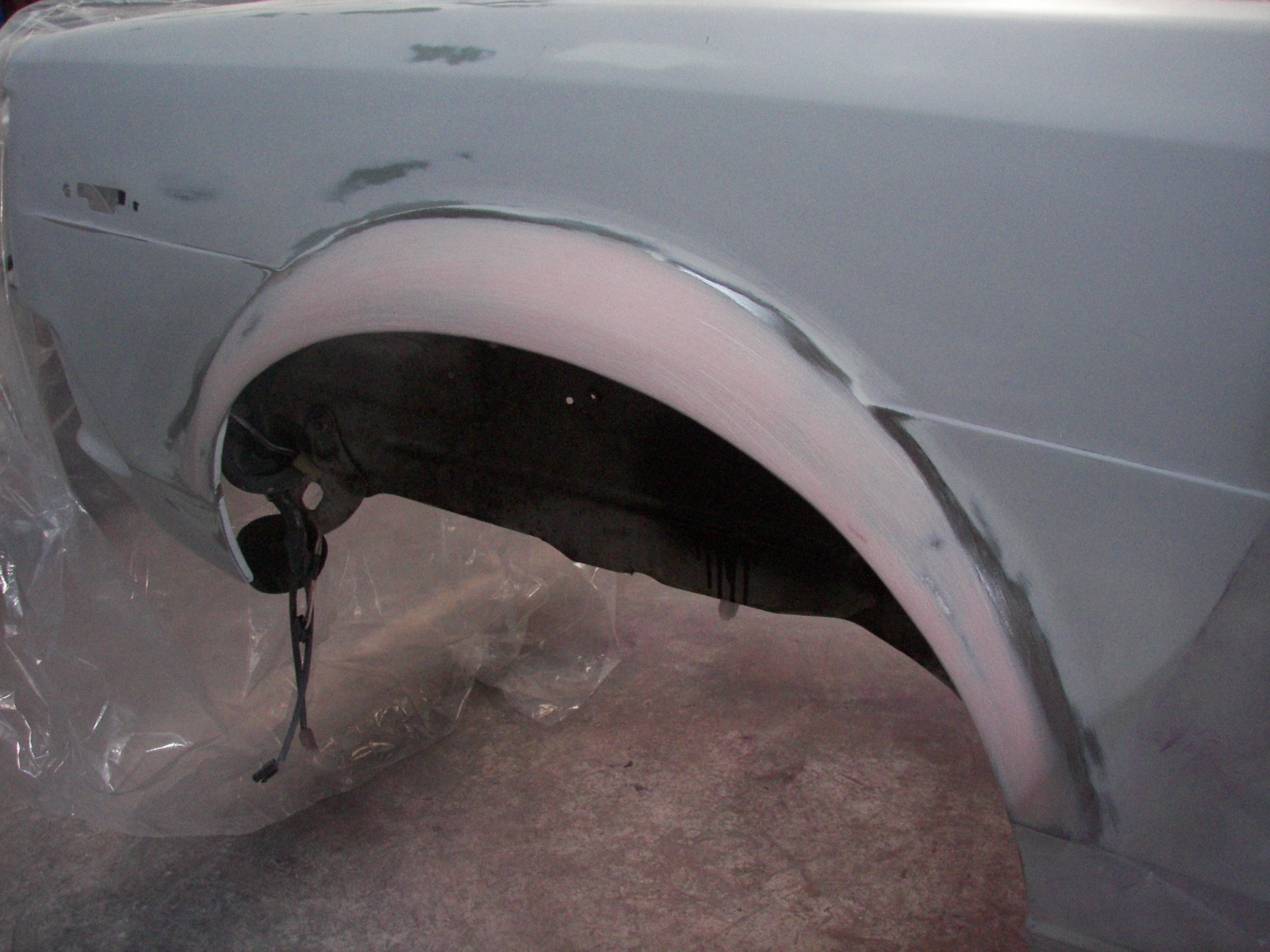

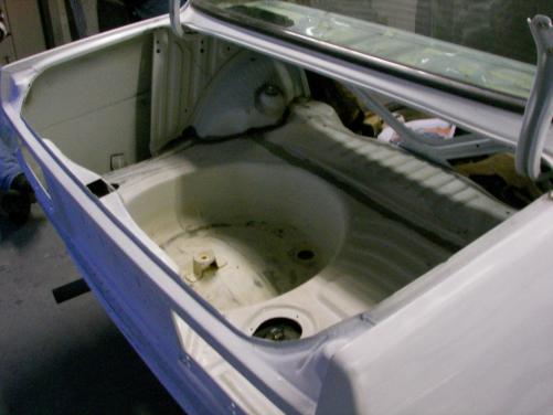

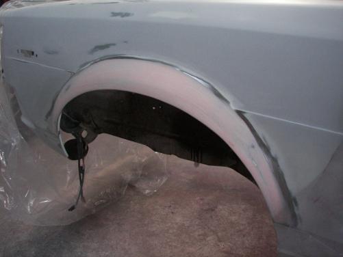

Got to work on the boot the other day. I scraped all the old shitty seam sealer off and resealed it all nicely. I also took all the vinyl of the insides of the rear guards and removed all of the fluff that it left behinde which took a while and got it all sanded down ready for primer. I then got to work with the spray gun for the first time putting on a coat of primer on after dad showing me how to do it. After that dad then put a coat of semi gloss black on it just to tidy it up before it all gets boxed in with some mdf covered with carpet for the floor and vinyl on the sides :y: The guards also had some more work done to them. finished of shaping them then bogged, still have to have a few bits and peices done to them but very happy with them :wink:

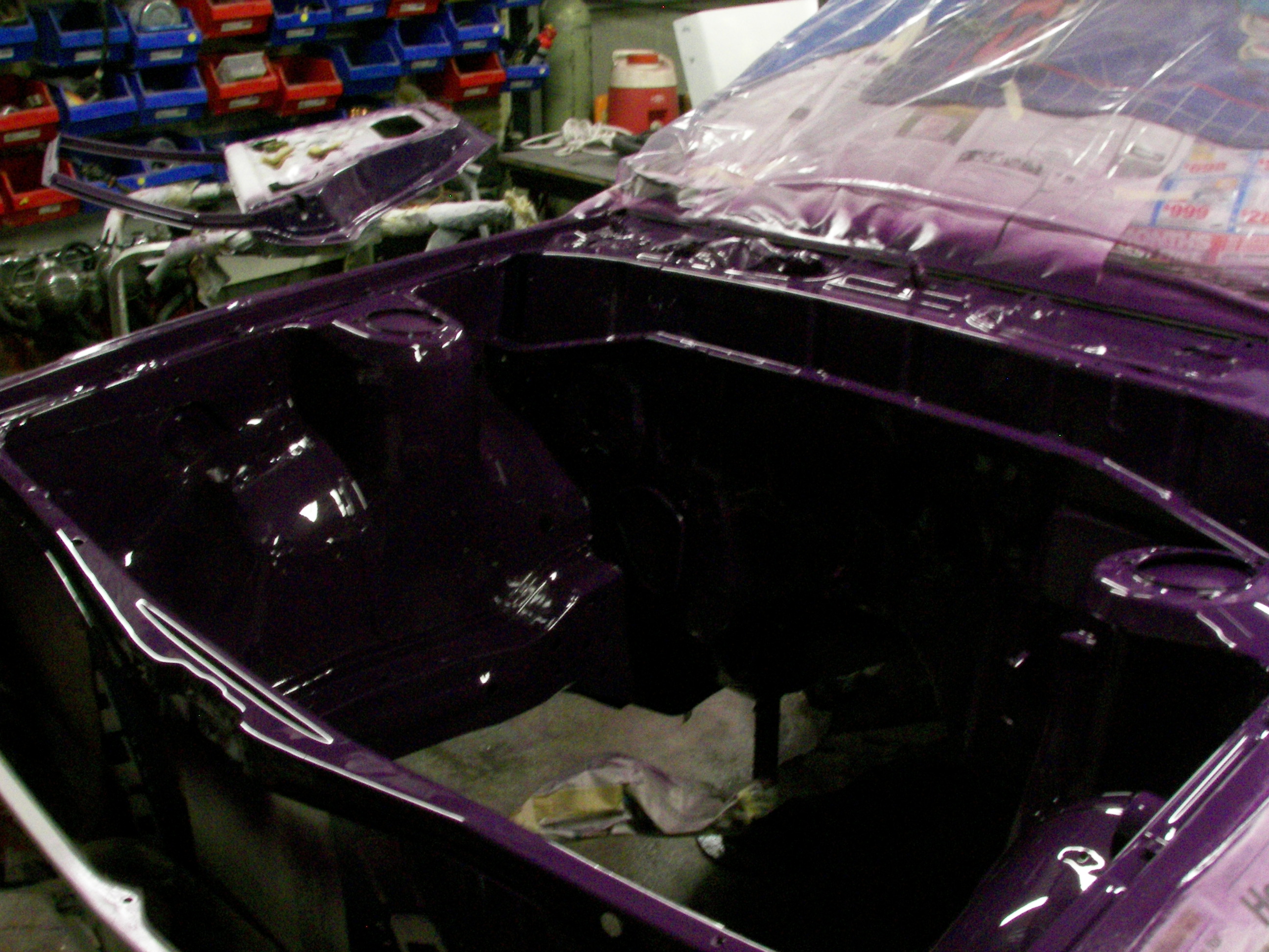

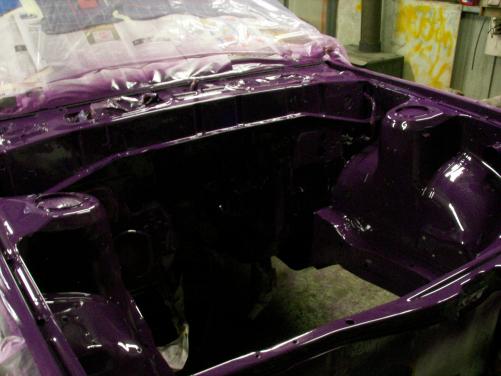

The primer went on in the engine bay today, then sanded and hit with a few coats of purple in our makeshift oven. Looking shmicko thanks to Dad, verry happy with the finish :yes:

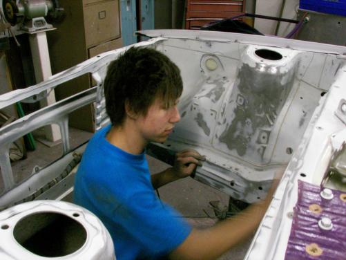

Got to work scraping of all the old crappy sealer that toyota have just slapped on :no2: ready to sand, reseal and paint, not that your going to see it because it will all be boxed in but why not do a propper job while its all apart :y:

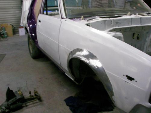

Went over to work on it today after school to give her a few finishing touches before she's painted and put a wheel under it to see what it would look like :yes:
