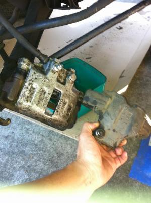

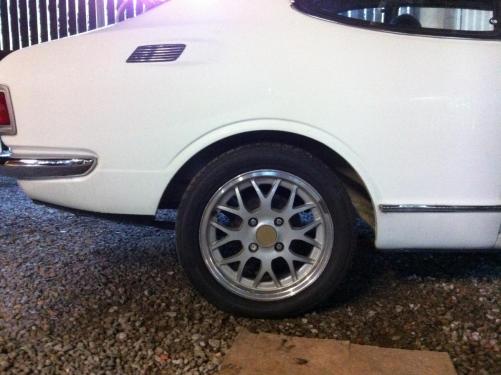

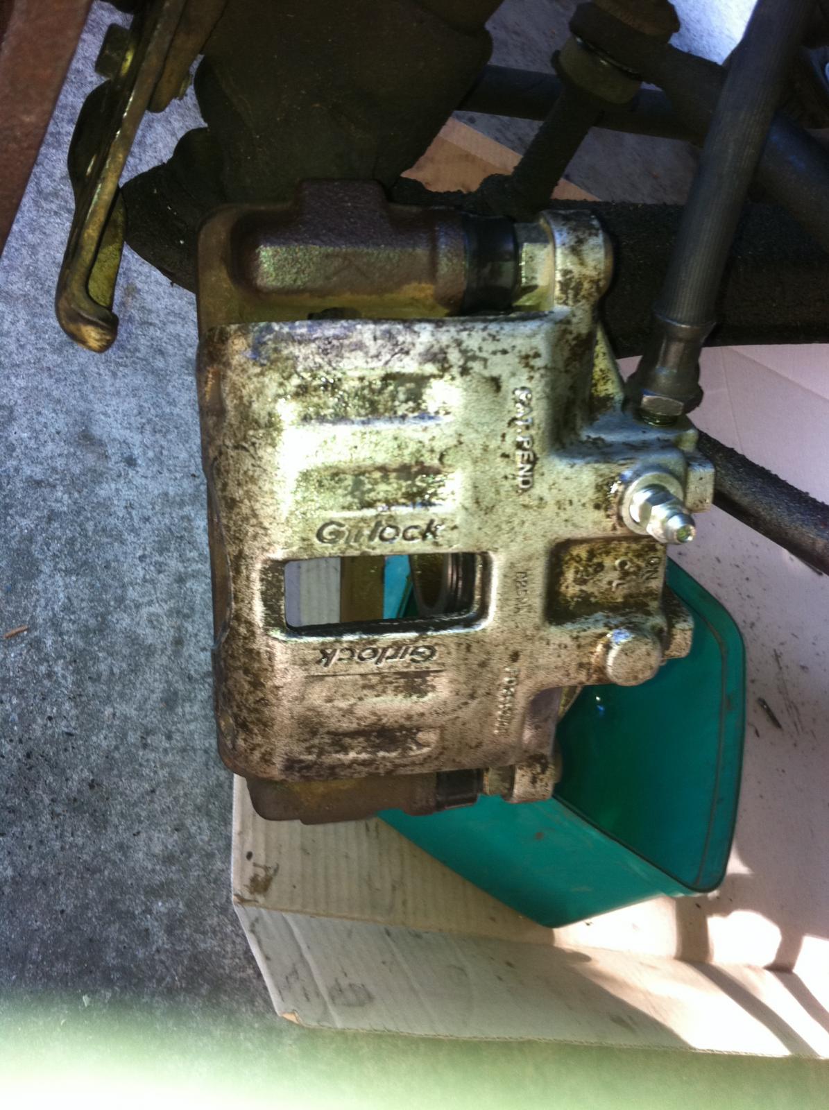

It was a week or so i was driving around with 12inch steelies on the front and 15inch rims on the back, but finally got time with my father in law(LARRY) to help me with the front pcd conversion. i asked him how long do u think it will take us??? maybe 2-3 hrs. Ok i said to him ill come at 9am so what turned out to be 3 hrs max turned into a 9am to 4:30pm finish. LOL The front conversion was a bit of work. had to drill the strut plate and retap new holes so the backing plate would screw in, the new drill bit went blunt after 3 holes so out can the grinder to sharpen the bit. bit of rust we sprayed with some penetrol. new rotors and calipers, the new calipers are WAY bigger then the stock ke25's So got both side fitted and brakes blead!!! and woohoo new front rims. only thing is now it looks like a 4wheel drive up front sits so high.. Gave the car a cut and polish the next day by hand took me 4.5hrs. Also used a razor and scraped off the white lines on the rear windscreen they were all half fallen off. NEXT step to lower the front which we will be doing on anzac day since its a public holiday All up to date with the posts will keep it up to day from now on :) Thanks all
So they where some of the older pics before i started doing some stuff to the outside of the car. I was wanting to upgrade the rims and brakes. so did some reading and decided to change the pcd of my wheels from 110 to 114.3. I found a jap ke30 diff drum to drum thanks Dave(noah) and used the rear axles. they needed to be shortened 5mm each side so i took them down to my father inlaws mate who is a mechanic and i used his drop saw, was supprised how fast it cut. I then scored some ke70 front hubs backing plates and 1 caliper from corolla Andy. Took me a few days to source another caliper but i ended up going to the salibury wreckers and took one of a ke70 sitting in the yard. My father in law got me a new rubber kit for the calipers for $50 and then showed me what to do to clean and revive them :) so cleaned the calipers put them back together with a great deal of fustration the dam rubber wouldnt sit straigh and the piston was so dam hard to push all the way in.. but got there in the end, saved myself $120 each caliper which i was qouted. I took the front hubs down to my father in laws mates workshop and he machine the rotors and sold me some new brake pads which where holden commodore rear pads for mates rates :) The first step we did was to take the rear axles my the ke25 then fit the new shortened ke30 axles. Put on some new RIMS i scored from Joel(pmp16) these things sit perfect the offset is just right 15inch hyperfangs
