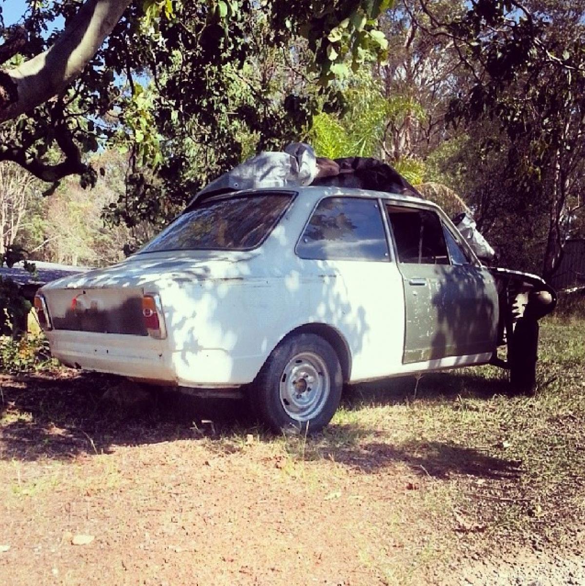

  3. Have a few hours to spend on the 11 over the long weekend. After finding even more rust, I've figured its going to be easier using the rolling shell I bought for parts as the base for the new project and put everything from the blue one into it. As it's 90% stripping already I'm going to start stripping the rear guards and get the bodywork underway :) More pics to come

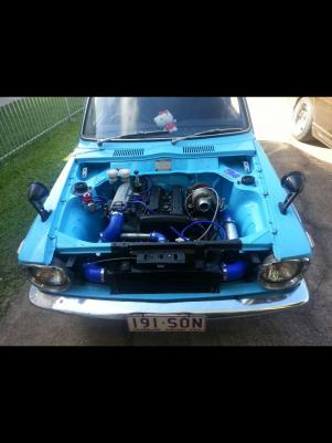

  4. Nah man it looked straight as. Not to worry though, it'll all be gone soon. It was alright hey. It was only running 5psi and a run in tune so I never really got to push it. Plans are to freshen up the motor. Bigger turbo (gt3076r) new ecu, and hilux diff. I want 250+ kW

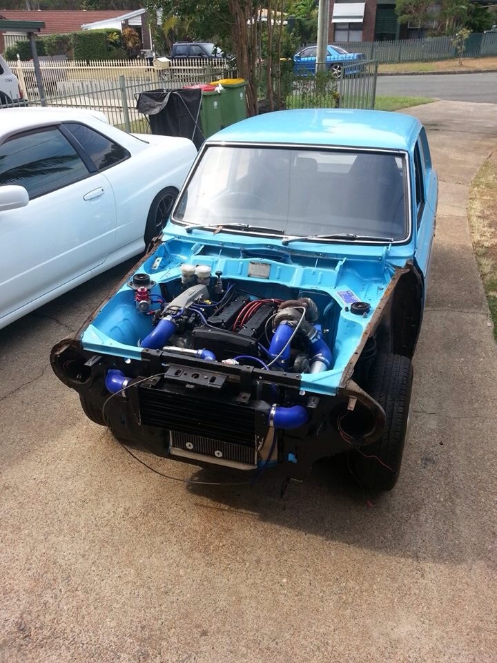

  5. I had it up for sale a while back but decided to keep it...

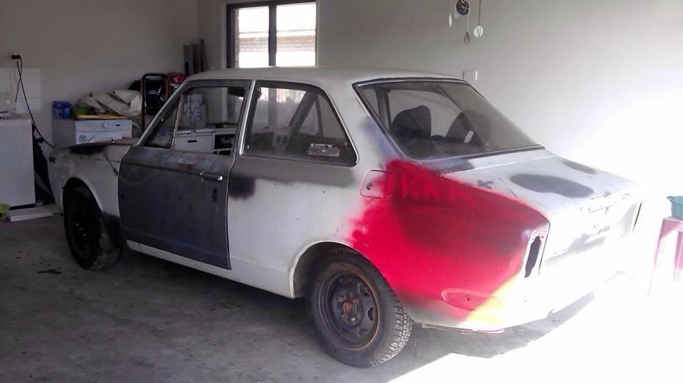

  6. A little more progress today. As I still live at home with the parents and were about to move house, I'm unable to strip the car completely bare just yet. In the mean time I've been stripping panels off the car and taking them to bare metal to see what I'm working with. Let's just say, BOG GALORE!!!! Whoever painted this car before I owned it took the easy way out and bogged all the rust. I'll post some pictures when I resume the bog clear out!

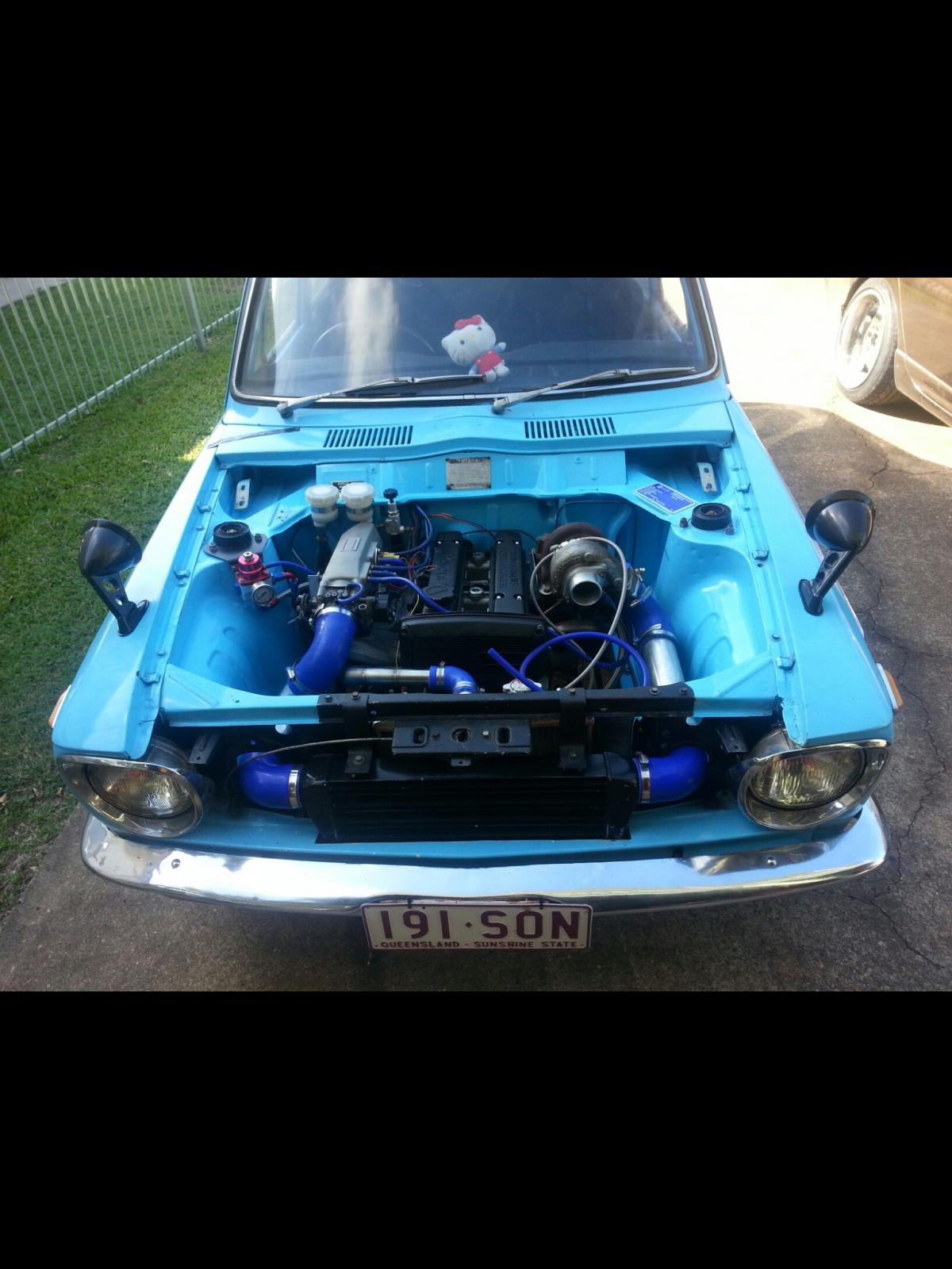

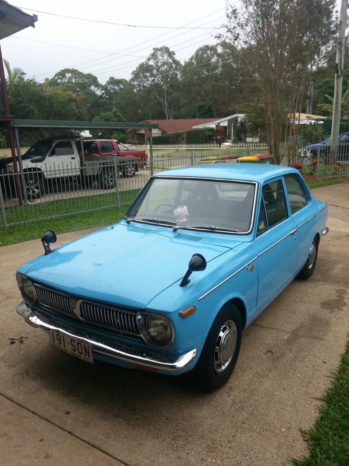

  8. It's all mod plated man:) Going to speak to an engineer to see how far I can go when it comes to motor etc I'll post more photos tonight.
  9. I bought this ke11 of a fellow rollaclub member late 2012. I had all the hard stuff done conversion wise so I thought why not! Drove it as a daily for about 3 months which was awesome, then after a few problems it's now been off the road for about a year. So I'm not going to strip her bit buy bit and rebuild it to get it to where I'm happy. Currently setup it's got; 4agte T25g s13 turbo Ross forged pistons Gze rods Acl bearings Arp head studs and main studs Plans are; Make body and interior look dead stock Body back to bare metal, repair rust Rebuild motor Cams and valve train Bigger turbo Bigger injectors New ecu Hilux diff Brakes Coilovers It's a long road ahead! Cheers Matt
