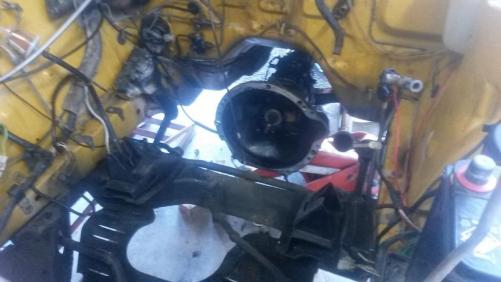

  1. It's time for a small update, over the weekend we took the old 3k out and put the 5k in as well as the k50 five speed box. We started at around 12pm and had everything in at around 8pm. It took a few hours the next morning to sort out some ignition timing issues. The TDC marking on the harmonic balancer was incorrect (someone may have used the wrong balancer previously) so we made our own TDC and went from there. My friends and I hadn't really had much experience with ignition timing before so we learn't along the way. This is the motor before we took it out. The motor out of the car The 5k and 5speed in the car. We attached the gearbox to the motor before we put it in.
