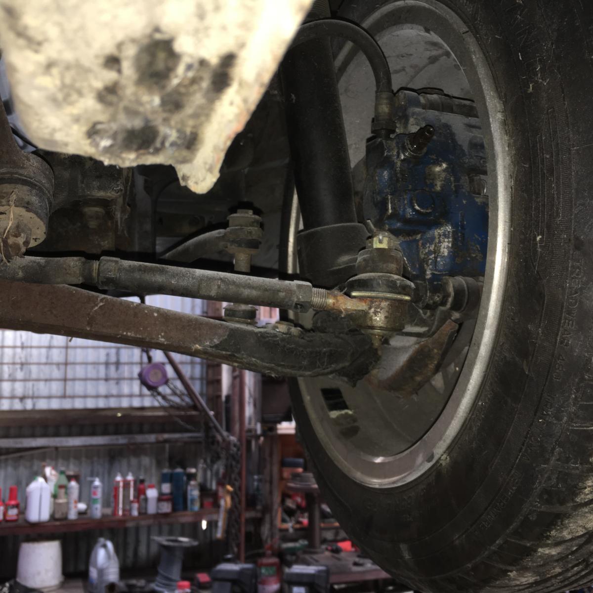

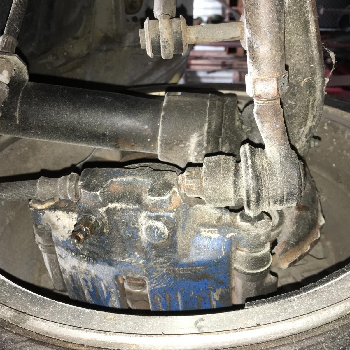

  6. Ohhh sorry, that's more clear and your first message means the same thing. Sorry for the confusion, I'm learning about this as I go. Thanks a lot for your patience and help Taz!
  7. Hey Taz, just checked them out, they're symmetrical in design, swapping them from left to right doesn't change how far they protrude. It also means the bleed nipple gets flipped to the bottom of the piston housing. Does the ke30 or ke55 steering arm fit the ke20?
  8. Here's exactly what it looks like. The wiki makes it out to be a straight swap, I can't understand why mine's different. They're apparently ke30 rotors and calipers, maybe the struts are different now from the suspension upgrade.
  9. The control arm is hitting the back of the caliper; the caliper assembly/cylinder body. I think that describes it? Does that sound correct?
