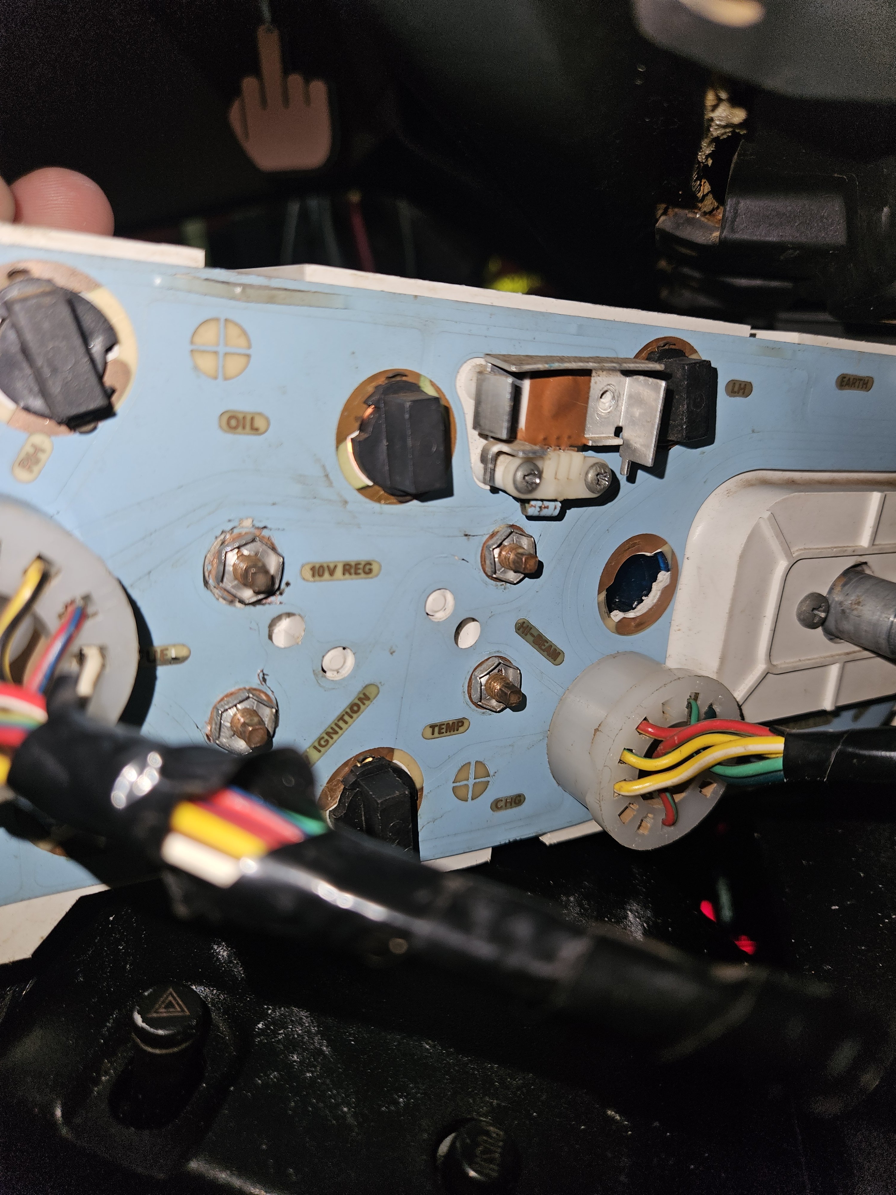

  12. Sorry for the very late reply banjo. Jave had many other things to fix so i forgot about it. But i Have pulled the dash apart multiple times and it doesnt seem discoloured or broken at all. I'm thinking it could also be the blue sheet on the cluster as it only gets voltage when the regulator is in just the right spot, as it has to be touching it just right for it to work. Also I have another question fkr you. Do you know whether between having a 5 speed gearbox, 4 speed speedo cable, and 3 speed auto cluster whether that may put the speedo out over 60kmh. I'm asking this as my speedo is out but only over 60. 100kmh by speedo is about 85kmh and 120kmh by speedo is about 100kmh. Cheers 79rolla

  14. With the battery connected and car running it charging at 13.8v with both terminals off battery while running its about 16v. If i can't fix it soon I'm going to just get an after market one and find a place to mount it. Cheers 79rolla
