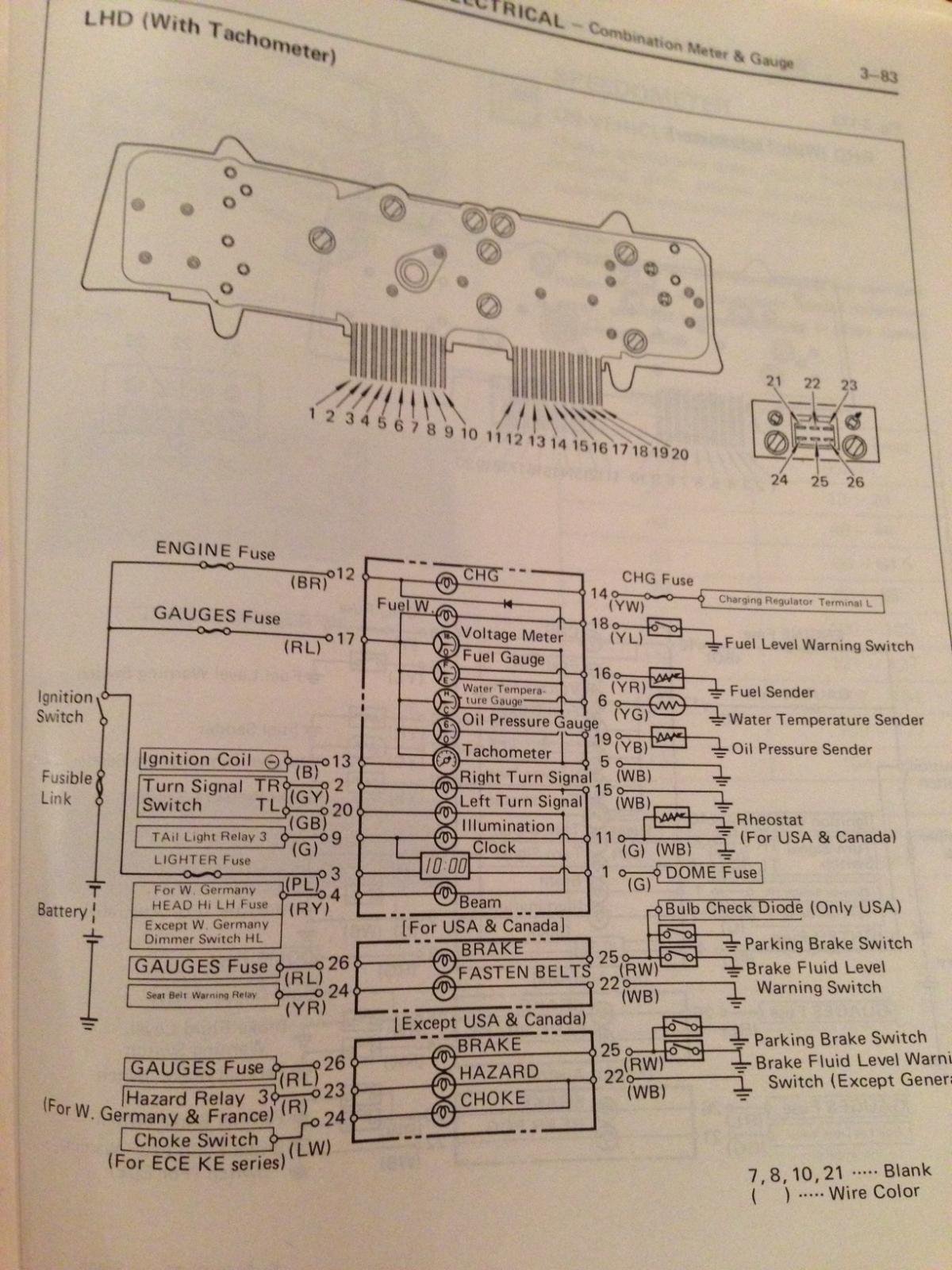

This is a KE70 cluster diagram, I don't know how different it is.

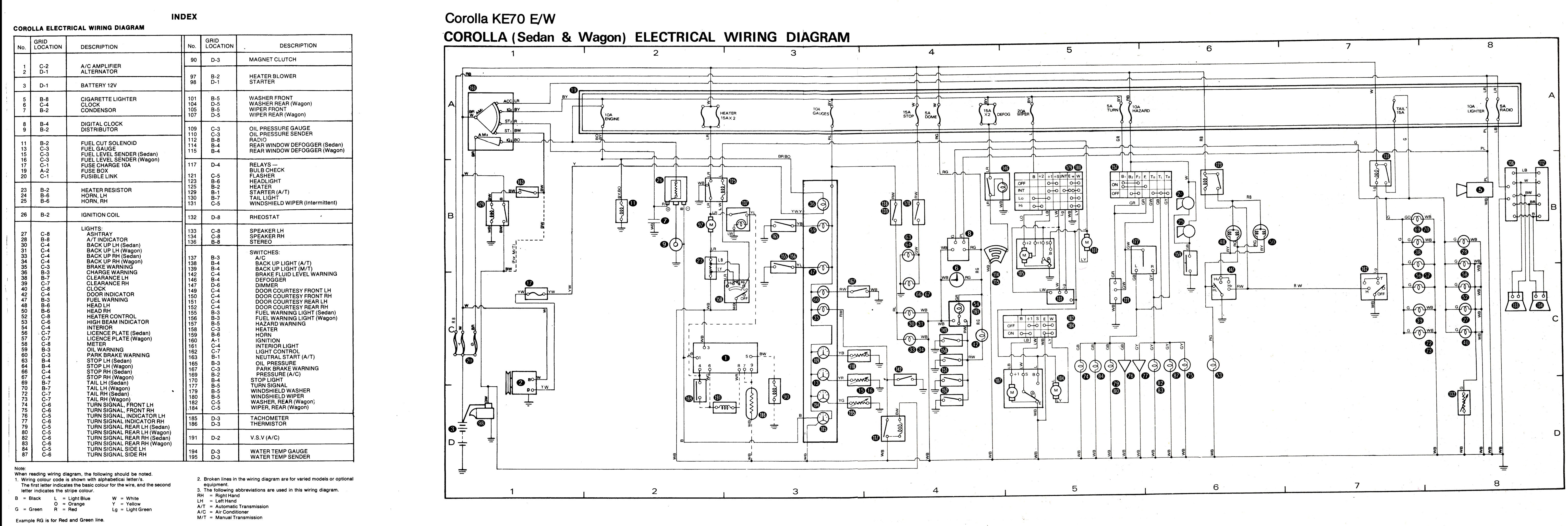

..and the whole diagram for a KE70.  There must be KE55 wiring diagrams somewhere on the net, but most web pages saying they have diagrams are pretty dodgy for some reason.

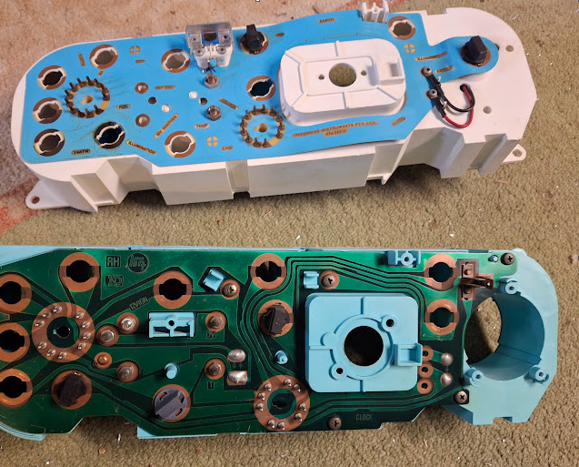

This is what the back of my cluster looks like. 1 other question for you banjo, would you know why it only sometimes gets power?

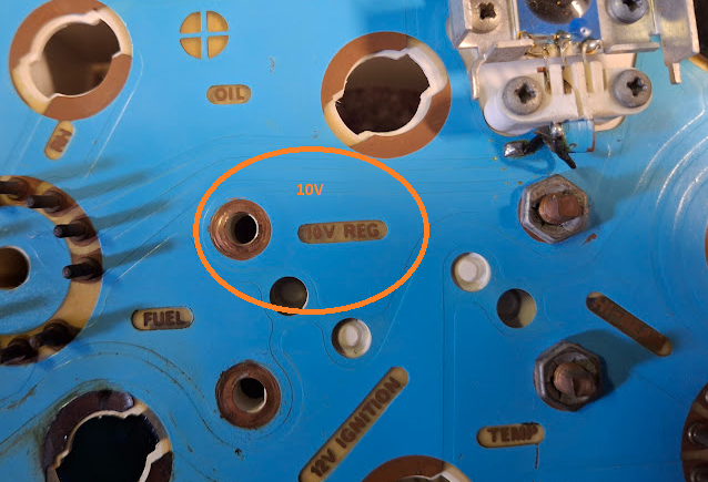

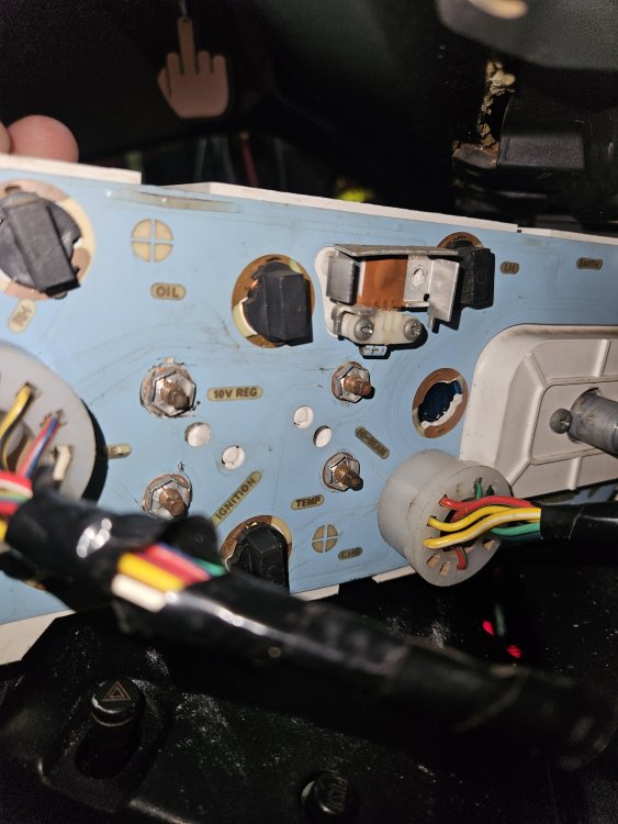

Good Morning !  Your picture indicates that the regulator in your particular dash unit, is a +10 volt model.  The circuit for your fuel guage is very, very simple.  When You turn on the ignition, the car batteries +12V is fed to the voltage regulator, which converts its output voltage to +10 volts. The reason there is a lower voltage, so that the fuel gauge's accuracy, is not affected by the +12V supply bouncing around, as it does. The first thing You should be measuring is not the resistance of the sender unit, in the fuel tank; but whether You have +10V at the so detailed terminal, on the back of the dash assembly. As I noted previously; it is the voltage regulators that are prone to fail, in these dashes. Turn the ignition on, & using your multimeter on a DC voltage range higher than 10 volts, measure the voltage between the terminal marked 10V, & chassis ground.  There is a good chance the regulator has failed; & as result the fuel gauge will not read; even if it's resistance varies over the correct range. If you Google this subject, you'll find a number of articles & videos, regarding this issue.  Here is one that may assist You.

P.S.  Unfortunately, that circuit that Altezzaclub posted does not indicate a +7 to +10V regulator at all. It depicts all the guages being connected to +12V battery supply, which is a bit strange.  Maybe it's a very early circuit. However, your photo of the rear of your dashboard; indicates it should have a +10v regulator therein.
