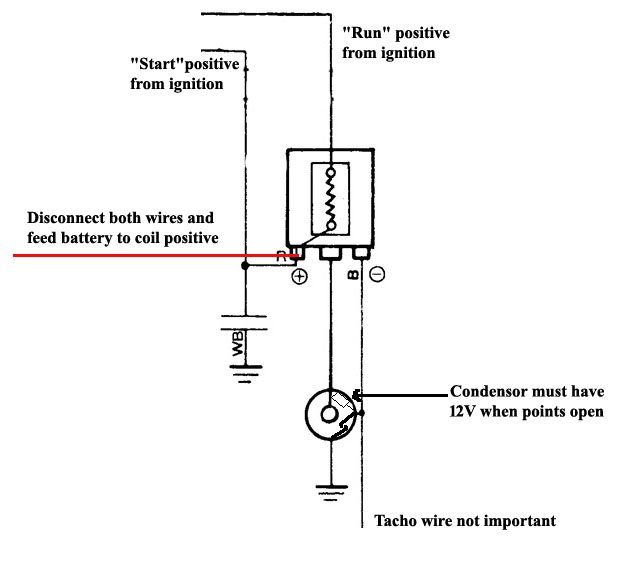

So 12volts goes from the key to the positive side of the coil, through the coil, out the negative side and off to the distributor. It joins to the points and the condensor, and power flows when the points are closed and it can get to earth. Does that sound right?
This diagram is for a KE70 with the 9V coil and a ballast resistor, I don't know if the KE55 had that.
I would check for 12V at the disconnected ignition-coil +ve wire, then put it back on and check for power at the points when they are open. If the first doesn't give you power its a wiring problem, and if there's power at the coil +ve but not the points the problem has to be in between.
You will only read +12v at the points when they are open, once points close you won't get a voltage reading.  However to get the car to spark you will need the points opening and closing to earth, so make sure your +12v at the open points vanishes when they close. Alternately, if you have the ignition on and the points open, they should spark when you short across them with a screwdriver.
