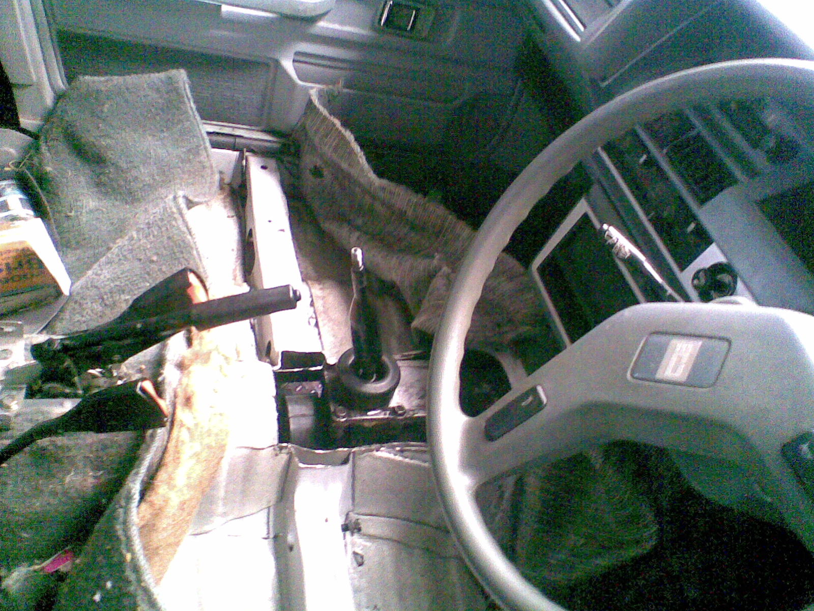

Thanks for the info mate, I was expecting the manual shifter would sit a whole lot further back than that. I've attached a pic of where mine was midway through the build with a sr20 box/engine. Do you think an RB20/25 engine/box would be futher back or about the same? I ended up turning my shifter around aswell and where it currently sits is no problem at all but any futher back and it will probably foul on the handbrake.

Any pics of the firewall before the engine went in? I'm considering going from a sr20 to a rb20/25 but I'm not sure where the shifter will sit.. Any ideas? Did you dummy fit a manual box by any chance haha?

Na I'm still using the ke70 crossmember with the old mounts grinded off and new ones made up from scratch. But I have heard of people using a s13/180sx crossmember aswell. Tunnel needed a bit of bashing but if I was to do this again I would cut and extend the firewall/tunnel to make it easier for gearbox/clutch changes. The gearstick does sit a bit back from where it used to be but I reversed the shifter which gives it a bit more room. Only just clears the handbrake where it's at now but it's no worry to me really. Any more questions feel free to ask :dance:
