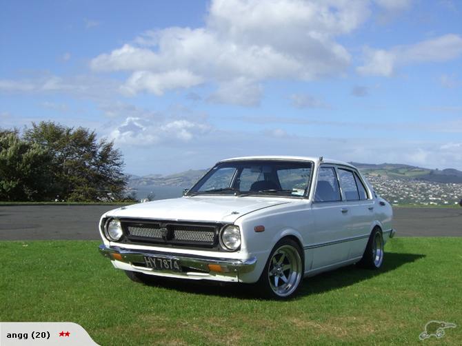

  8. I had a mate that put some silver mesh in the grille i actually liked it and I'm not usually into things like that but each to their own i suppose.

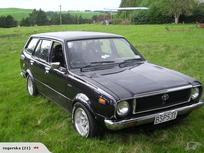

  9. it was just my run around for a couple months couldn't drive it any further than about 30km as it had a huge overheating issue blown headgasket. Kept driving it hard though and stole the eagers off it and sold it for what i paid for it haha. Anyway sorry Finn.KE30 for getting off topic heres some more black rollas.

  12. They were highly polished up 13x7, 0 offset performance wheels spitfire lookalikes i think. Stuck out of the gaurds way too far with the eagers on them though And also on my old KE70. Hideous car but overrated wheels haha.

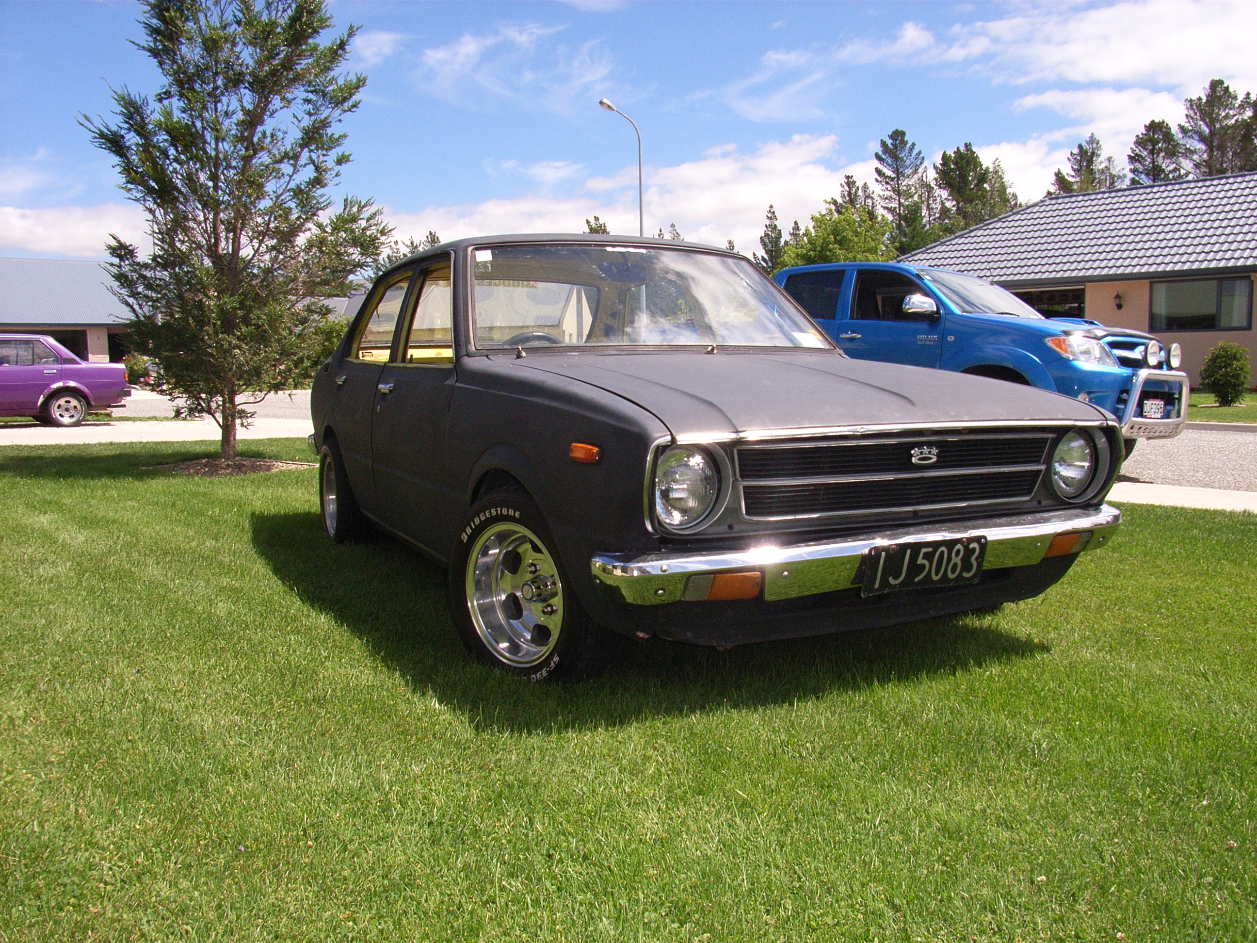

  13. Here's mine matte black before i stripped it
