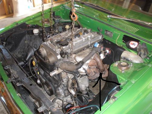

sat the motor in today just to see what i had to do with the crossmember etc it all ligns up overrated just have to cut the existing mounts of the cross member and use the mounts that are on the engine. The only problem i have at this stage is the swaybar is to close to the sump so will either have to find a different swaybar or maybe get one made. Just sorted out a bellhousing tonight its a 1S bellhousing and i am now going to use a W57 gearbox as apparently the ratios work better with the beams.
seems to be something missing here, good looking car mate
haha yea they wont be staying i work in an exhaust shop so I'm going to build up sum custom stainless ones
