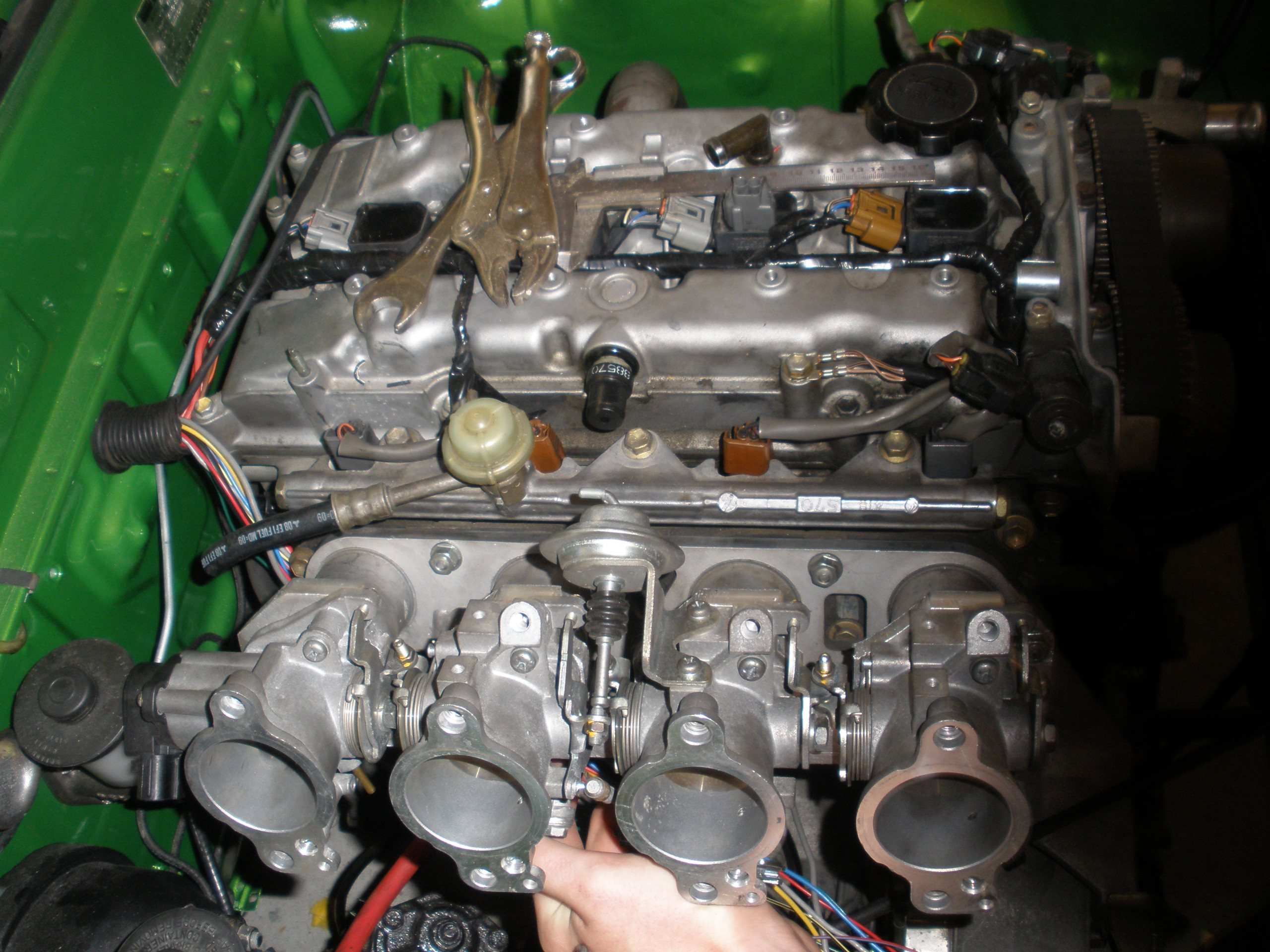

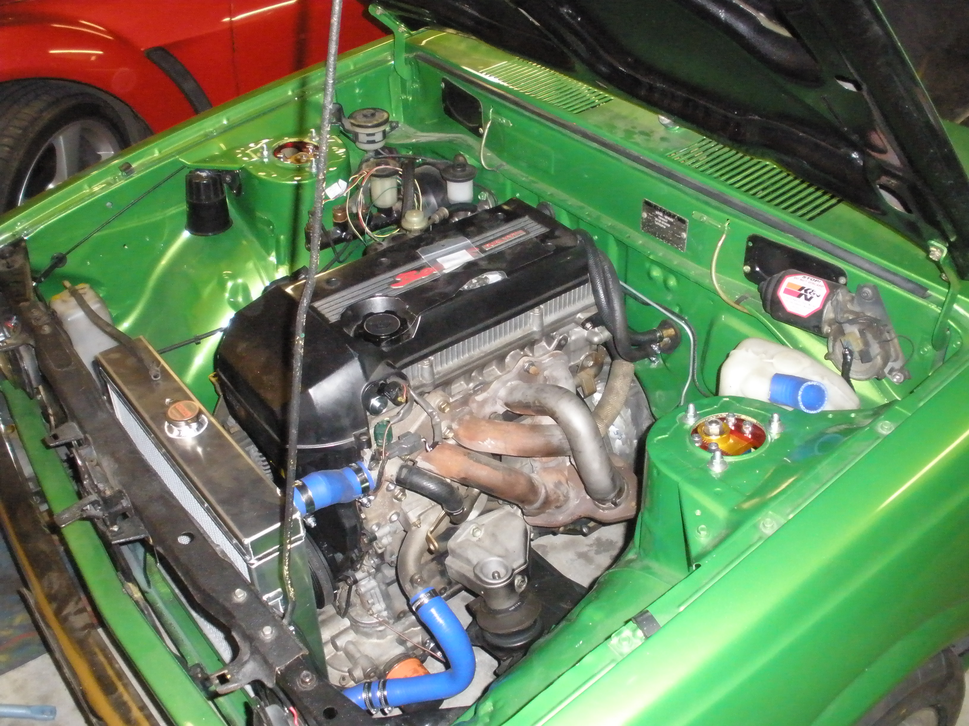

Ok bit of an update. Motor hasnt had much work done I'm still pissing around with the blacktop throttle bodies making a manifold plate and welding it onto the factory runners etc. I am still waiting on my axles to be done by the engineers should have them by tomorrow hopefully, have made up my front strut setup with shortened

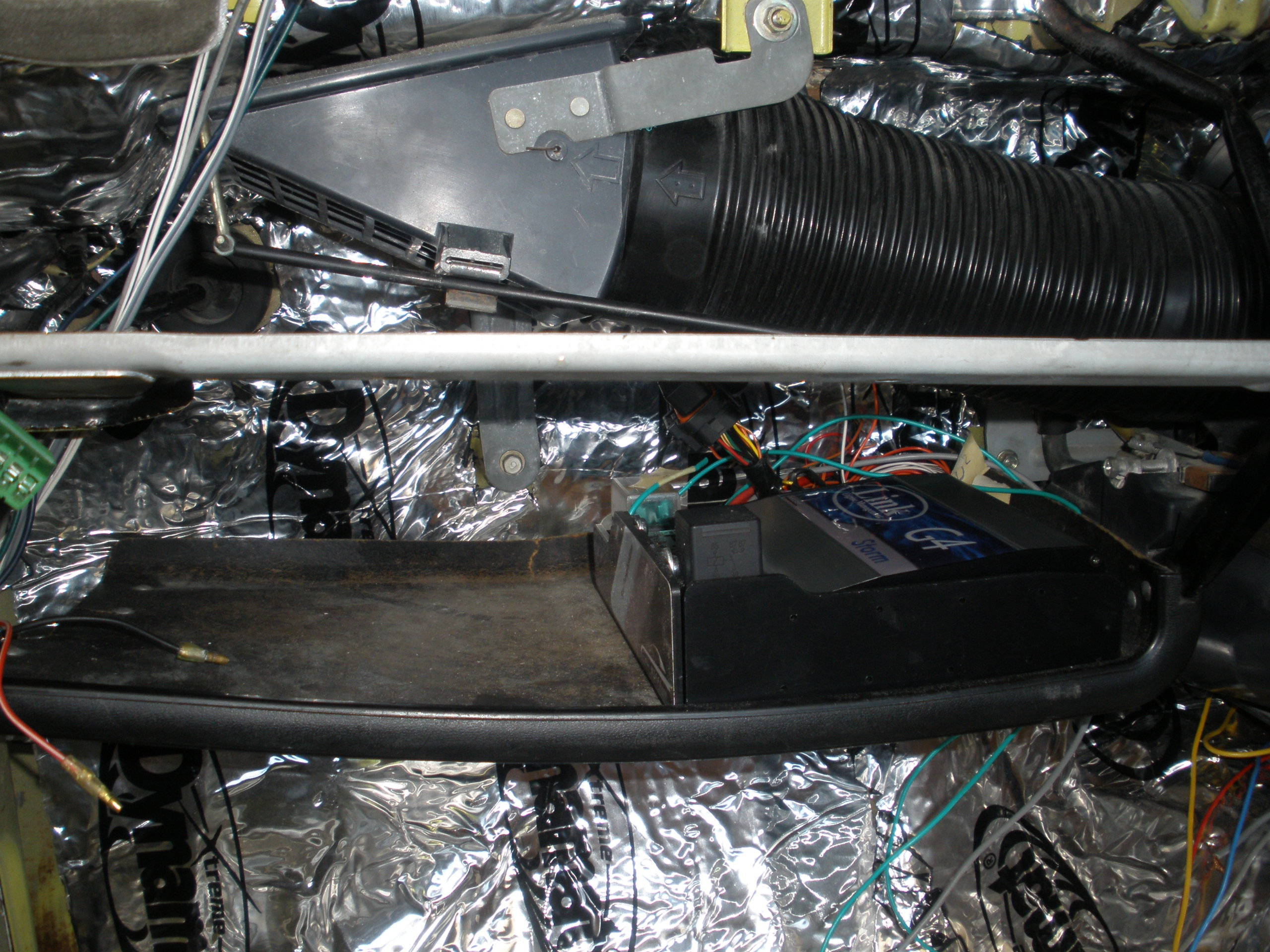

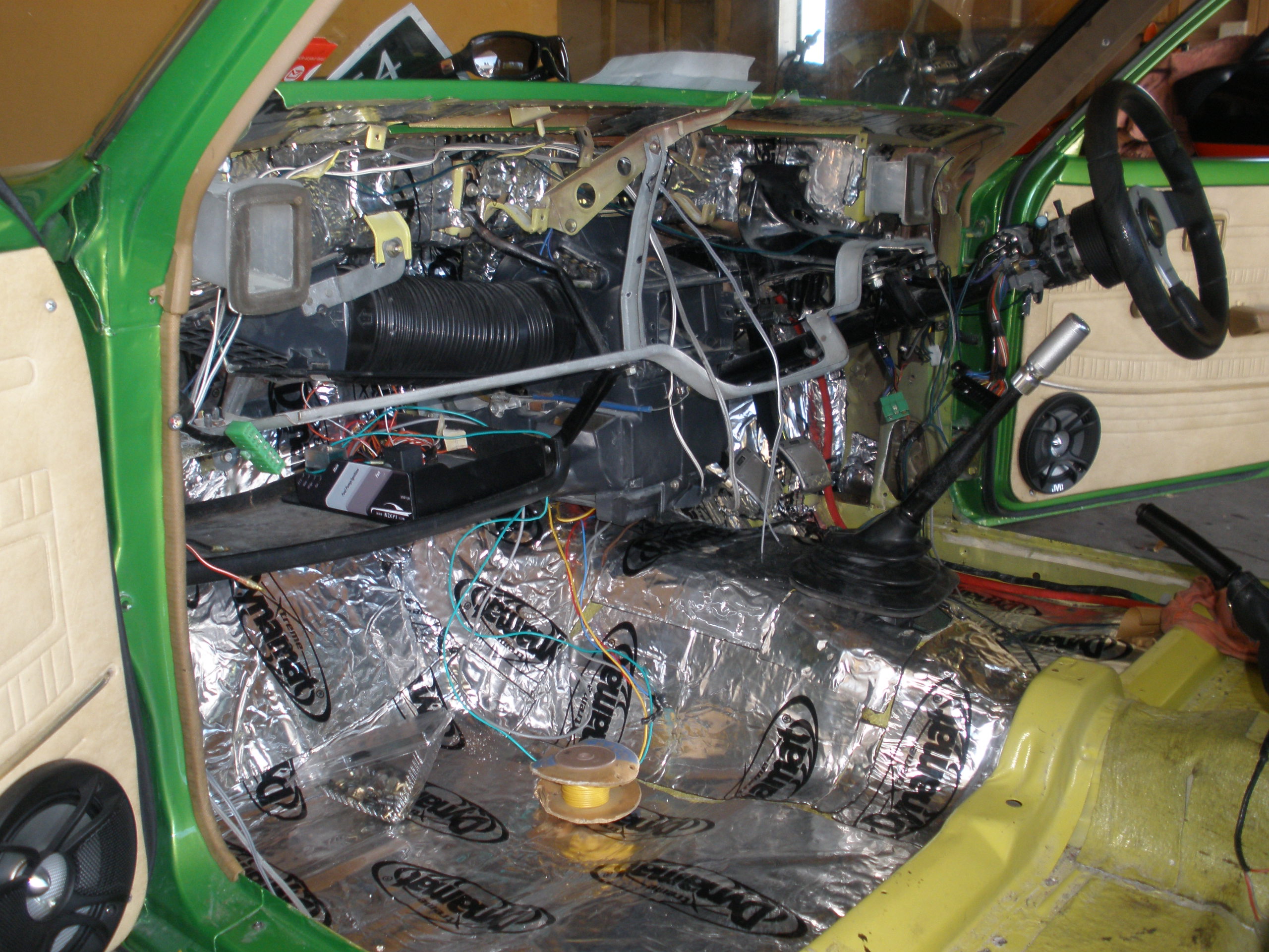

AE86 strut cases and AE92 top threads welded on to take the AE92 bilstein inserts with adjustable sleeves and springs. Have gone for 6kg/mm springs in the front hope this is close enough. I have dynamatted the firewall and front floor to reduce road/engine noise a bit as it was terrible before, Just in the process of wiring up headlights etc. and that will be the wiring completed.

All the wiring underbonnet and behind dash is all sorted now, everything works suprisingly. All i need now is the radiator and drop tank, sent away a request today for a qoute for a custom alloy radiator should hear back tomorrow. and drop tank and intank pump will be made and fitted once the diff is in the car.

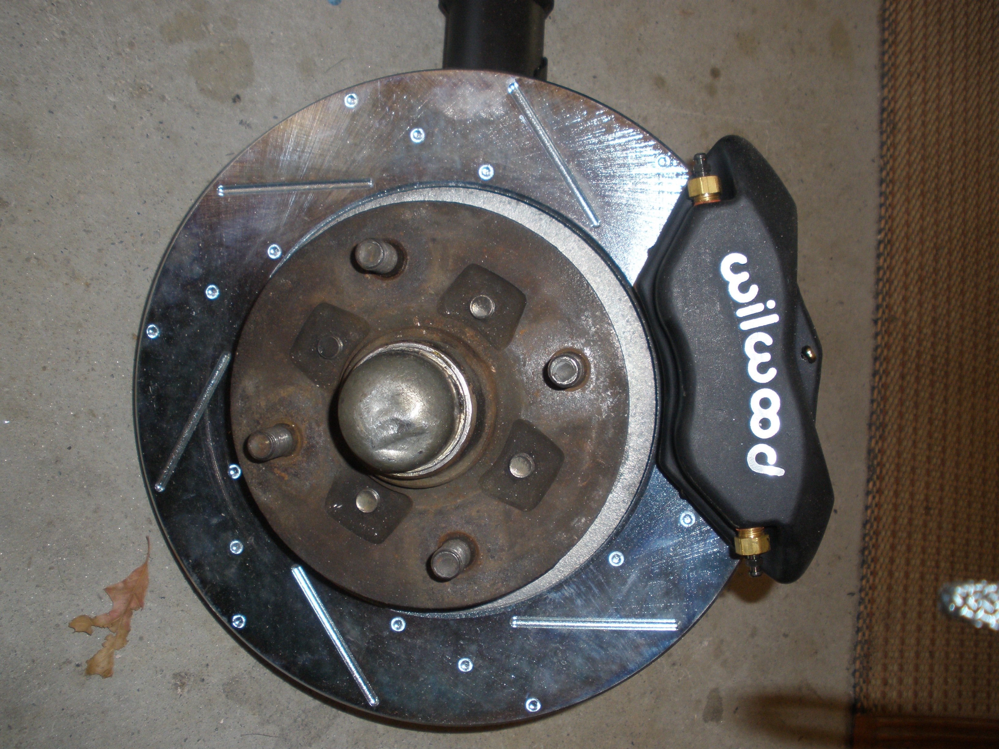

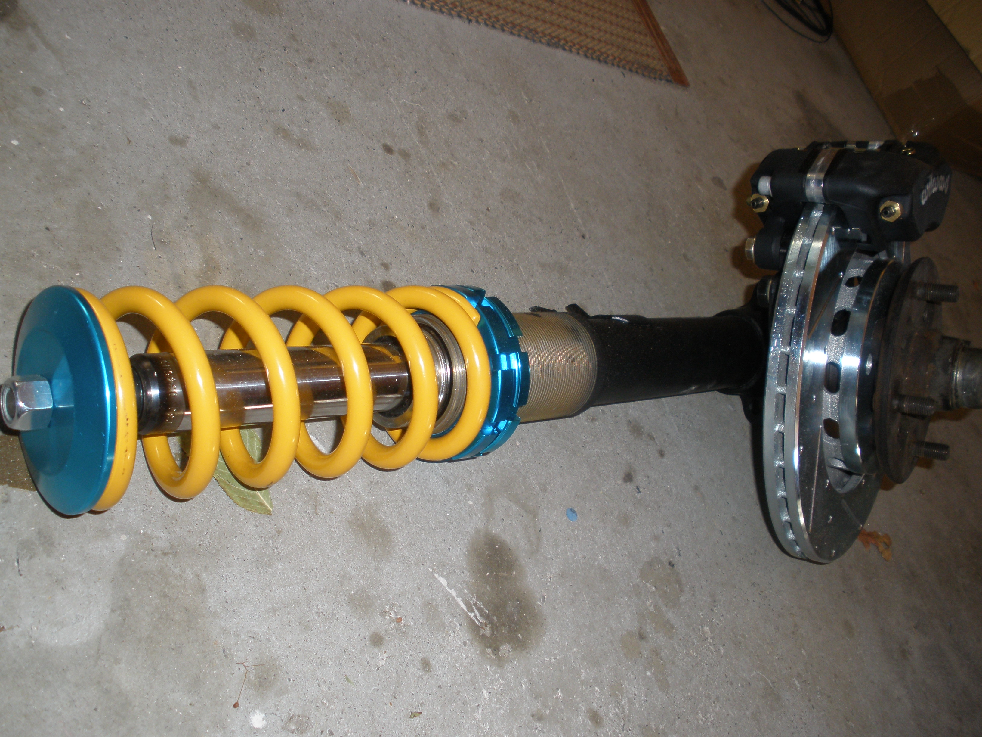

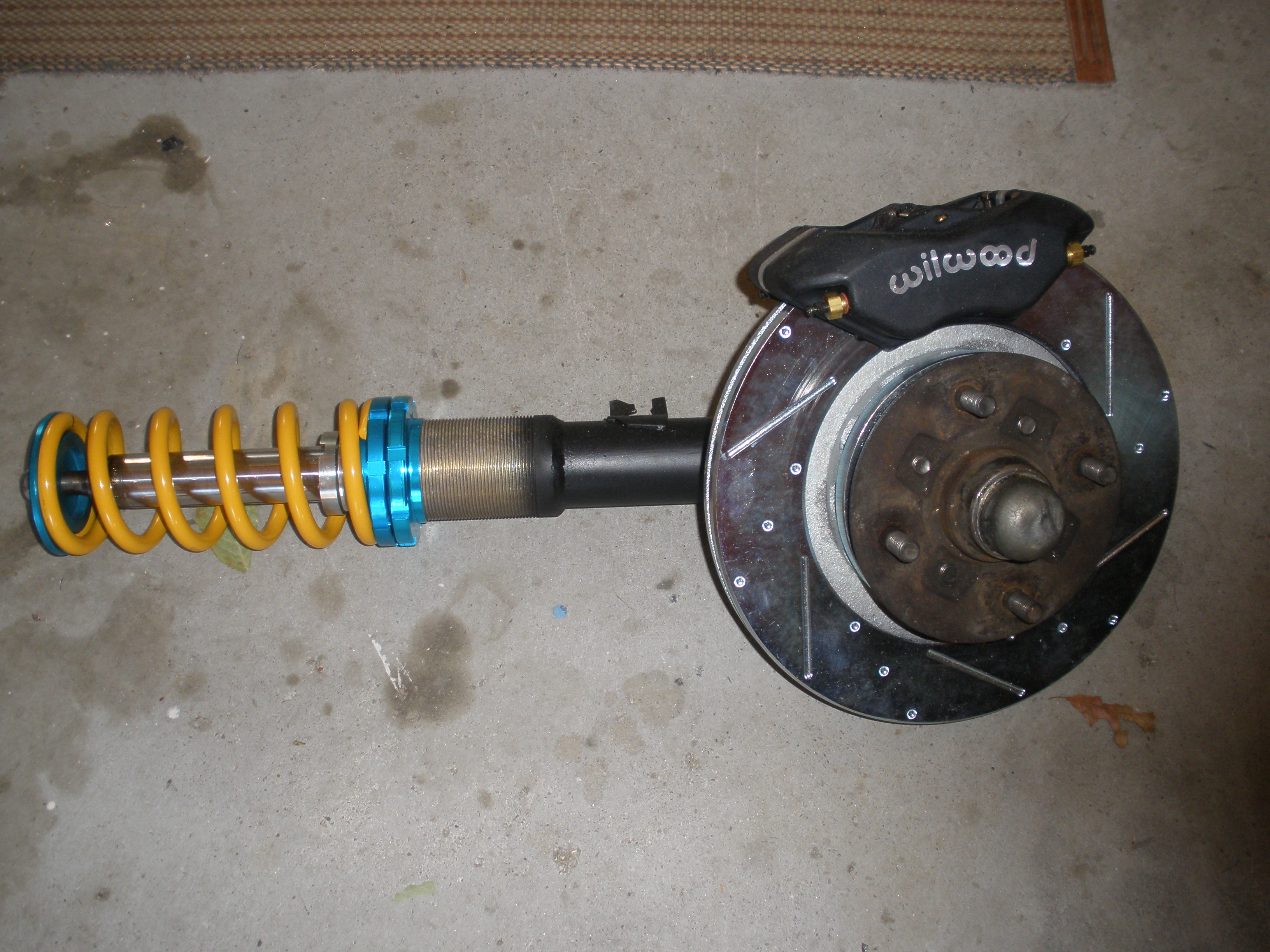

Some photos of the coilover setup. Bilstein AE92 inserts, shortened strut casing with the ae92 thread welded on the top of the AE86 strut Techno Toy Tuning AE86 big brake kit including willwood 4 pot callipers, slotted and semi drilled rotors, braided brake lines.

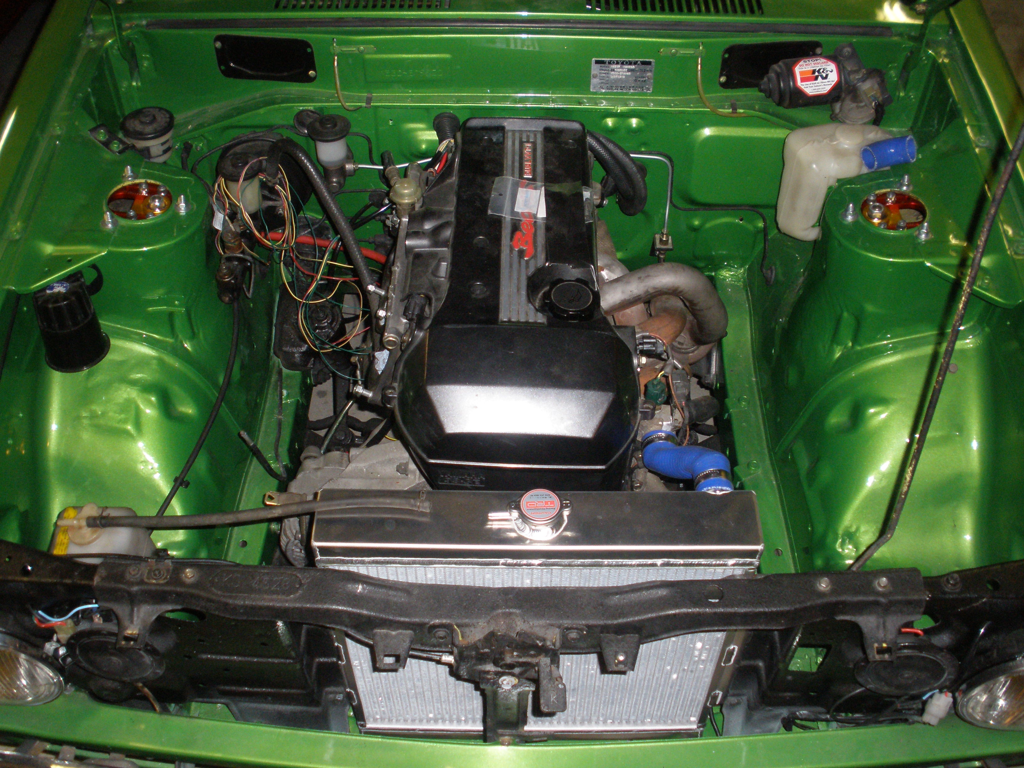

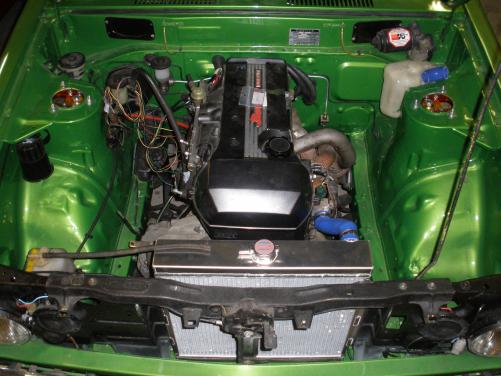

I know its been a while since the last update but the progress is still happening albeit very slowly. Pretty much got the engine and gearbox sorted now just got to weld together my ITB manifold and get the fuel tank and fuel system sorted and it (hopefully) should be a runner. I got all the front suspension setup sorted after a bit of clever machining of the T3 adjustable camber tops.

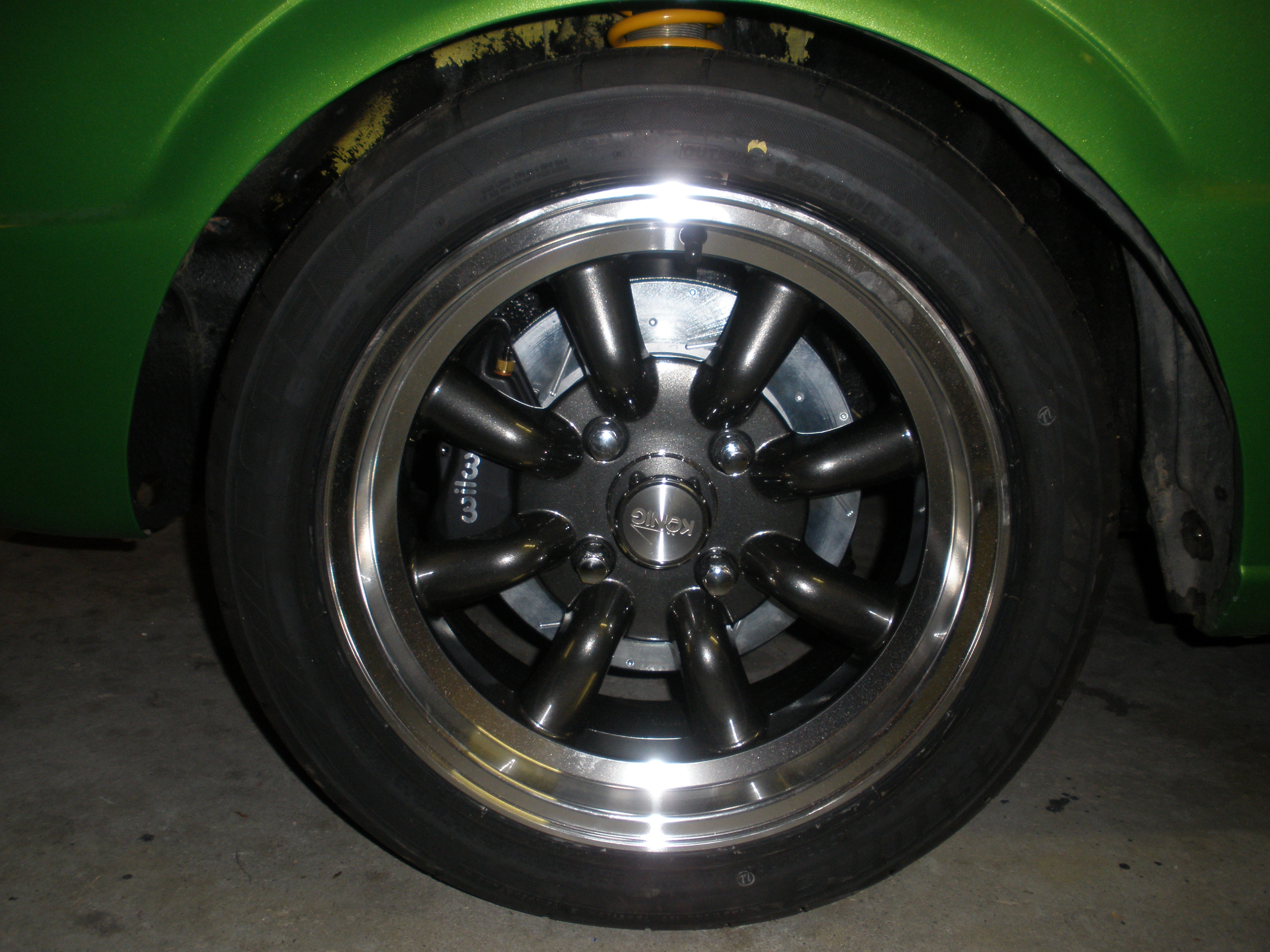

I had a custom 57mm core radiator made in Christchurch, it cost me a overrated but fits properly and looks pretty good. Also bought a set of Konig Rewinds 15x7 fitted with 195/50R15 Bridgestone RE11.

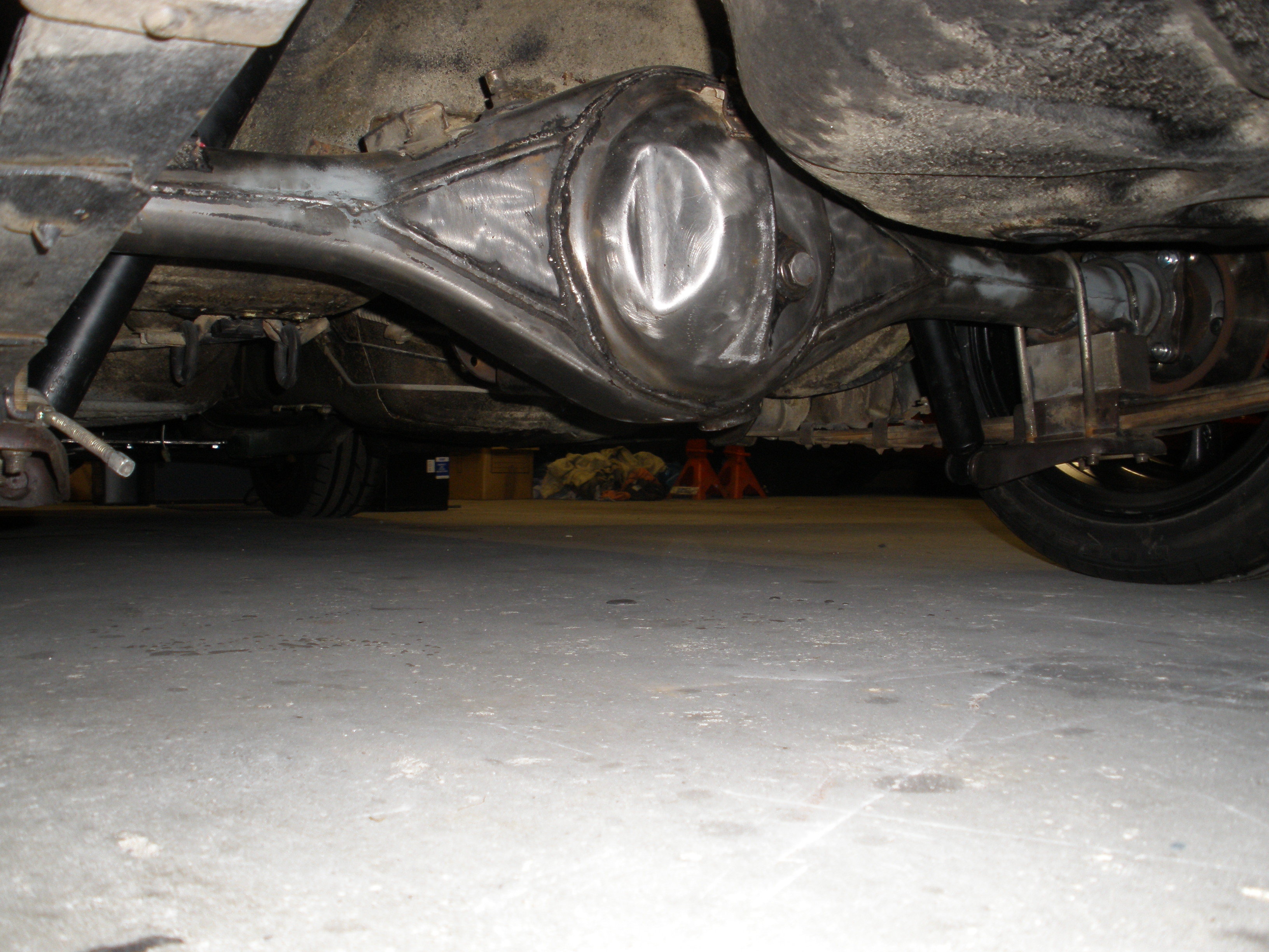

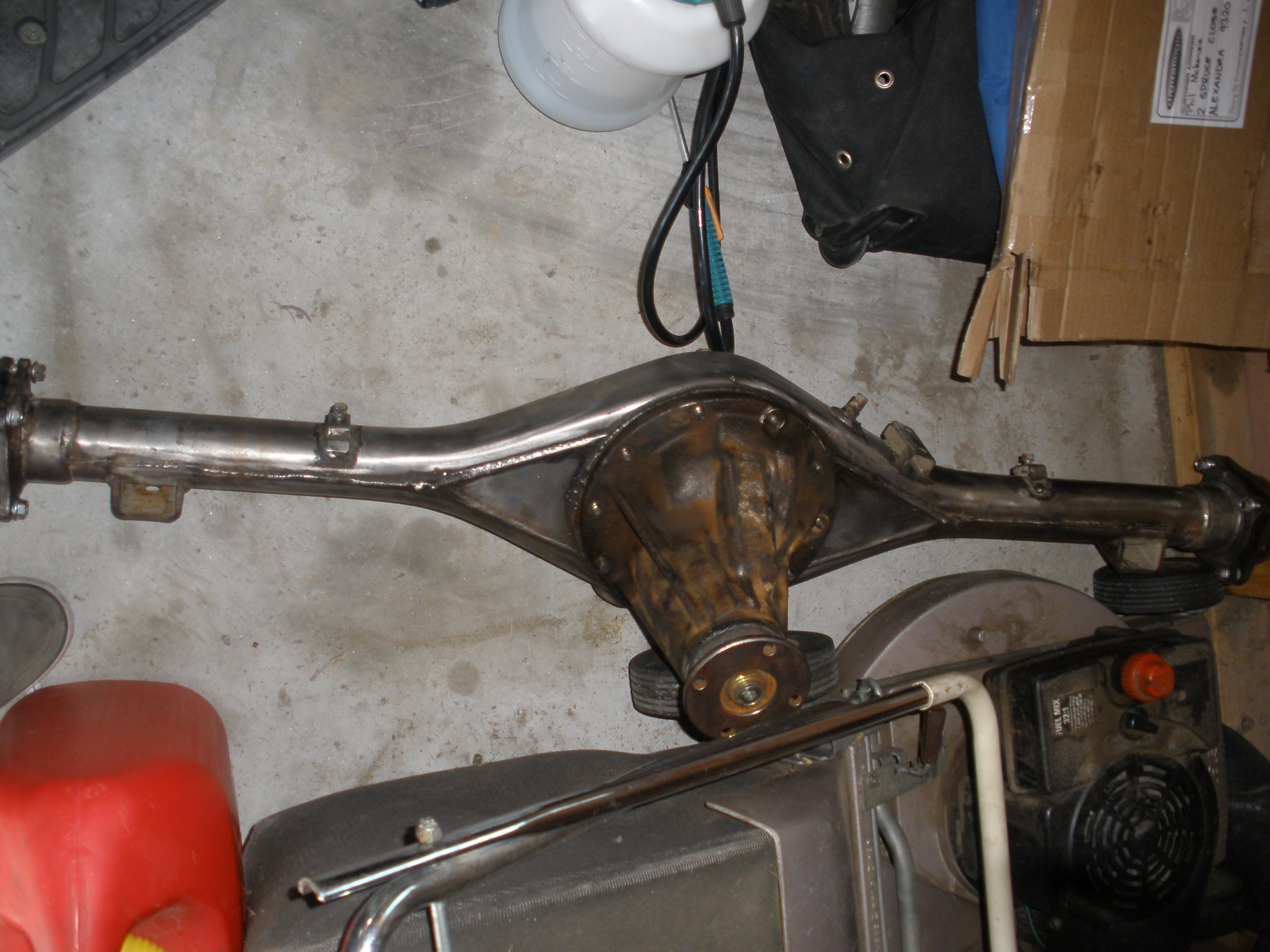

The diff is away at the engineers at the moment being shortened and i should have it back next week to fit the U13 Bluebird rear brakes to it.

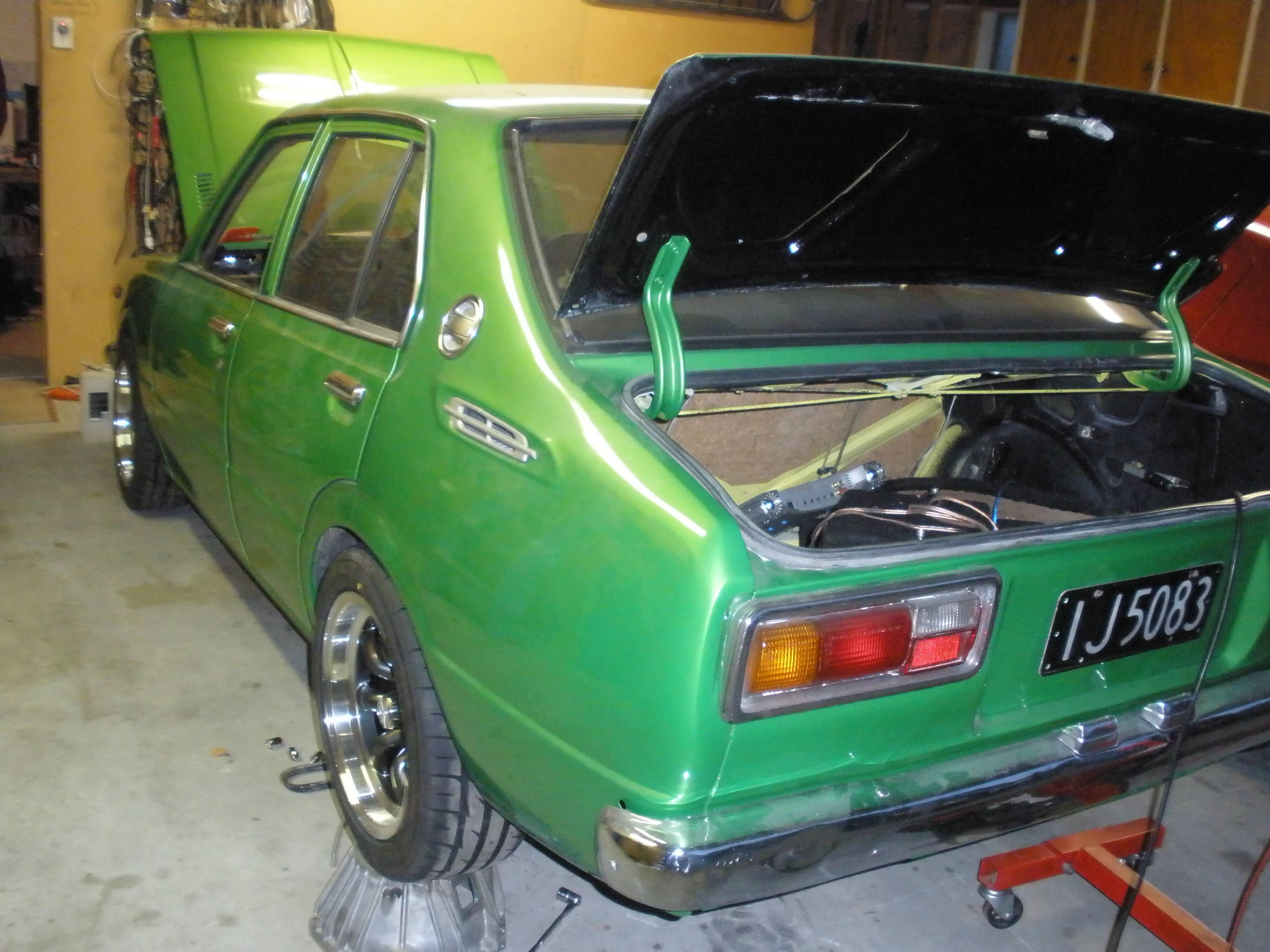

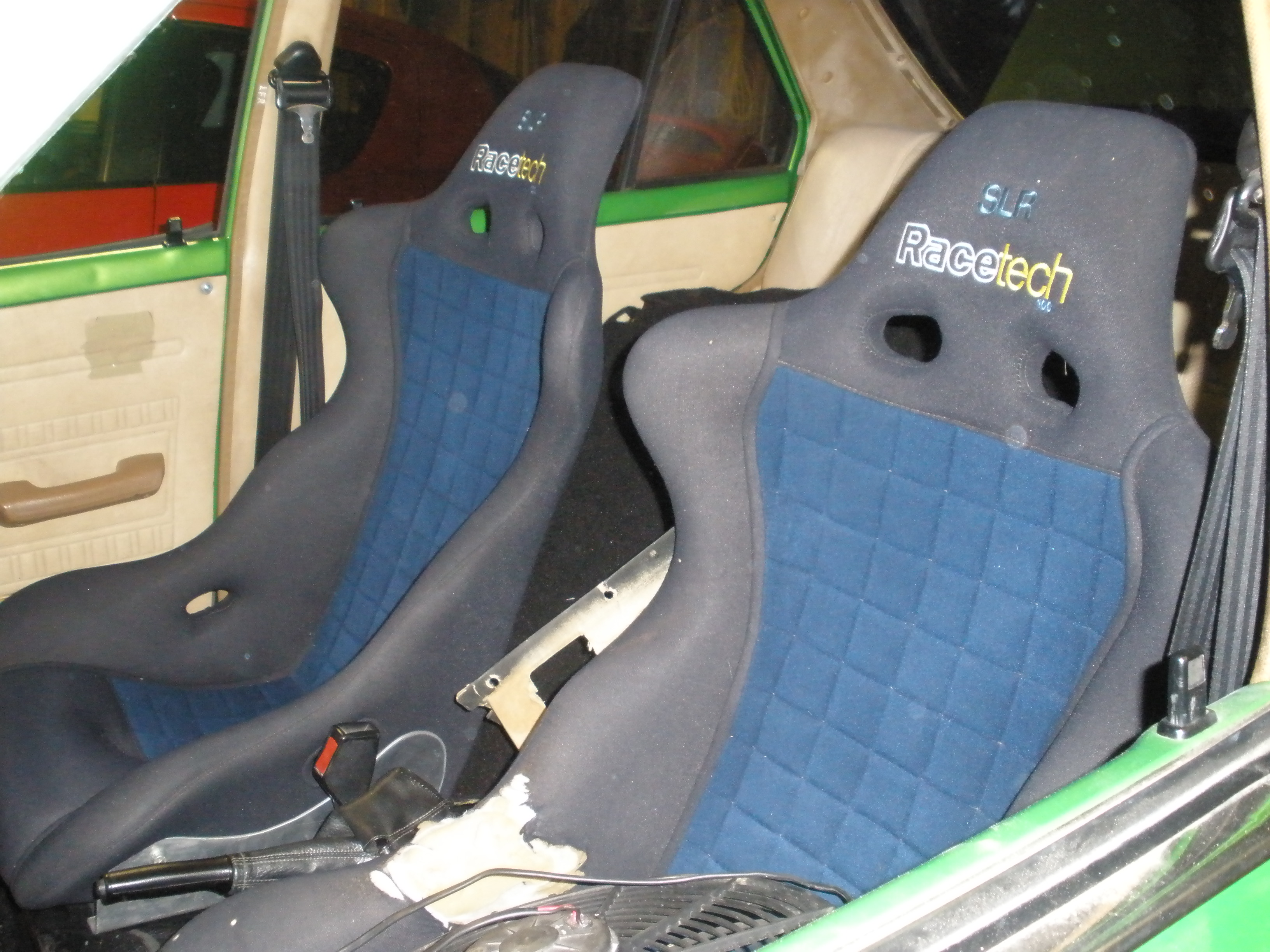

Scored myself some Racetech 100 seats for $200 with the brackets, so i fitted them in on some modified Mini seat mounts i bought off trademe and also fitted the carpet and lower part of the dash. The top peice of the dash is being recovered as we speak. The interior will eventually see a re-trim but at this stage it looks semi alright and will do until the cars properly on the road.

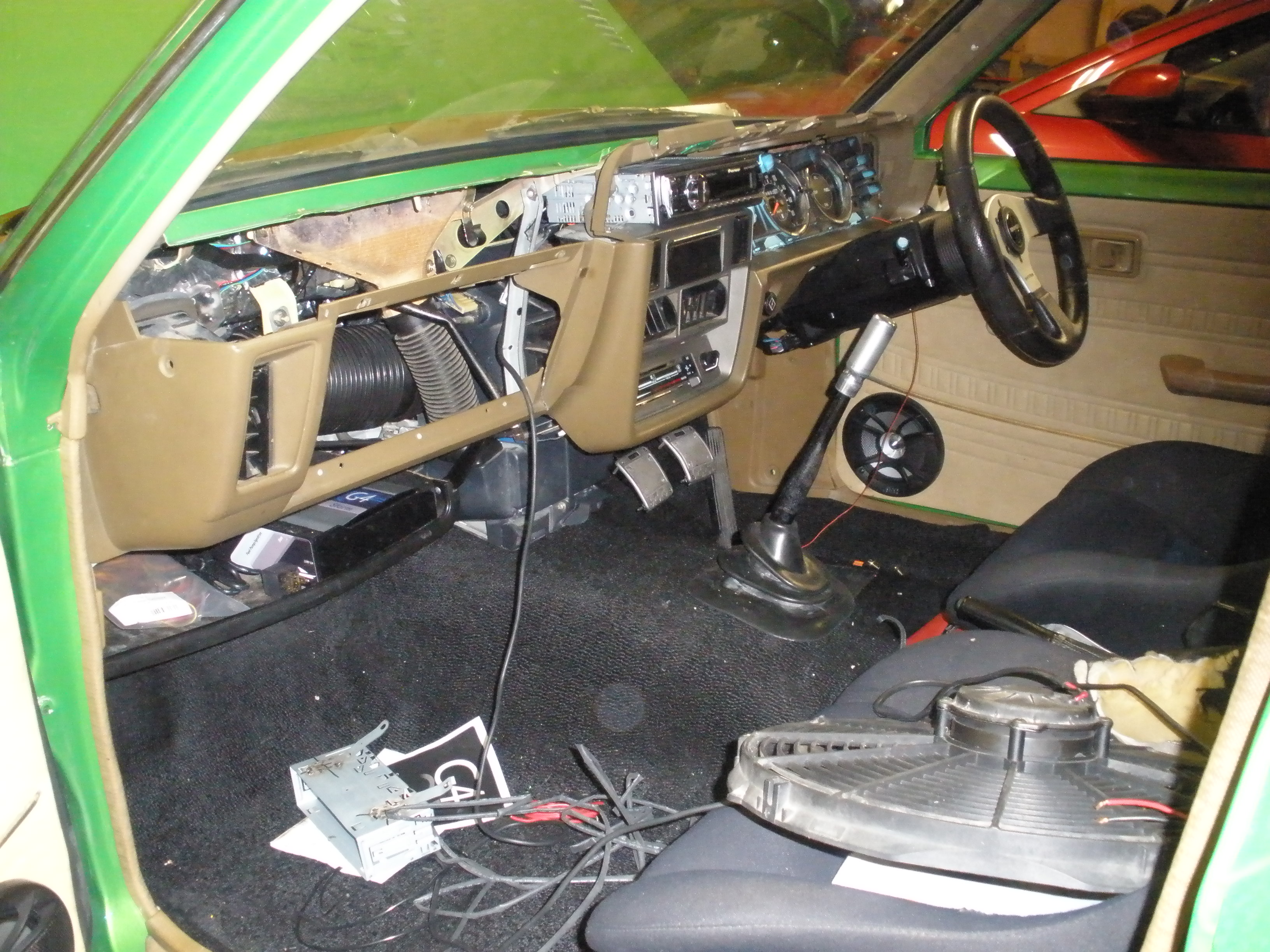

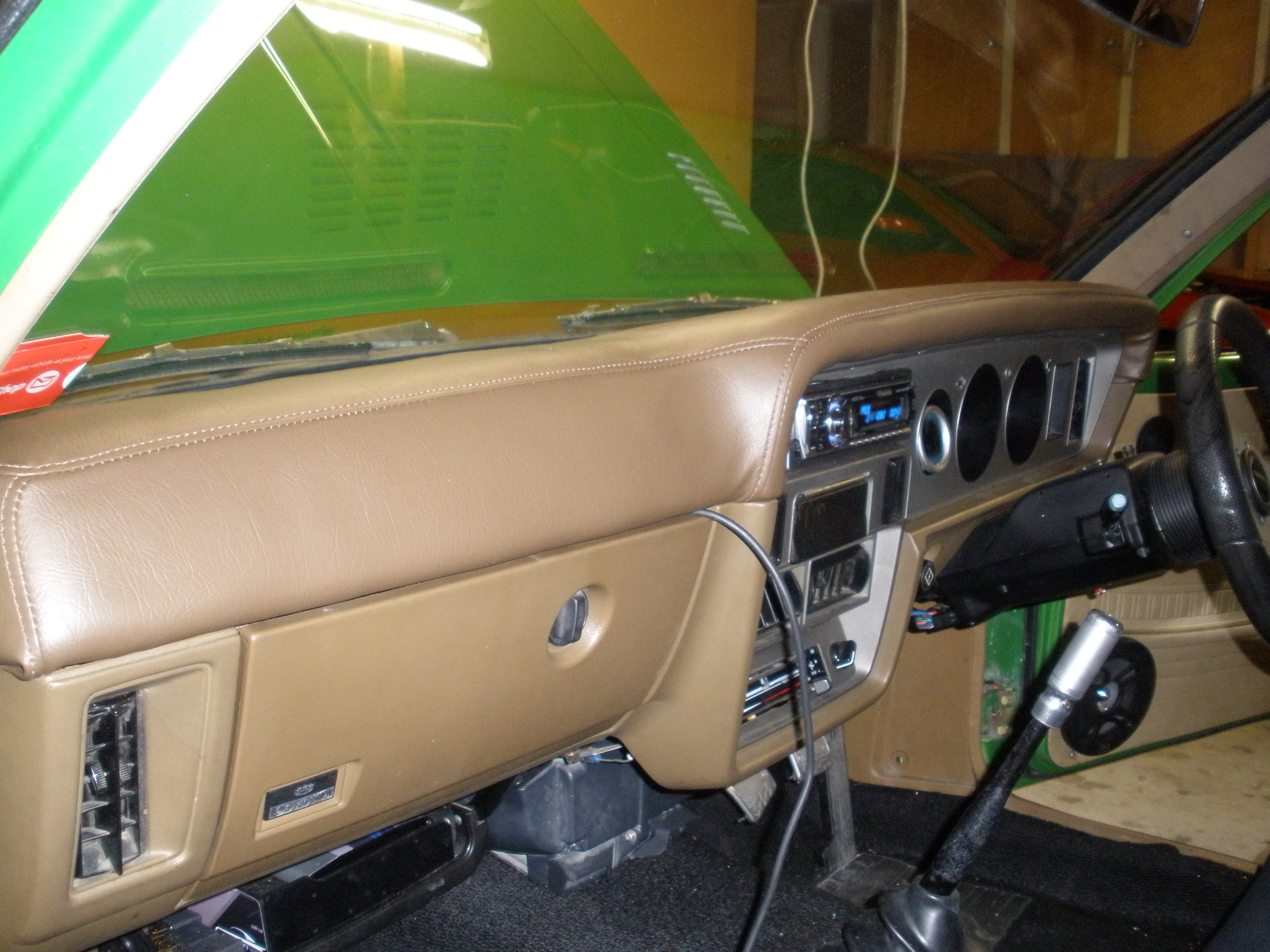

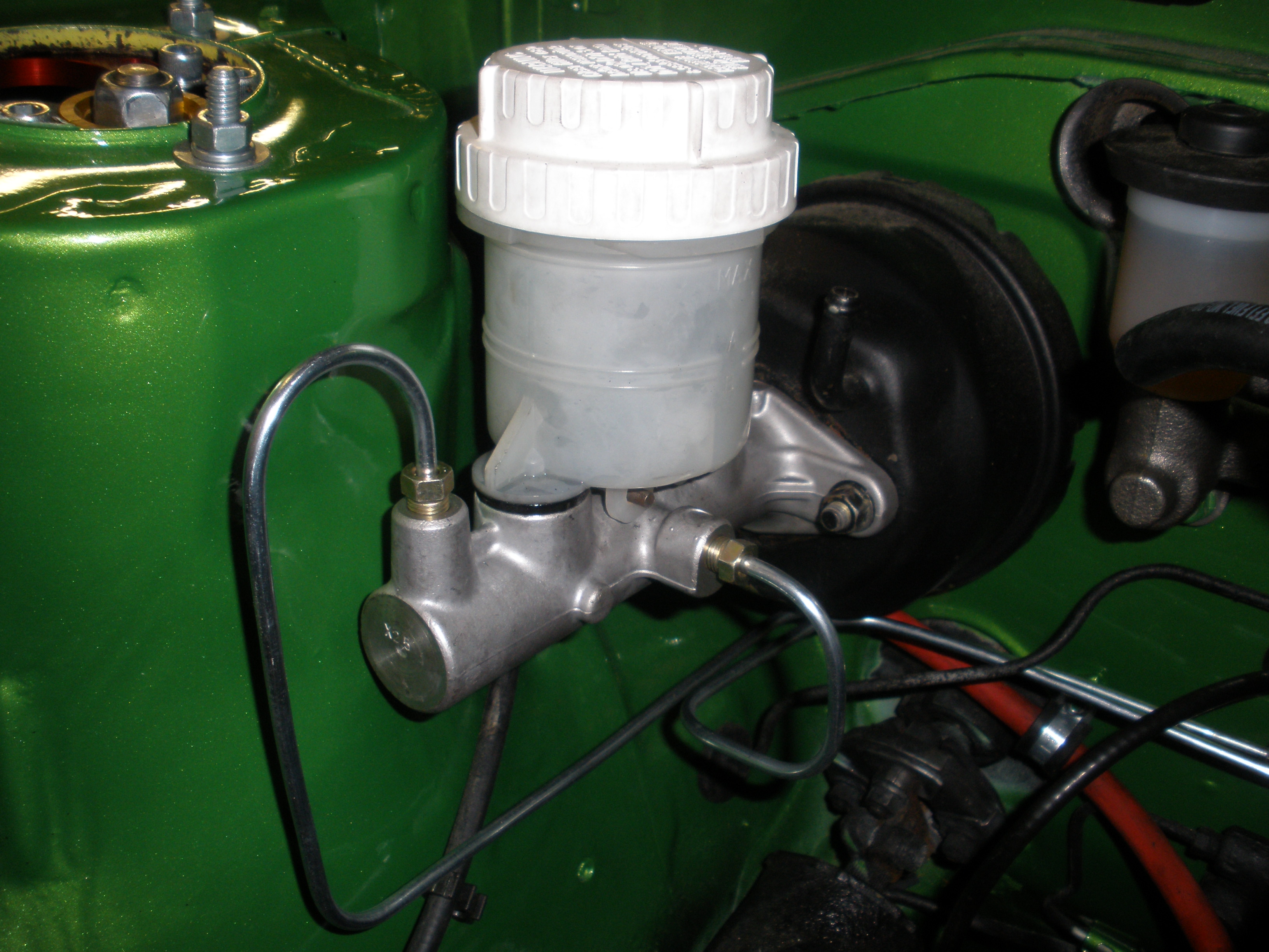

Just finished putting my recovered dash top in and decided to have a wee update. Have sorted out everything apart from the fuel system and rear brake mounting and a driveshaft. I managed to find a Mitsubishi RVR 1 inch bore master cylinder and it bolted straight up to the original brake booster with no mods. Got the Hilux diff shortened and it's all fitted up now, still with the lowering blocks until I find some spare cash to get the rear leaves done properly.

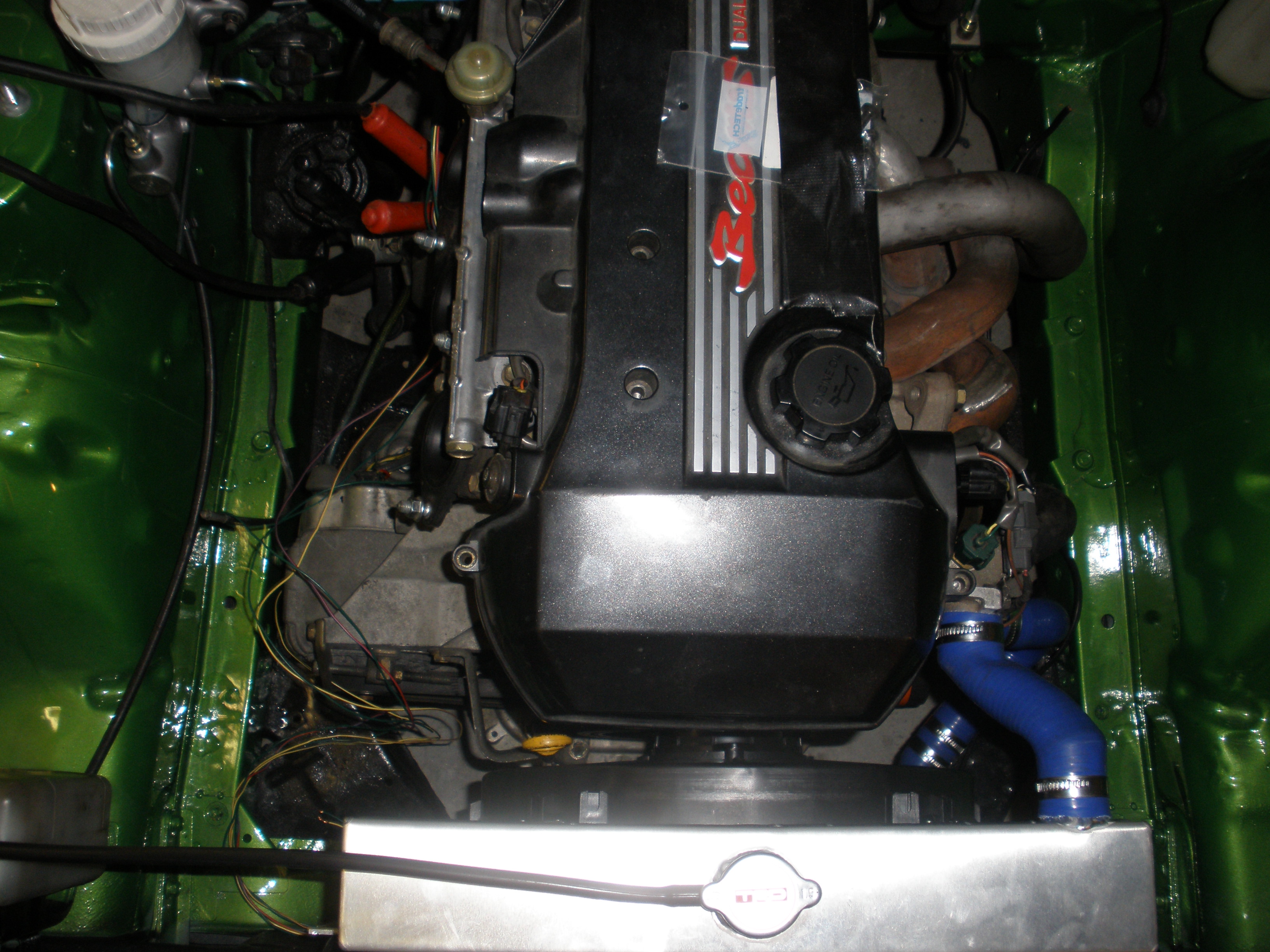

My throttle body adapter is just at the engineers getting planed down as the heat from welding it warped it a wee bit so should have that back on next week and I can finish off all the engine work. Also fitted up a new 14 inch electric fan. The fuel tank is getting built this week with a Walbro 500hp in-tank pump.
Not far to go now am looking forward to getting it started and taking it for a spin.
