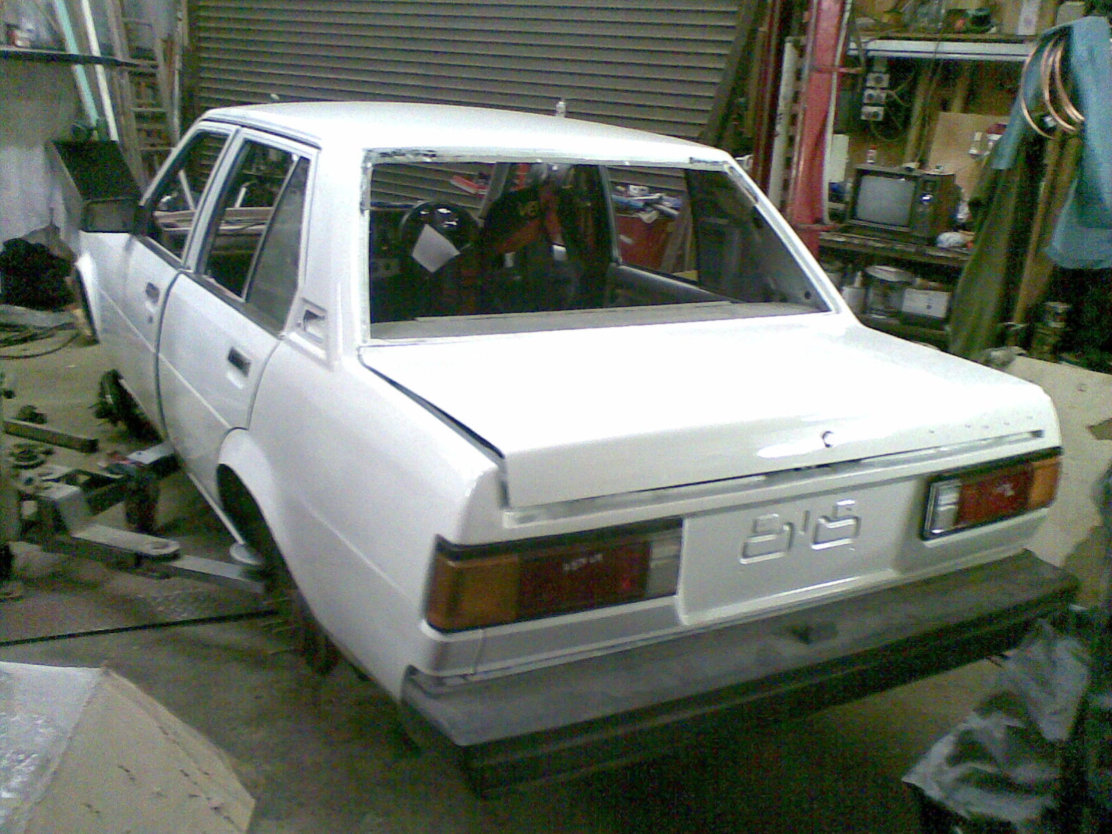

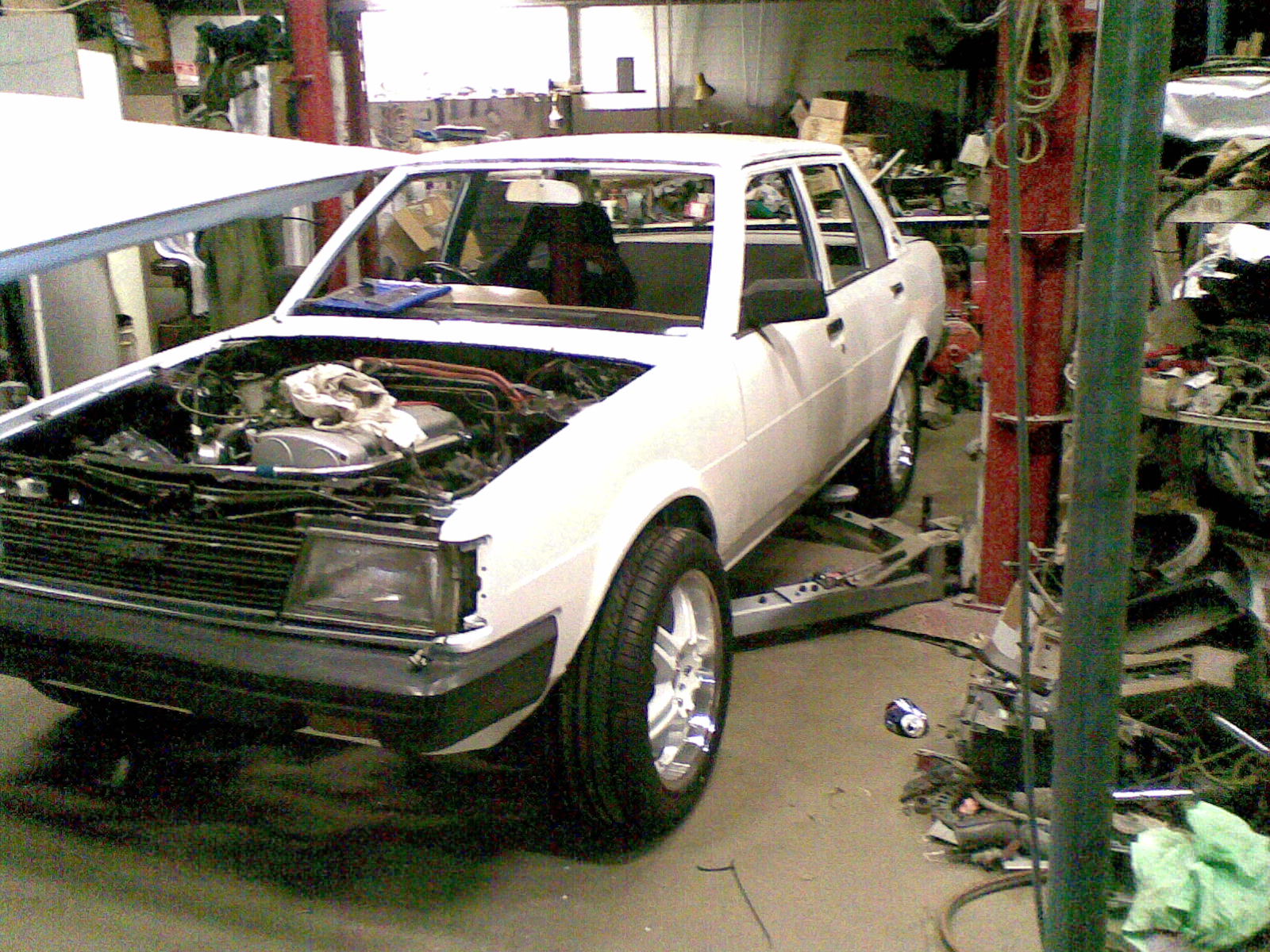

  5. well three weeks ago i started this project, puttin the 20v in that is. then it became tidy the body work up (Typical corolla rust spots) :hmm: but due to there not being enough hours in a day the project didnt compeat in the hillclimb last weekend... :lolcry: here is some up to date photos as it sits on the hoist, oh and it does have a windscreen in it...

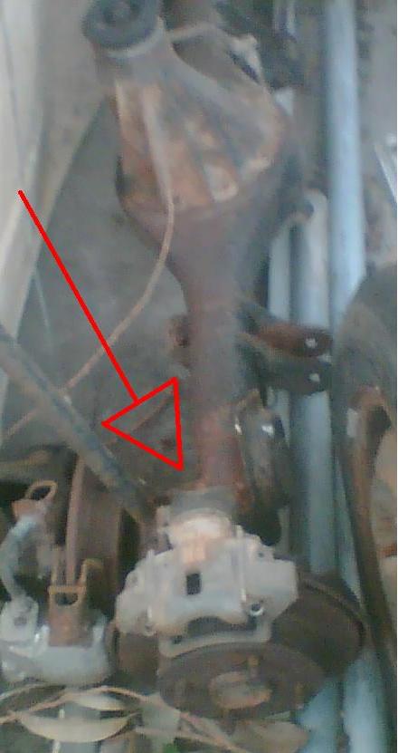

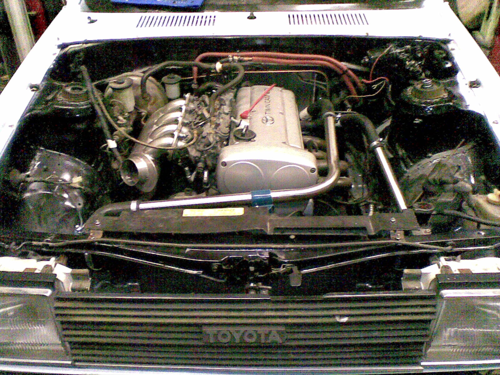

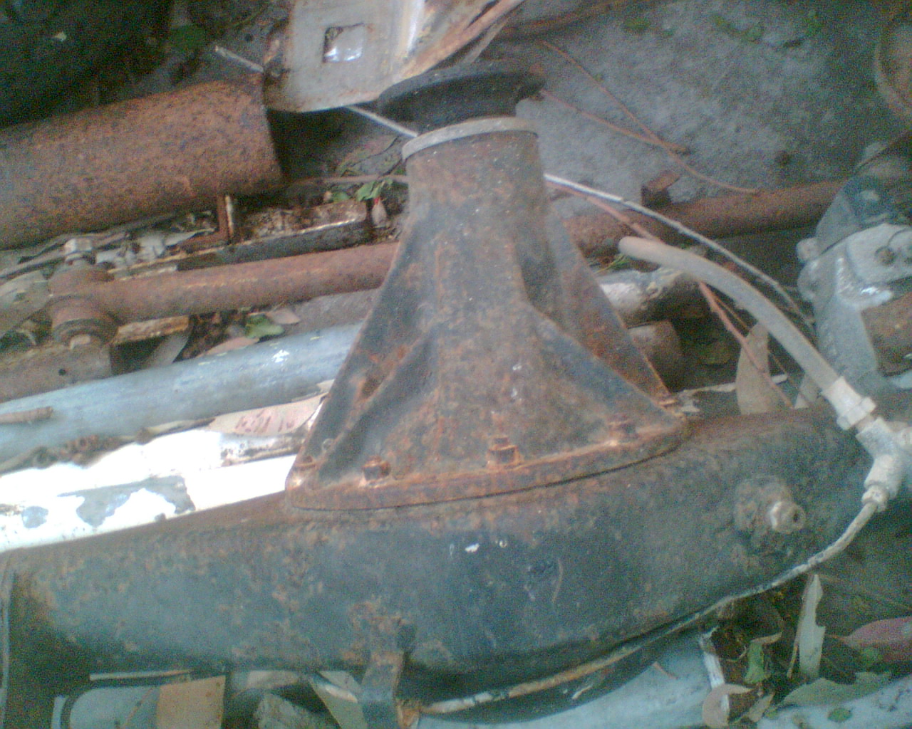

  6. the ring gear measures 6.5" after searching a international spoonta site i found a sit that broke down (with pictures) the ae86 disc rear end... i have found i have Zenki axels
  7. well i pulled the axels out tonight. they have 23 teeth on the spline. the axel bearings are about 2 inches long and the centre is open. the ring gear is roughly 4.11 well more than 4 turns but less than 4.5 but not too worried about that. just after what type of axles type i have so i can chase up an LSD center for it Willie

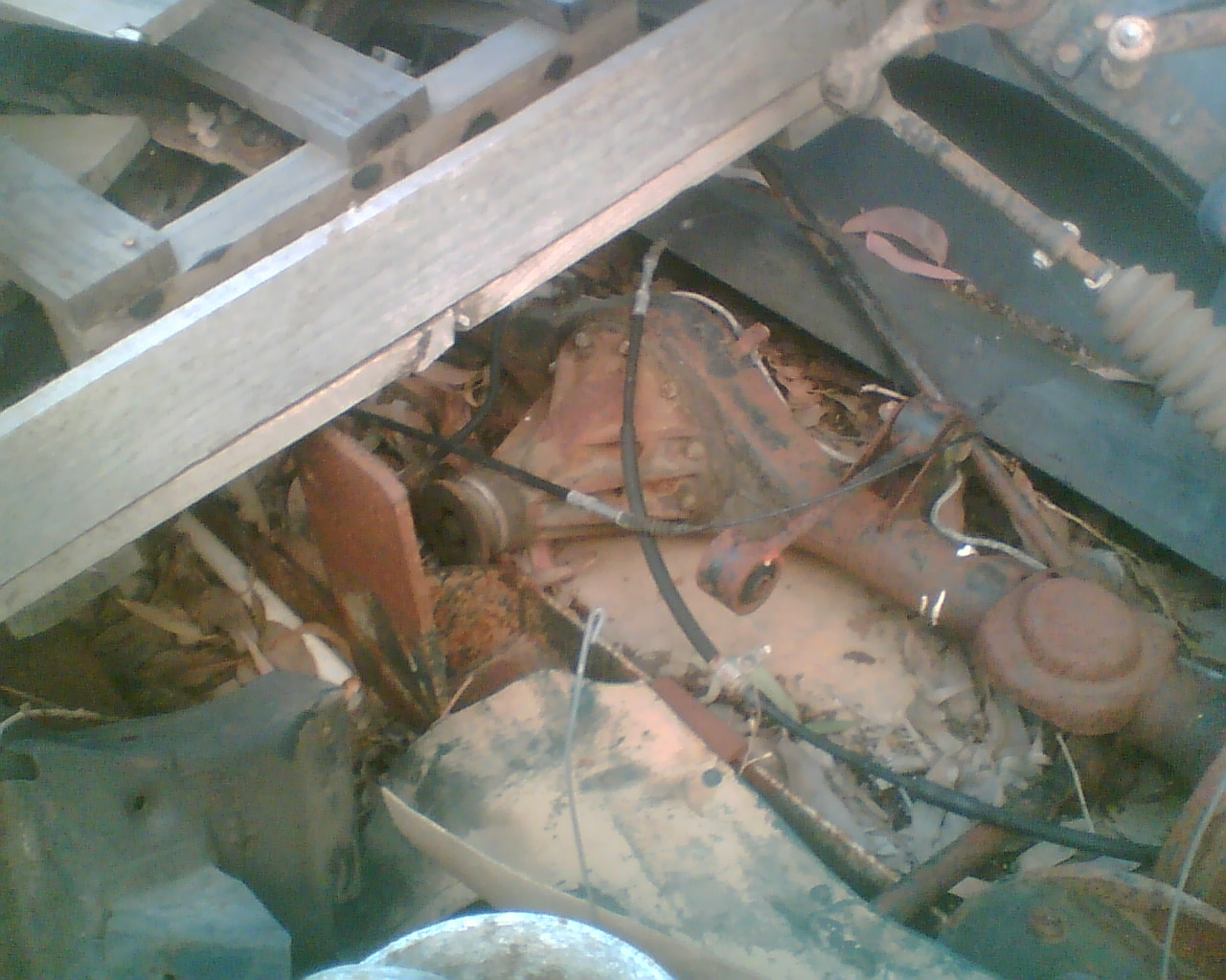

  9. as the hill climb gets closer its time to pull my finger out. BUT i have this diff i got with another car. but i have no idea what it is!!! its a jap style. (ie have to remove tail shaft to unbolt and remove centre). will i find an LSD for it cheaply??? or do i need to invest in axels and CIG the centre???

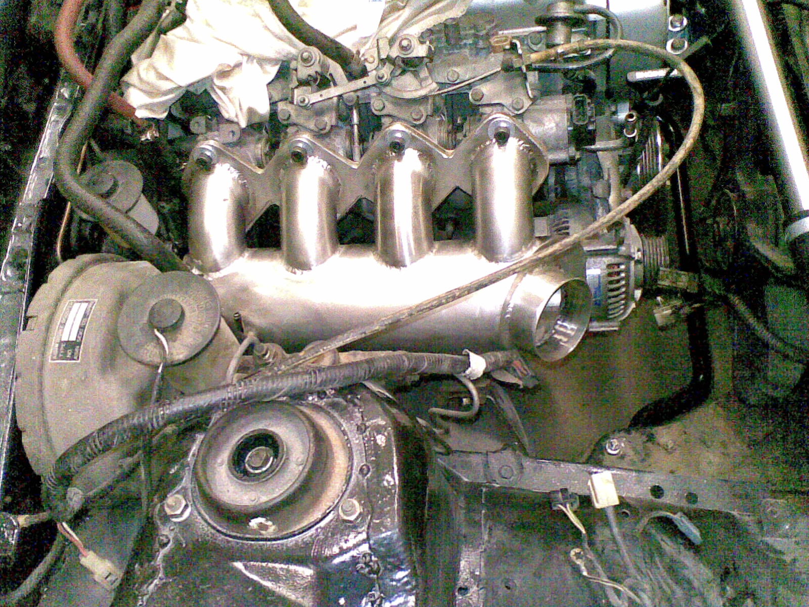

  10. well just to update Dizzy cap is unknown what he ordered. but ordered correct one. Got correct rotor button/ disc. Have new ignitor and coil. because i have had previous trouble with the ignitors in my TE30. Ae101 HD clutch and pressure plate are on the motor. Input/ spigit bearing inserted in end of crank. Have assorted S/S pipe and bends to reroot the water from the back of the block. Just look for some thermo fans (2) prefured same size, to fit a suburu vortex radiator. y i used it is cos it is brand new and it came on the car we got for nothing. next when leads and cap come. assemble motor and install in engine bay.

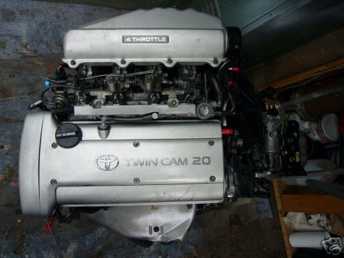

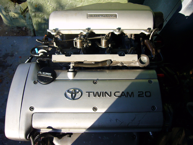

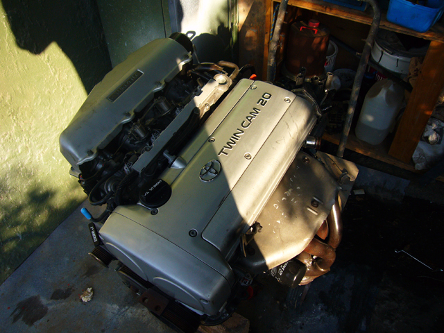

  12. :y: heres the pickys i got sent of the motor

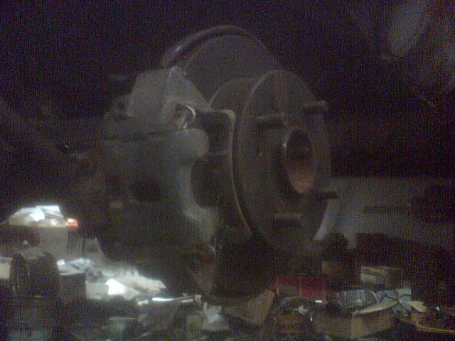

  15. As time gets closer the list is slowly gettin smaller on my new race car. but now i have a dilemma i need some help on. i ordered for my S/T 4age a set of leads and timing belt and half a dozen other things but they all don't fit!!! i did a little research and found that i have a motor from an AE92, not the AE101 as i have read about every where else... is this motor good or bad. any difference? more to the point is the wireing diagram's the same for the AE101 to the AE92????

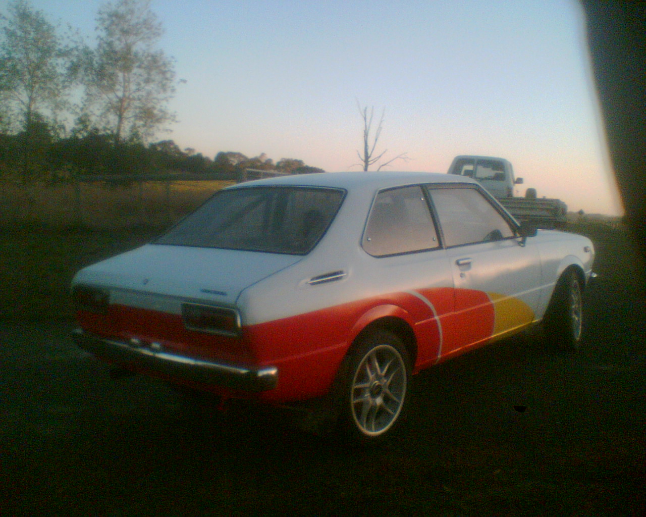

  20. i got the colour scheme from the alan moffart XC federation insurance falcon. or the camel filters...

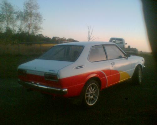

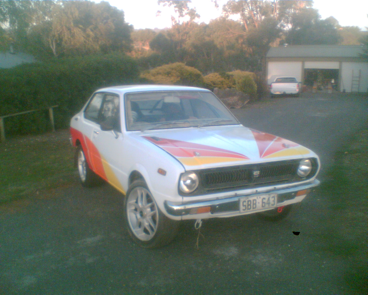

  21. After being like 6 weeks in the spray booth... The mighty rolla now sounds and looks the part...

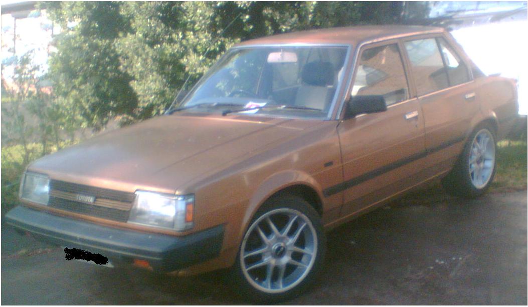

  22. well the mighty Poo rolla has 3 weeks of rego left till it comes off the road.... so i decided to put 17's on it... :( :)

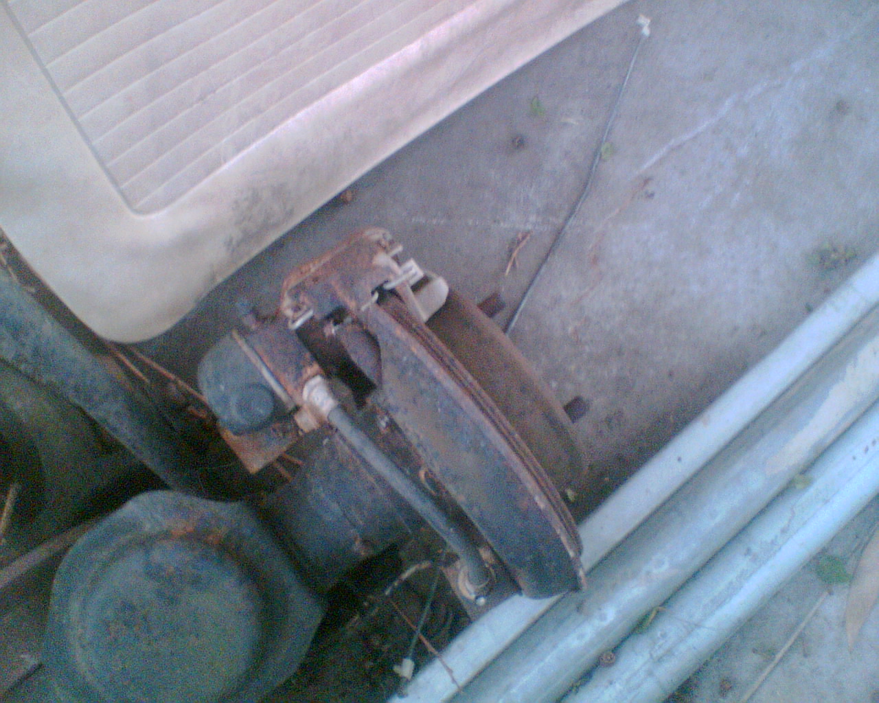

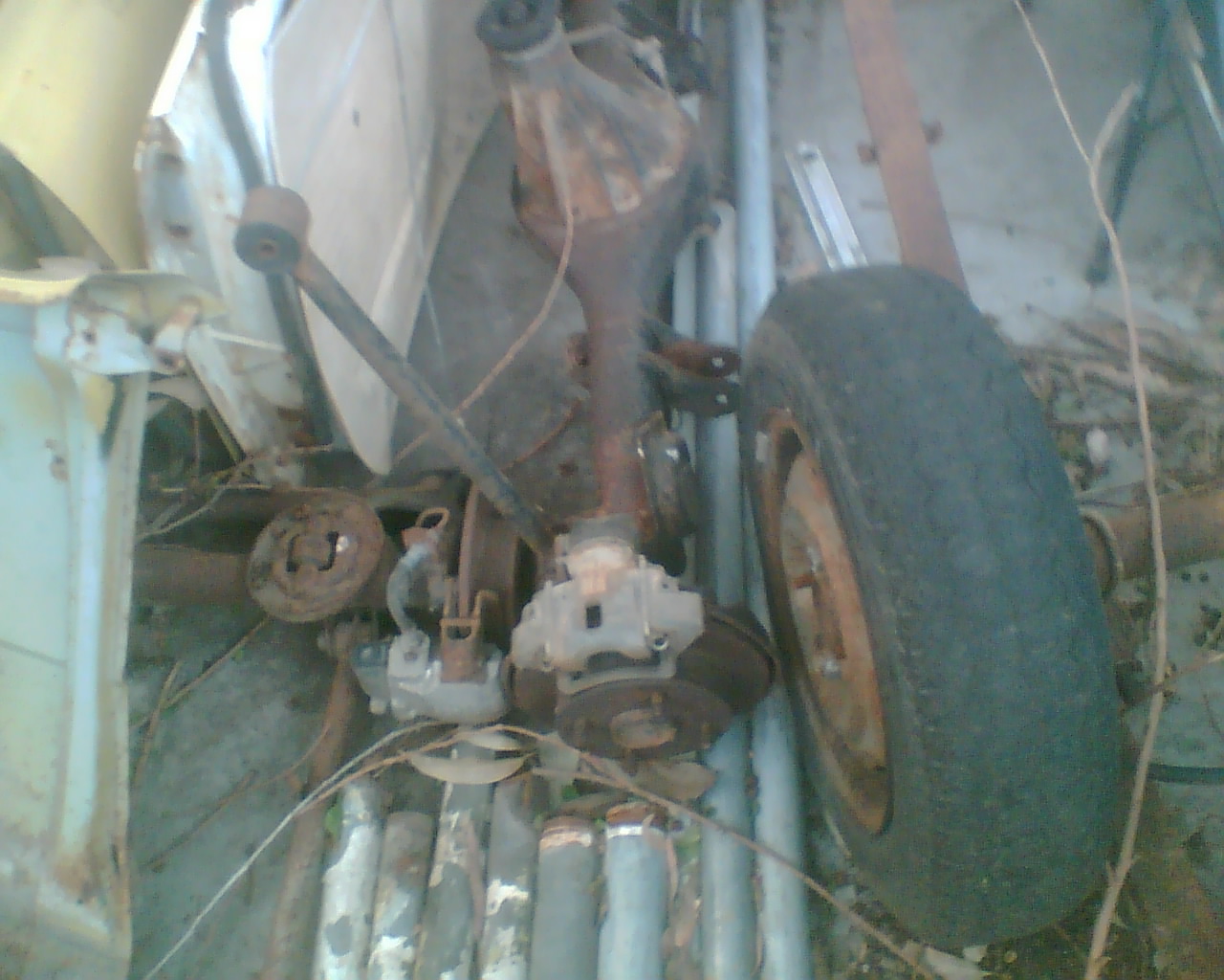

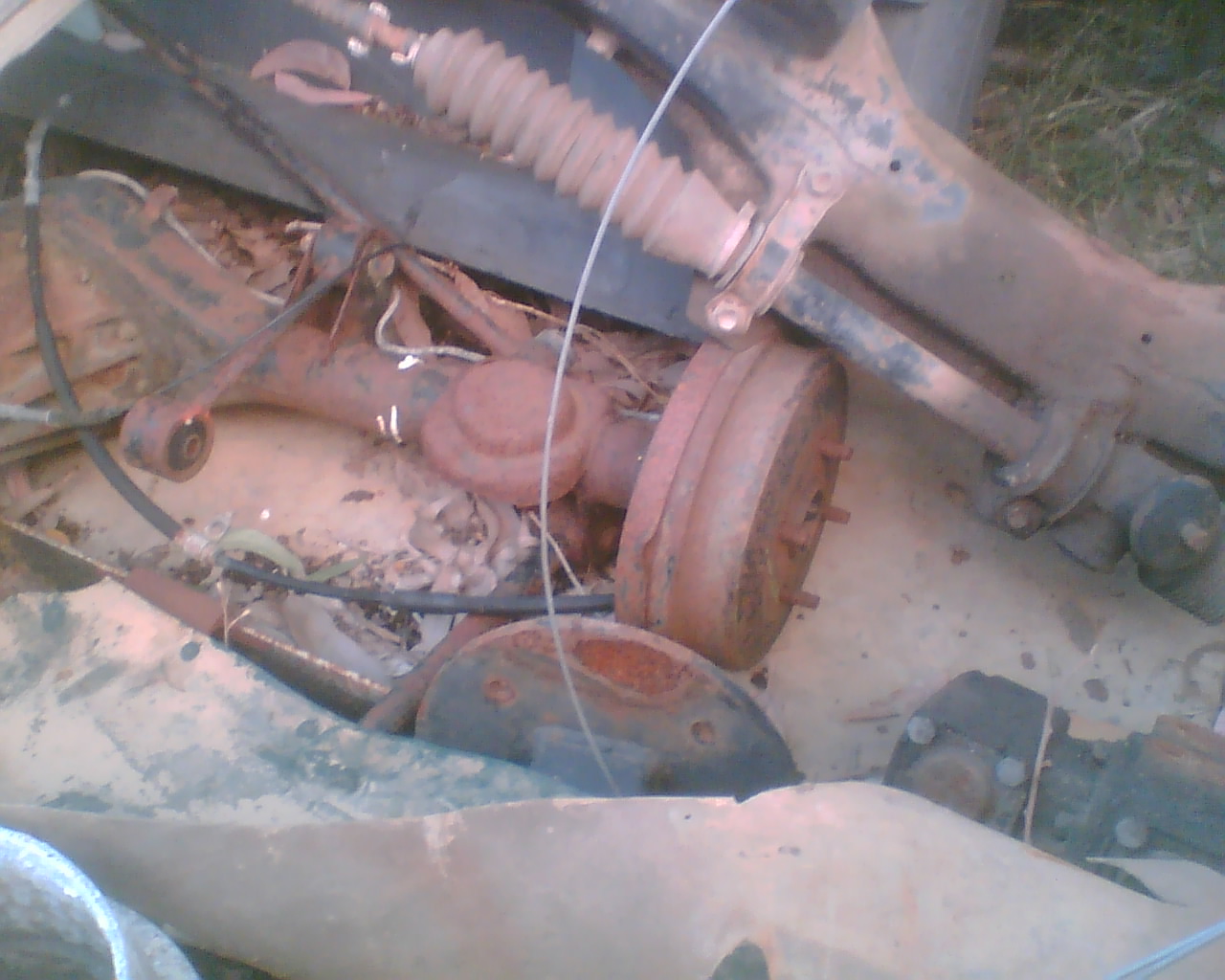

  23. this is a drum diff out of the celica fastback... i think this is a disc diff out of (as teddy tells me) AE86. what style of diff are these? Are parts easyish to get for them? CAN U GET A LSD FOR THEM???? (the main point of the thread.) i have heard that the hilux 2wd lsd boults into a housing but I'm not sure which one.
  24. had the beast out for its maiden race last weekend. umm well it goes. front brakes locked on so had to fix that out there. (brake bore has a non compressable objects in it ie sludge) after that when like a shower of shit... now have fuel problems... south aus state motorkhana on this weekend, i will see how it goes up there.
  25. the motor, g'box, ractors, 2" exhaust. no carbs. cost me $400 inc freight
