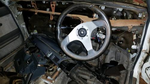

Not really keen on doing it myself, done my fair share of rust treatment before. Have heard good thingd about the POR15 kits though, if I had the time again I'd try that. It's due for pickup in Wednesday evening, it will be going straight into the car, connected & filled to the brim with BP's finest. Dash in. Instrument cluster in. Cluster cover in. Still need to do some minor electrical work (cd player & O2 wideband wiring) but for the most part, the wiring transplant is done. Which includes the body-loom. The engine's on the stand for a good scrub/clean up, thinking of changing things like camshaft seals etc (while I'm here.....) before it gets bolted to the C56 & thrown into the engine bay. Tempted to bolt the Exedy HD clutch that was attached to it back on as well.- 539 replies

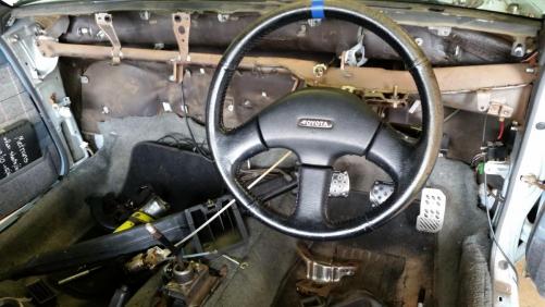

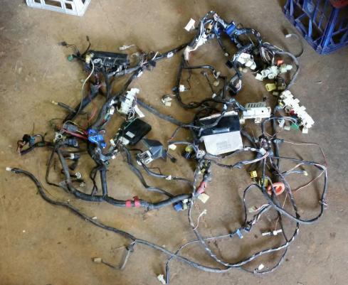

All the wiring required to run an EFI engine. While I was there, also removed the fuel flap/hatch release cables/levers for installation into BT. I don't have to put this dash back together, Blue Things on the other hand... There's a heap of rust in the EFI tank that's going to have to be cleaned out before I can use it. Urgh, there's always something.- 539 replies

No need to source one thankfully, the SOHC-carburetor wiring loom that BT came with was modified for the quad-setup. I have since removed it & storing it away for later. Am removing the DOHC-EFI loom from the white TC (EFI & Carby looms are quite different) to install into BT, I also have the EFI loom from the project car if need be. :)- 539 replies

It could be a lot worse I guess, it doesn't have A/C or P/S so there's less hoses/wires to deal with. The loom needs a good clean up & re-taping in some places. I tapped into it for power/MAP sensor signal etc at a few points & my electrical work from 7 years ago leaves a lot to be desired.- 539 replies

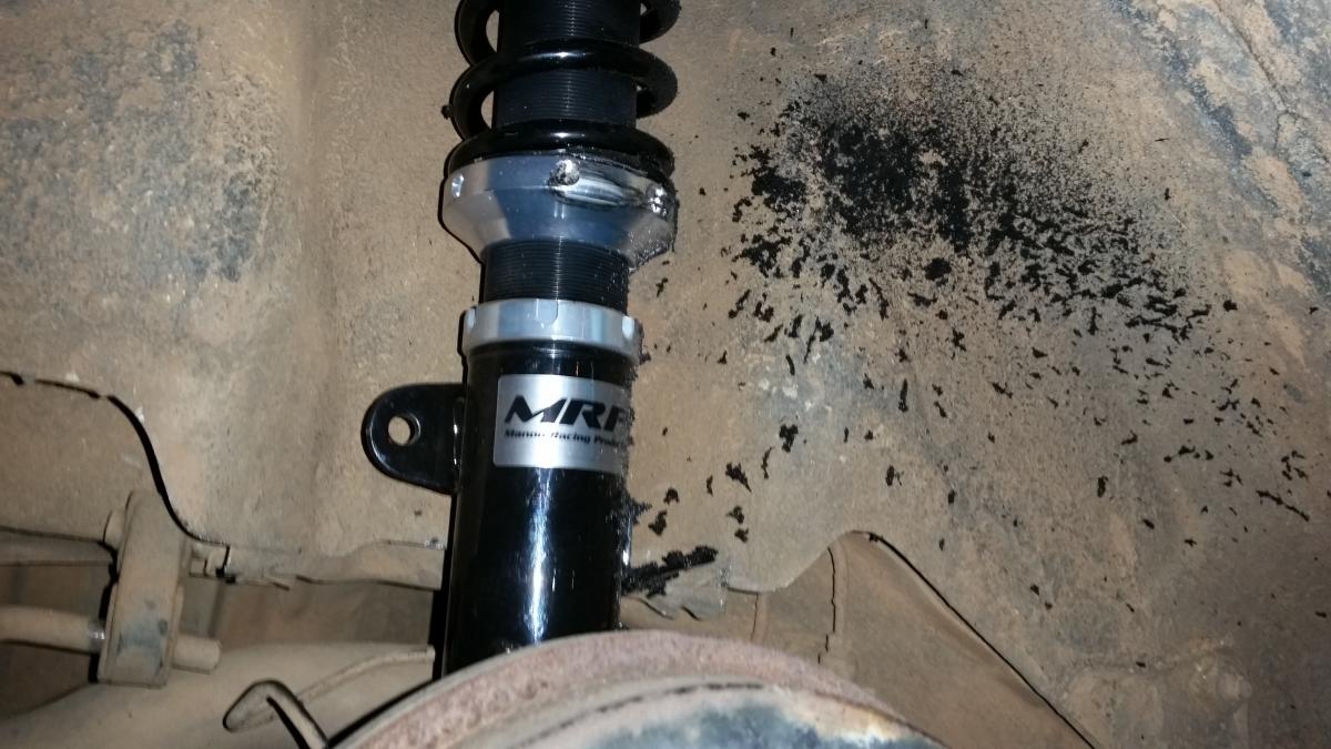

I am feeling the need to kill this mosquito, beginning to give me a headache. Distracted myself from it by installing the coilovers. Liking my existing ride height for its practicality, I only removed 10mm of height from the front & 5mm from the rear. Had a small drama at first, due to wheel offset/185 tyres, the inside edge of the rear tyre rubbed on the spring perch. Tried fitting a 175 tyre, this gave me clearance but I want to run the widest tyre possible & be the same at all four corners. Reduced the rear camber from -2.3° to -1.4° & this solved the problem. From start to finish the alignment took me about an hour & a half to get right, but when you have an alignment machine at your disposal & you're not paying for labour... :) Running -2.3° camber with 0.5mm of toe-in on the front & 0.0mm of toe on the rear. Test drove with the suspension on the softest setting, felt just like the KYB's with the KS lows. Went 4 clicks firmer & suffice to say that's firm enough for my local roads. The difference in handling is mind-blowingly awesome, the front has so much more grip & there is very little roll through corners & lunging under brakes. 10/10, would install again.- 539 replies
