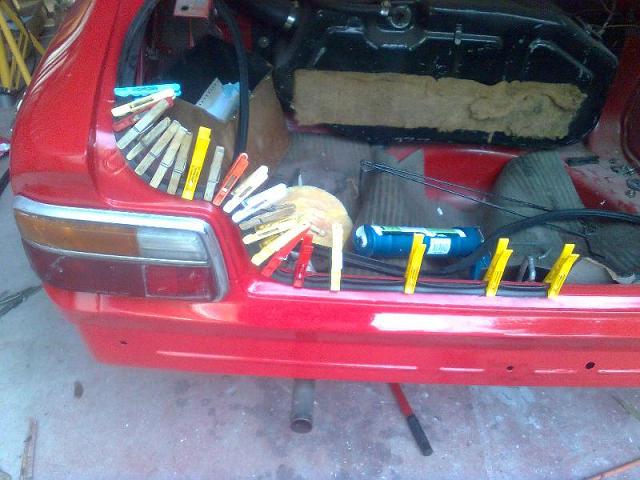

  7. I used windscreen sealant as an adhesive and raided the peg basket to hold my new boot seal in place overnight while it set. Does the job. Easy Cleanup.
