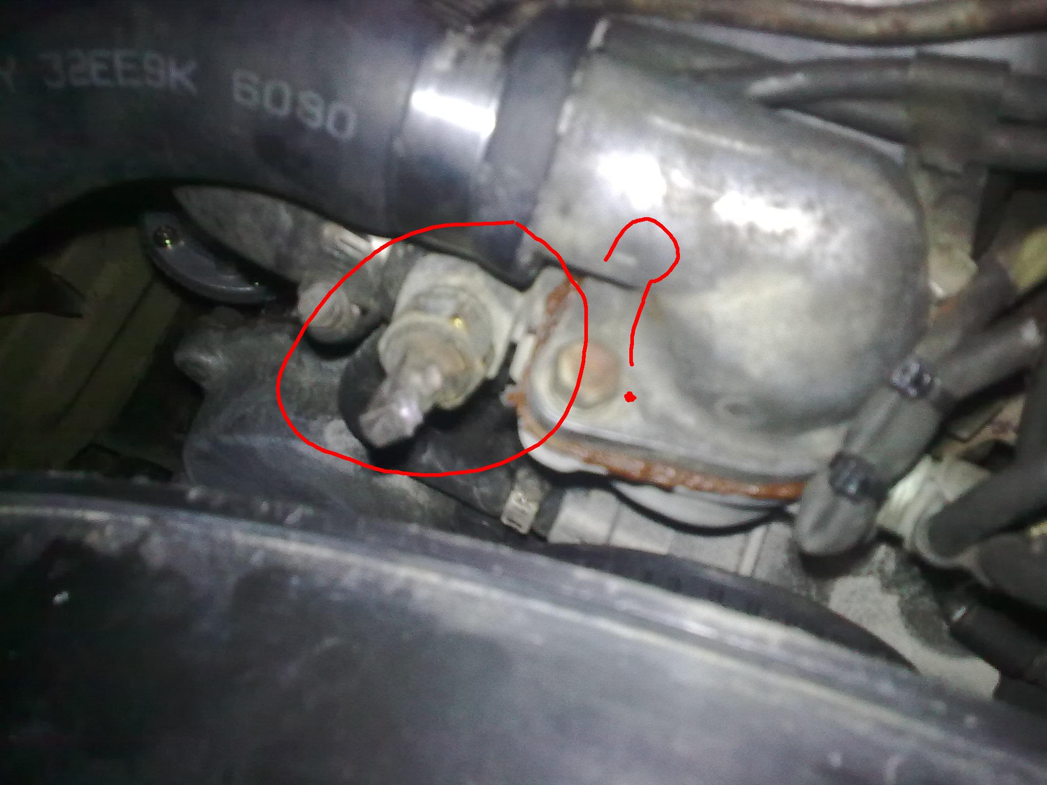

  3. nah there are no wires or anthing hooked to it there were two vacume lines but some idiot (myself) broke them off it but thats it?? yeah sorry from camera phone thats why...
  4. i have a over heating problem that aint been ironed out yet but i found this bit broken and dunno what it actually does???

  14. yeah i thought it might have been the thermostat staying closed due to lack of vacume? all my vacume lines are fairly f@$ked and there is two lines blocked that were off this lil plastic bit bellow the top hose?
