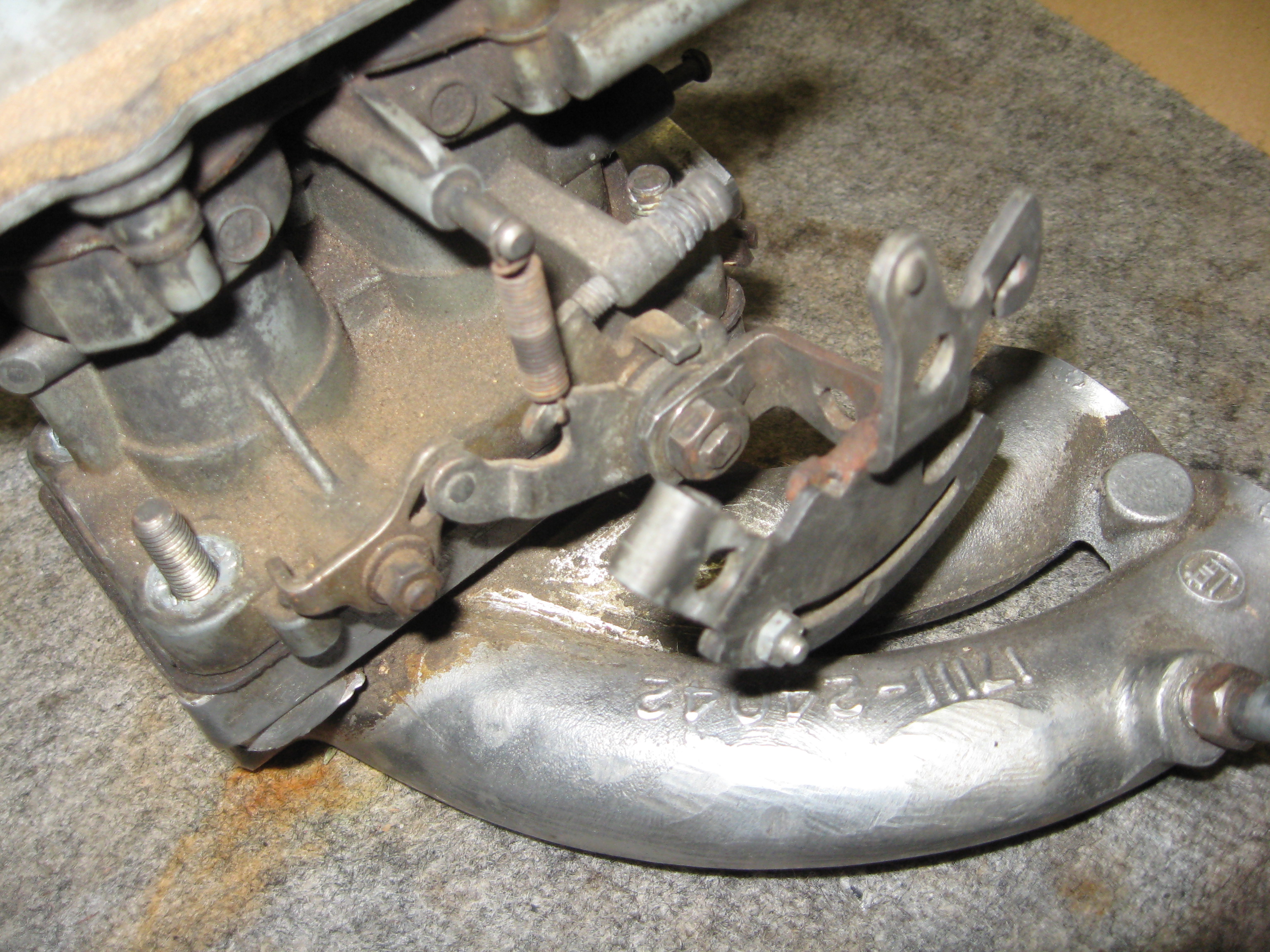

  2. This is one that may have come out of a 70,I'm unsure,its just a factory toyota linkage cut off,fliped over,and welded to the weber,this is easy and solves the problem of the weber throttle rotating in the opposite direction to standard carb.
