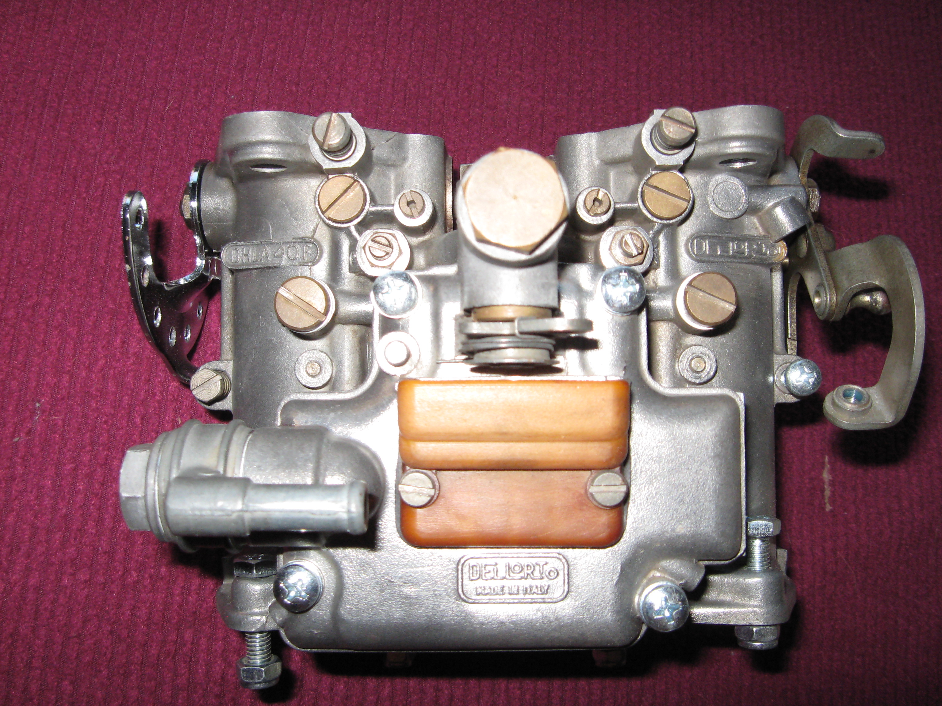

Yeah i would like to,just not sure where or if my dellorto can..?
post-9701-1262594405_thumb.jpgThis is the carb...may help. ;)
As far as I know there is no provision on dellorto carbs for vac advance.
Not sure if you can hook the line into the same vac line as brake booster line. This may give too much vacuum to the advance unit.
It seems many people just go without vac advance after putting dellortoes on. Hope this helps a little
that helps heaps,cheers..no vacuum addvance it is then. ;)

No ports on the carby. It's got to be on the downstream side of the butterflies as well.
If you have a brake booster line, yes, you can just tap off this. This will come off the inlet manifold, not the carb.
I'm not running either vac advance or vac brake booster.
put a small port/fitting into the manifold on the opposite side to the brake booster line, and get a vac advance valve that cuts vacuum below a certain level (ie turns manifold vac into ported vac) and hook it up. Much better fuel economy and drivability with vacuum advance.
Failing this, get the dizzy recurved without the vac advance, although they say this is more appropriate for race cars.
