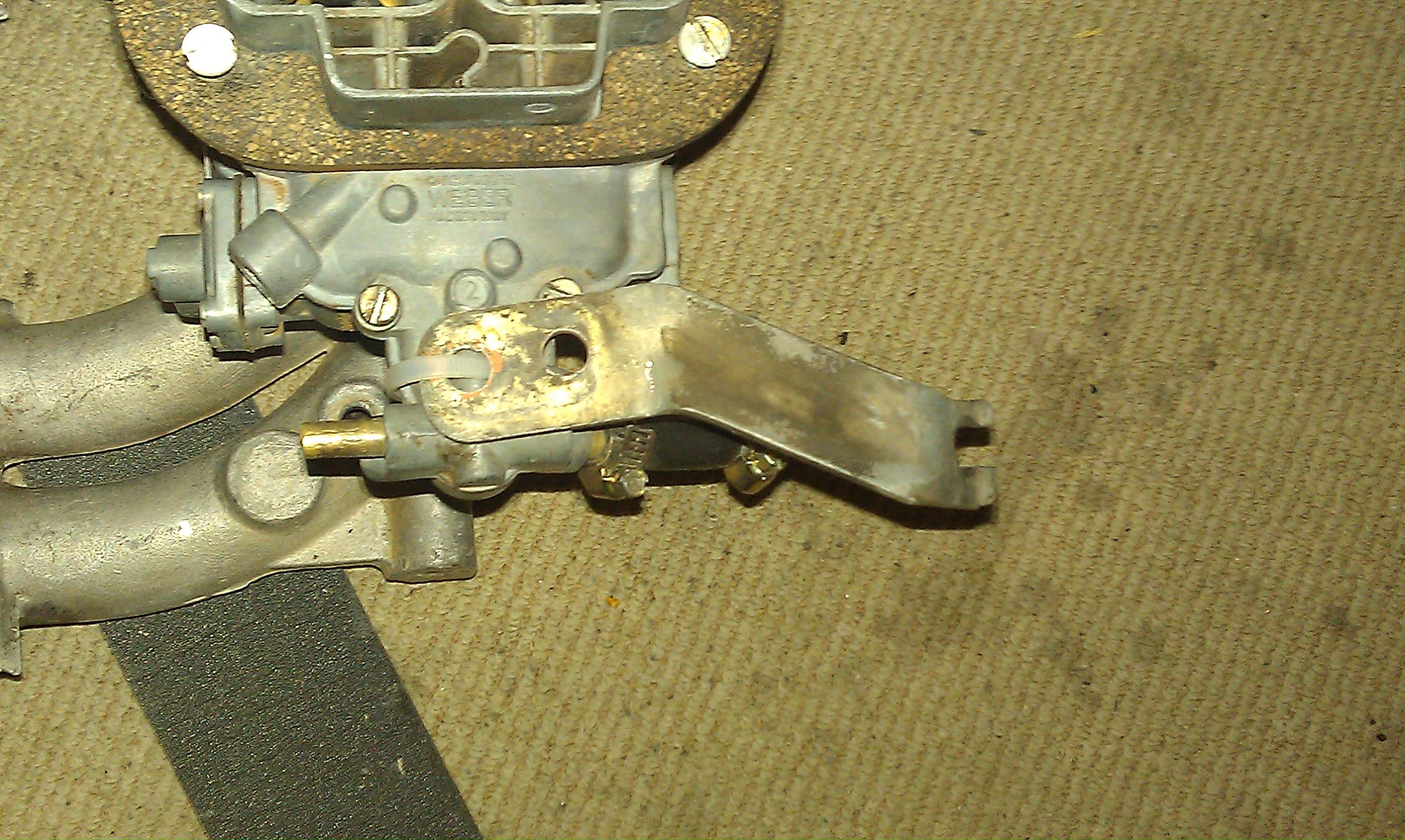

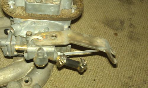

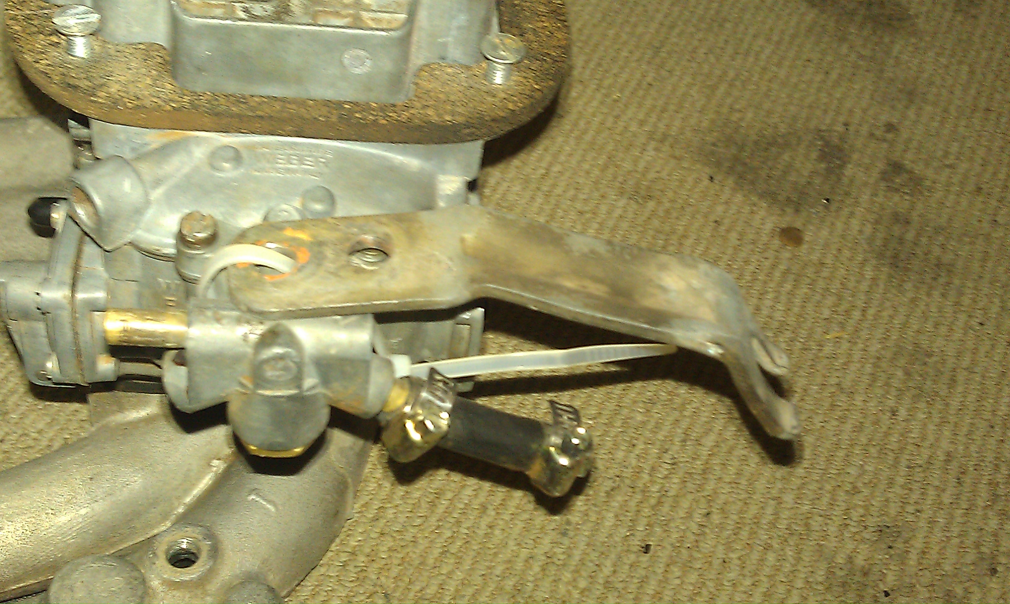

This is one that may have come out of a 70,I'm unsure,its just a factory toyota linkage
cut off,fliped over,and welded to the weber,this is easy and solves the problem
of the weber throttle rotating in the opposite direction to standard carb.
