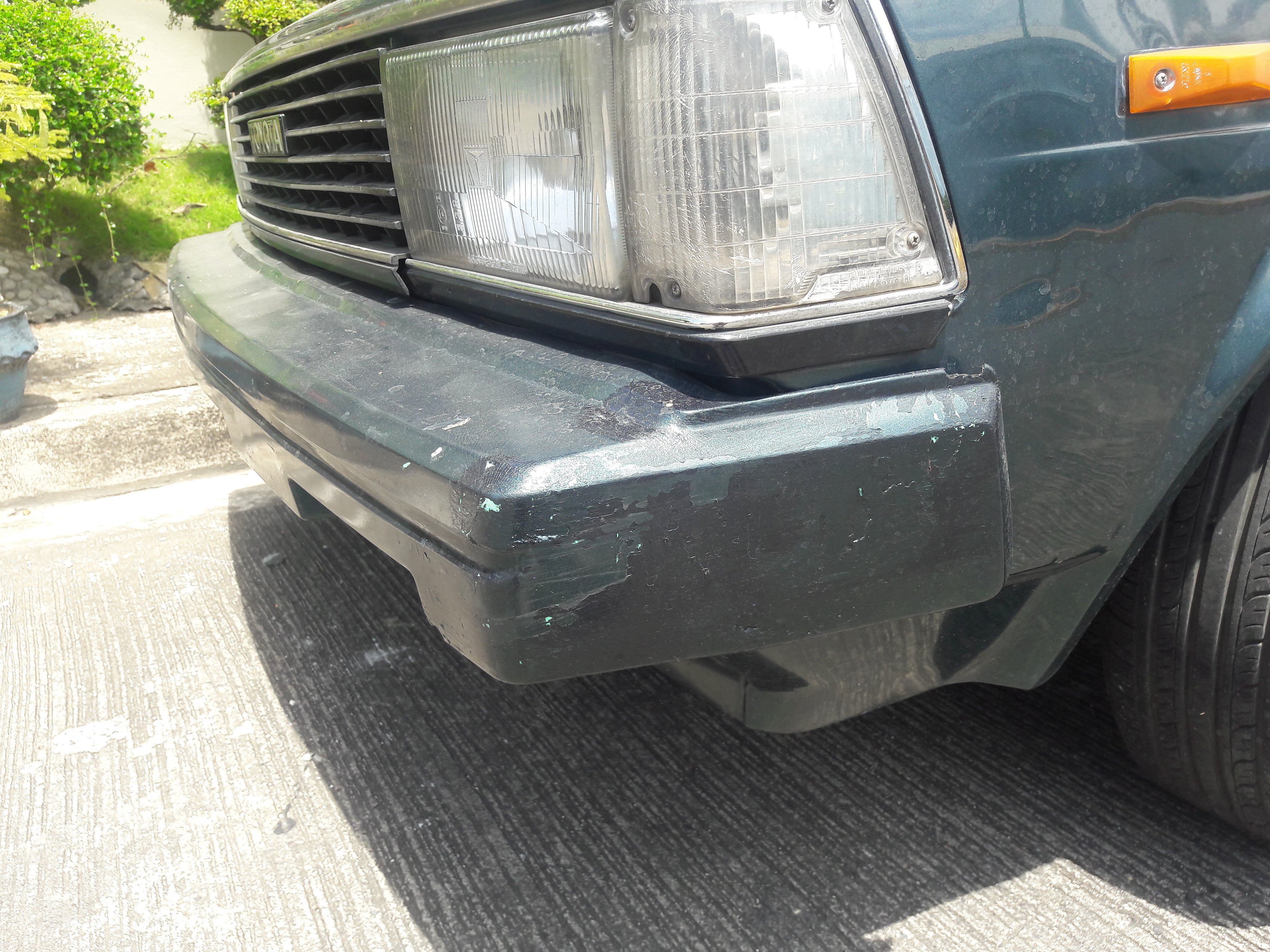

Do i need to change my fenders, apron, radiator support, hood etc. Anything else i need to convert it to quadlights. Thanks! Car model: 1983 corolla GL variant (philippines)
