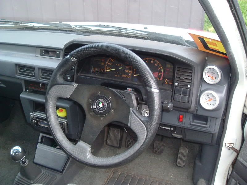

Its a daily driver so mods are reasonably limited at the moment, but I have done as follows.
2" straight through exhaust
Cold air intake and pod
KMAC Super lows and Monroe shocks
Bendix performax pads all round
New Steering wheel and shifter knob
South African import Dash
Custom twin 2" guage pod

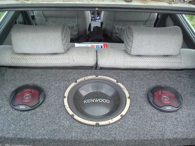

Covered the plastics in hatch with carpet along with custom shelf (the sub is now in a proper box, not in the shelf)
can't remember what else has been done... there are other mods but there pretty small.
I also have 4 sets of wheels to change the look of the car (and because I do too many skids). The only ones not in the pics are the 13" grandma spec stockies!

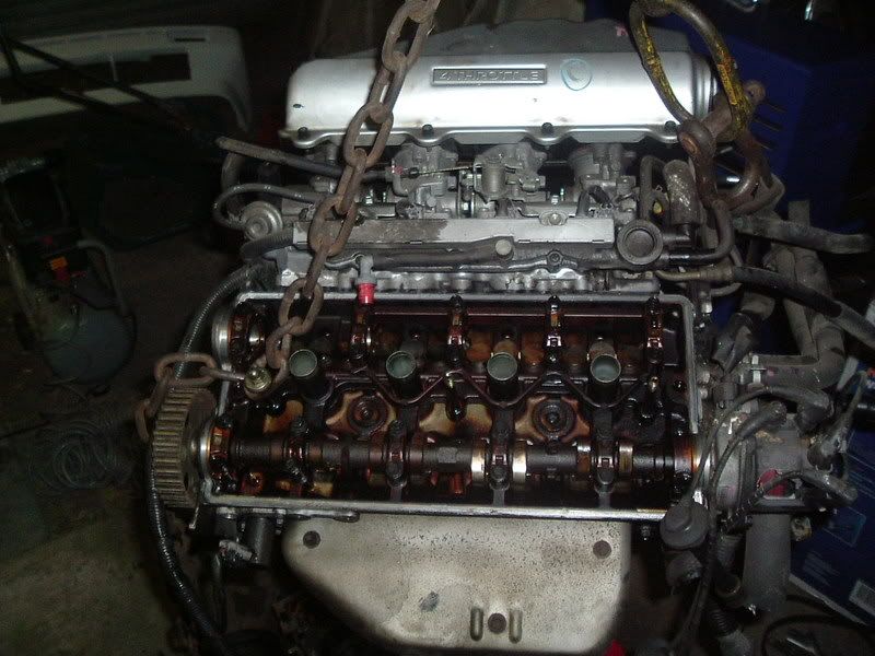

The next thing to be done to the car is my engine swap.

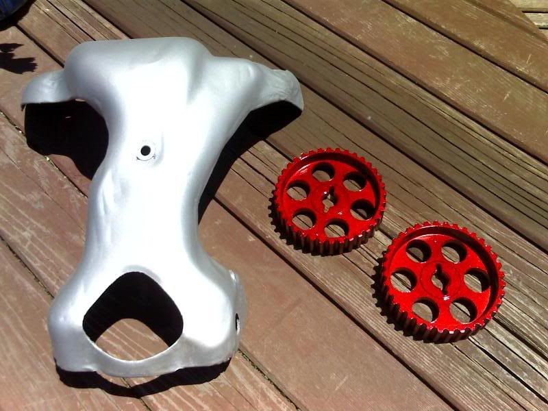

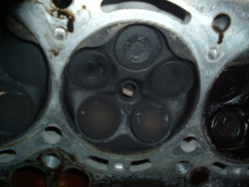

This weekend I am pulling the engine out and swapping it for my new engine. I have built a bigport using a 20valve block (you might have seen my 20valve head and tb's for sale). There are a couple of reasons for doing this, the main one being cost. I was offered a (very) cheap 20 valve with box so I snapped it up, that way I could sell the head and tb's to fund the rest of the build. Also, I end up with a much stronger engine with higher comp and a higher redline... without the pricetag of building a bigport from scratch.
Anyway, heres some pics of the progress... Will have more after this weekend!

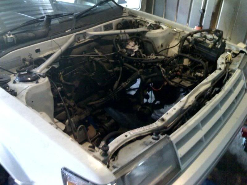

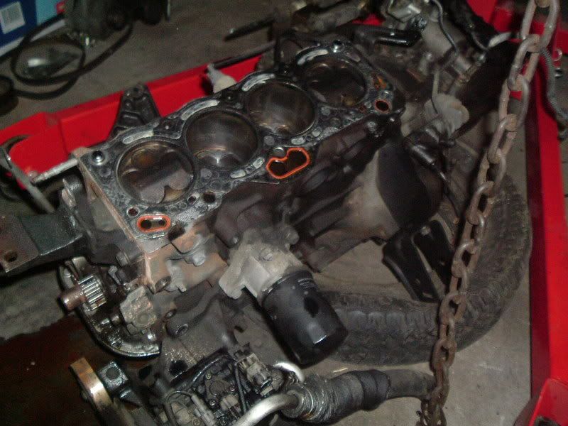

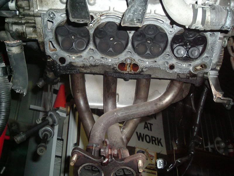

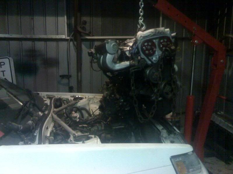

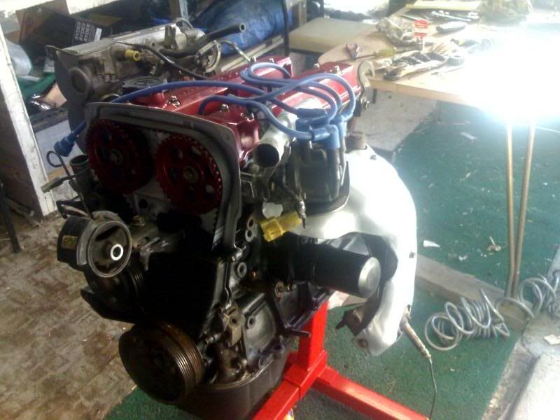

Well, what a weekend! After starting the swap thursday night I didnt get a chance to work on it again til Saturday morning, and even then it was only for about 4 hours. Thanks to Mrmoparman for coming over and lending a hand, made a big difference for the day!
Back to work thismorning I made a full day of it, I started at 9am and finished up at 10:30pm... like I said, I made a day of it!
I managed to get the old engine out and have it completely stripped and then put the new engine together and fit it up to the box... and managed to get it in the car ready to be hooked up and started. can't wait!
Anyway, the pics show a bit of the story... there off my phone so I hope there ok.

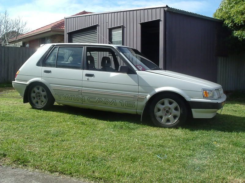

Heres a pic of the (almost) finished product for you all. It still hasnt been cleaned but I will get onto that!
