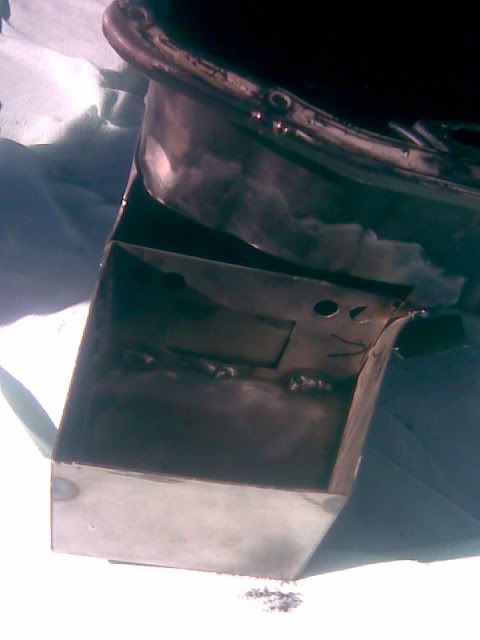

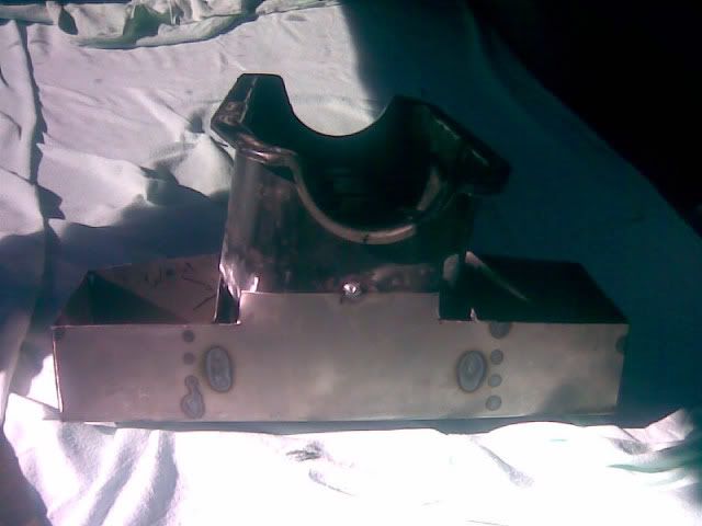

thought id post progress pics of my sump, its almost done.. getting final welds etc done to it right now. will be cleaned up and painted black for the finishing touch.

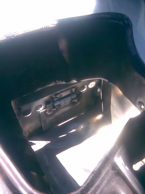

inside one of the wings... holes in the top allow oil to flow into the wing while drifting one way then when a transition occurs the gate will swing open and release another half a litre of onto the bearings.
what it looks like on the inside

That sump.........is massive.

yea the clips are there for quick release, i have to take them off to get it in my driveway or to put it on a trailer etc.

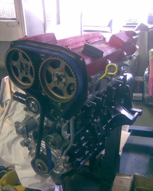

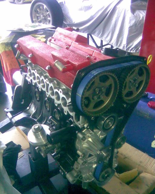

decided to throw up a pic of the motor all finished... sorry for the crappy phone pic.
all i gotta do now is solder one plug and put some oil in it and i can crank it over to bleed the coolant... then save for a tune :P:(

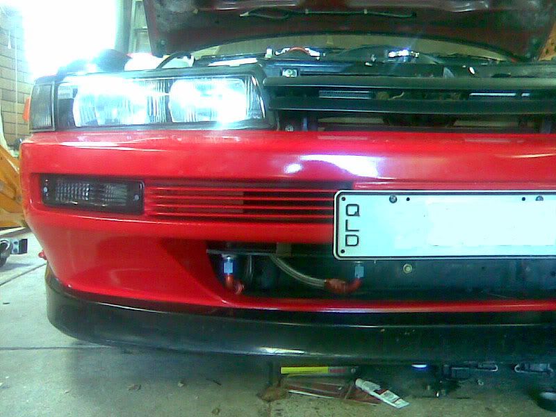

also a pic of my oil cooler mounted.
