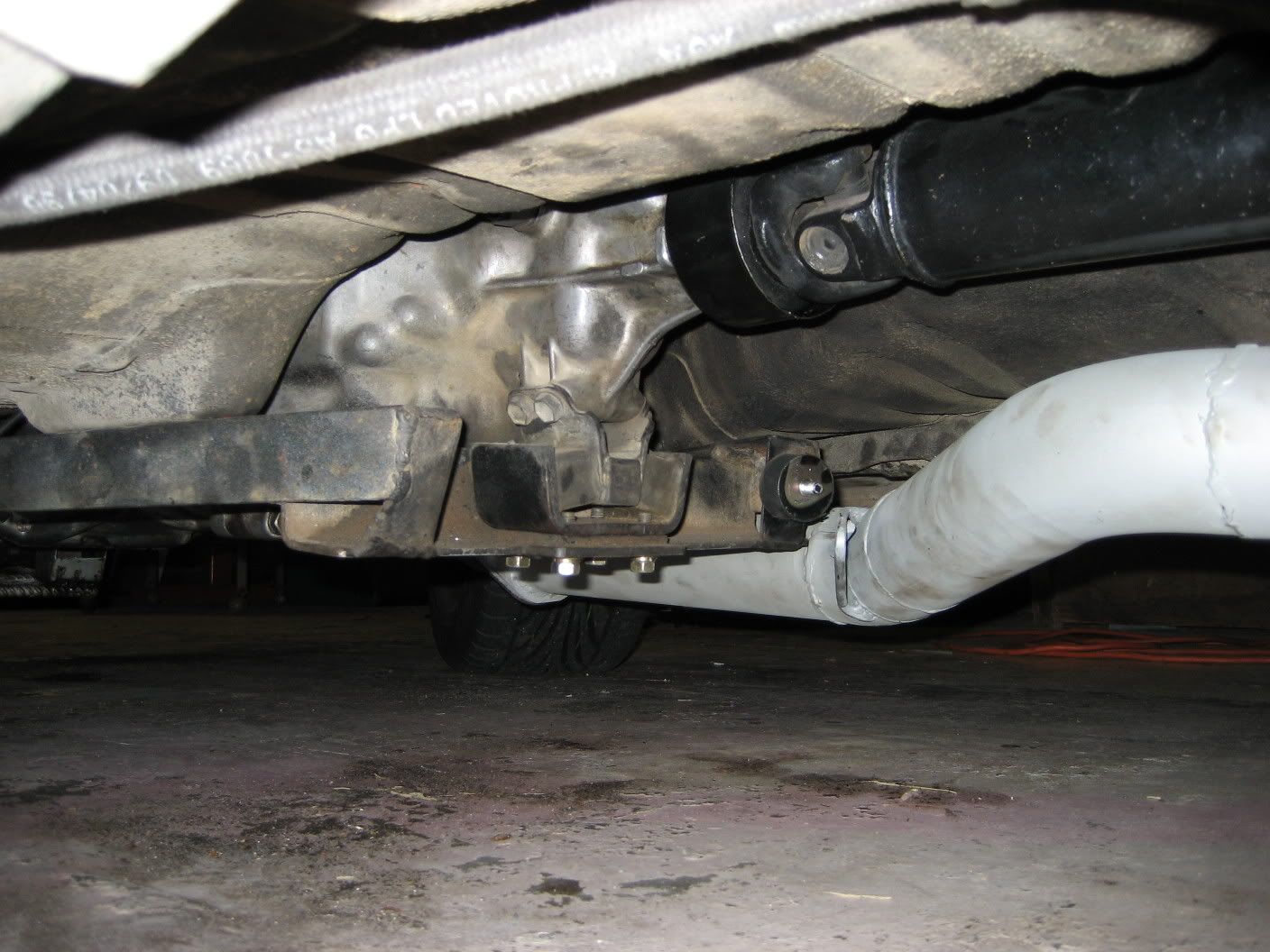

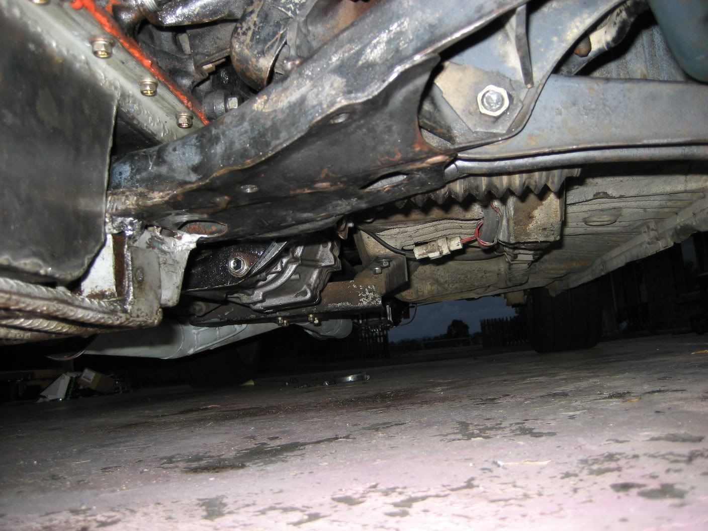

love ke70 Posted December 19, 2006 Report Posted December 19, 2006 make your own crossmember? if my ke70 with w57 was here i would take a pic of how simple these things can be to make. all mine has is 1 peice of thick angle steel on each end to bolt into the floor, and a peice between the two angles thats got holes drilled in it for the gearbox... hope this makes sense, ill take pics if you need, when i get it back from the workshop... Quote

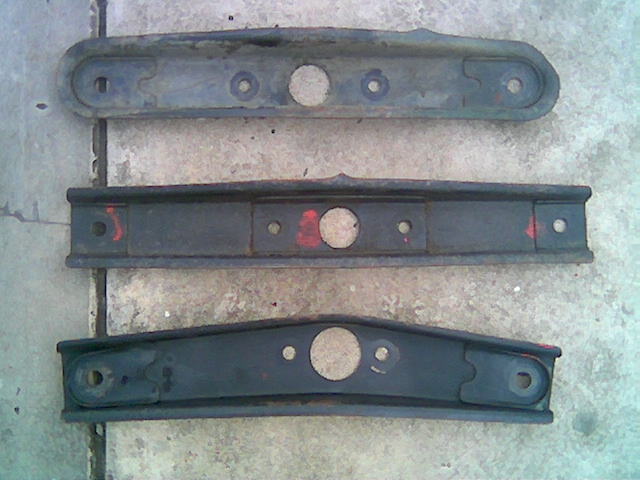

SKA80R Posted December 23, 2006 Author Report Posted December 23, 2006 (edited) Top- KE70 Panelvan JDM? (Vans were Imported from japan) K-50 x-member Middle-KE70 sedan (australian made) K-50 x-member Bottom-AE71 Wagon T-50 x-member The AE71 has the same bolt hole as my JDM KE70. The problem is it has to be bolted about 6 inches to the rear of where the original KE70 x-member went. Edited December 23, 2006 by SKA80R Quote

love ke70 Posted January 1, 2007 Report Posted January 1, 2007 hmm, i just took a couple of pics but the car was out on the drive and the stones dig in. so theyre a bit blurry and you can't see much. so ill put the car in the shed later and get some better pics. just remember its a supra gearbox under my ke70 so the mounting point is along way different so this idea worked nicely, but there may be a better way using a box almost the same size as what came out. if i don't get pics up, remind me tomorrow cheers, andrew Quote

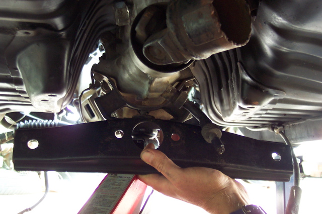

Rollin-Rolla Posted January 2, 2007 Report Posted January 2, 2007 if worst came to worst you could always make your own. its honestly not that difficult. had to do it to for fitting my sr20 into my ke70 sedan. http://i104.photobucket.com/albums/m164/pe...pg?t=1167743785 http://i104.photobucket.com/albums/m164/pe...pg?t=1167743833 sorry its a little hard to see detail as this was when i got it back from the powder coaters. but you can tell which way it goes as you have seen your ke70 mount. i also used all four bolt holes rather than just the two for either manual or auto models. just to make it bit stronger. with a bit of measuring its fairly easy. goodluck. Quote
love ke70 Posted January 3, 2007 Report Posted January 3, 2007 rollin-rolla thats like my crossmember, only mines a bit bigger, holding a W57 n all :D i think they explain it. with rollin-rollas off car pics, and my on car, you should be good :) Quote
Rollin-Rolla Posted January 3, 2007 Report Posted January 3, 2007 yeh you are right they are fairly similar. the only thing thats funny with mine is that i need to get spacers (alloy bush style) and place them between the gearbox and gearbox mount as that mount with the sr gearbox sits a little low need to up it about 40mm. I'm still in progress on my car not completed yet but all of the mounts and crap like that are done. once you get an idea what you need to make its pretty easy. Pete Quote
