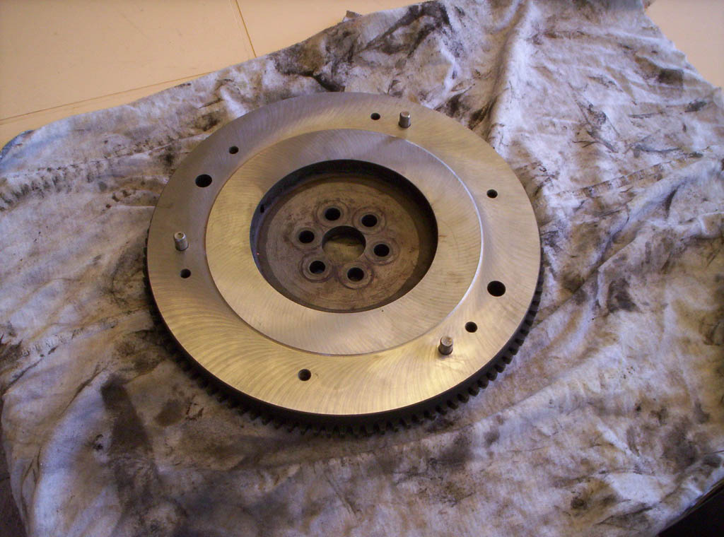

Raven Posted February 6, 2007 Report Posted February 6, 2007 I need to compare my flywheel step in my panel van as I think its possible they gave me too much step, hence the dodgy clutch at the moment. If anyone can measure me the height of the step and get me a picture, that would be greatly appreciated. Quote

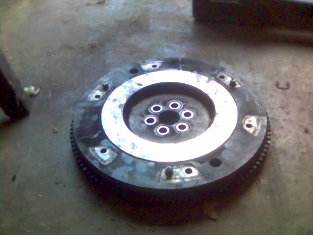

Raven Posted February 7, 2007 Author Report Posted February 7, 2007 That'd be great if you can Rob. ;) jamesrolla: I'll post a pic of my flywheel up. You'll see the area where the friction plate clamps onto the flywheel. Quote
OniBerserker Posted February 8, 2007 Report Posted February 8, 2007 hey man I dug up my 4k flywheel measured with steel ruler, step is 1mm or 1.5mm pretty sure its 1.5 but mines dirty Quote
Raven Posted February 11, 2007 Author Report Posted February 11, 2007 Cheers OniBerserker. I think mine's a little bit bigger than that from memory. Will find out this coming weekend when the gearbox comes out again *sigh*. Starting to become an expert haha. Quote
styler Posted February 14, 2007 Report Posted February 14, 2007 hey if you look on the xtremeclutch or daiken/exedy website it lists the flywheel step height for their clutch kits. Quote
Raven Posted February 23, 2007 Author Report Posted February 23, 2007 Just had a look at the Exedy website, and it says the Flywheel profile should be 1mm. Me thinks they screwed up when machining. Just gotta find some time to pull that gearbox out... Quote
