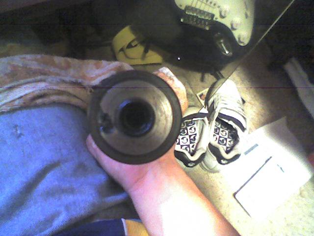

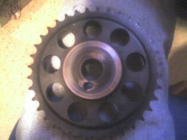

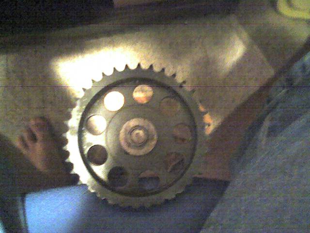

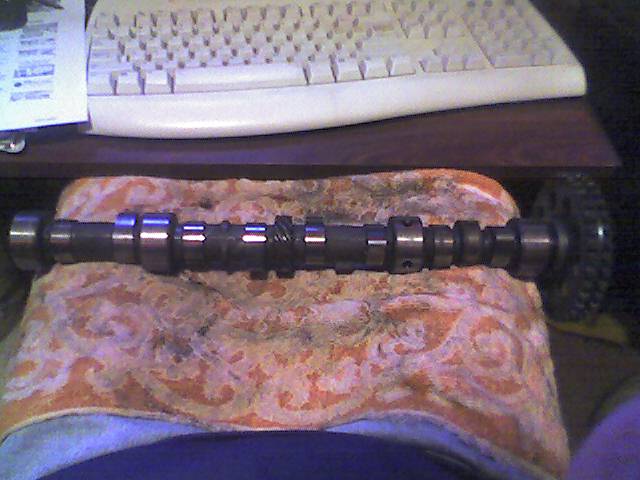

Ok just before I type my reply to the latest postings I will just post pics of my dead cam shaft (semi dead) as I can save it adn reuse it later.
Above is the side of cam.
Front of pulley, Also this pulley was custom made to suit this cam as the timing mark is a tooth forwards to the original K motor pulley and it has been machined out of solid stock and not cast like a stock unit.
Here is the cam notice pin missing..lol It has taken the load of the cam due to the main bolt coming lose and it took the full cam load. The chip of metal also jammed in the thrust plate so I had to replace that also as it was eaten out and in a bad way.
Back of the wheel. As you can see it has stretched the hole and deformed it so it is not serviceable in this spot which is a pity it was a nice cam sprocket :P
But I have thought drill a new pin hole 180 degrees around the wheel and on this cam shaft and it should be usable just u install differently to how it would normally be done eg timing mark at bottom not top of the wheel when installing. As the cam is still good no wear and the cam face that oil sits between on the thrust plate is still good as a straight edge adn a feeler gauge showed me so I might try this cam in my 4K yet.
