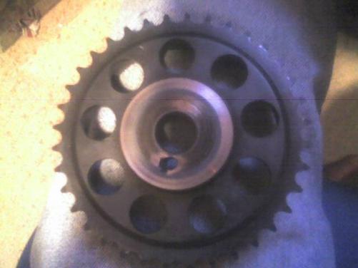

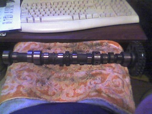

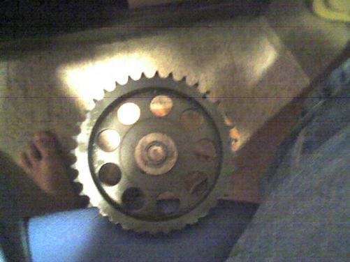

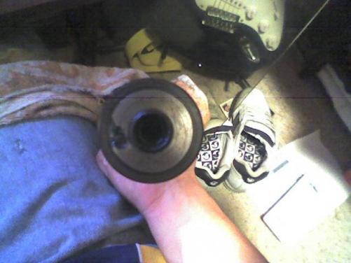

Hi,
Well all those who said use regrounf cam and move it one tooth well bad news. I can't..lol Turns out the pin on the front of the cam has snapped shattered the front of the cam and it was all lose and 10 degrees out so it is pooped so in goes a standard 4K will post pics after I finish putting motor back together about 50% through cam swap now..lol

Oh well at least you now know what the problem is.
