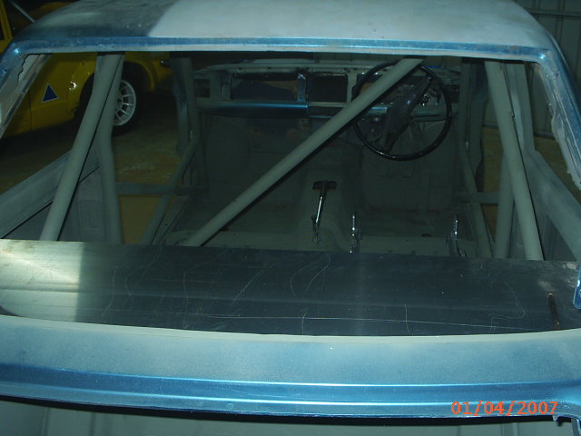

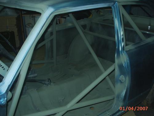

Hi All,
Another small step in the process.
The car is back from blasting the internals out (3 weeks longer than promised!!!). Now ready for the rear ally panels to seal off the top & rear bulkheads from fuel. Just need the rivets to fix into place. Also the brackets for the TA22 fuel tank are to be made to fit in the boot where the old one was residing. Both will be done over the easter break as well as a group sanding effort on the rest of the body.
Another quick job of the seat brackets to be finilised for the set of Velo's to be added when painted.
Hopefully looks like a car once the paint has been done.
The next set of photos will starts to show real progress.
DMC
