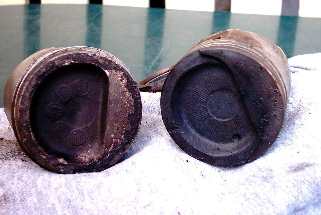

I can't remember off the top of my head, but there was something like 16cc's in the piston of a dished 4k (twin squish type). Depends on what pistons are in it as there are 2 different types of 4k dished pistons.

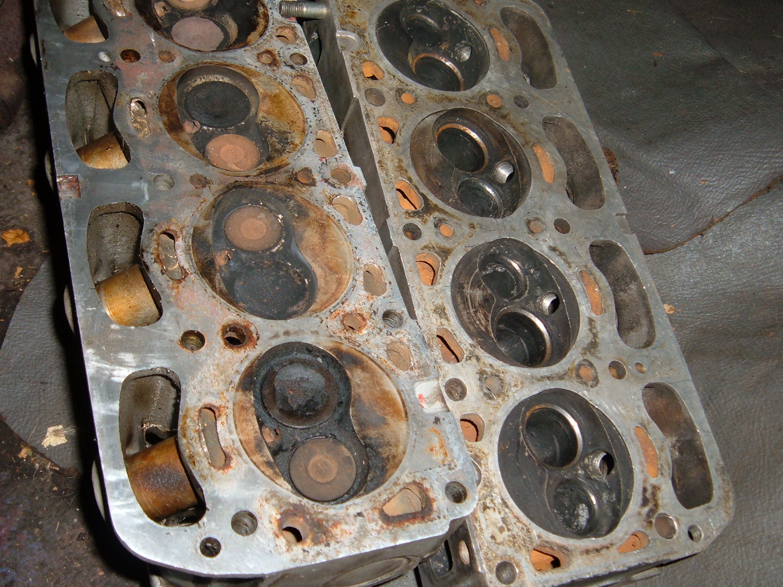

this it what i mean
Use either of those heads and you WILL need some sort of dished piston, not sure how hard they are to get .

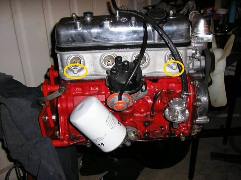

The dished piston 4k motors are easily identifiable by the heads having cast protusions under no1 and no4 spark plugs (like on a dished piston 5k). They share the same head. Have a look in the pic below so you know what to look for in the wreckers and such.
