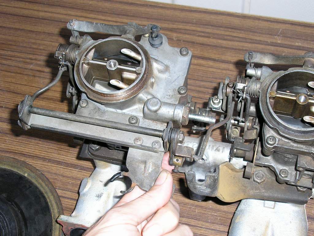

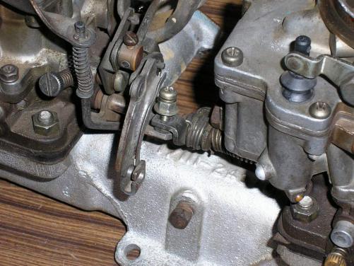

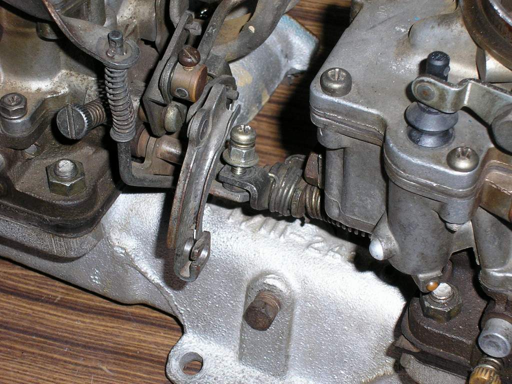

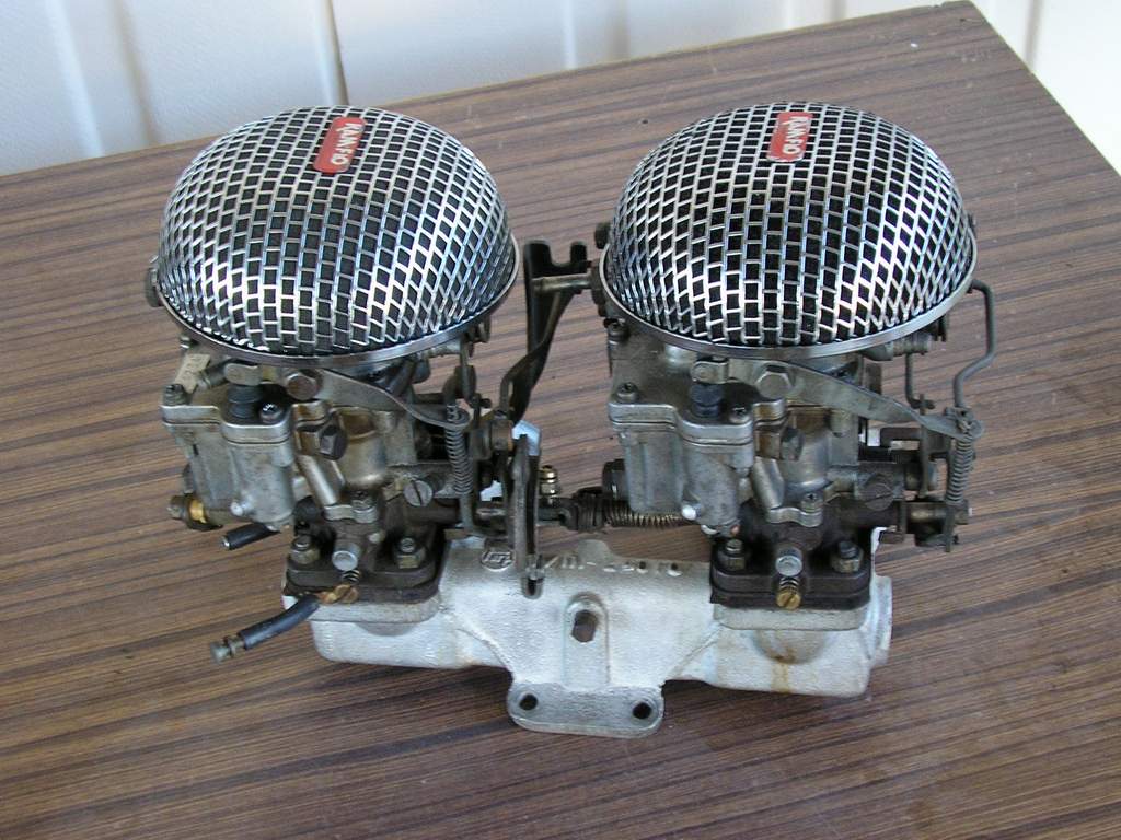

I don't have any decent pics of when I ran my twin aisans on my ke15. I do have some pics of my twin aisan setup on the bench. If I get time tomorrow I'll see if I can resize them and post.

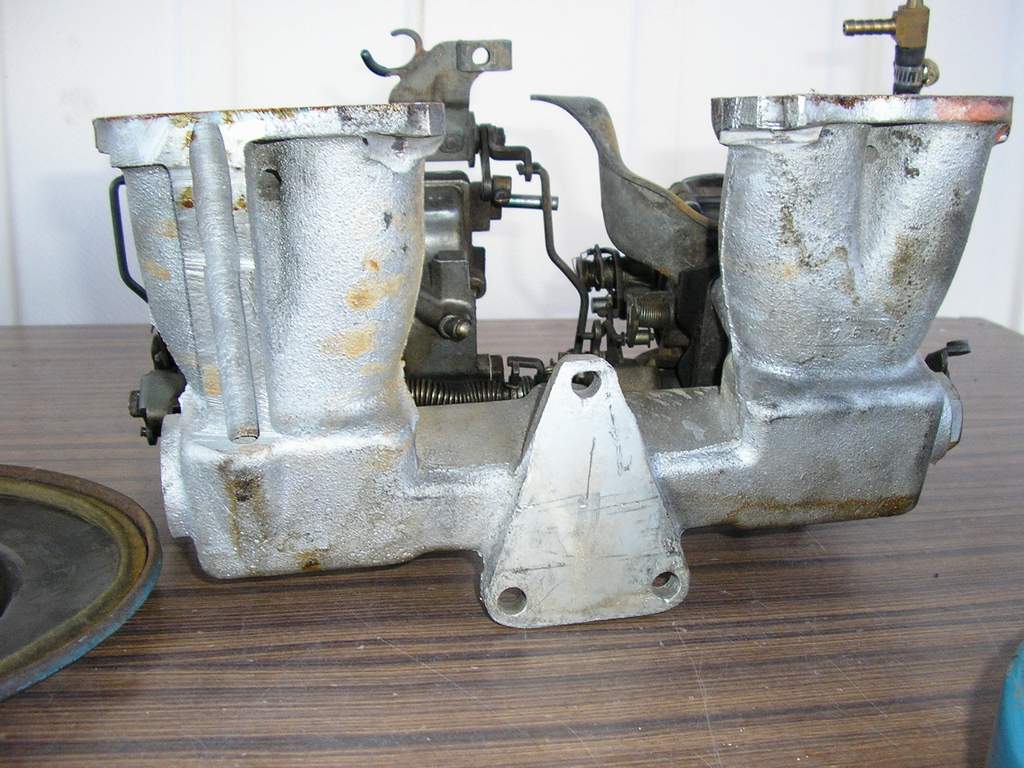

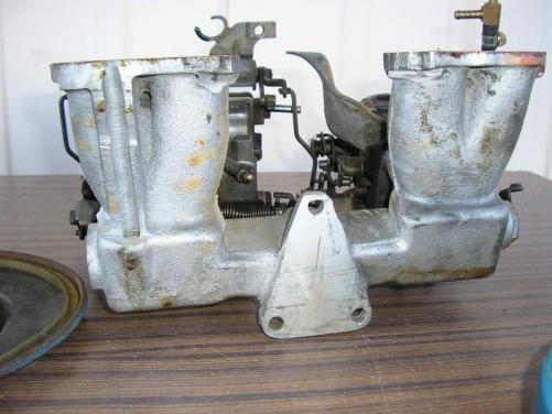

I wouldn't worry to much about the water heating. My carb setup had the water passage ground off the base of the manifold. Just takes a little longer to get up to operating temp, use the choke a litlle longer on cold days. If we lived in a really cold climate the water heating would be of more benefit.

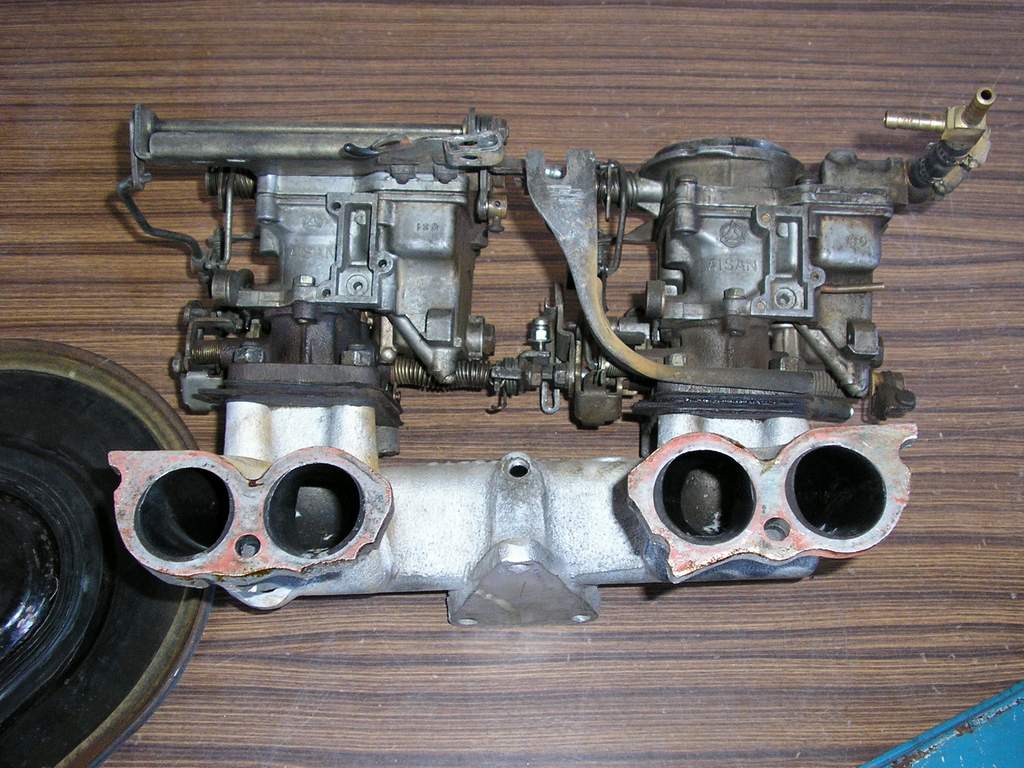

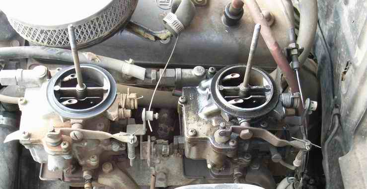

Here are some pics of my carbs. Should give you more of an idea of how the linkages go. Also there is a pic of the water gallery under the manifold and how it has been ground off on my setup. I didn't grind it off myself, it was that way when I got my carbs.

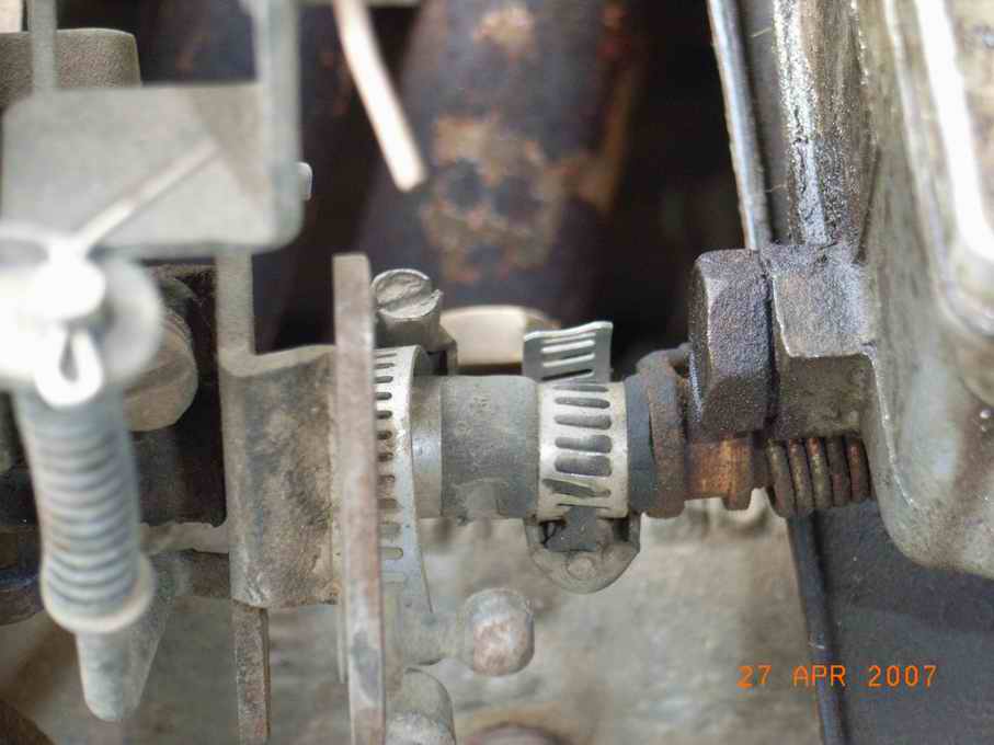

just linked mine up with a piecs of fuel hose clamped onto the throttle shafts and ran the cable off the back carby as I didn't get the linkages when I got my minifold, but if its a restorer then this wouldn't be original.

Felix thanks HEAPS for those pictures will be a big help.

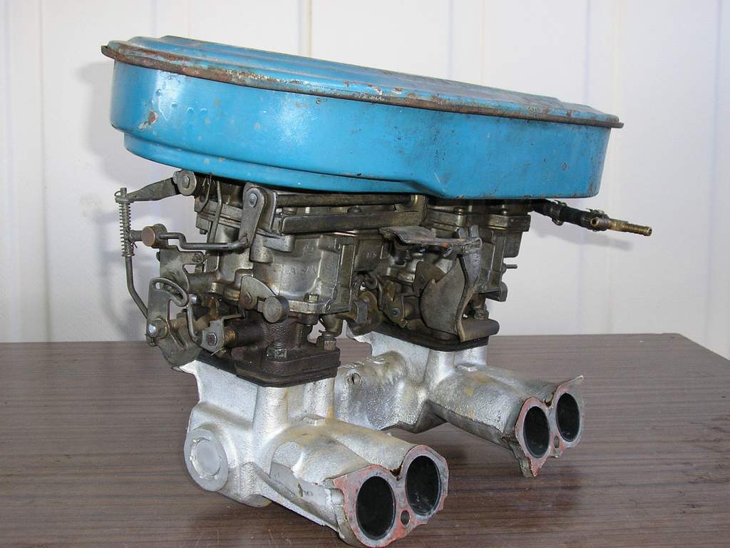

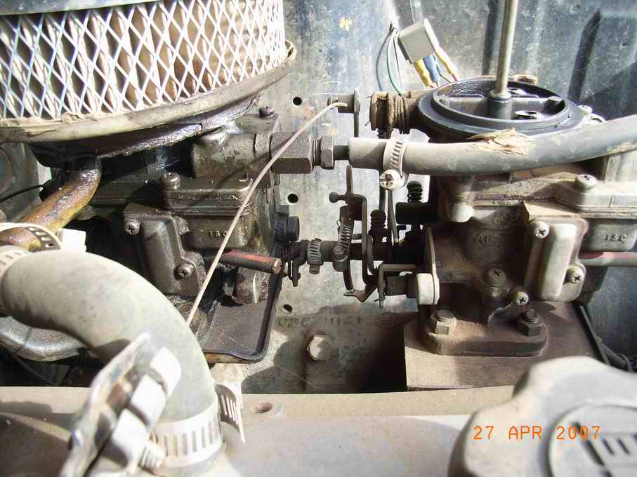

Ta Kangaroosa, beat me to it. Will get a close up if you need it.
Hi,
Thanks for that link. But if possible coln72 could I get some close up shots. As yours as on the car so it will show me the cable link up better etc.

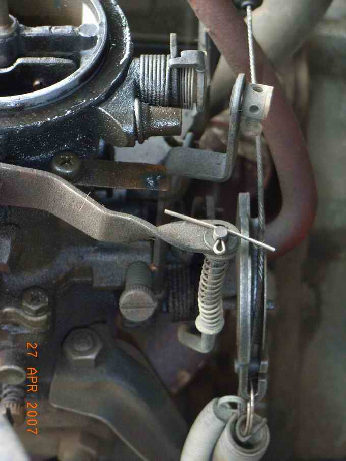

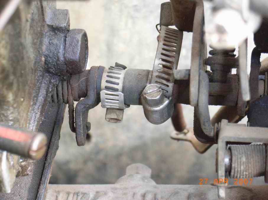

hope these pics help. Remember that this is a made up system as I was only given a manifold and I hade to stuff around to make it work with spares I had laying around.

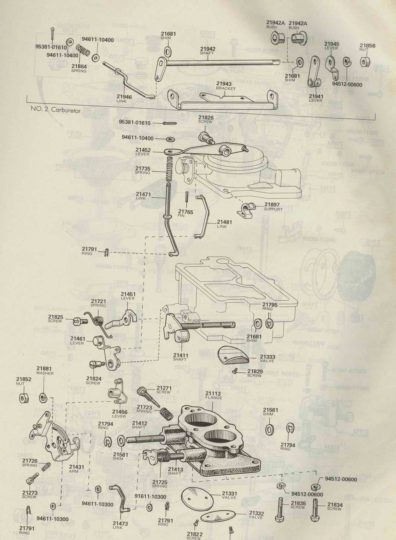

this is the only pic in my parts manuals that sorta shows the linkage
hope it helps (sorry about the quality)

Today I finished assembling my K-B intake assembly. After just going off the pics you guy's supplied and a few cingle carby setups I had at home I was able to assemble the carbies again.
They all work and I decided to totally strip the carbies down clean and reassemble bead blast and paint a few parts also as the cad plating on some parts from Toyota was gone and corrosion was setting in.
So Below are some before pics of what I had when I started:
And below don't let eh neatness in this pic of the carby box I had fool you. Linkages missing, stuff bent, rusty, full of dirt, missing parts etc....
Now end of todays finished item. A fully bead blasted adn painted and clean K-B setup on a GENUINE BIG PORT manifold ready to live life again. I also included some close up linkage photos for you to see. Also I like this notice my stainless steel lock wire holding linkages together. Had no split pins left and I had this wire from my place of study at BAC (Brisbane international airport) where I am studding so I though if it breaks about now planes will be falling out of the sky everywhere..lol Also wont corrode :)

That diagram was from the KE2? manual which I have two different versions. Also have a KE3? one as well. All 3 list 3k-b carbies.
I think my manuals are pre production ones as they have not for official use printed on the covers. Got them for $20 from a swap meet.
