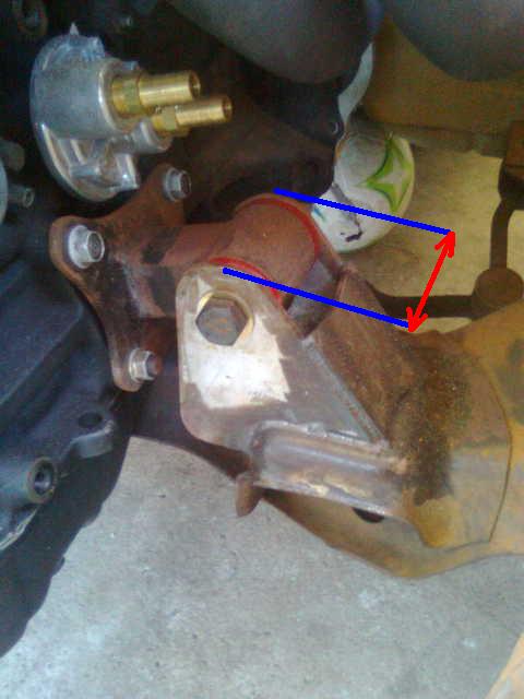

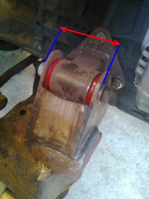

Hey there,
I am just about at the stage of making my engine mounts like the ones you have in your car. Could you measure how wide the mounts are (outside measurements) that have been welded to your cross member.
This is the measurements that I am after.
Thanks

Hey there,
Thanks
80mm is the number you're after my friend, just measured it.
Thank you very much :y:.
