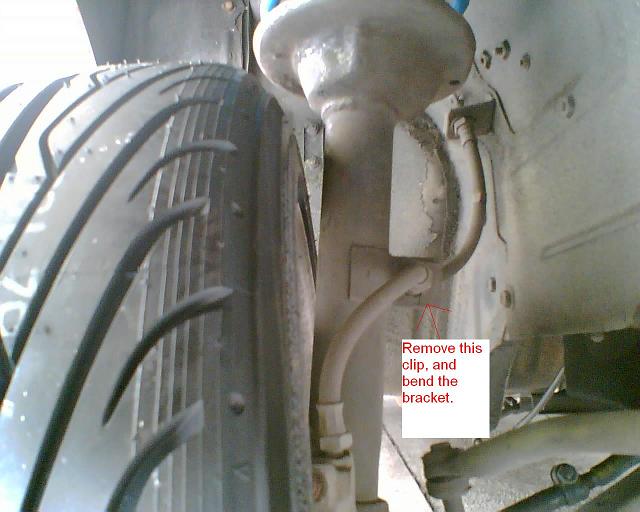

yeh thats what I'm deciding too do now. just stuck on taking the brake hose off the bracket, do you actually have to seperate the hose so brake fluid comes out? or is there some other way that i can't see :P, since the bracket is welded onto the strut
Remove the clip that holds the brake line to the strut. On mine, there is a slot cut through the bracket. That allows me to bend the bracket upwards (creating a larger opening) so i can slip the brake line out.
