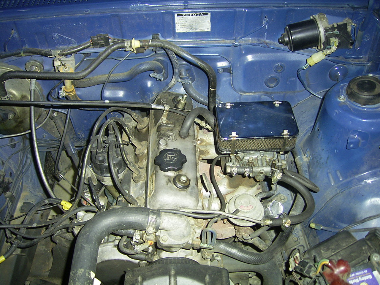

I am after some help with working out "wtf" is going wrong with my carbie. Have a 32/36 DGAV Weber on the 4K since the Aisan one shit itself. All was working fine with it over 2 months or so, but now something is wrong and I am unsure of what it is. The car will not rev at a steady level. If you try to hold the revs at a constant mark, the engine drops in revs then kinda splutters back up then drops again. The same goes for the idle. It barely idles, and when you adjust the mixture screw, it does hardley anything. The screw can be the whole way out and the engine still runs like it was halfway in. When you try to increase the idle speed, the engie just picks up then dies then picks up again, much the same as when you try to hold it at a constant rev. :P It is almost impossible to drive the car as everytime I clutch in, the car stalls, and also, any small acceleration and the car just starts bunny hopping foward even when the clutch is out :P I am stumped as to why it worked fine now all of a sudden it is running like crudler. All the manifold and adaptor plate studs are tight and the vacuum lines seem to be all free from blockages. The jet sizes that are in the carbie at the moment are 132 main and 165 air in the primary throat, 145 main and 175 air in the seconday throat and has a 55 idle jet. I'm sure that these wouldnt be the problem as it was working fine until today, but if anyone could please tell me what size jets they run, that would be appreciated. Here is a photo of what the carbie is like on the engine. Please, if anything seems funny, let me know.
If anyone has an idea of what may cause this, that would be great. I may even be wrong by thinking it is the carbie... :D
Thanks in advance, Alex.

The intake manifold looks a little dirty under the fuel lines. Had a fuel leak lately that the dirt has stuck too?
Edited by kangaroosa
That was from a few minutes earlier when i disconnected the fuel hose from the carbie. A little bit spilt out onto the manifold and yeah, that is why it looks wetish still.
