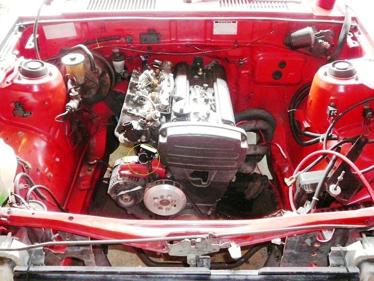

Hey did you buy one?
i really want to know if i'm still going to have to mod the water pump?
Their system puts the thermostat pretty much where a 4ac has it, and has no bypass. I prefer it, and use it in my car. The back of the waterpump goes directly into the bottom radiator hose, and the thermostat fitting pictured which points forward, joins to the head where the waterpump used to. I just try not to rev it past 4000 until the thermostat is open.
You block off the heater port on the back of the head behind the extractors and either modify the existing thermostat housing at the rear or I think the kit might have the right fitting from Yager. Not sure, I have a modded standard one.
Believe you can pick up the thermostat housings cheap that are a direct bolt on without any interference, had one in at work the other week and it had been done in this way.
LittleRedSpirit, it should comfortably take 4000rpm while the thermostat is getting up to temp, may run a slight bit warmer for a few minutes but as long as the plumbing is fine and your thermostat hasnt perished, all should be right as rein to pull high revs off a cold start :hmm:
