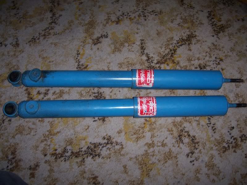

October 9, 200719 yr comment_202464 I just put some AE86 TRD 8-way adjustable in the back of my car! Direct bolt in..... They are just awesome!! :y: Report
October 15, 200719 yr Author comment_203459 I just put some AE86 TRD 8-way adjustable in the back of my car! Direct bolt in..... They are just awesome!! :y: they would be nice, but I'm trying to do this on the cheap help people! Report
