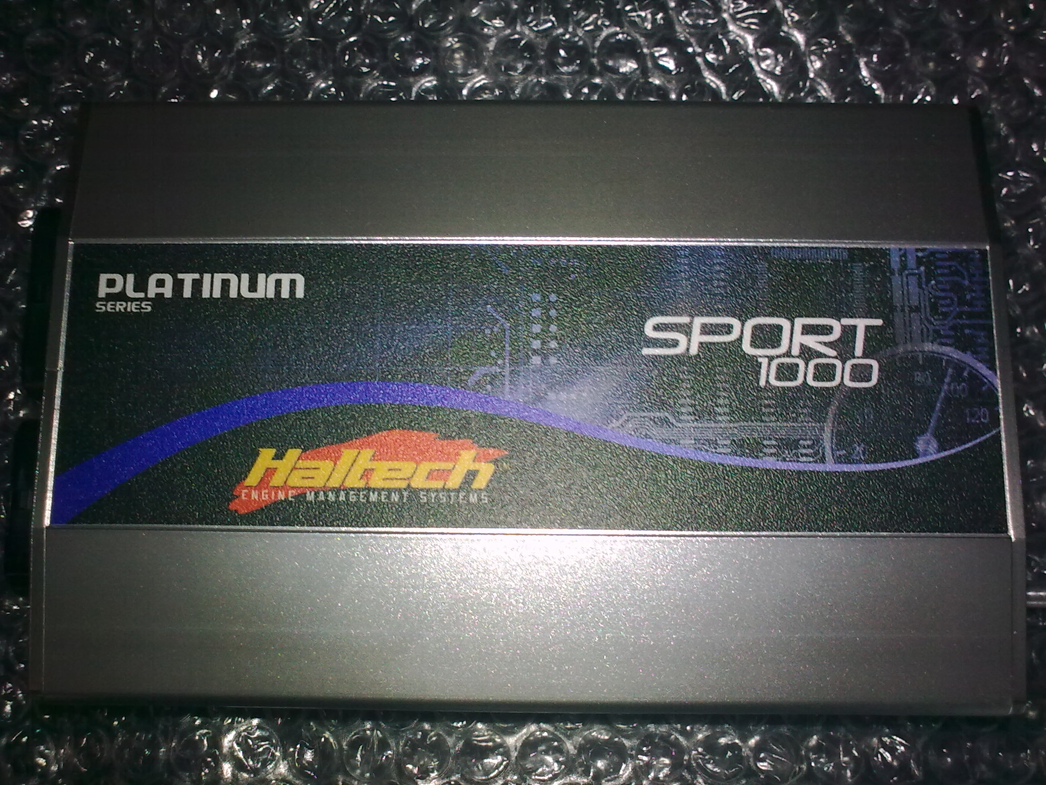

  2. I have brought and installed a Haltech PS1000. the car is now running but needs a tune. Here are some pics i have a video of it running for the first time, but i can post it up.

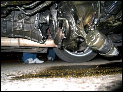

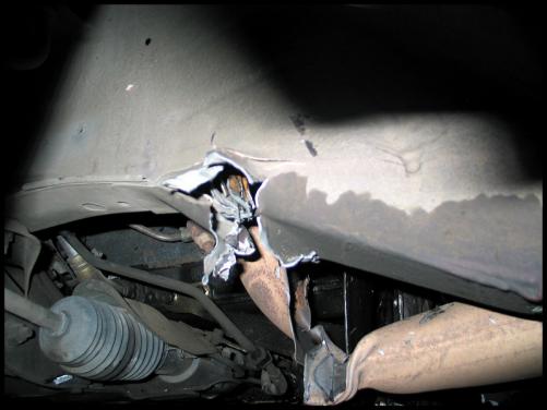

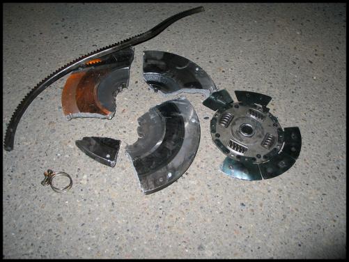

  3. Be very carefull with machining flywheels. Here is a good example of bad machining. (its not my car)

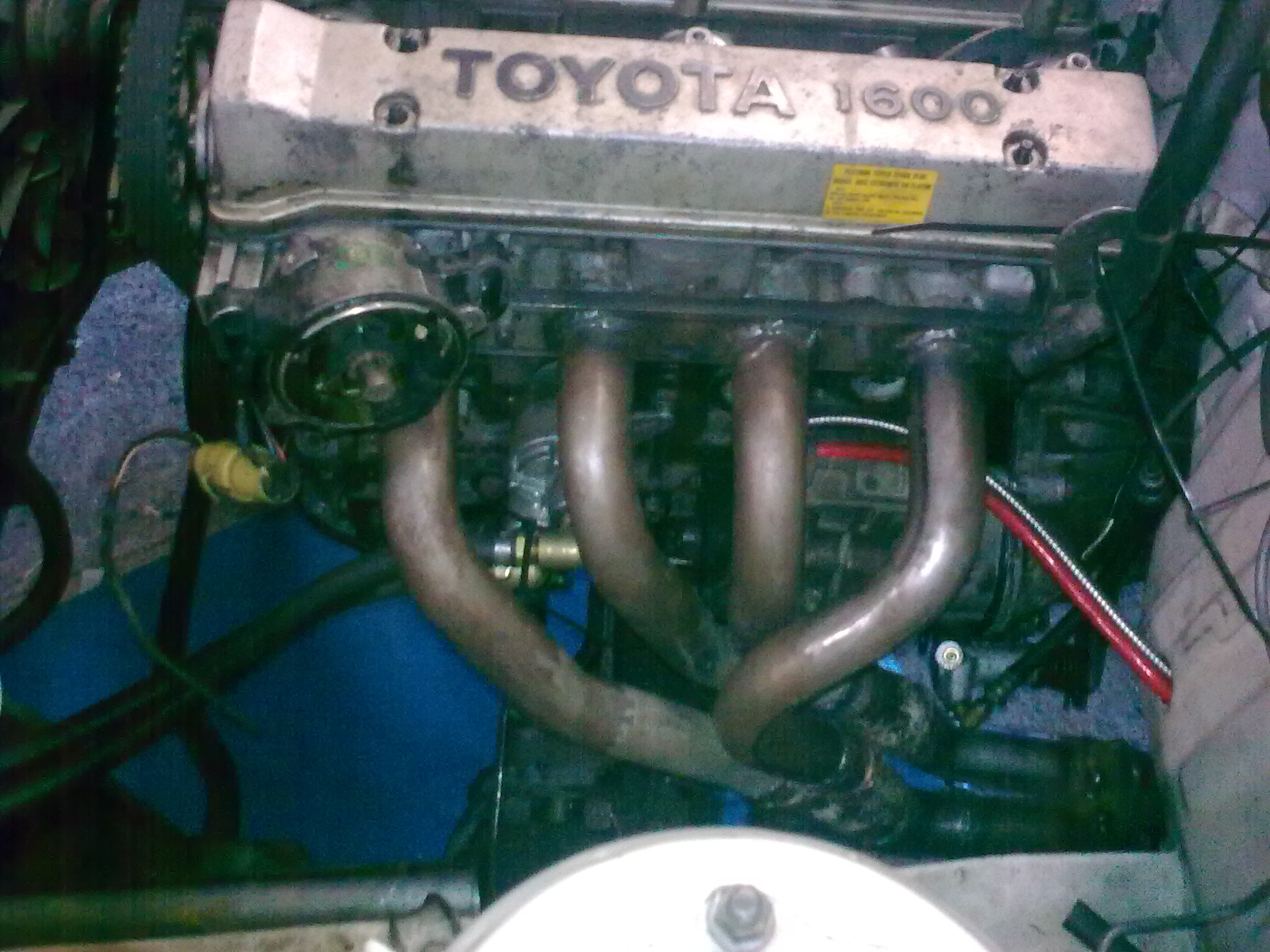

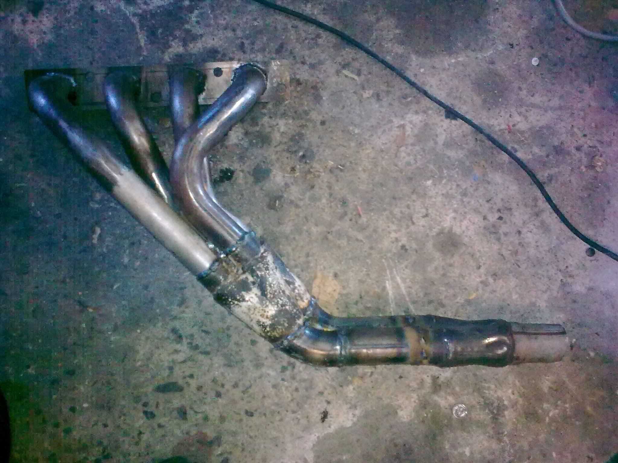

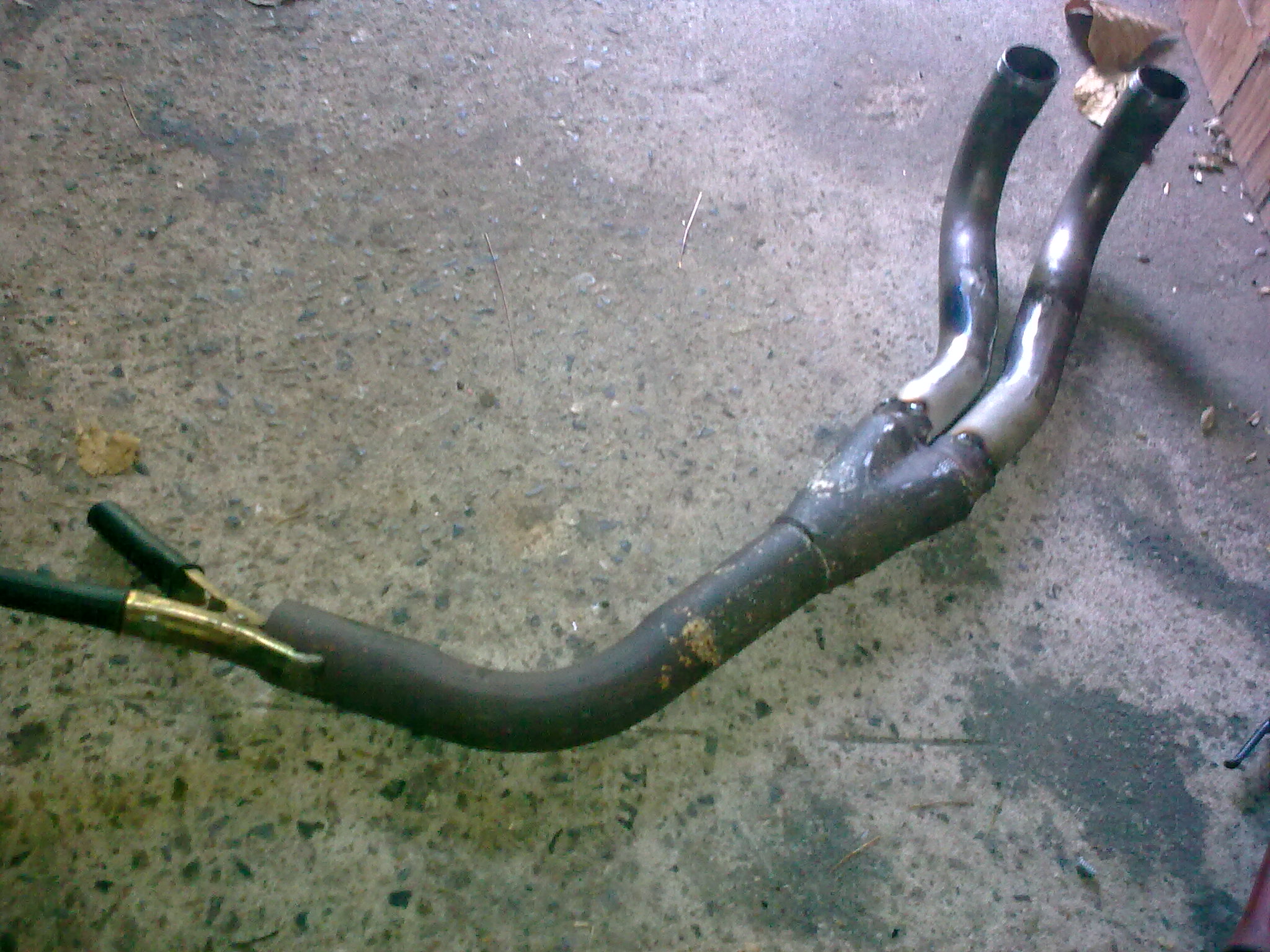

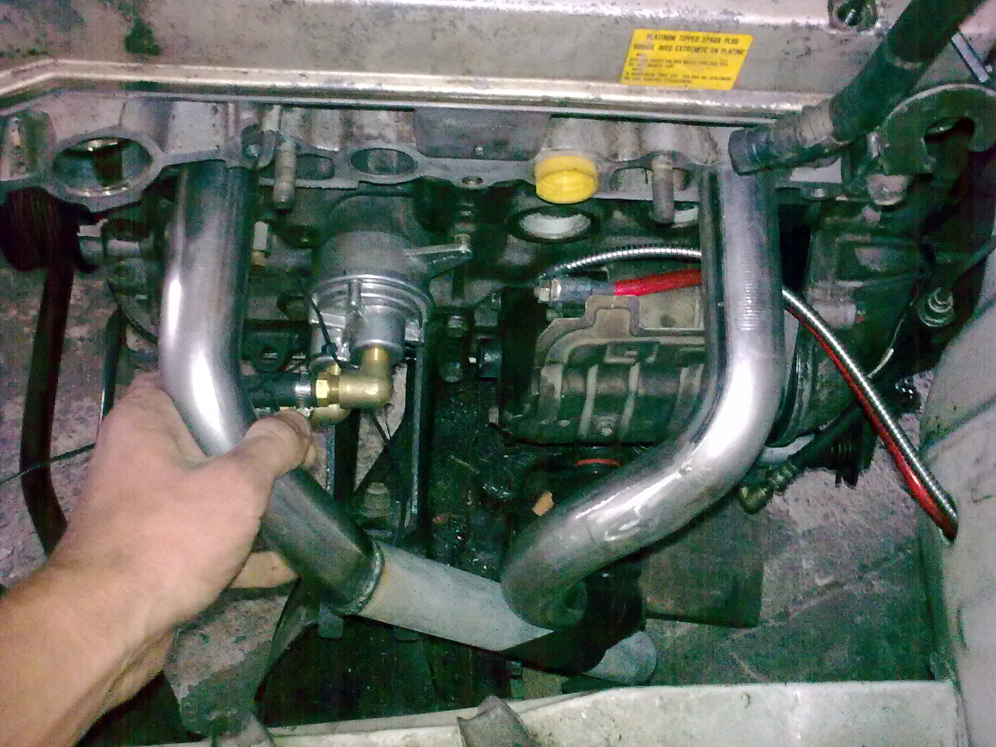

  6. I have recently built a set for the 4AGE in my Ke70. here are some pics, I used 1 1/2 primarys 375 mm long I used 1 3/4 secondrys that are approx 160 long. I could of made the secondys longer, but i was told that the secondrys had to be a little bit under half the length of the primarys. I am using this set of extractors just to get my engine running. if you want more info on my extractors PM me or look at my project thread, Cheers Jarrod

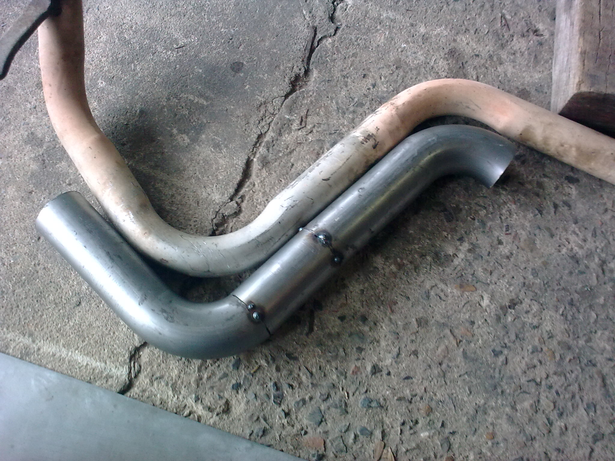

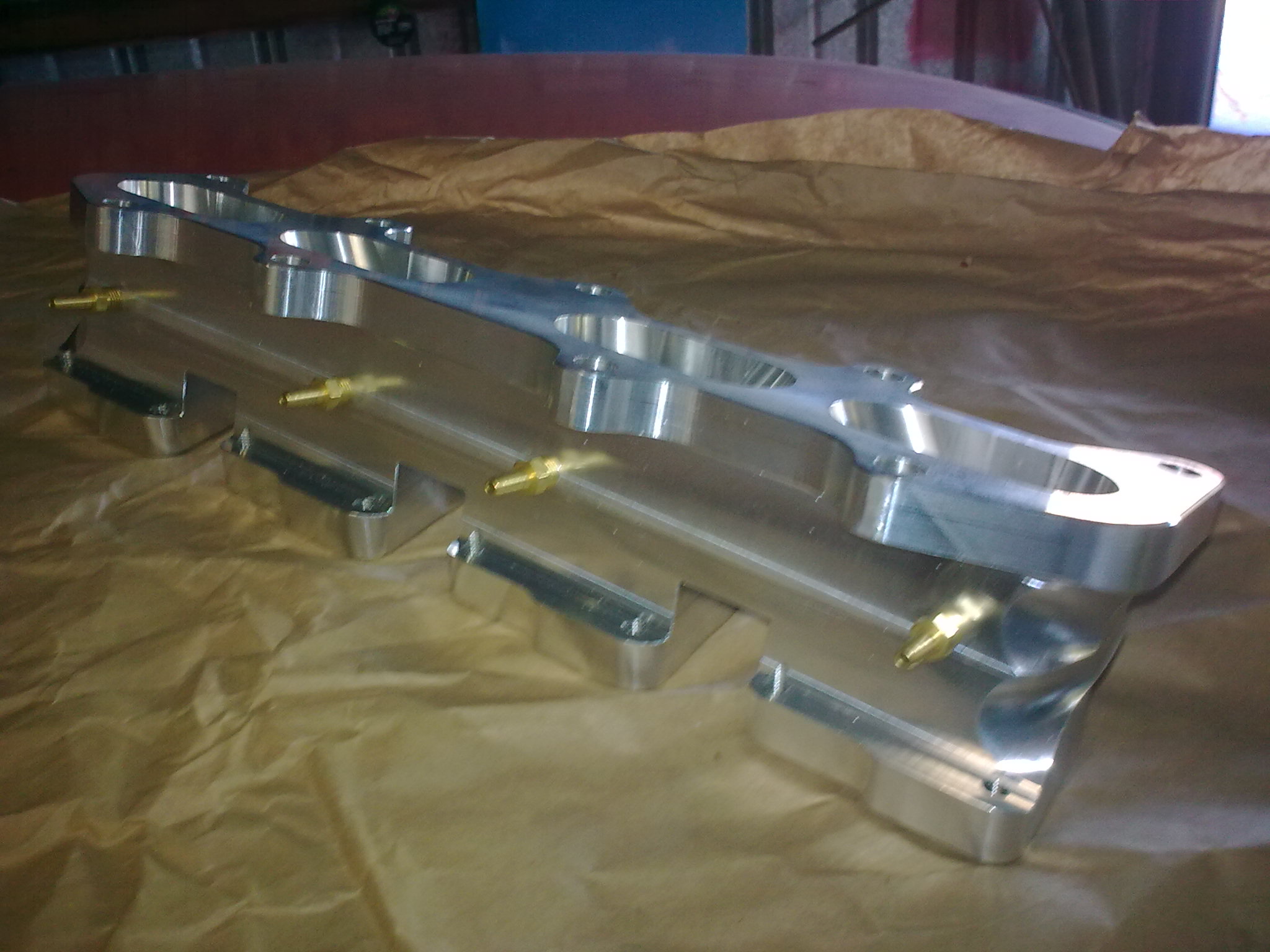

  7. i will be getting the fuel pumps and the inlet manifold over the next 2-3 weeks Here is the bend for up and over the diff i have put an excel radiatior in now and i will put more pics up later Cheers Jarrod

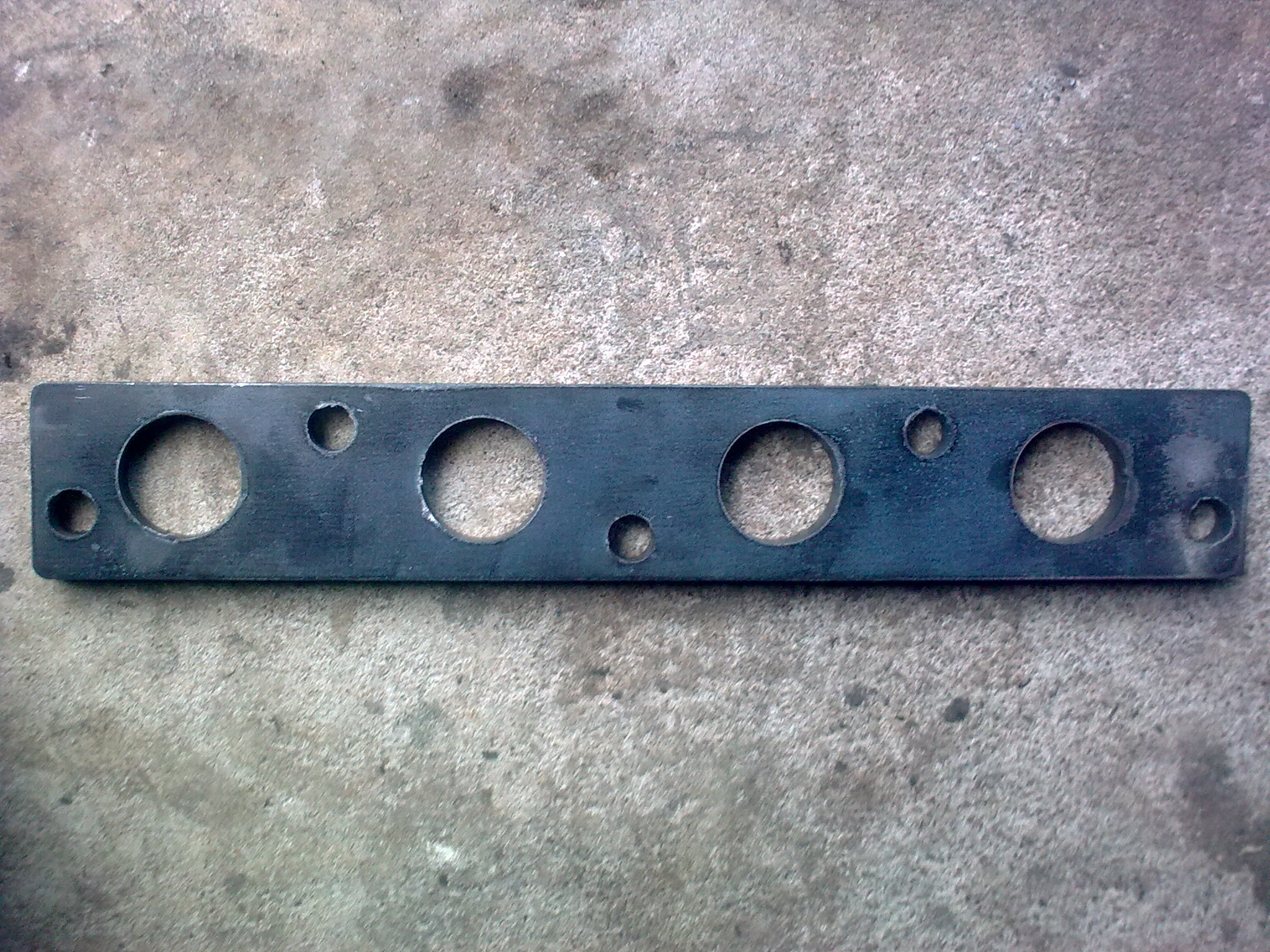

  8. just a couple of tricks: Machine the flange flat before welding anything onto in take lots of time to organise pipe layout (Clearances between starter motor, steering boot, chasis, clutch, ect Weld pipes in stages (e.g 1-4 to the collector, 2-3 to the collector then weld 2-3 onto flange, ect) don't get too much penetration on welds (too much penetration will reduce the ID of the pipe causing more restriction) get pipe lengths as equal as possible tack pipes together before welding properly get extractors machined flat after all welding is done
  9. here are some pictures of the extractors

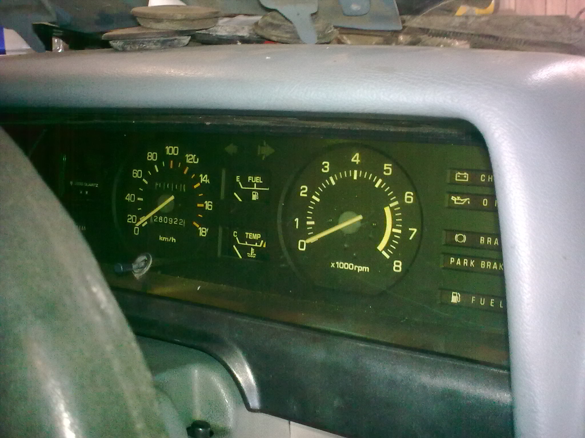

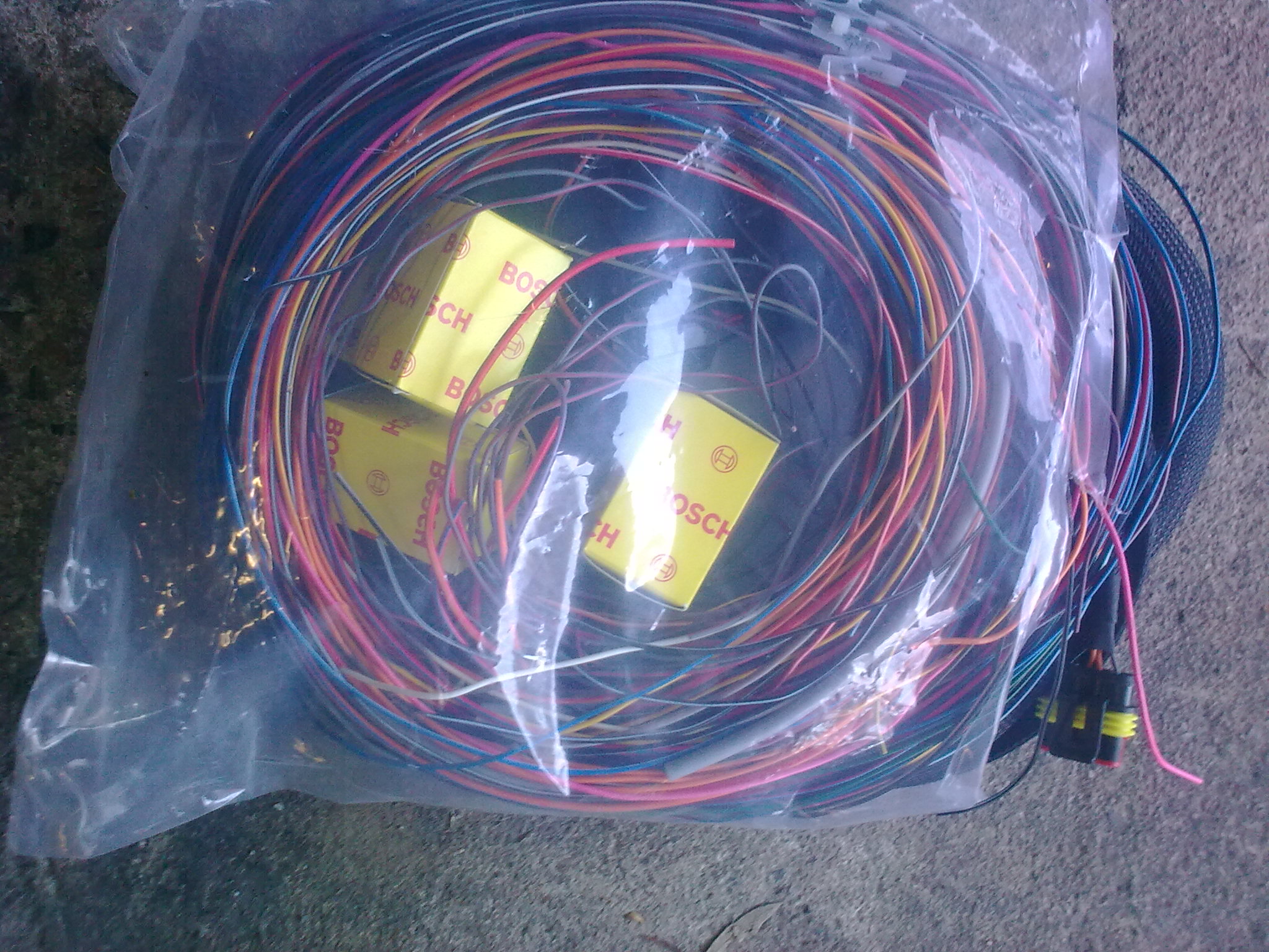

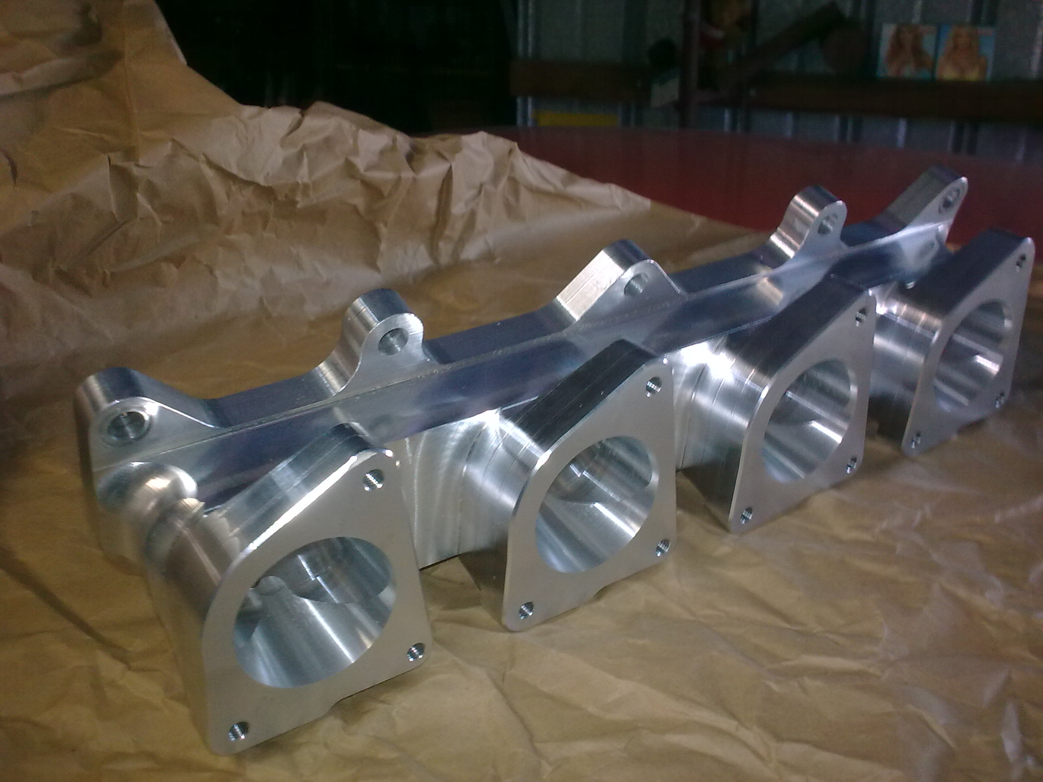

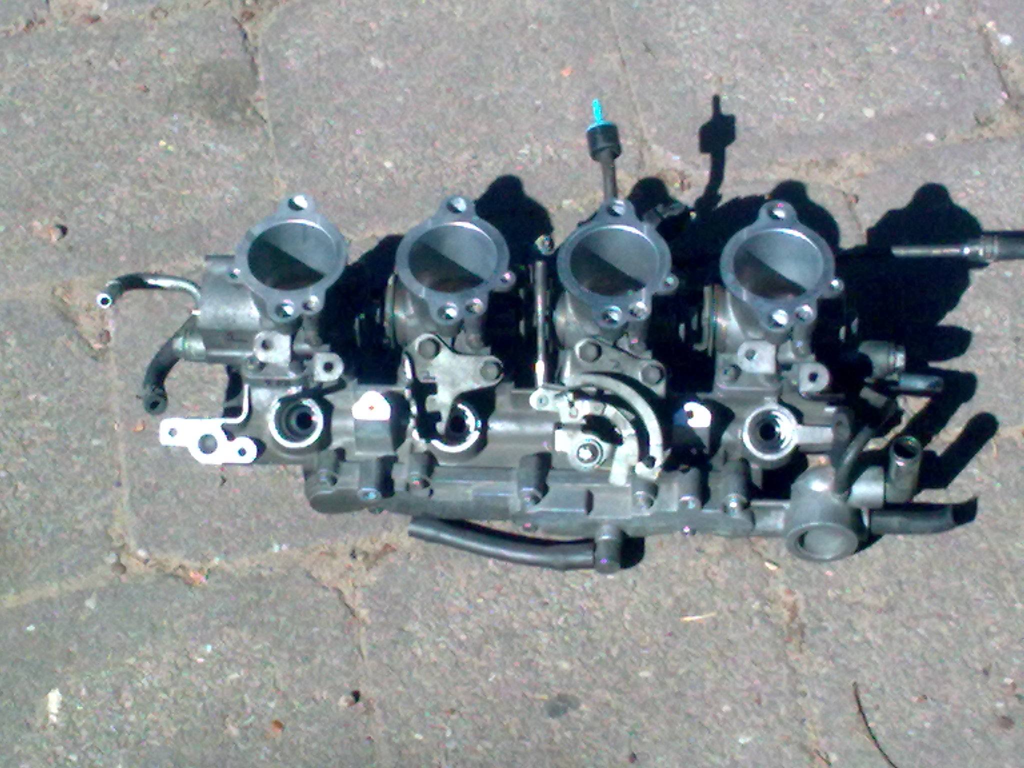

  10. I've started building the extractors and exhaust. I have decided to use the following size pipes in the extractors: Primaries: 1.5" Secondary: 1.75" And the rest of the exhaust: 2" I'm going to be using 2 small straight through mufflers. I have now got a tacho dash. The wiring is all done now except for the ECU wiring I have also put some pictures of my quad throttles. P.S I'm still looking for a manifold for the ITB's Cheers Jarrod.

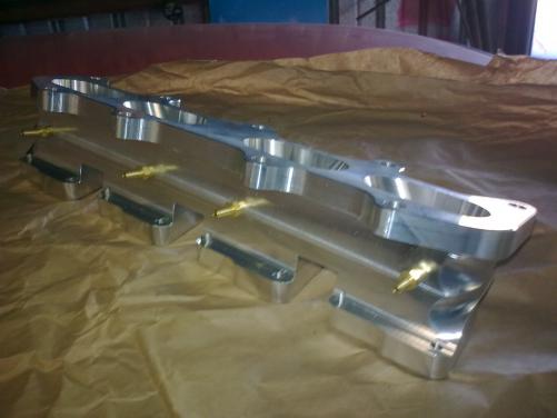

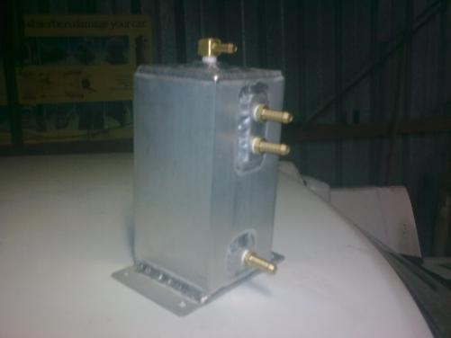

  11. Its about time for an update: I have brought a surge tank. I have done 90% of the wiring for fuel pumps/cooling fans I still need to find a: New 070 bosch fuel pump New lift pump Sort out radiator/ cooling system (Excel or VL) probably VL Make manifolds. (will be getting flanges made next week) Haltech I will post up more pics later

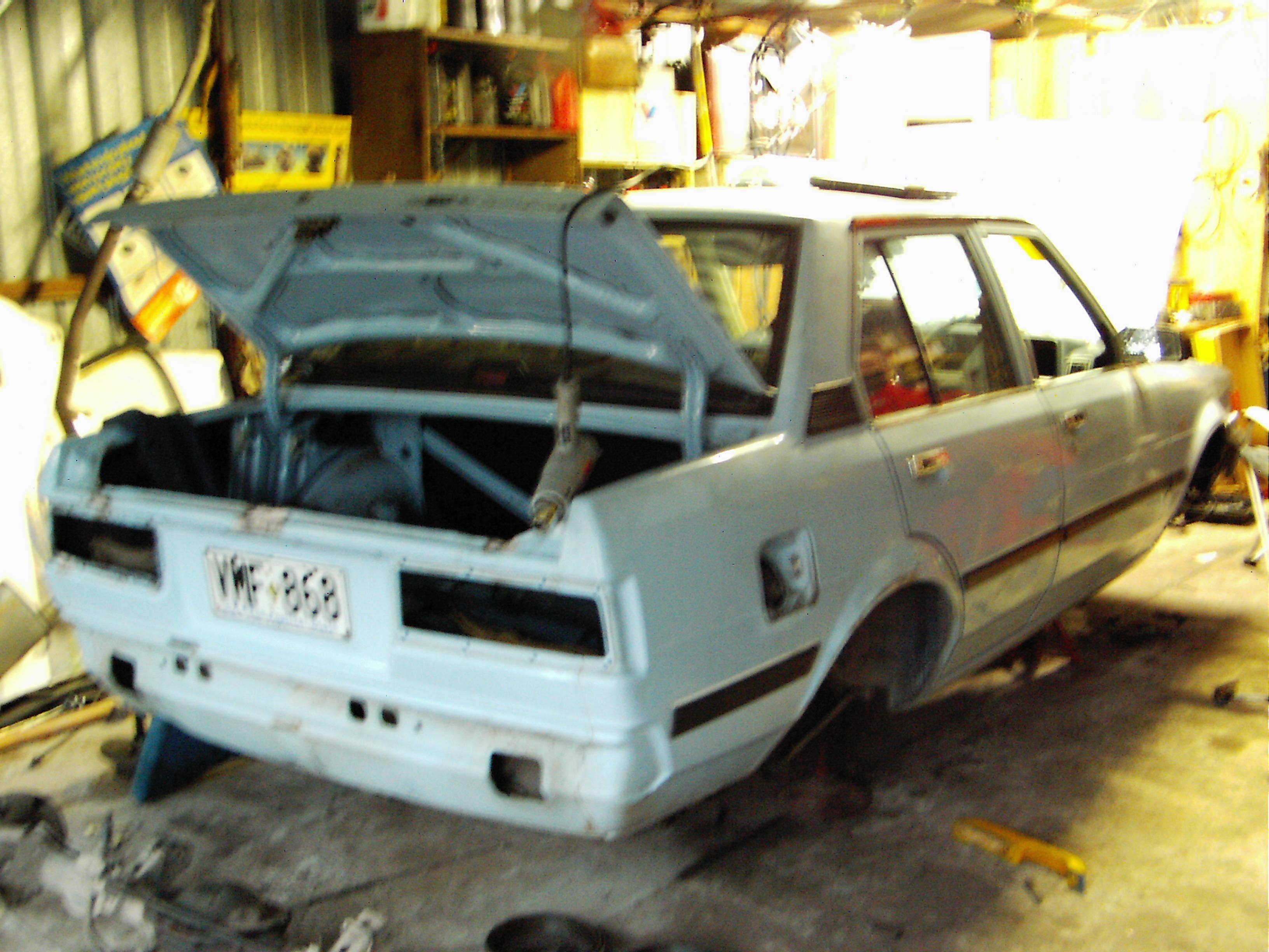

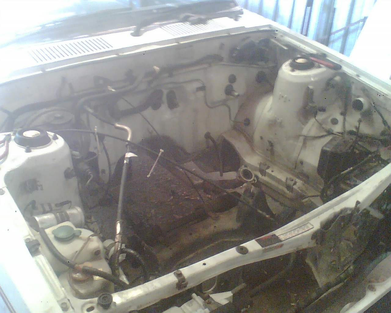

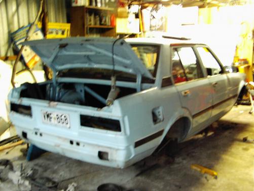

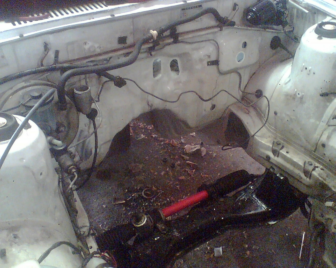

  12. Then the crossmember was swapped. all un-neccesary engine bay stuff was removed. Pedal box was swapped and hydraulic clutch was set up Then the 4AGE and T50 went in. Now i need to: make my manifolds buy of make surge tank set up fuel system Make exhaust buy haltech and tune... then race....

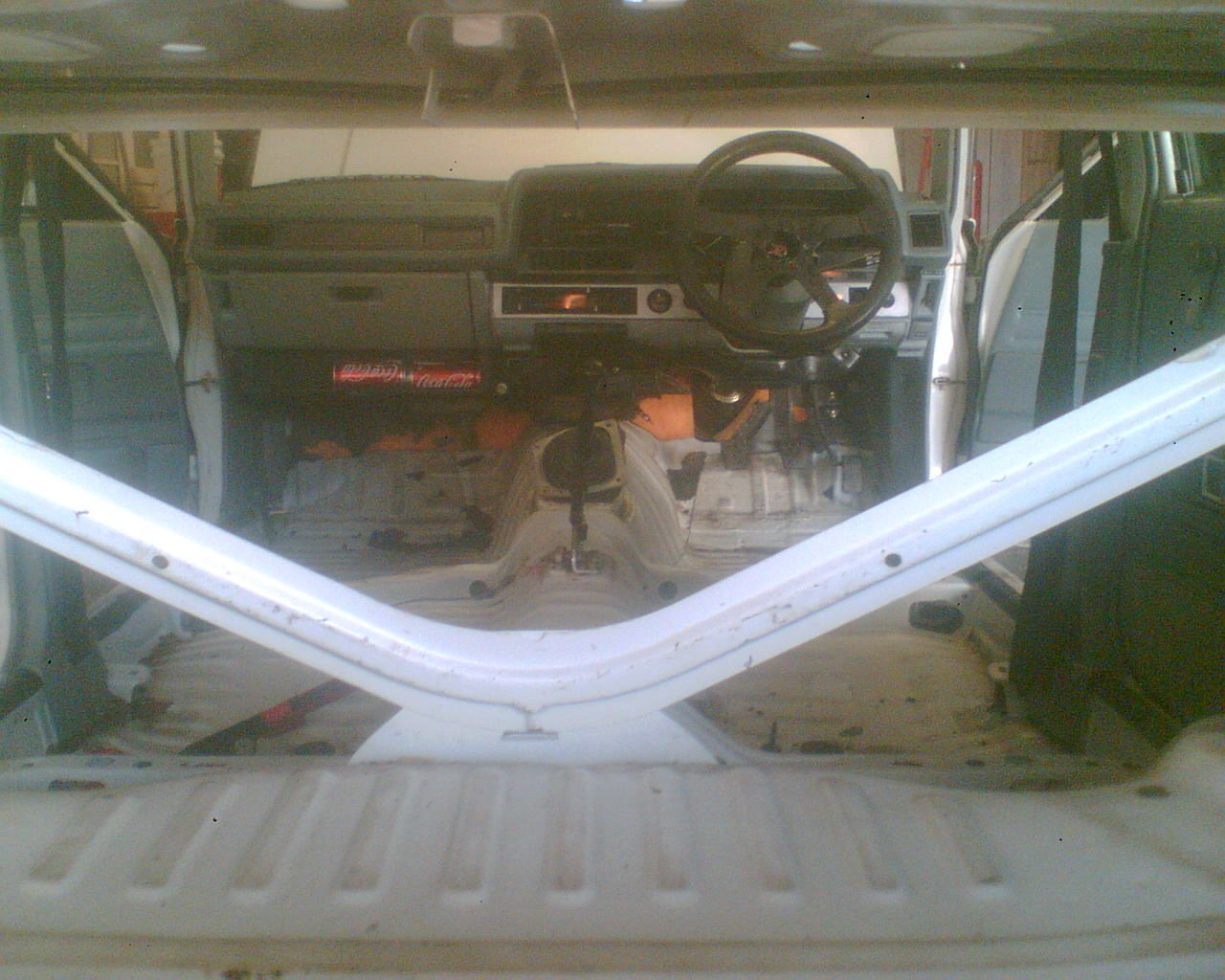

  13. Then we stripped out the interior, all the sound proofing and carpet came out (even the stuff behind the dash) The 4k+5 speed came out.

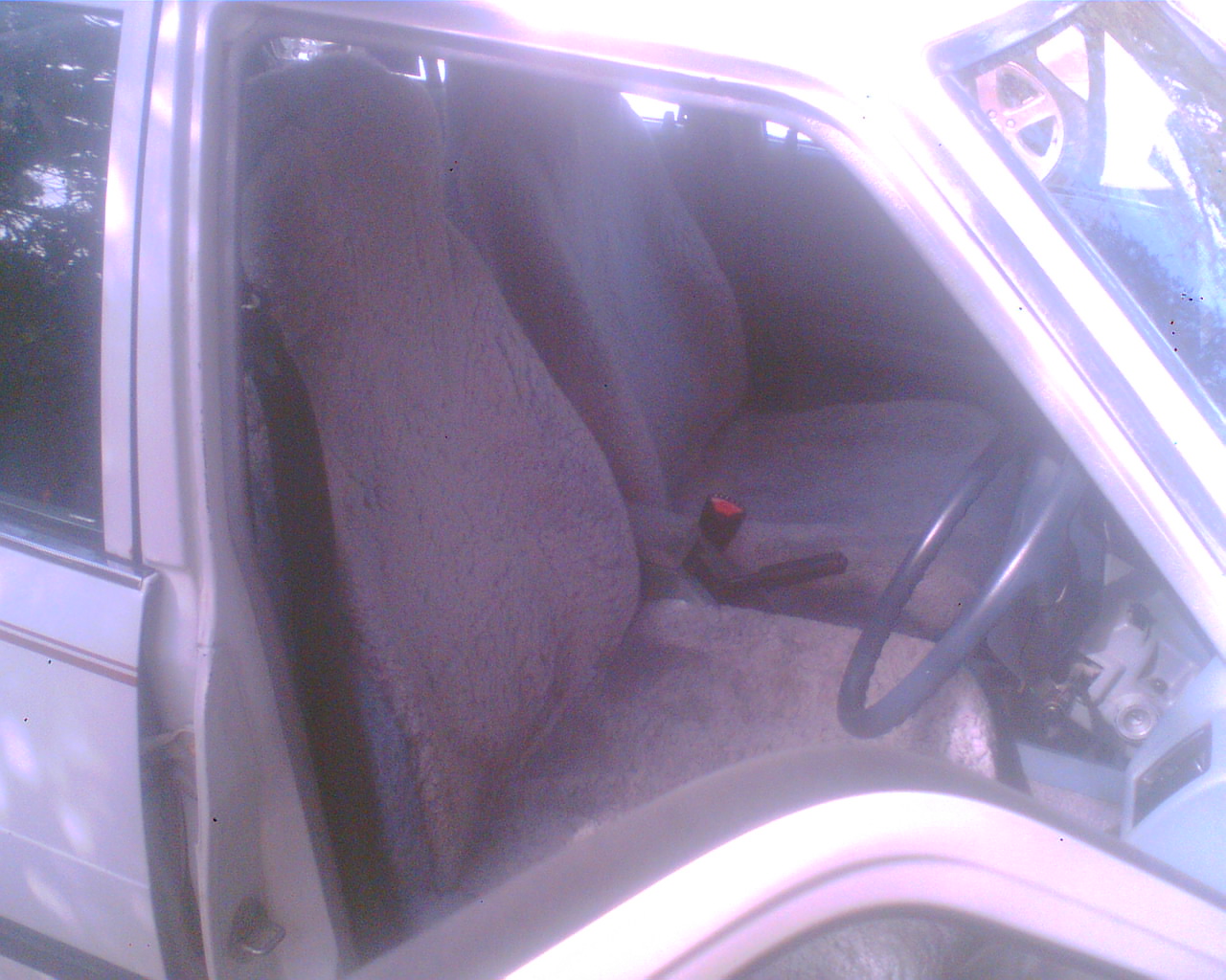

  14. Here are the pictures of the conversion, The camera batterys were flat so the pics were taken on a mobile phone Stock (and yes that is lambswool)
  15. Hey everyone, Just letting you know that the car is now off defect. There was no problem at all, (So who ever said the rego was canceled didn't know what they were on about) I have already started stripping it. 4AGE is going in tomorrow. Will post up pics tomorrow. Cheers,

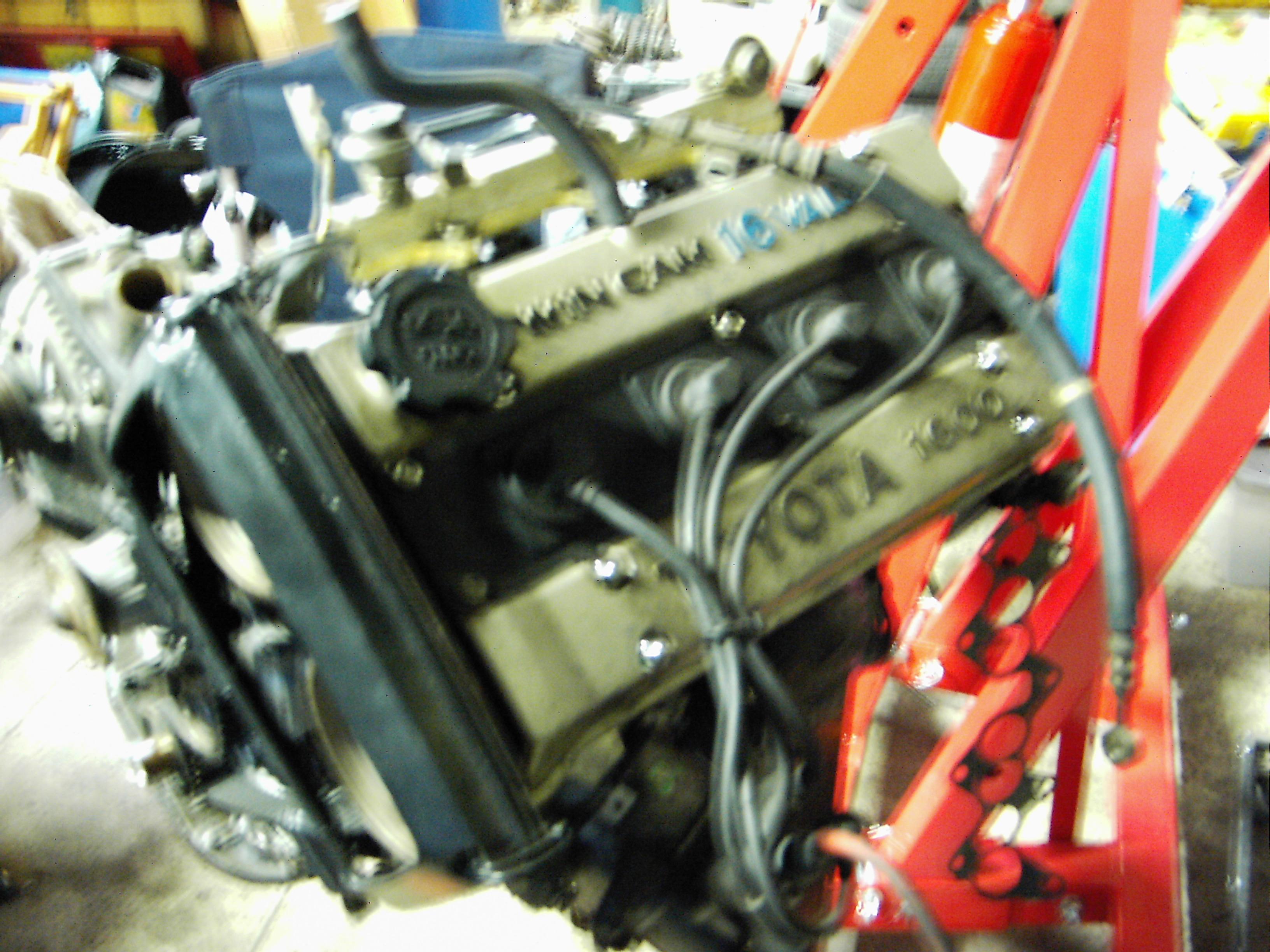

  21. Yea i got the 4AGE, and all the other stuff, i am just waiting untill the defect is cleared berfore i put it all in. my car is going to be used for mainly khanacross, autocross, motorkhana, ect. CAMS PRC (production rally car) rules don't allow for this conversion. (but thats for serious rally) I just want to have some fun. Heres a pic of my engine (sorry about how its blurry) its a bigport MAP sensored. P.S i brought Silvertop 20V quad throttles this weekend (now i need to make the manifold) Cheers Jarrod.

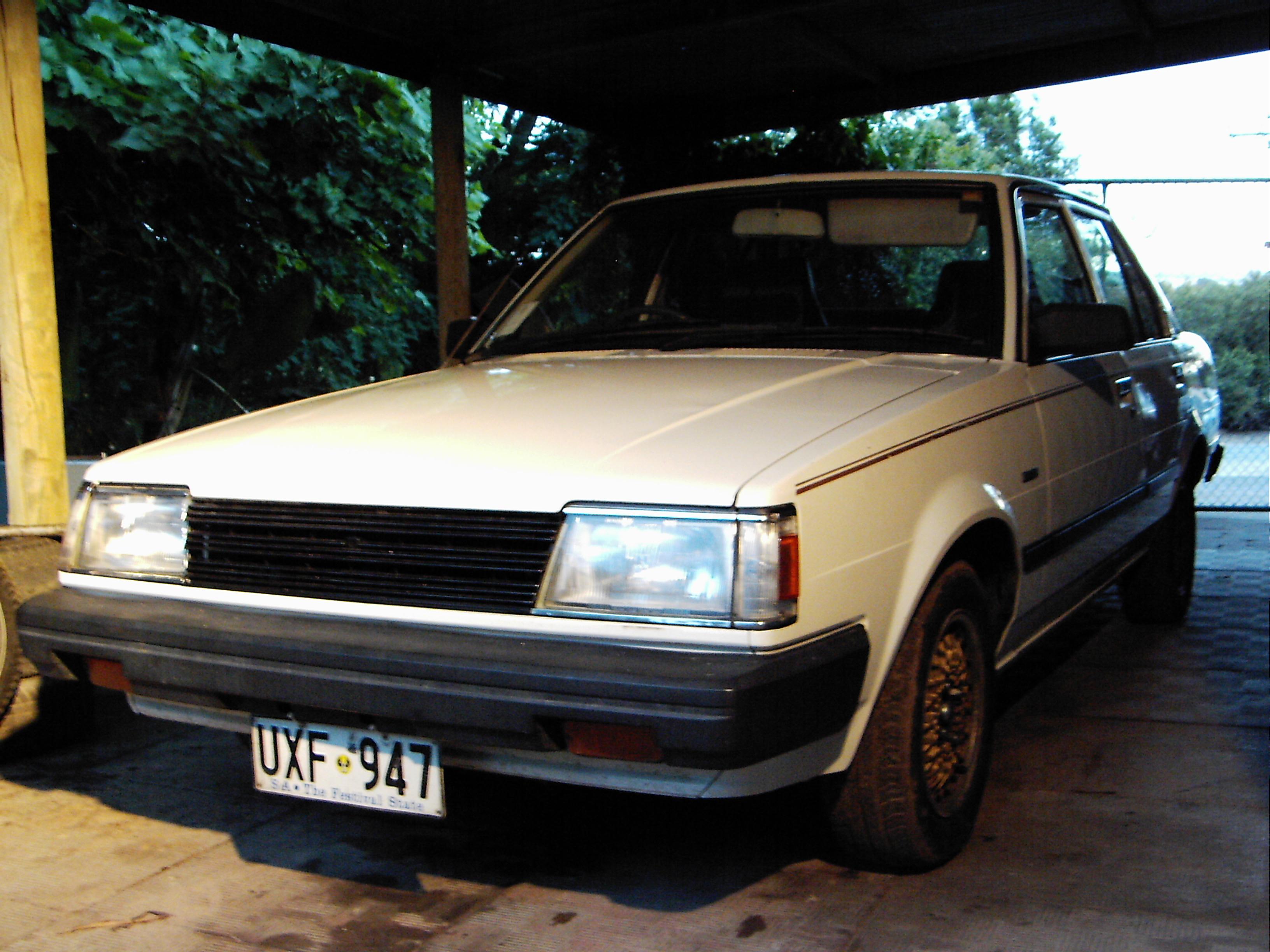

  23. I just found out that there is a 3 week delay to get it through Regency.

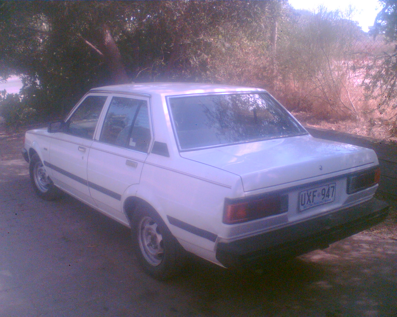

  24. The White KE70 is still defected. (for bald tyres, leaking suspension and too low) I have already put a set of Monroe GT's and some standard springs in, as well as a set of standard Lower Control arms in (to get through Regency) I still need to put a good of good tyres on it. I plan to take it through Regency this week, then I can get started with putting the crossmember, ect in. I will probably run the 4AC for a while, as I am saving money for a E8 Haltech for the 4AGE Will keep you posted, Cheers Jarrod. I still need to put a good set of tyres on it.
