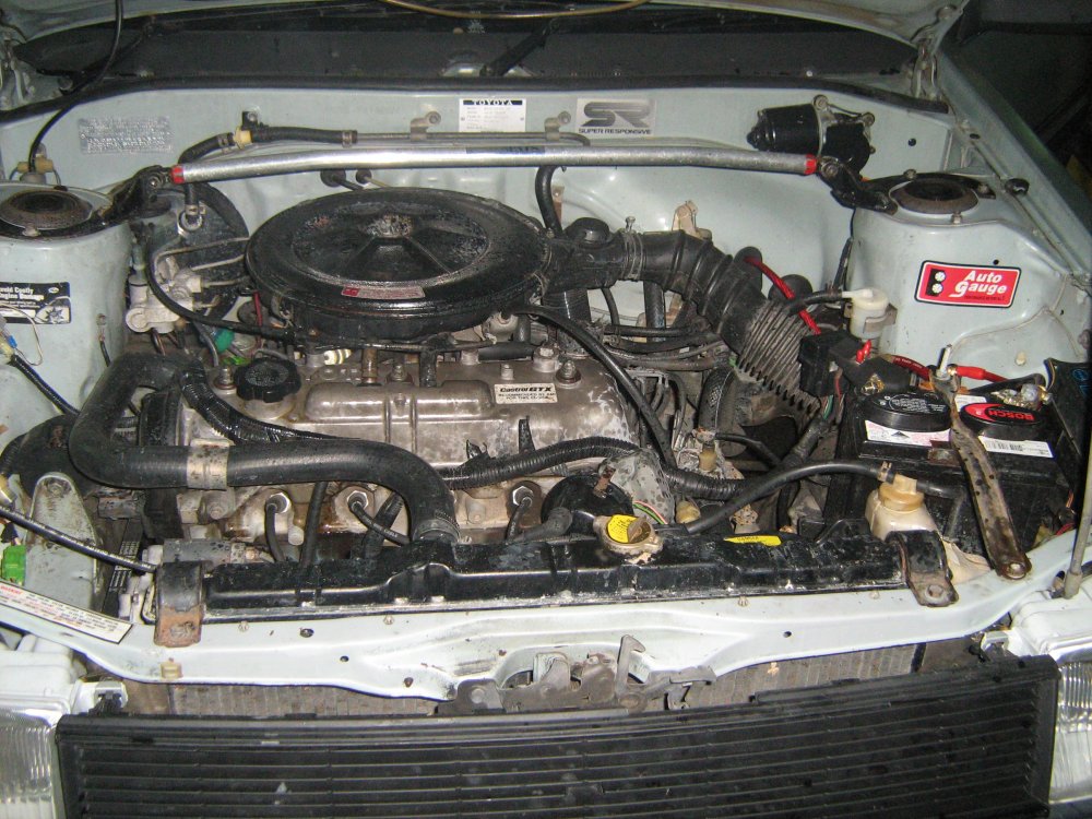

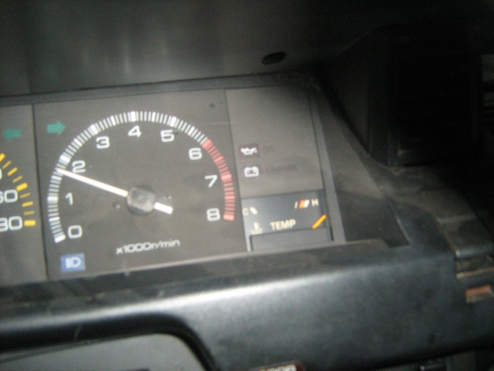

November 20, 200817 yr Author comment_291720 Well my night was shit, I blew the headgasket on it: I have 2 options: 1. Rebuild the 4A-C 2. Convert it to a twinky. Report
November 20, 200817 yr comment_291731 oh snap, was it the waterpump again or whats the story there? take some pics of the gasket when the head comes off. Report
November 20, 200817 yr Author comment_291733 oh snap, was it the waterpump again or whats the story there? take some pics of the gasket when the head comes off. The radiator has not been the best, The car has got hot before but never over the normal operating temp hot. Report

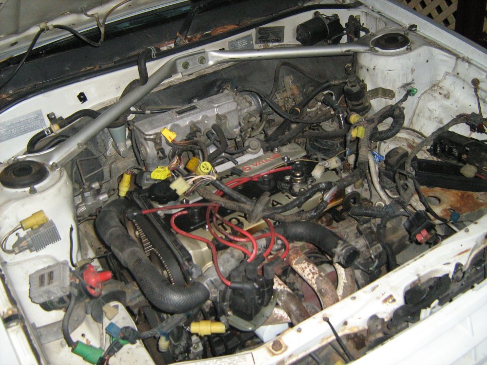

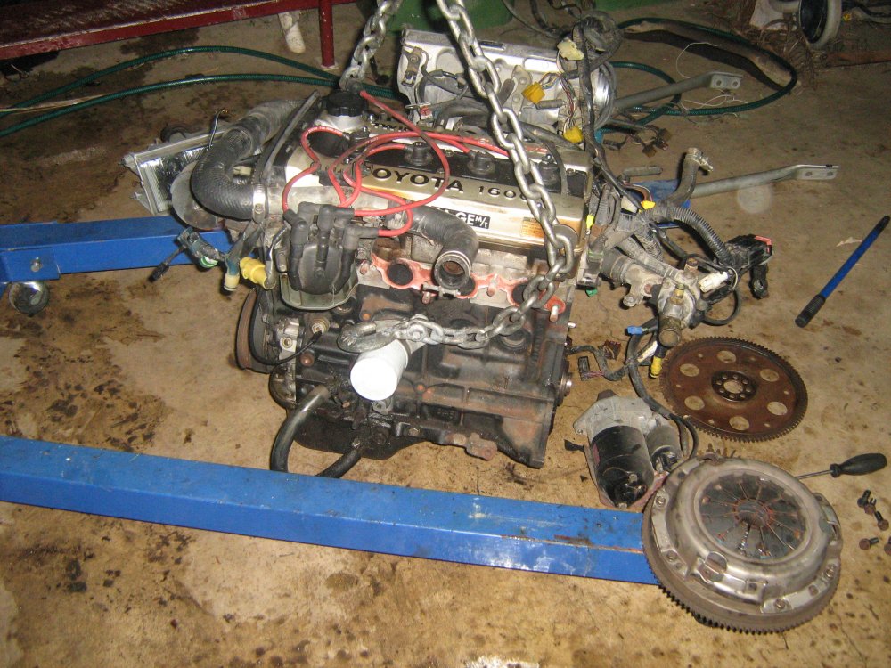

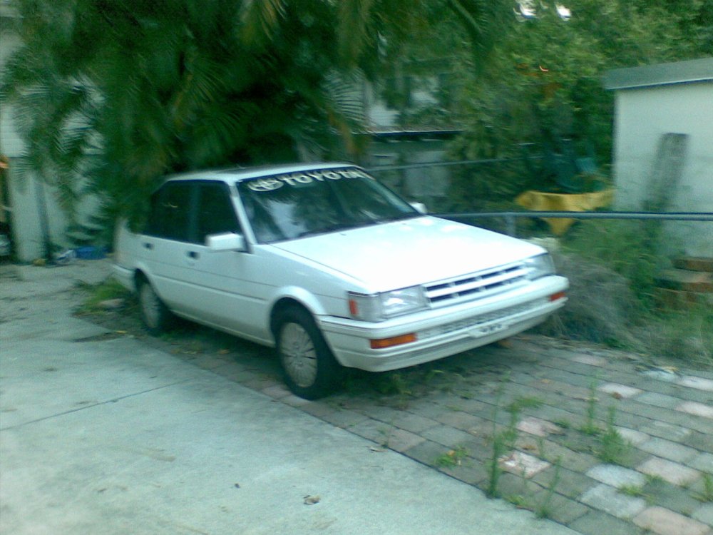

November 21, 200817 yr Author comment_291905 Pic of the donor car that i am hopefully getting next week: Every car we have will then be a twinky. Report
November 21, 200817 yr comment_291940 Pic of the donor car that i am hopefully getting next week: Every car we have will then be a twinky. Why are you taking photo's of my driveway that don't include my selfindulgent car? You know it'll chuck a tanty now... Edited November 21, 200817 yr by Insane Report
November 21, 200817 yr Author comment_291946 Why are you taking photo's of my driveway that don't include my selfindulgent car? You know it'll chuck a tanty now... Ha maybe you should make a rides thread for the 300 then so people can see what else you have. Report
November 23, 200817 yr comment_292257 Damm! That temp gauge is off the chart totally!! I just pulled out my 4ac today, goes pretty hard for a 4ac. check out my signature I'd sell it to you but i'm in melb so yeah... sorry to hear about the head gasket. Report
November 23, 200817 yr Author comment_292281 Damm! That temp gauge is off the chart totally!!I just pulled out my 4ac today, goes pretty hard for a 4ac. check out my signature I'd sell it to you but i'm in melb so yeah... sorry to hear about the head gasket. Nah i wouldnt buy a replacement 4ac for it anyway, I work at a mechanics/machine shop so i could easily rebuild it but its working out cheaper and better to buy the other ae82 twincam and do a conversion. Report

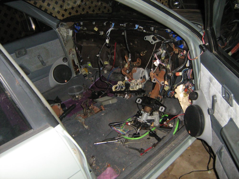

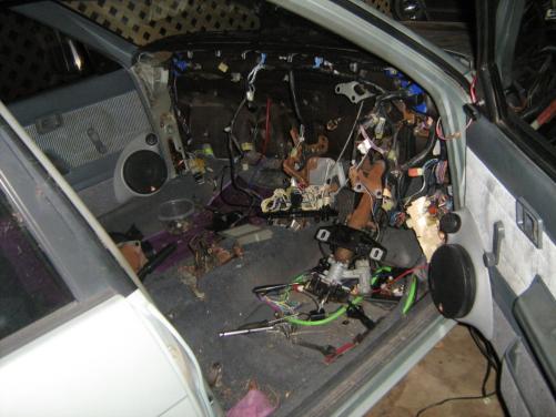

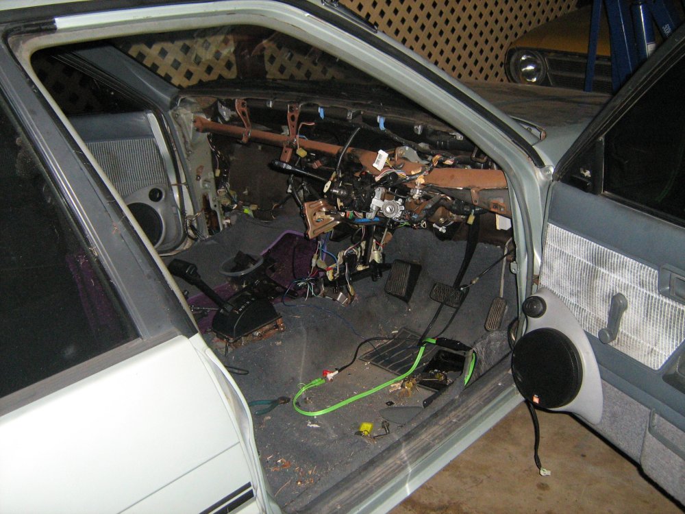

November 26, 200817 yr Author comment_293115 Dash & inside loom is almost out: Tonight i will disconnect all the engine and tranny shit so i can just undo 4 bolts and it will be out tomorrow. Report

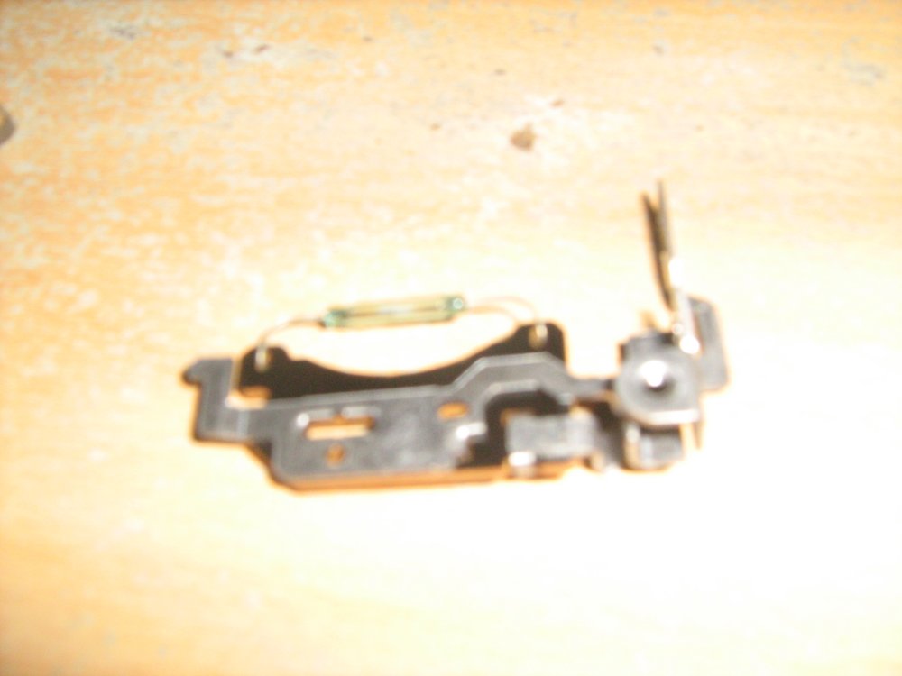

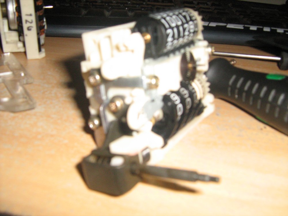

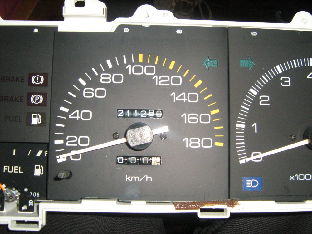

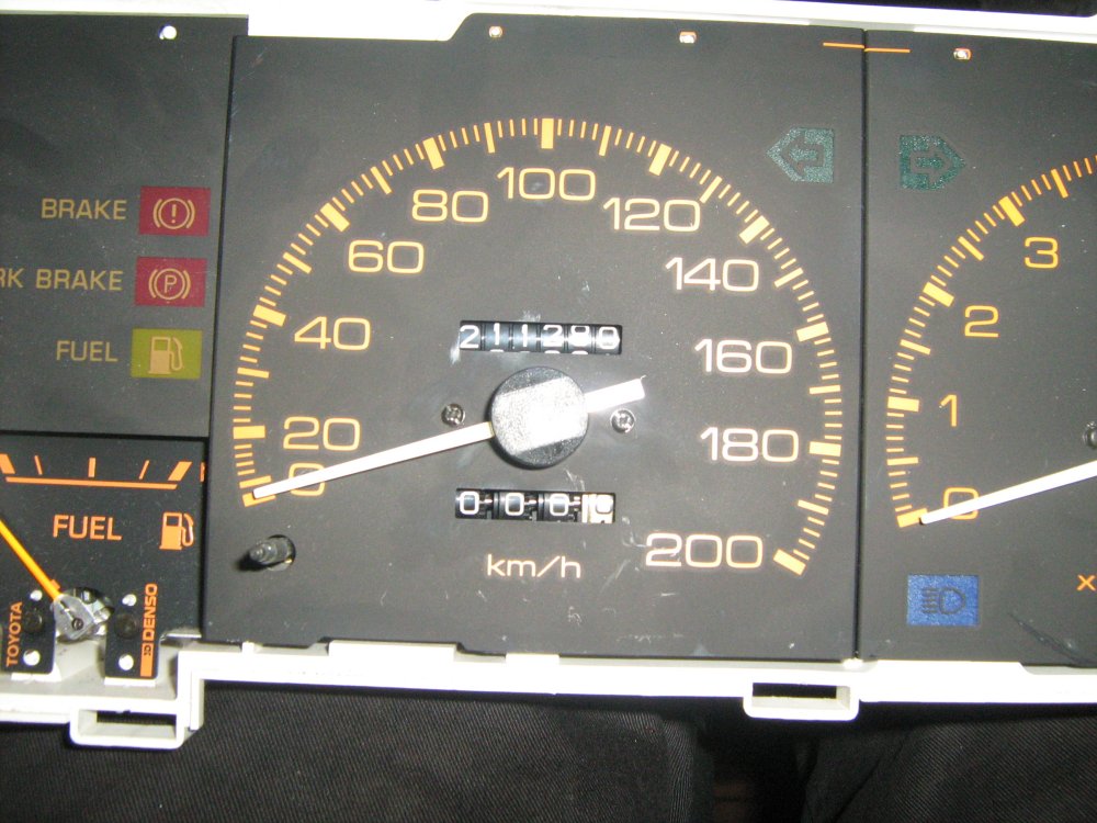

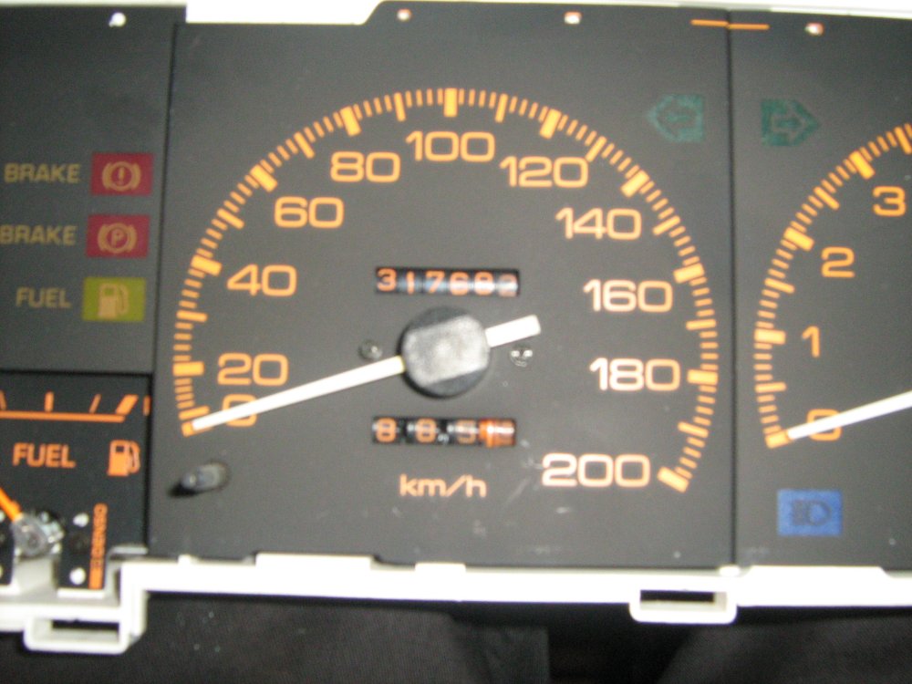

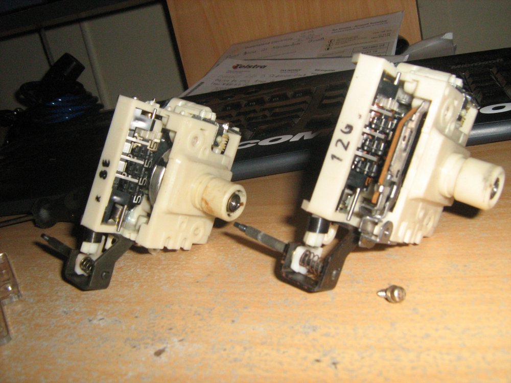

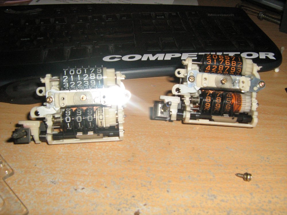

November 27, 200817 yr Author comment_293310 I wanted to keep the chassis k's on the car but i knew the speedo in the twincam had a speed sensor so i thought id take a gamble and make the single cam one work, It was easier than i expected, Pics: I don't have pretty colored numbers now but oh well. Report

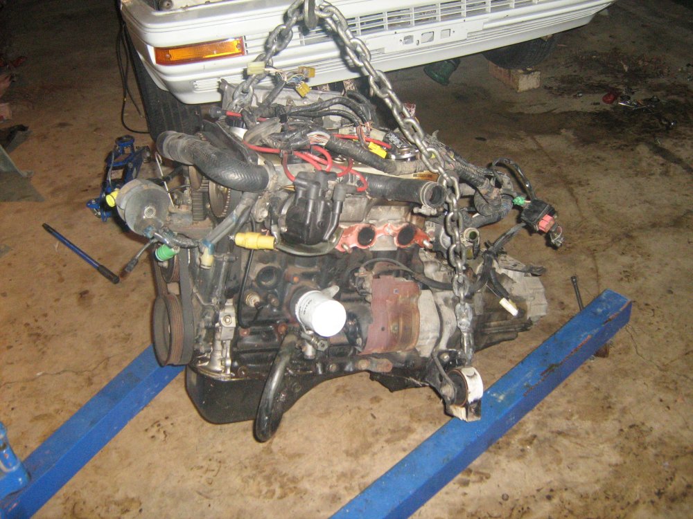

November 27, 200817 yr Author comment_293447 Its all coming along quite easily so far, The twincam harness is installed into the car and the 4age is disconnected from the other car except for the oil cooler, Engine mounts, Extractors/exhaust and a fuel line, I'm hoping to take the 4age out tomorrow night and sort out everything else i need off the car then i only have to get the front body loom out. Report
November 28, 200817 yr comment_293562 Gee's mate, you don't waste any time do you! As you know, I'm doing the 4age convo as well but I was just going to use my single cam speedo, then when I rev it to 7500rpm, people will freak out, he he! You lost me on the speed sensor odometer thing, I understand you want to keep the 211k but what is the speed sensor thing? Report
November 28, 200817 yr Author comment_293595 Gee's mate, you don't waste any time do you! As you know, I'm doing the 4age convo as well but I was just going to use my single cam speedo, then when I rev it to 7500rpm, people will freak out, he he! You lost me on the speed sensor odometer thing, I understand you want to keep the 211k but what is the speed sensor thing? Nah i try not too, I wanna drive it to work monday... Why will they freak out, My 4ac revved to 7200 (it just didnt wanna rev anyhigher, oh well), Can you get the twincam dash for it? Ok to put it in a easy way it sends pulses to the ecu, Without it the rev limit will lower to 7500rpm. Report
