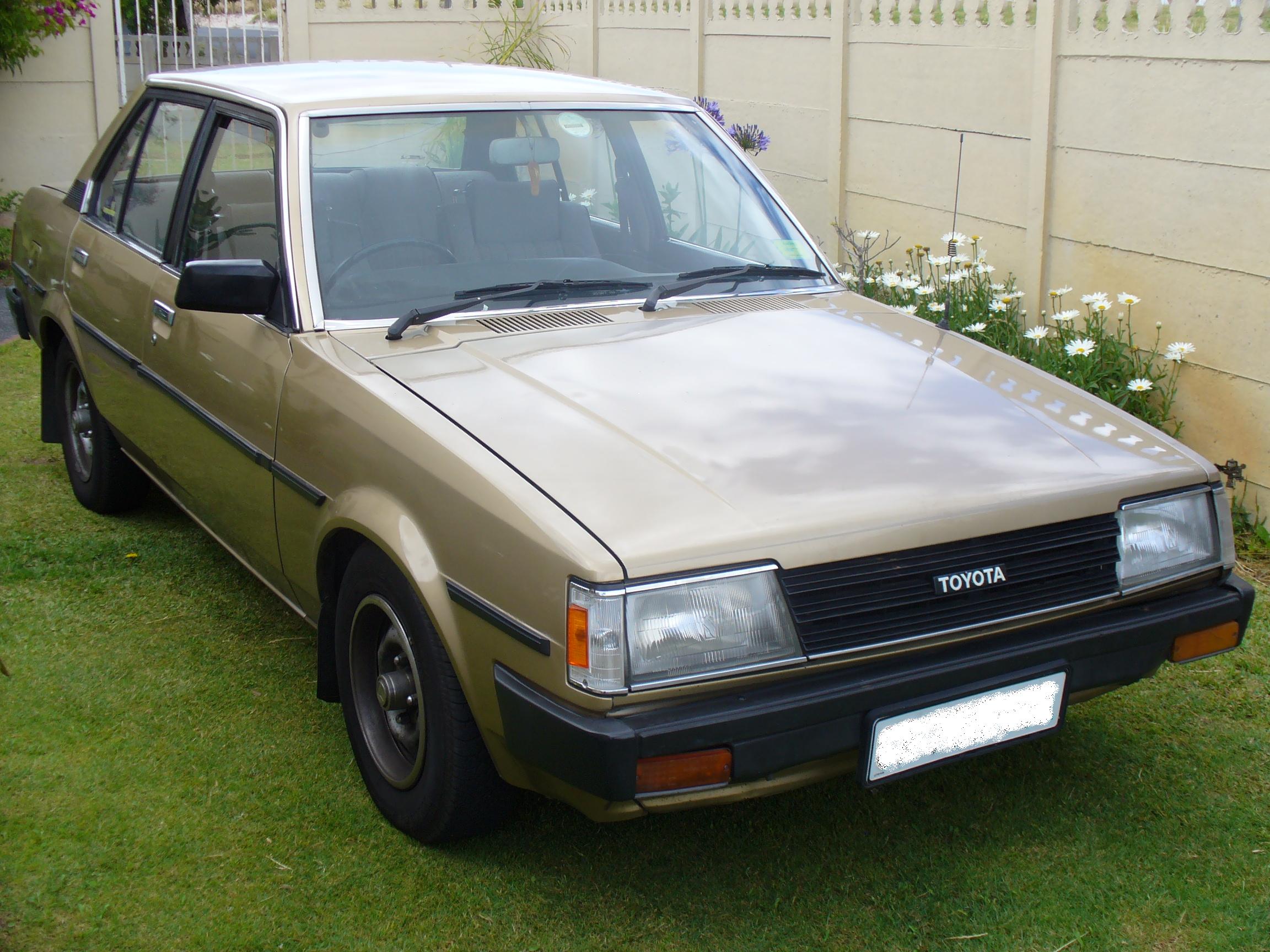

December 5, 200718 yr comment_213344 Dude, that looks like an AE71 or KE70, NOT a TE71. Engine bay pics will show for sure, or check engine number. Edited December 5, 200718 yr by machg Report

December 5, 200718 yr comment_213360 Toysrus, Welcome to the club ! First up, everyones here to try and help you out; don't mind the occasional thing said thats not quite true as were all still learning here. Thats a nice Te71 you have there, ive only ever seen 1 in the country. (Australia). Being a Te71, I'm not too sure if you have a steering rack or steering box. Either way, to fit a 4age, you will have to change to an Ae71 cross member, or fabricate something to suit. Some pictures of your steering shaft to the steering *assembly*, and the motor would be helpful. For people playing at home, Yes its a Te71. Note the different bumpers, Seats, Indicators, radio poll position, and i think even the mirrors are different on the jap ones. don't quote me on that tho. Also, Te / Ae / Ke - yes its for the different motor, but there are also many other differences between the models. Its easy to get confused, but its the small details that make the big difference :jamie: Report

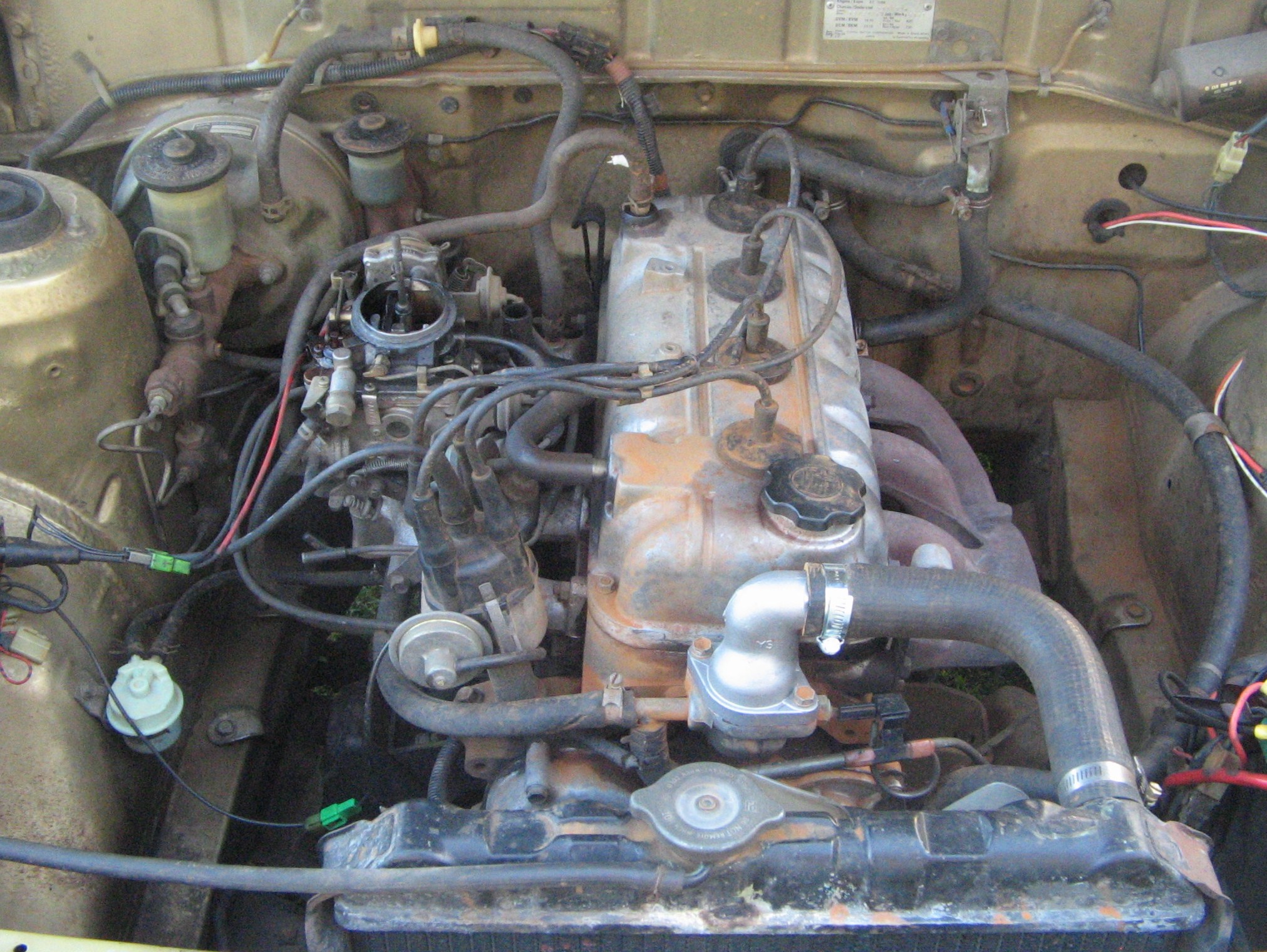

December 5, 200718 yr Author comment_213374 Thanks!!.....and thanks alot for the info on the crossmember, thats my main worry. Ill take pics of the engine bay later. Report
December 5, 200718 yr Author comment_213385 Motor is a bit dirty. Edited December 5, 200718 yr by toysrus Report
December 6, 200718 yr comment_213565 That certainly looks like a t series engine. I am also doing an A series engine swap into a TE71 (all be it a 7AGE into a hatchback body "lazarust") but you'll probably beat me to it, as I have lots of bodywork to do first. Report
