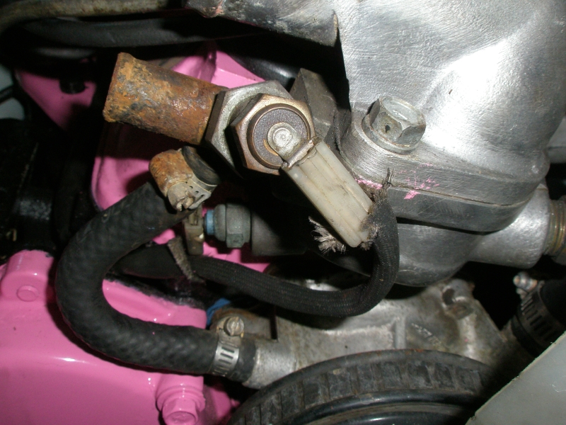

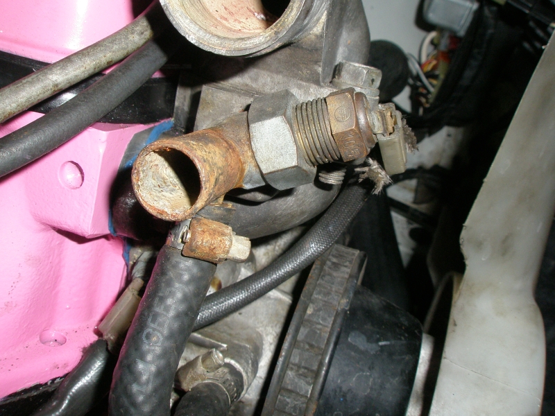

my temp gauge doesnt work so i had a look at the cables and found on connected to the thermostat but there is another one just chilling there see pic
so where does that go??

3. that wire goes over the other side of the thermostat housing where there is another temp switch.

as for the thermostat i looked around for like 20mins and couldnt find anything, this is what she looks like i seen others that have it near the top but i got lines going into it so where would this cable be??

Could possibly just be that wire thats hanging down then goes to that one temp switch, the other one might be for oil pressure. Does your oil pressure light work when you turn the igniton on and start it up?

All of mine have two temp senders... one on the side (like yours) and another around the other side of the thermo housing at the front.

ok cheers i had another look and couldnt find it so a pic would be great cheers

still can't find the connector for the temp gauge:sob:
