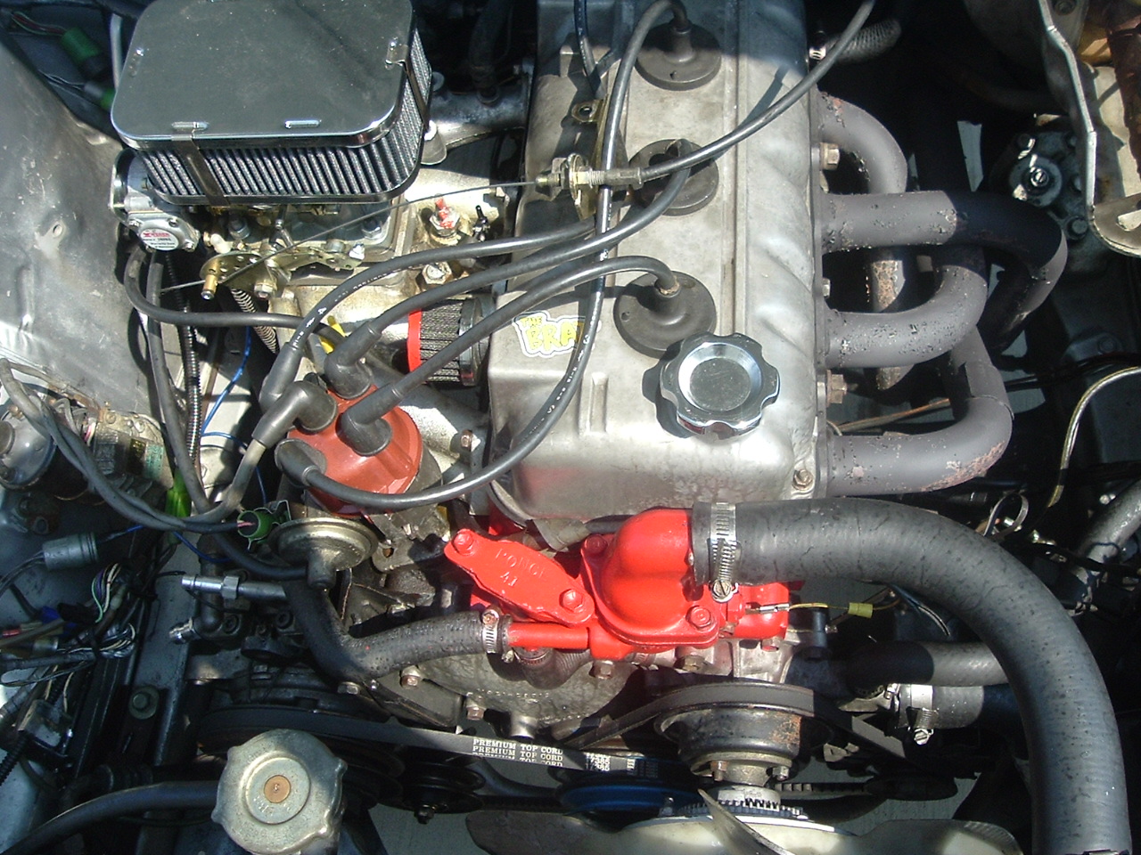

  8. Well guys I finally found the problem.....electric stuff in Toyota are tricky but with a lot of patience and a multimeter you can get to it.....well first of all I striped the wire hardness going and coming form alternator/battery/voltage regulator. Got my multimeter and started checking for continuity...well found a fried wire so replaced it no problem.......but the problem was still there......When back to multimeter and check for voltage coming from alternator and voltage regulator....it was the same so I knew that voltage was not been regulated at regulator.....so open the regulator and it was burned inside so my problem was a combo....anyway replaced the regulator and presto problem solved.......I hope this helps anyone out there with the same problem....thanks a lot for the inputs guys

  15. The batery has been replaced same with the regulator and all wires got good continuity......will replaced the regulator again in case it came defective from factory...I will let you all know if it got fix or not.....I also found the wire coming from the alternator to the fuse link to battery burn out...replaced it and the problem is still there....when I open the regulator it looks like some wires where burn out so anyway i will let you all know as soon is replaced.....How much voltage is outputted by the alternator? and thanks for the help.
  16. Hey guys i got a te72 corolla wagon an 82....well I got the charging light always on for some reason and I have replaced the alternator, voltage regulator, batery and nothing ...still there.........I check for continuity on wires and is good. When I checked the battery input it reads 18 volts wich I know is way too much.....so I took the voltage regulator off and the voltage drops down to 14 V like it should....can someone help me ...I'm running out of ideas....thanks
  17. Hey I had the same problem and it was only the ground wire for the battery...it will act up sometimes and sometimes not...any way the cable was loose and battery ports dirty...replaced the wire cleaned the ports and presto.....no more problems. Hope it works for you.
  18. Hi guys ...I got a wagon 82 te 70 USA version...anyway I put a 34/34 carb webber in it and since my charging ligth came on it is not working rigth...so I figured maybe battery, alternator, voltage regulator, battery cables, MSD ignition coil and ballast resistor replacement will fix the problem...but no after every one of these parts have been replaced the light is still there and the car feels like it want's do die when I first hit the gas...after the revs are high no problems...the only thing is that it make explosions like if there was too much gas goin in the eng but it stills rides with lots of power...also I check how much voltage was been delivered to the battery and it said 18 v....which I think is too much but not sure....I have set the webber to factory specs and still nothing...I think my charging light has to do something with the problem but got no ideas...please help!!!!!!!!
