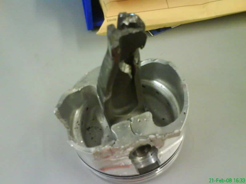

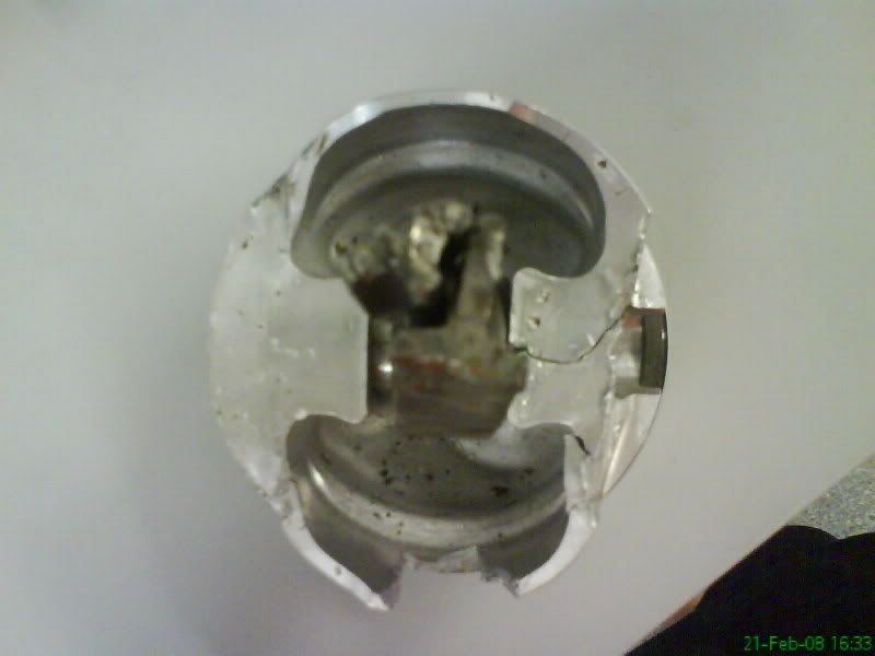

The dude at work builds race engines for some boats on the side, At the moment he is building a mild 253 for a stock class boat which means crank mods only. But this was a previous motor in the unlimited N/A class.
366 Chev.
Loads of head work.
JE pistons.
Carillo rods.
Custom stroker crank.
Titanium valves
Methanol mechanical injection.
16:1 Compression ratio
800hp - 850hp.
Bad tune = bye bye rods, valves, pistons, crank, sump, block and $15,000+.

:P man, it would take some effort to do that to a carillo!
i know alot of people who don't bother to get a proper tune, then wonder why this happens. :yes:
This happened because it ran too lean.
Barrel valve decided to play games.

shit 16.1 comp that's a lot you'd have to be spewin though.

I had a SBC drag car piston in the other week that we had made. It looked pretty much the same as that except the rod was bent really bad but not broken. I`ll have to dig up my old phone and get the photo.
stu.
I remember hearing about that boat.
stu.
That would be good.
Been reading some books about methanol mechanical injection *drool*.
I will also get some pics of a melted titanium valve.
